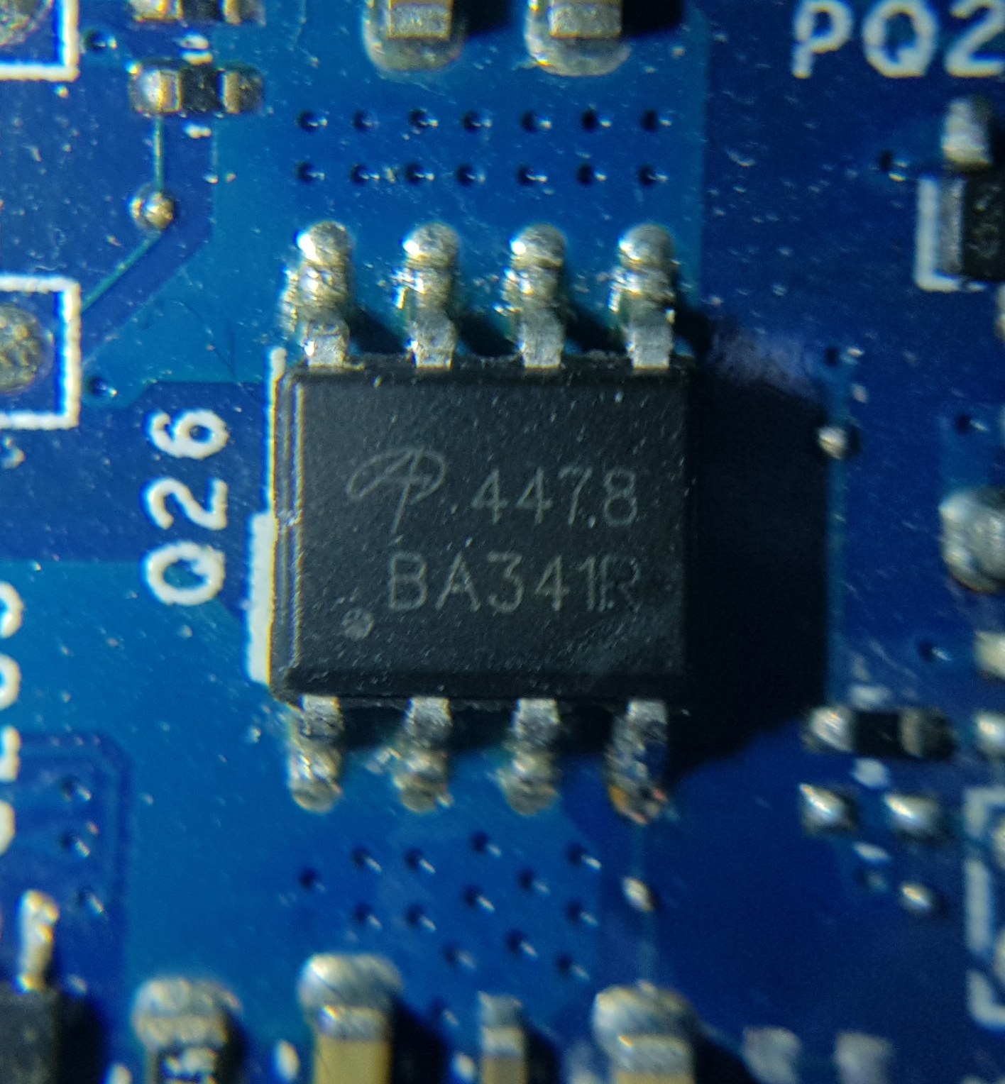

    Where can I buy a new replacement IC marked AO4478 BA341R, I don't have this one on any of my donor boards, they are different markings.
    Or is it SI4800BDY-T1-E3

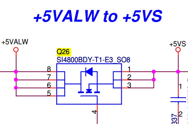

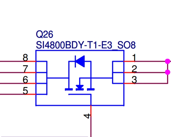

      Re: Alienware M14x R2 with 7 beeps error
      Q26 is SI4800BDY-T1-E3_SO8. It is cheap and can be found in any local Electronics IC store. If they do not have it, ask them for a compatible replacement that should be an N-channel Mosfet.

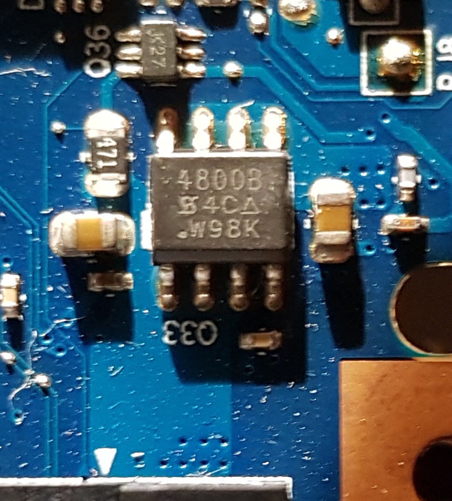

            Is this also it even though the markings on it are different?

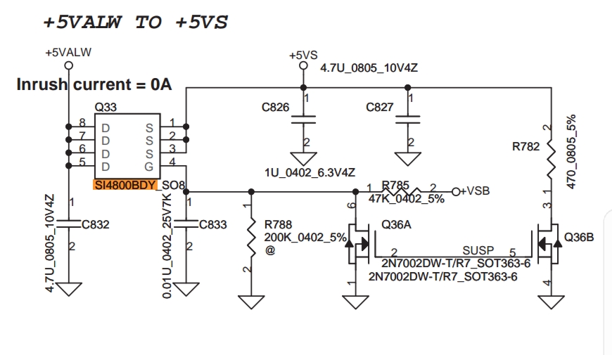

              if the schematics belongs to the Q33 IC, it is the same as Q26 of your laptop.
                4800B is the important bit on the chip, the rest will be date codes/manufacturing plant/package type etc. so are unlikely to match.
                It's the correct chip.

                  Mine is 4478 and this one is 4800B, but they are the same SI4800BDY model on the schematics, is that ok?
                  Mine is the 2x pics on the left and 2x on the right is the donor part
                    Great news and bad news, great news is the +5VS line is working, the speaker beeps are loud and clear high tones as it should be and the keyboard LEDs are working properly and the fan runs at a higher speed, bad news is I still have 7 beeps, sometimes 3 beeps then 7 beeps as I was getting before, so one problem is fixed, now have to find the other, I'll test Vcore again.
