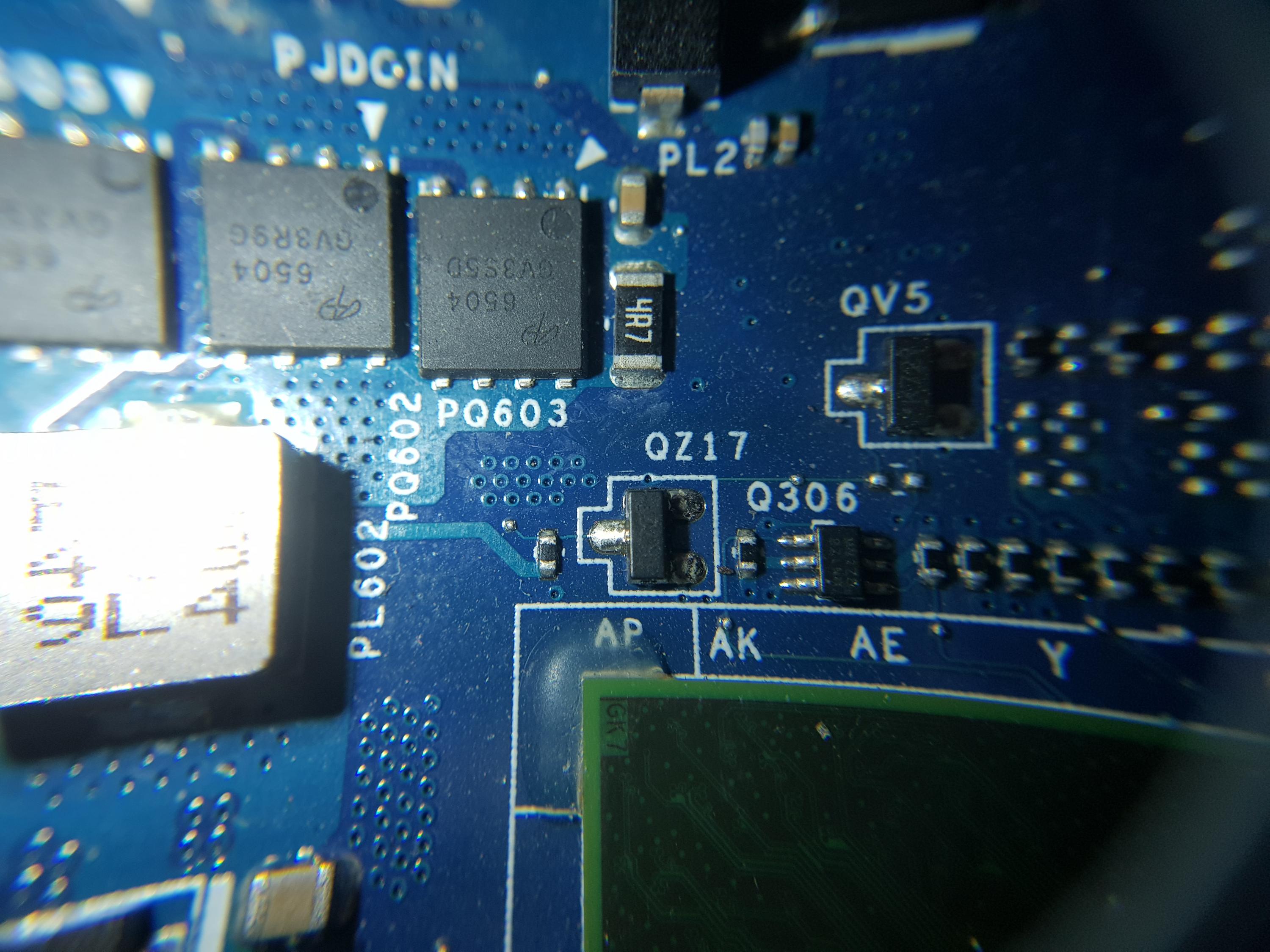

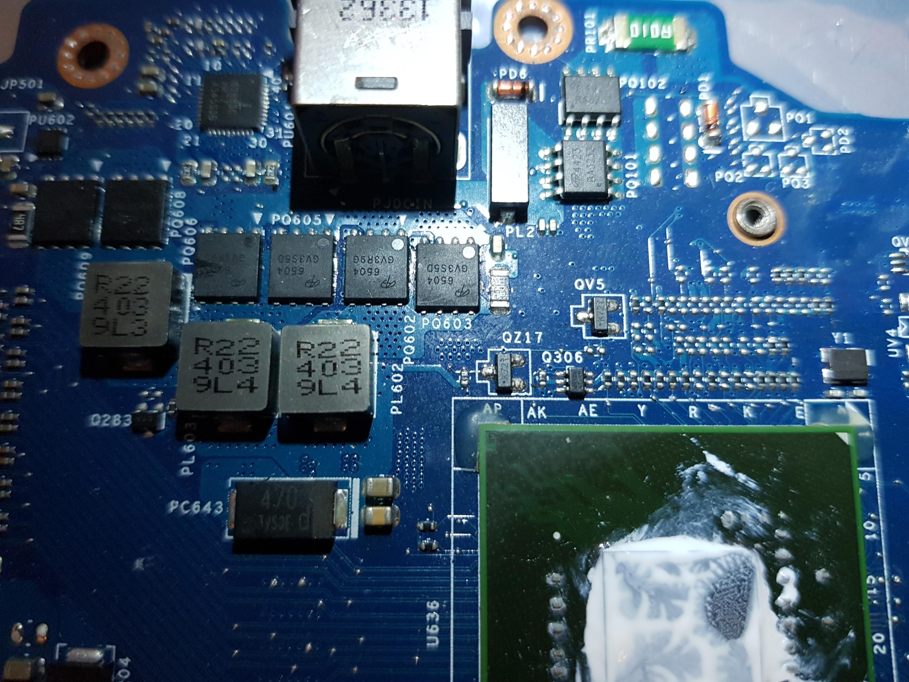

    Here is a picture, I only recently learnt about boardviews but couldn't find one for this board, it would be awesome if you or someone found the boardview for this board! It would make it so much easier :-) I'll be back online tomorrow night here :-)

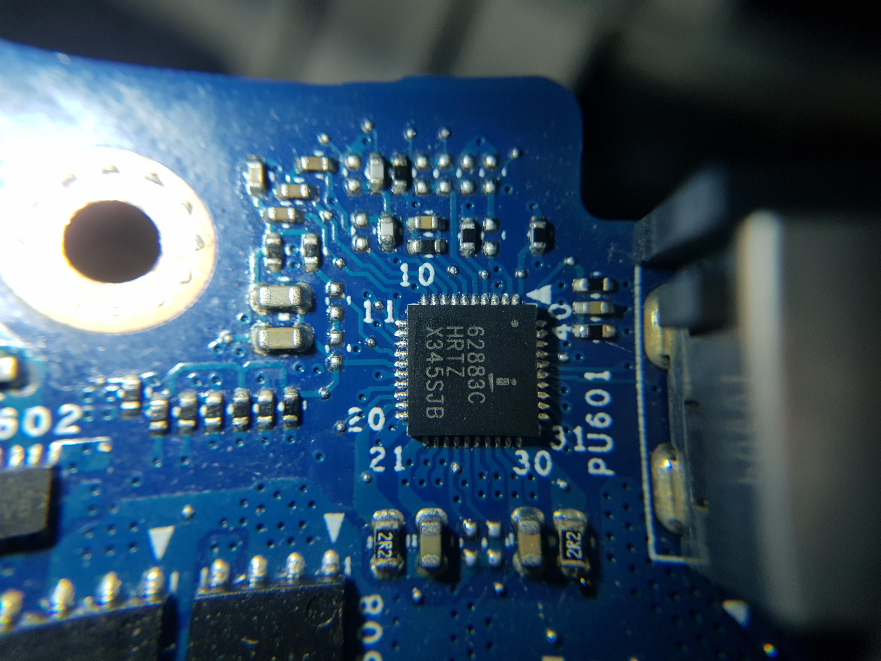

      Firstly, clean the pins of PU601 using a brush. I see a tiny wire on its pins.
      I searched the net. No boardview is available.

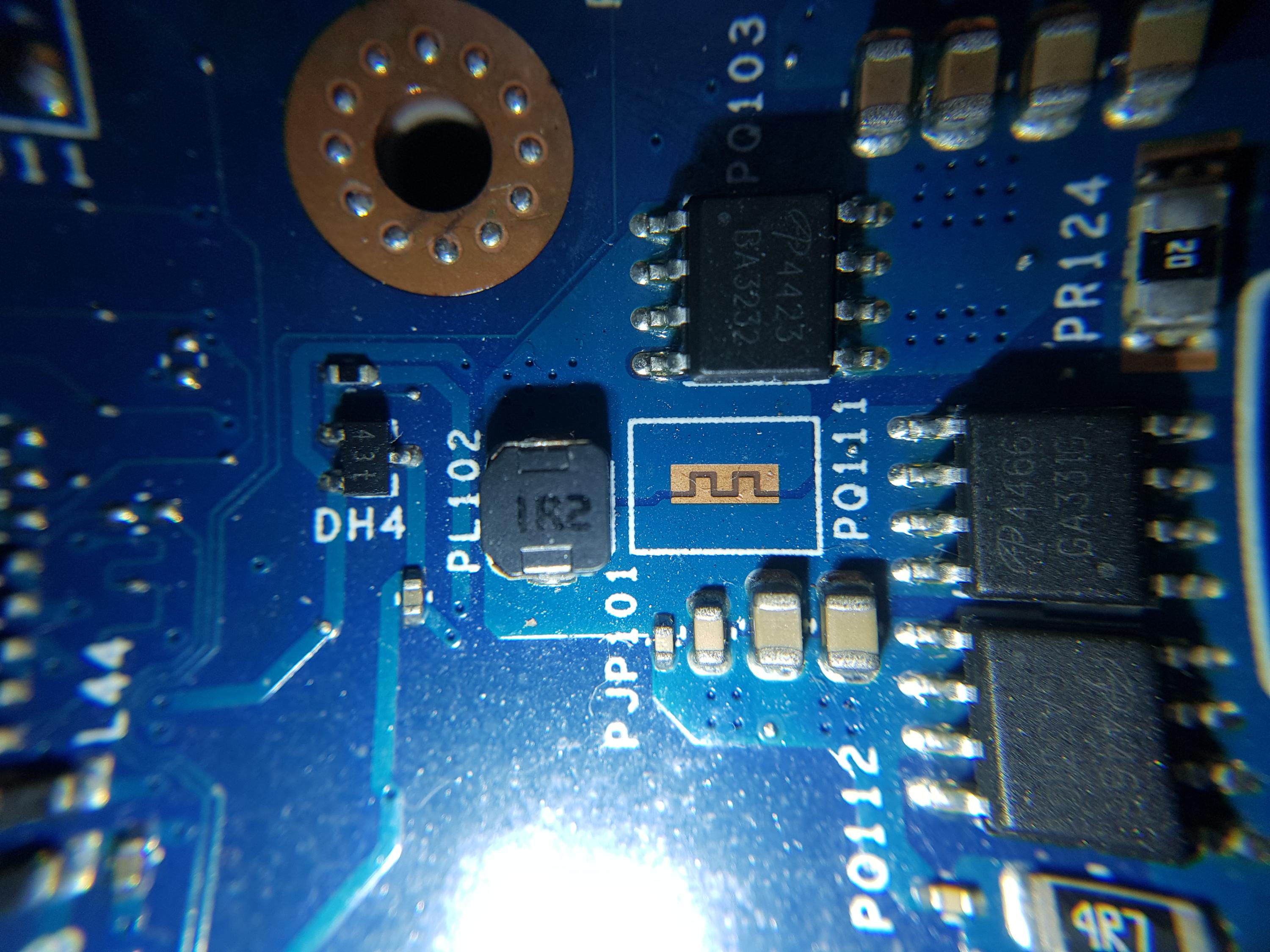

                On schematics PJP101 is a jump but on the board it looks open from factory.
                PJP101 pin 1 to PJP1101 pin 1 - goes up and down between 0.3 ohms and 0.1 ohms
                PJP101 pin 2 to PJP1101 pin 2 - went up to 380 ohms quickly then O.L
                PJP101 pin 1 to PJP1101 pin 2 - O.L
                PJP101 pin 2 to PJP1101 pin 1 - goes up and down between 0.2 ohms and 0.0 ohms

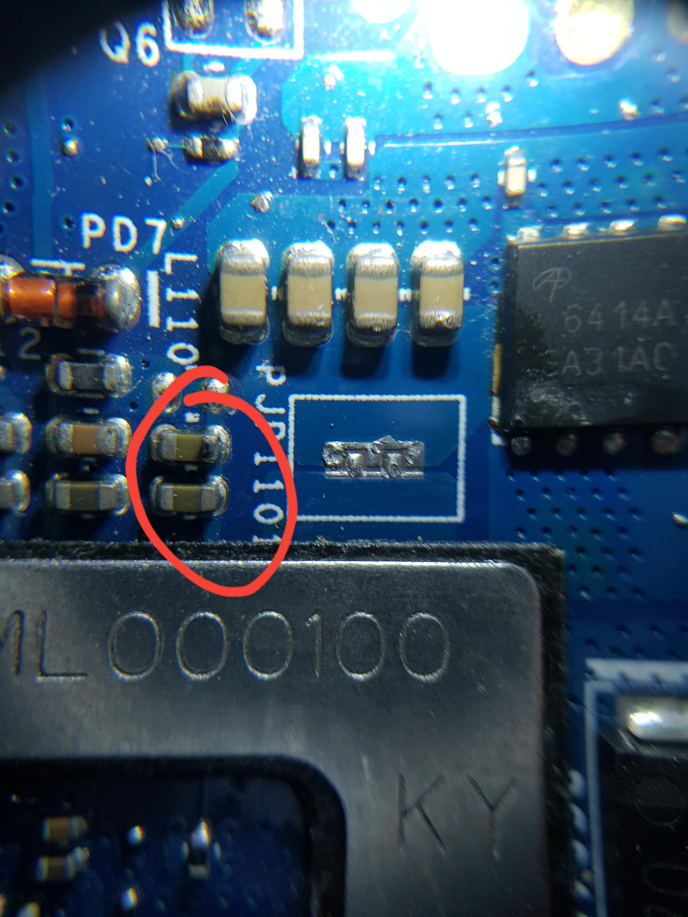

                        I cannot locate the markings, they are possibly unmarked.
                        Maybe these two?

                          #172
                          Re: Alienware M14x R2 with 7 beeps error
                          those two components seem to be capacitors.
                          look for PL714 and PL715 on the other side of the mainboard.

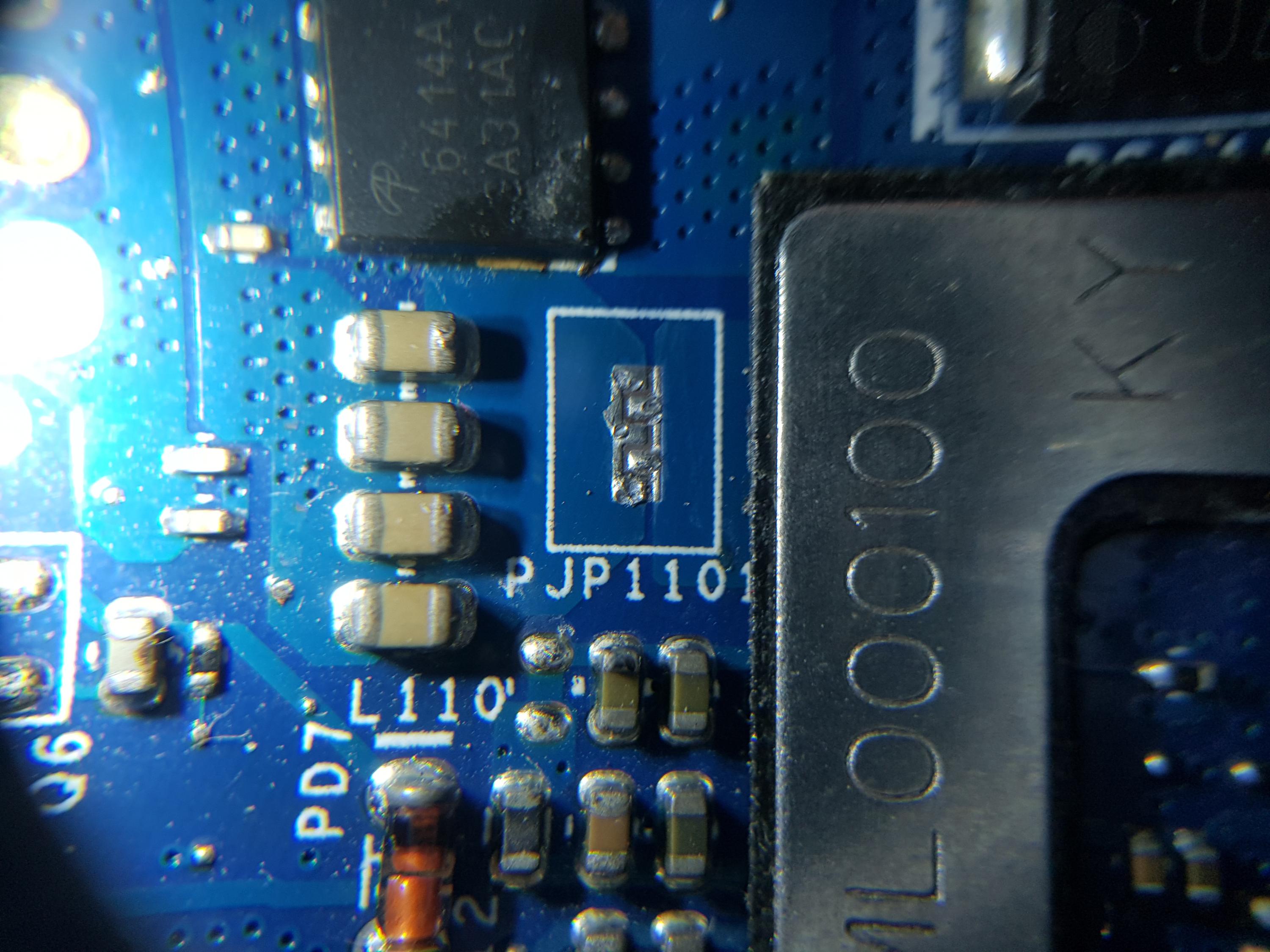

                              please take a photo of the other side of the board under PJP1101.

                                PJP1101 is under PQ603

                                  #176
                                  they are not found.
                                  Now, temporarily short the two sides of PJP1101 using a small wire and turn the laptop on.
                                  then measure voltage on all pins of PQ601.
                                  it is a bit risky. if it smells something burning, turn the laptop off.

                                    I've just looked at multiple pictures of this motherboard online and it looks like PJP1101 is Jumped in all the pictures.
