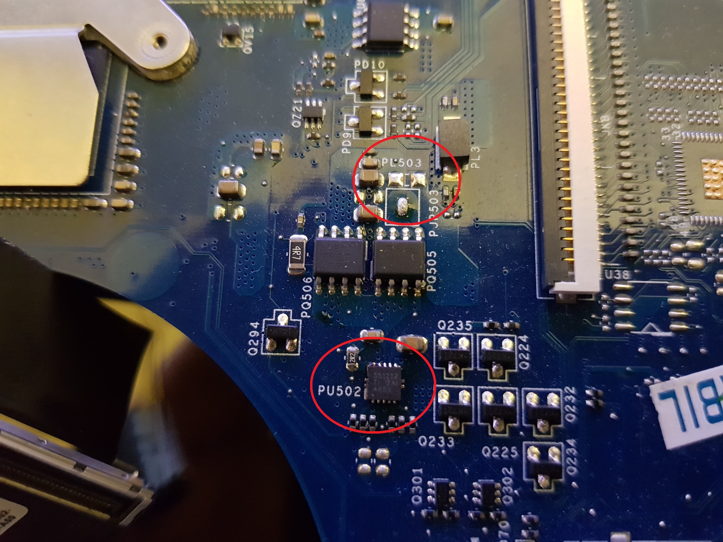

            now measure pin 1 and 3 and 7 of PU502 after turning on.
            in addition, the voltage on PL503.
              #86
              Re: Alienware M14x R2 with 7 beeps error
              PL503 has no component from factory.
              PU502 what is the pin order? second pic doesn't look too good or is it some sort of factory flux?
                #87
                instead of PL503, measure voltage on pins 5-8 of PQ505.
                yes, PU502 seems fluxy. anyway, please measure voltage on its pins 1 and 3 and 7 according to the attached picture.
                all the measurements are after turning on.
                  #88
                  why u are measuring pl503 and pu502?
                  pl503 get 18 volt for vram mosfet, and pq505 supply 1.5volt for vram.
                  if u disconnect pl503 pc works just fine with integrated intel video

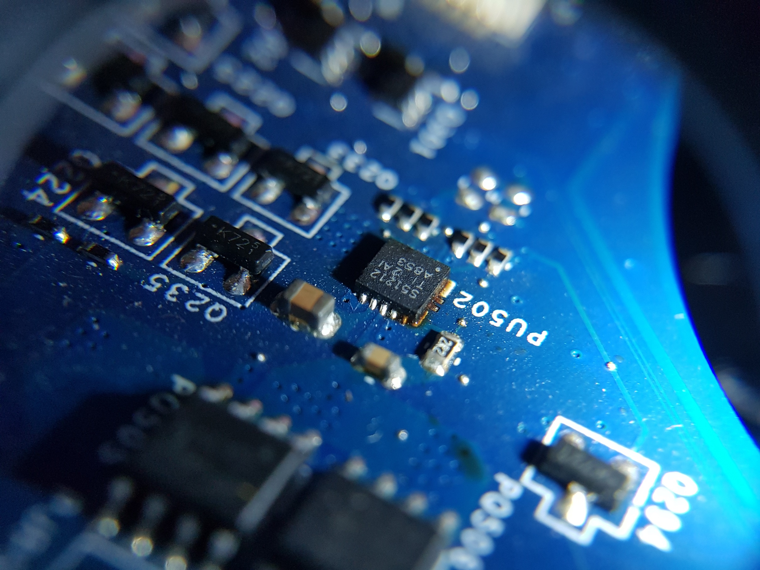

                    After mesuring PU502, I found puting a little presure on PU502 when booting would somtimes give:
                    1 beep, then 7 beeps repeat
                    2 beeps, then 7 beeps repeat
                    3 beeps, then 7 beeps repeat
                    4 beeps, then 7 beeps repeat
                    5 beeps, then 7 beeps repeat
                    6 beeps, then 7 beeps repeat
                    on multiple different boot tests.
                    PQ505
                    5 - 18.96V
                    6 - 18.96V
                    7 - 18.96V
                    8 - 18.96V
                    PU502 - pin layout as per your picture
                    1 - 24.2mV
                    2 - 0.0mV
                    3 - 13.1mV when not beeping, 13.4mV when beeping

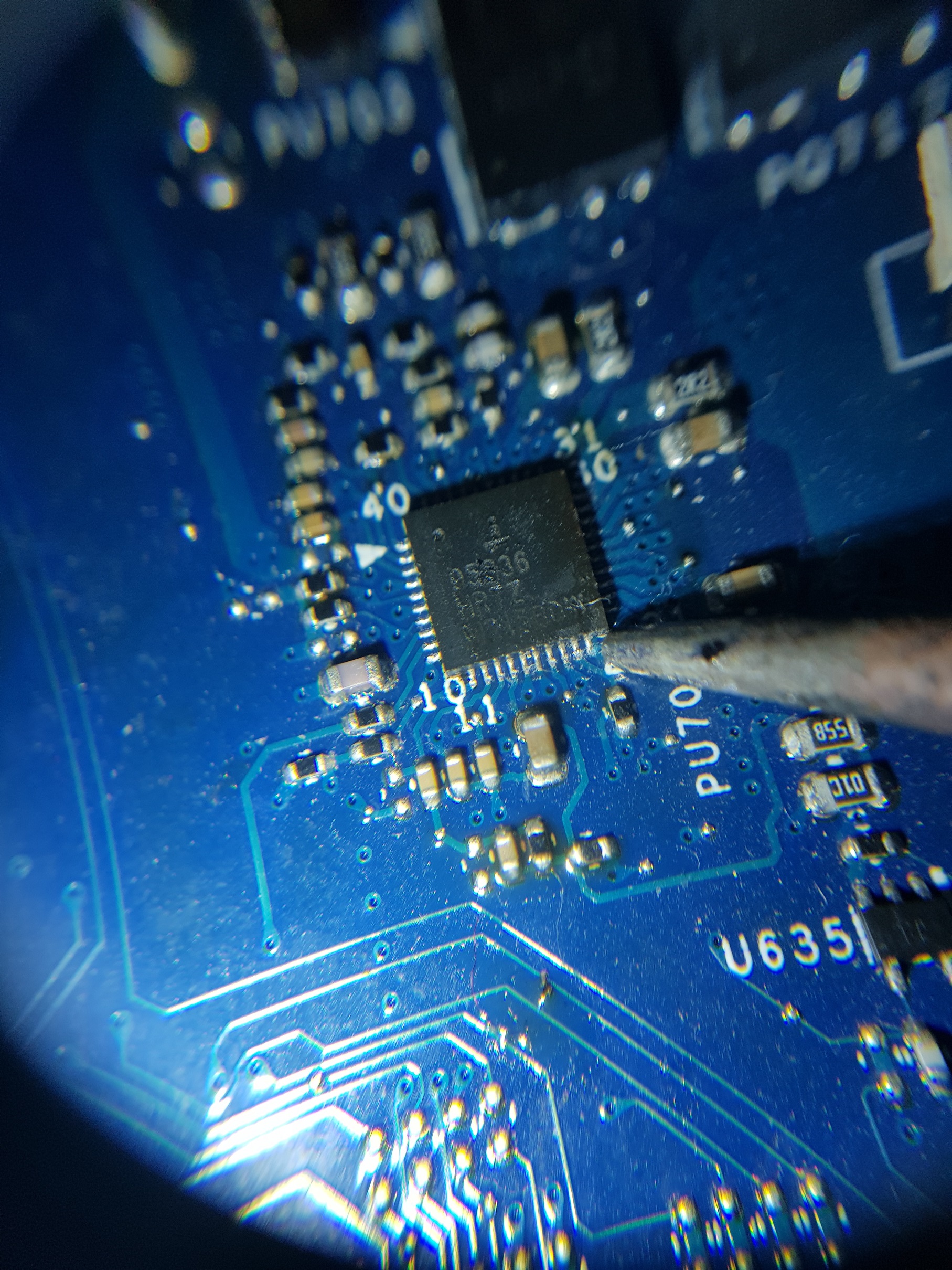

                    4 - 0.0mV
                    5 - 0.0mV
                    6 - 0.0mV
                    7 - 5.12V
                    8 - 0.0mV
                    9 - 0.0mV
                    10 - 4.90V

                          #92
                          now you did most the important tests and it is time to reach a conclusion.
                          the following voltages are missing on the board:
                          GPU_CORE, CPU_CORE, GFX_CORE, +1.5VSDGPUP
                          any advice and suggestions will be appreciated.

                                    #97
                                    your resistance measurements are OK and do not show any short.
                                    PU502 probably needs a reflow to get fixed that you can do it later.
                                    are you skilled in SMD soldering?
                                    It may be required that you replace PU701 later, but not now.
                                      #98
