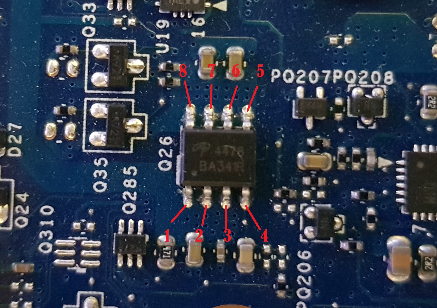

              My digital multimeter has a 4 digit display, when testing the PL703, PL704, and PL705 the display shows "000.9mV", is that 900 mili volts or 900 micro volts?
                Re: Alienware M14x R2 with 7 beeps error
                pin 25 and 26 of PU701 have got 2.5v whereas they are assumed to have 5v.
                please unplug the laptop and measure resistance between the following pairs of points:
                - between pin25 of PU701 and pin8 of Q26 (one probe on pin25 of PU701 and the other probe on pin8 of Q26)
                - between pin25 of PU701 and pin1 of Q26
                - between pin26 of PU701 and pin1 of Q26
                Then, turn the laptop on and measure voltage on the following points:
                - pin1 of Q26
                - pin8 of Q26

                  Resistance between pin 25 and pin 26 on pin 1 seems high, is the pin layout in the picture correct?
                  (PU701)pin25 on (Q26)pin8 - 4.72 k ohms
                  (PU701)pin25 on (Q26)pin1 - 1.1 ohms
                  (PU701)pin26 on (Q26)pin1 - 0.4 ohms
                  Q26
                  pin8 - 5.13V
                  pin1 - 2.574V when not beeping, flashes between 2.574V and around 2.501V when 7 beeps are sounding
                    these measurements show the +5VS voltage rail on the board is not correct. this can be the main cause of all the problems. so you need to do more measurements on +5VS.
                    first measure voltage on pin4 of Q26 after turning on.

                      Q26
                      pin 4 - 3.367V when not beeping, flashes between 3.367V and around 3.301V when 7 beeps are sounding
                        unfortunately, +5VS is connected to many components and tracing it takes many measurements.
                        to start, measure voltage on pin 1,2,6 of Q285 after turning on.

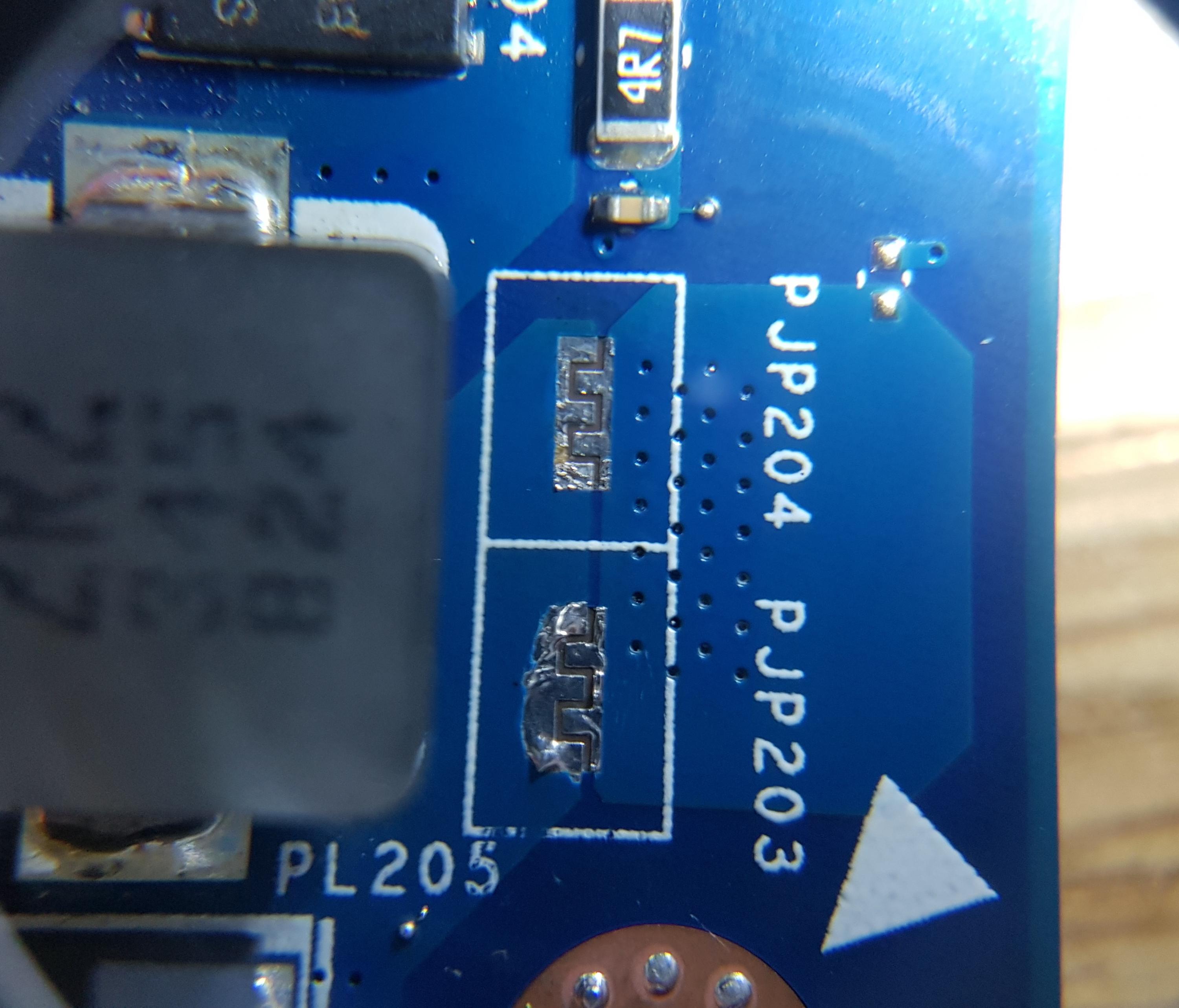

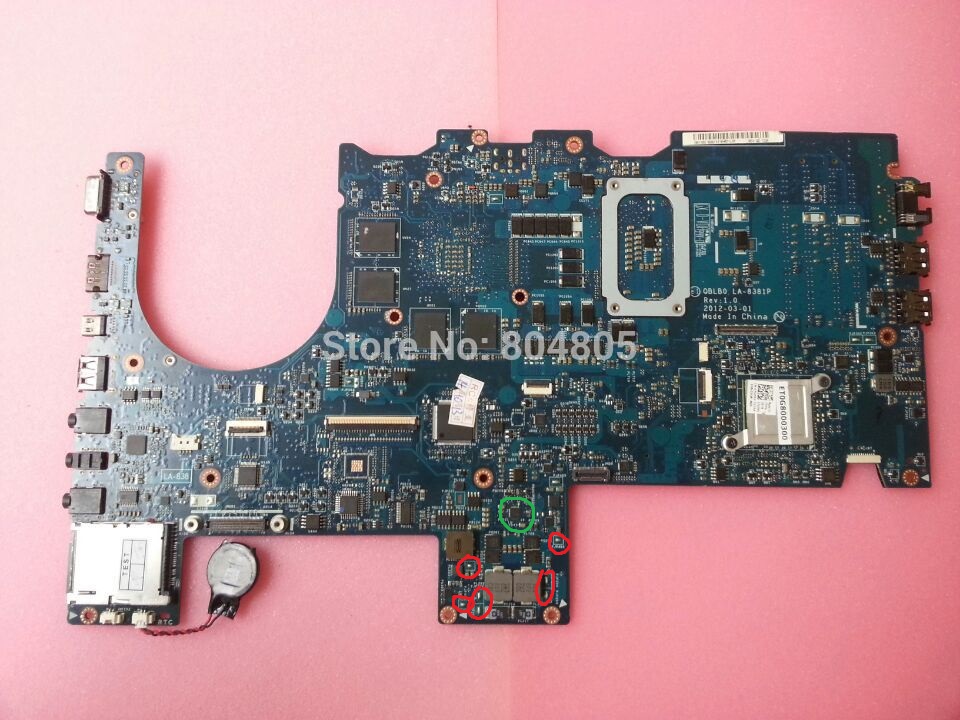

                                      remove solder on PJP203 or pjp204 located near 3.3 and 5 volts regulator in the lower part of mainboard (down from keyboard connector, in that extended part of mainboard)
                                      remove joint and measure if one side has 5 volt or 3.3 volt.
                                      as in the attached picture pjp should be one of the marked red, while the green is the 3.3 alws and 5 alws volt regulator.
                                        Do I have to remove both of them to test each side as they both connect to the same point? Like this?
                                          just measure voltage on each side separately.
