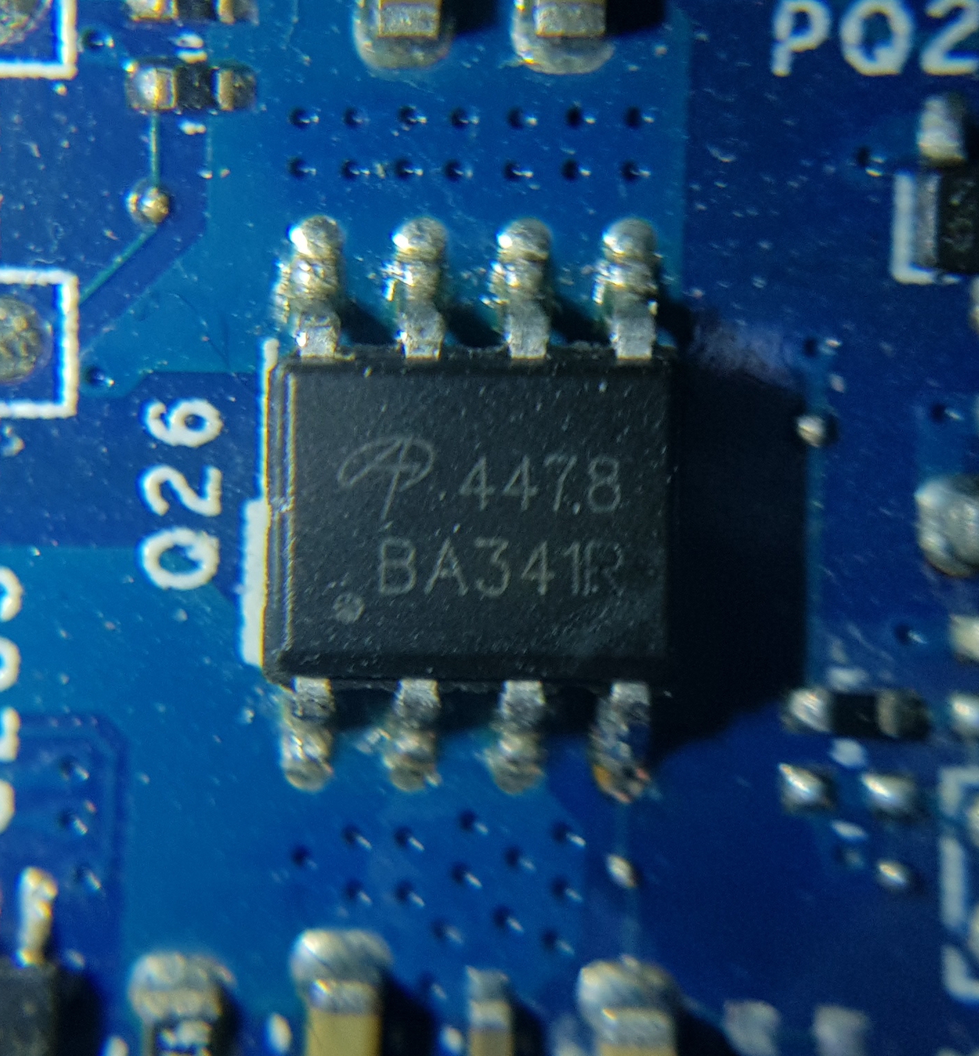

      when there was solder on them ( bridged) u got 5 volts ?
      if so:
      voltage on q26 pin 4 ?
      R270 is 102k ?

        5.12V when bridged.
        Q26 pin 4 is in post 110, will have to test R270 when I have some more free time.
          Re: Alienware M14x R2 with 7 beeps error
          r270 should be the one near pq206 mark. check value (without power ofcourse) and also voltage both side of that resistorwhen powered on.
            39.3 k ohms across R270
            37.4 k ohms pin1 to ground
            8.43 k ohms pin2 to ground
            R270
            pin1 - 18.97V
            pin2 - 3.373V when not beeping, flashes between 3.373V and around 3.295V when 7 beeps are sounding
                  as i said pin 4 of q26 is low. ih should be 17-18 volt like on q27.
                  2 reason: or r270 is bad or q26 is bad.
                  u can try:
                  1) replace r270 with 102k resistor
                  2) remove q26 and see if pin 4 get 17 volt and pin 1-2-3 get 5 volt.

                                    put back the old resistor and remove q26 and see if pin 4 get 17 volts after q26 is removed. if yes, replace q26.
                                      Good news, I asked a local micro solder repairer guy (that runs his business from home) if I could use his rework station free of charge and he said yes I could :-) I went there today, I replaced R270 properly with it's original resistor and removed Q26 from the board, pad 4 of Q26 now gets 18V as it should and R270 gets around 99k ohms across, now I have to find a replacement for Q26 and hopefully that will fix the +5VS line :-)

                                          Where can I buy a new replacement IC marked AO4478 BA341R, I don't have this one on any of my donor boards, they are different markings.
