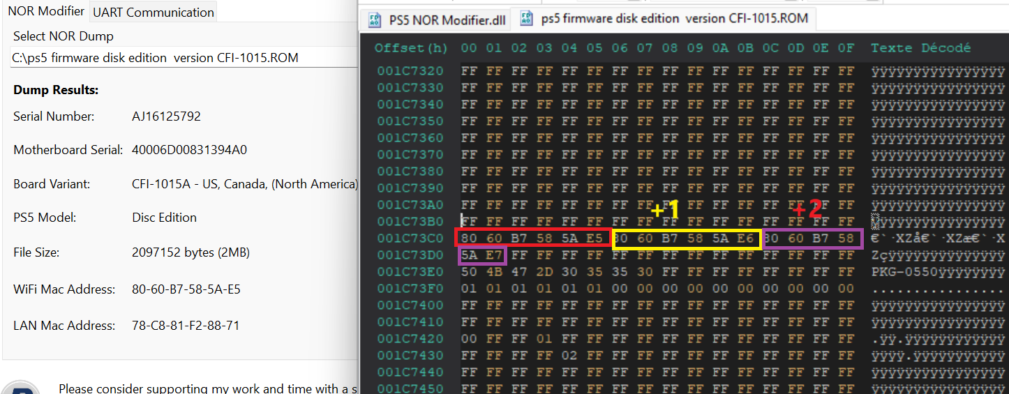

                              Originally posted by Cobbes
                              If you replace also the MAC for LAN and WiFi you get three beeps? Interesting.
                              For the WiFi Mac address, did you notice that it's written three times? With +1 and +2.
                              Click image for larger version  Name:	Nouveau Image bitmap (4).png Views:	0 Size:	375.4 KB ID:	3639083
                              Edit
                              Click image for larger version  Name:	image.png Views:	0 Size:	31.0 KB ID:	3639088

                                  #196
                                  Edit
                                  Ah!
                                  Yes I noticed that but I completely forgot about bluetooth! So it could be because a mismatch!?
                                  I'll try and let you know asap!

                                        #199
                                        Edit
                                        Fixed all the MACs but still three beeps. I gived up and keeped the old one from the dump. Console boot, goes online, joypad works, disc drive works.
                                        I noticed that WiFi MAC is still the original one and NOT that from the BIOS. Maybe it self-update by reading the chip infos?
