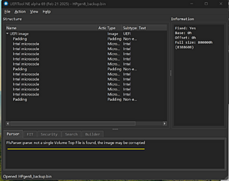

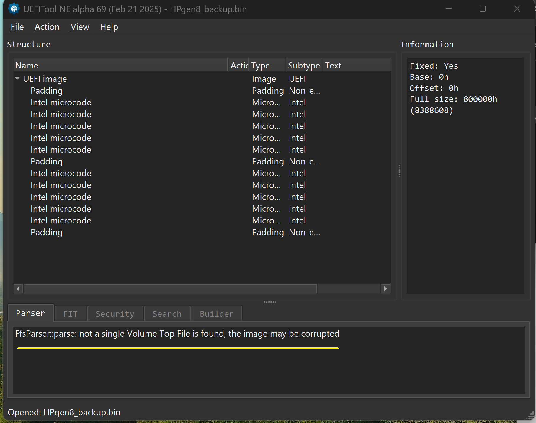

        I hope this works for my BIOS file that I took off the chip before I did anything:

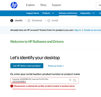

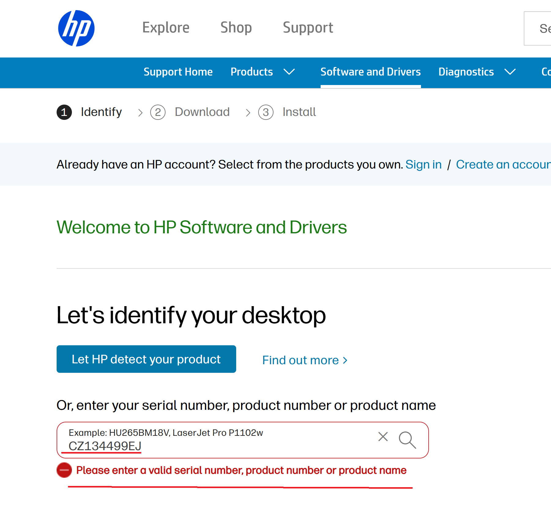

            • Ahari
              Ahari
              • Aug 2025
              • 10
              • South Africa
              Originally posted by hoaca388
              Your serial number ?
              I thought the serial number was one of those on the sticker. Do you mean the serial number of the box? If so, it is: CZ134499EJ
              I hope that is what you need?
              • hoaca388
                Badcaps
                • Jan 2022
                • 12206
                No hope
Name:	2025-08-14 12_51_29-Settings.png
Name:	2025-08-14 12_53_46-Official HP® Desktop Drivers and Software Download _ HP® Support.png
                • Ahari
                  Ahari
                  • Aug 2025
                  • 10
                  • South Africa
                  No hope
                  Okay, I think I see the problem. This is a microserver and the support page is on the HP Enterprise webite at support.hpe.com. The PID no is 712317-421 and the link: https://support.hpe.com/connect/s/se...erOfResults=25 will give you the search for this machine. The software updates are here: https://support.hpe.com/connect/s/pr...oftware&cep=on
                  I hope this helps. Thank you for your efforts.
                  • Ahari
                    Ahari
                    • Aug 2025
                    • 10
                    • South Africa
                    I have tried flashing all the BIOS available at the HP site, but have only had success in updating the iLO firmware. With the help of ChatGPT, I have tried all the methods for flashing the BIOS: USB stick, iLO firmware update, Cold boot method (holding the power button with the usb stick in specific port) with no luck. I have tried using dip switch 6. 1&6 as well as 1,5 &6 while trying to flash. I have also desoldered the chip and soldered it onto the programmer, which is where I got the BIOS bin file from. I have done the desoldering twice with different firmware. Nothing. ChatGPT says my BIOS is missing something that can only be replaced by getting hold of a full BIOS dump, which lead me here asking for help.
                    I really hope you experts can help me get this going...
