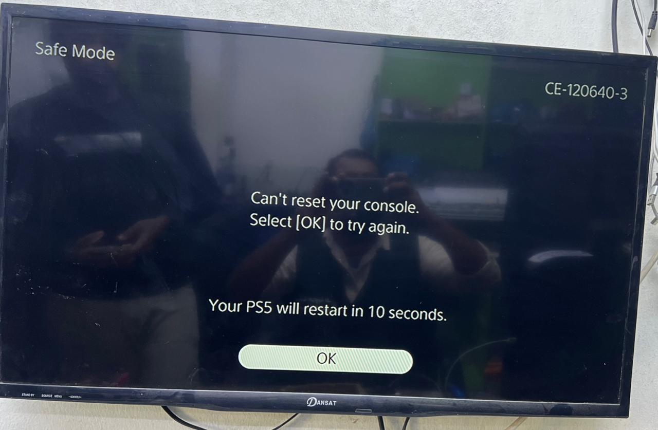

                    Still the same problem despite multiple attempt to fix the bios, impossible to play games that stops with error, reinstall the software in safe mode (CE120239-7 blocks at 29%) or via the error parameters here is the original dump that I reconstructed is what there is an error somewhere because after my PKG-3486 I have "y" and not the sequel as in other dump here is the file, EDM-041
