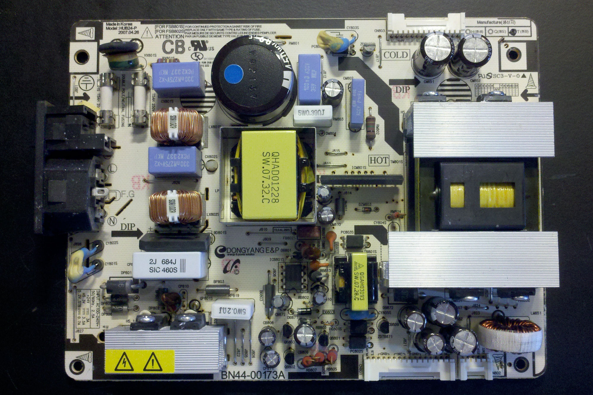

      Re: Samsung Syncmaster 245BW
      So I am prepared for next steps...

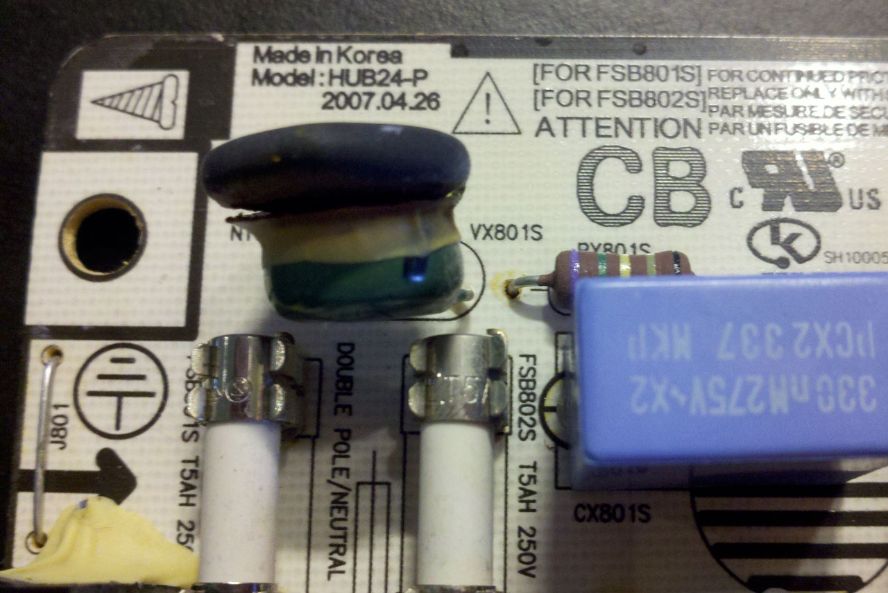

      There are currently no caps bulging on power supply board. I have ordered replacements for the three RB80# resistors, and hope to be able to test everything further once the power flows past the burned out RB805.
      There is a little scorching between the NT811S inrush limiter and the VX801S behind it. It could just be the inrush limiter has just baked the thermal glue that binds the two to a toasty brown.
      First question: do I need to re-glue the two inrush limiters to each other for thermal protection? I may just replace them, I think I have some from a Samsung power supply recap i did this spring.
      Second question: on the Samsung PS for my PowerMac I recapped this spring, I also ended up replacing several of the MOSFETs connected to the heat sinks. I think there has been some chatter about the 5-pin ICM852 being suspect in this thread. How do I test them for failure? Do they fail open or shorted?

        I let my edit window expire so I am adding to it here. Some other observations/measurements before I replace the burnt RB805 and its siblings:
        1. From post 276 in this thread, the voltage measured across CB876 is 5.15 - 5.29V, fluctuatiing relatively slowly
        2. From post 41, voltage between pins 7 and 8 on ICB801S is 11-16V, fluctuating fairly quickly.
        3. From post 45, votage between pins 8 and 23 is 168V, all other pairs are at or near 0V
        And I completely forgot to list my initial symptoms, start-up gets blue power on standby light and black screen from any video source. I am not suffering from a flickering display, it just didn't come back one day when it went to sleep.

          Wanted to come back and say a huge thanks here for the guidance. 5 minutes of time and we saved another monitor from hitting the trash heap....

            Hi. Just experienced the same thing with my "old" 245b. Having played with electronics since I was a kid, I have no problems opening up and checking around but I am no expert.
            Me not remembering the color codes, what replacement resistor do I need to get for the RB805, RB806 and RB807 (watts and ohms)? I have checked all RB807 shows 66.6, RB806 shows 68.0 and RB805 shows 500K ohm.
            So it should suffice to change that last one.

              I say you have several options:
              1. Google resistor color code
              2. Curse the instructor who failed to teach you Bad Boys Rape Our Young Girls But Viola Gives Willingly
              3. Recall that 68 is a standard resistance value.
              4. Search all instances of RB805, etc in this thread. One of them will have the value.

                Success! Replaced the RB80# resistors with a new trio of 5W 68Ohm ceramic monsters, and display fired right up. I would really like to know what fried the RB805 resistor in the first place, but who can tinker when there is a backlog of work to be done.

                  Congrats on the repair. I'm surprised that you were able to squeeze in 5W resistors. Since so many people have had problems with RB805, I would suspect that the original 68 ohm resistors barely met design specs at 1 Watt. And over time, constant overheating eventually caused the resistor to break down and fail. I personally would use a resistor rated at 2W as a replacement.

                    Replaced the RB508 with a 2W 68Ohm. Same size as the original one. Monitor works!

                              Another succes story by replacing most of Capacitors but The problem was due to CM802 (18nF 630V) bought from this guy in ebay (really great service and fast shipping) :
