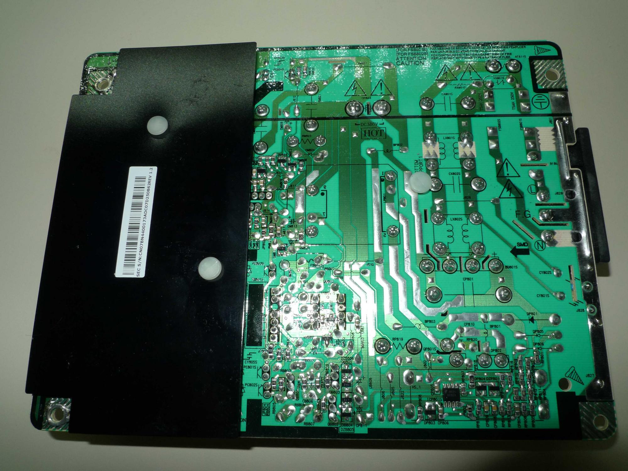

        Re: Samsung Syncmaster 245BW

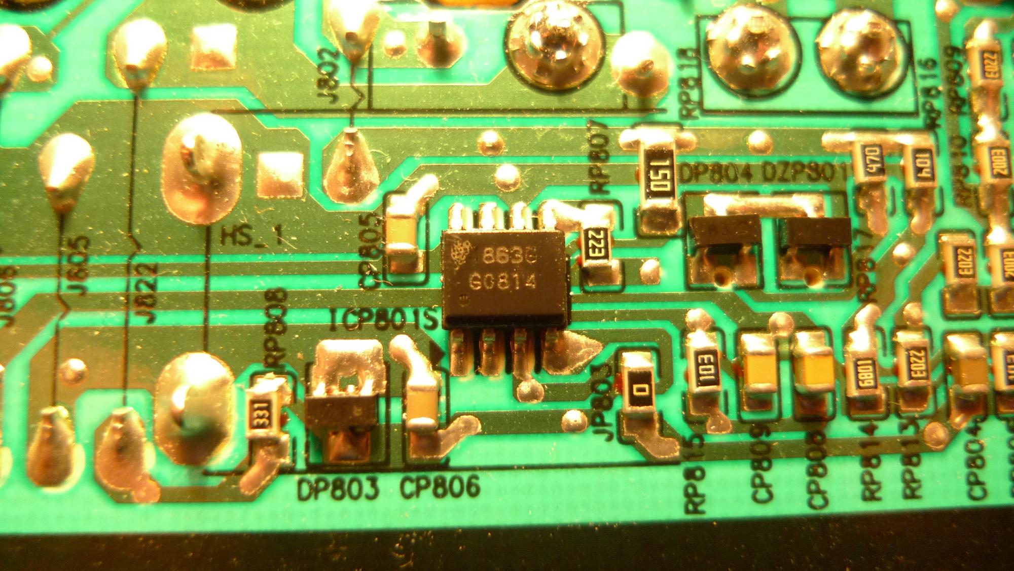

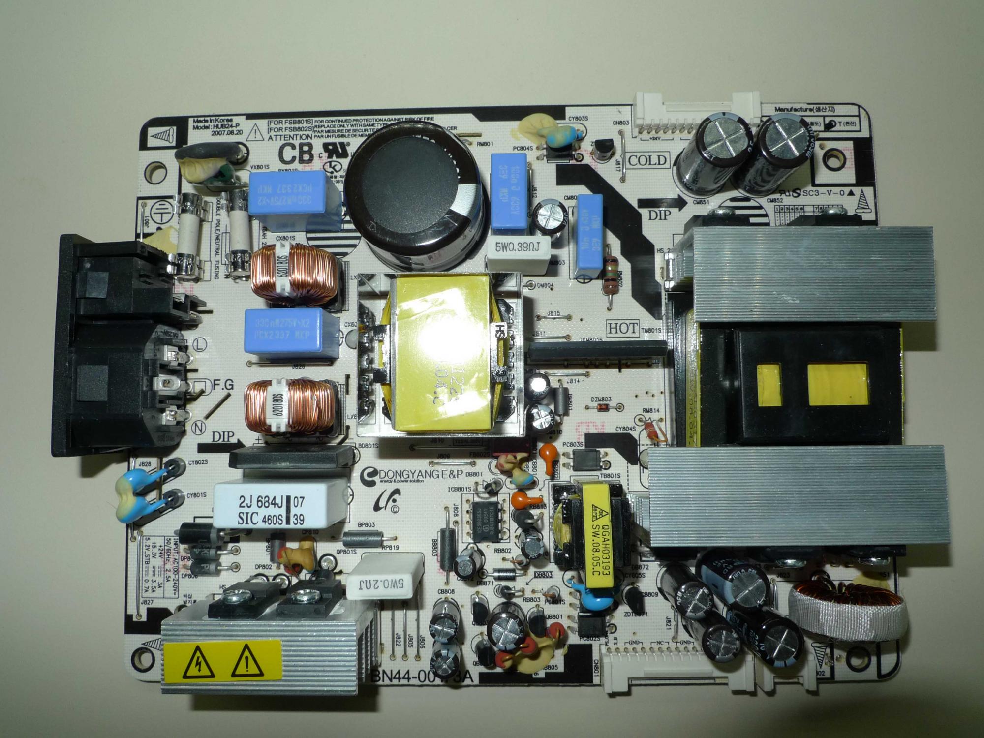

        Hello guys,
        After 18 months, my refurbished Syncmaster 245BW has died. Last month it would occasionally make a noise that was a single, fairly loud crack. This would repeat every once in a while, but hours apart. It had no apparent effect on the display. Then last week I started to notice a flickering in the intensity of the display. The flickering was in a pattern of wide horizontal bands several inches wide, which looked like it could be the back lights. The flickering was quite intermittent, but finally the screen simply went dark. I found several comments on the badcaps.net forums that encouraged me to take the display apart and look for bulged capacitors. I did not see any evidence of bulged tops on the caps and saw no evidence of leakage. With the power supply removed from the display I applied power and measured no voltage at the 24V or 5.3V output connectors. I verified that the power switch worked and the fuses were good. I flipped the power supply board over and found two points on the circuit board that were labeled “DC 380V”. These are the leads to a large (1.2” diameter, 0.7” tall) 82 uF bulk capacitor. When I measured across these two points my Fluke multimeter read 160 Vdc. Readings between these two points and ground were +55 Vdc and -55 Vdc. It was a great display, so I would really like to fix it.
        Does the power supply need to be hooked up to the rest of the circuitry in the display for the 24V or 5.3V outputs to come on?
        If the 82 uF bulk capacitor was good, would it read as low as 160V with no load attached?
        Thanks in advance for any insights you may be able to send my way.

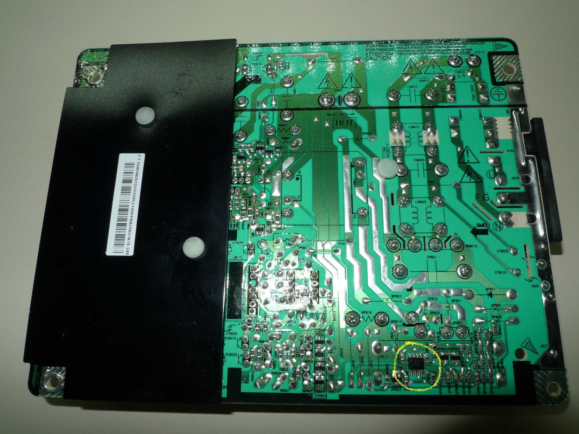

          If you're in the USA, the voltage across the 82uf cap will read between 160-165VDC.
          Some power supplies require that everything be connected before they will start up. Try this and measure again for the 5V & 24V.
          What is the part number of device circled in yellow?

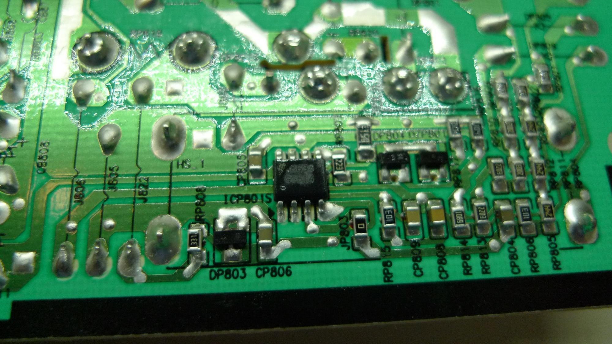

            jetadm123,
            Thanks for your reply. I am in the United States so I am applying 120Vac to the power supply.
            It is a bit difficult to plug all the circuits into the power supply and still be able to access it to make measurements, so I assumed that the inputs to the supply were more important than the 6 outputs to the back lights and only connected the inputs. I turned the power on and measured 24.4V and 5.4V on the power supply outputs. I also measured the 82uF cap again and now it read 390V. Attached are some pictures of the component you circled in yellow. I think the number on the component is 4863G G0814. In one of the pictures this component looks a bit CRISPY. With 24.4 V and 5.4 V on the outputs, I measured the voltages on the 8 pins of the component with respect to the ground buss on the input power side of the board. Voltages starting with the lower left pin in the picture and proceeding counter clockwise were -56v, -53v, -55v, -56v, -53v, -50v, -40v. Doesn't sound good.
            Several minutes later I measured the 24v and 5v outputs they both measured less than a volt. At that time I also measured the 82uF cap and it measured 160v.
            After several more minutes and a POR the 24.4v and 5.4v outputs were back and the 82 uF cap measured 390v again.
            Does this shed some light on the problem?
            If I need to replace the 4863G G0814, I will need a soldering iron with a small tip as well as a solder sucker.
              Datasheet is at
              http://pdf1.alldatasheet.com/datashe.../TDA4863G.html
              For the negative voltage readings, try using the negative lead on the main filter cap for ground. That should give you positive voltage readings.
                      Thanks for the the data sheet info. I used it to make some better measurements. These measurements are with respect to pin 6 which is grounded.
                      Pin 1 Vsense 2.49 v
                      Pin 2 AVout 2.60 v
                      Pin 3 Multin 0.81 v
                      Pin 4 Isense 0.013 v
                      Pin 5 Detin 1.89 v
                      Pin 6 Ground
                      Pin 7 Gtdrv 5.35 v
                      Pin 8 Vcc 15.09 v
                      When making these measurements, the 82 uF cap was at 390 v and the ouput voltages were present at 24.4 v and 5.4 v.
                      Does that make more sense?
                      Regards, DiyAlan

                        That means the power supply is working. Given the symptoms, you should be looking at the inverter. This is one reason I often ask for an over-all picture of the entire back of the monitor.

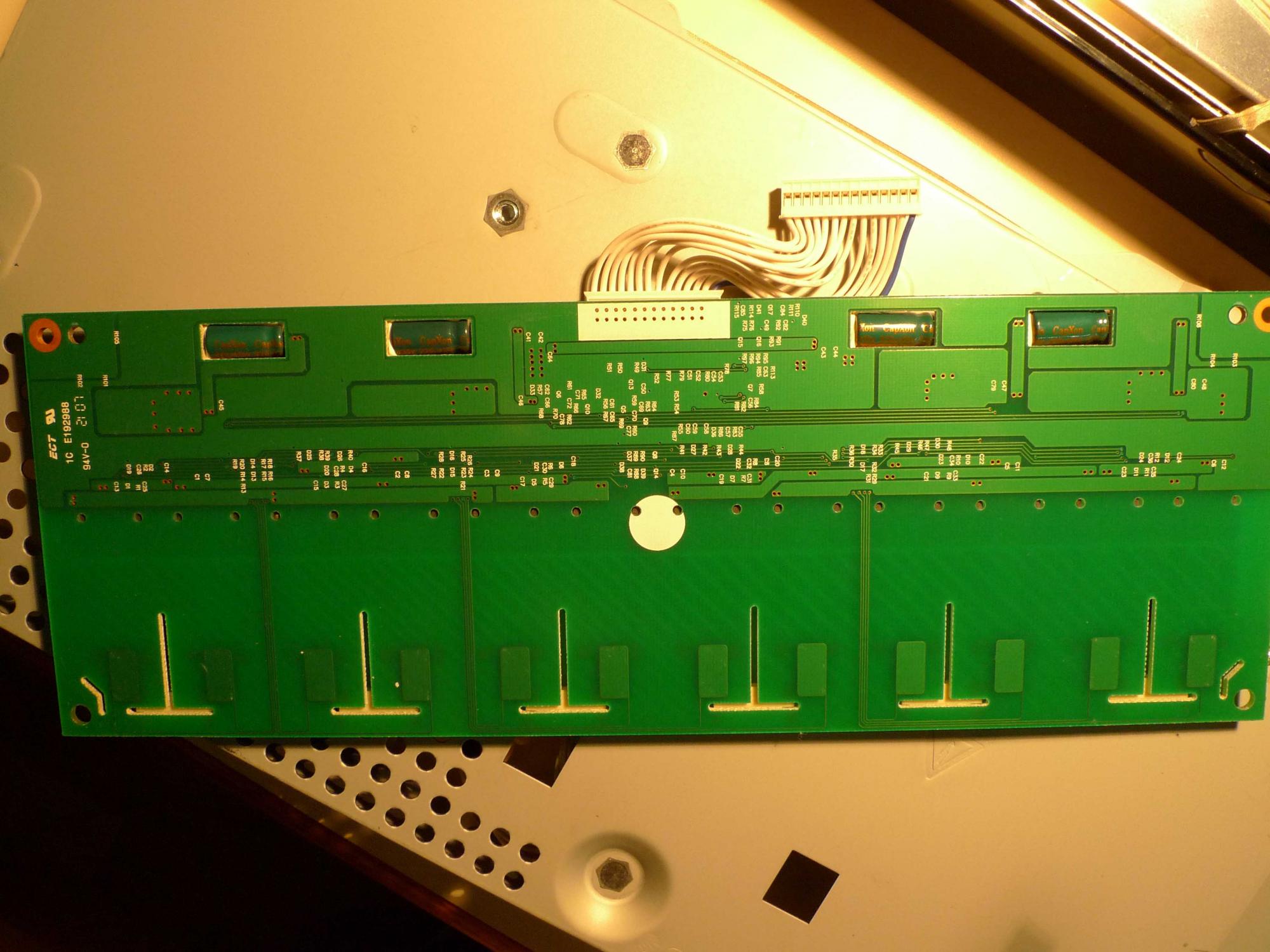

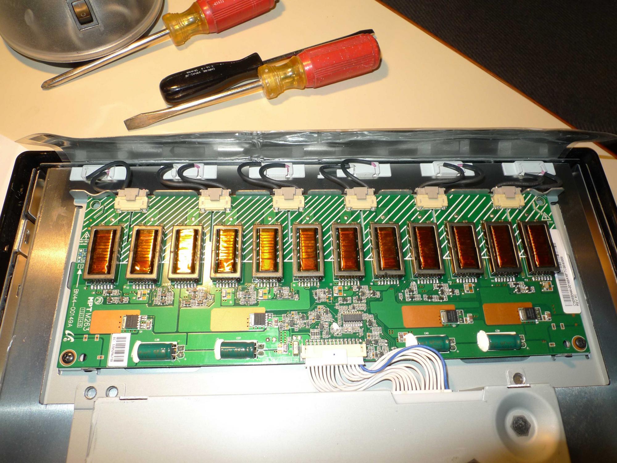

                          Earilier, you said that the 5V and 24V would drop to <1V after a few minutes. Is the output voltage still going off/on, or is it now steady output?
                          Please post a photo of the inverter assembly.
                          • DiyAlan
                            • Nov 2010
                            • 4
                            #193
                            Here are some pictures of the inverter when I took the display apart. At the time I noticed that the leads going to the top and bottom lamps were not positioned the same as the rest of the leads. I just put it back together with the lamps plugged in to the inverter. This time I moved the leads of the top and bottom lamps to be in positions that are more like the rest of the leads. The display is face down since I have not put the back of the case on, but it looks like all six lamps are on steady. It would be GREAT if that was all it took to fix the display !!!!!! ;-). From the front it looks mostly dark since there is no video signal driving the display. Is there a way to make the display go white without a video signal?
                            Are there any other things I should do to test it? Should I let it run for a while?
                            Thanks,
                            DiyAlan
