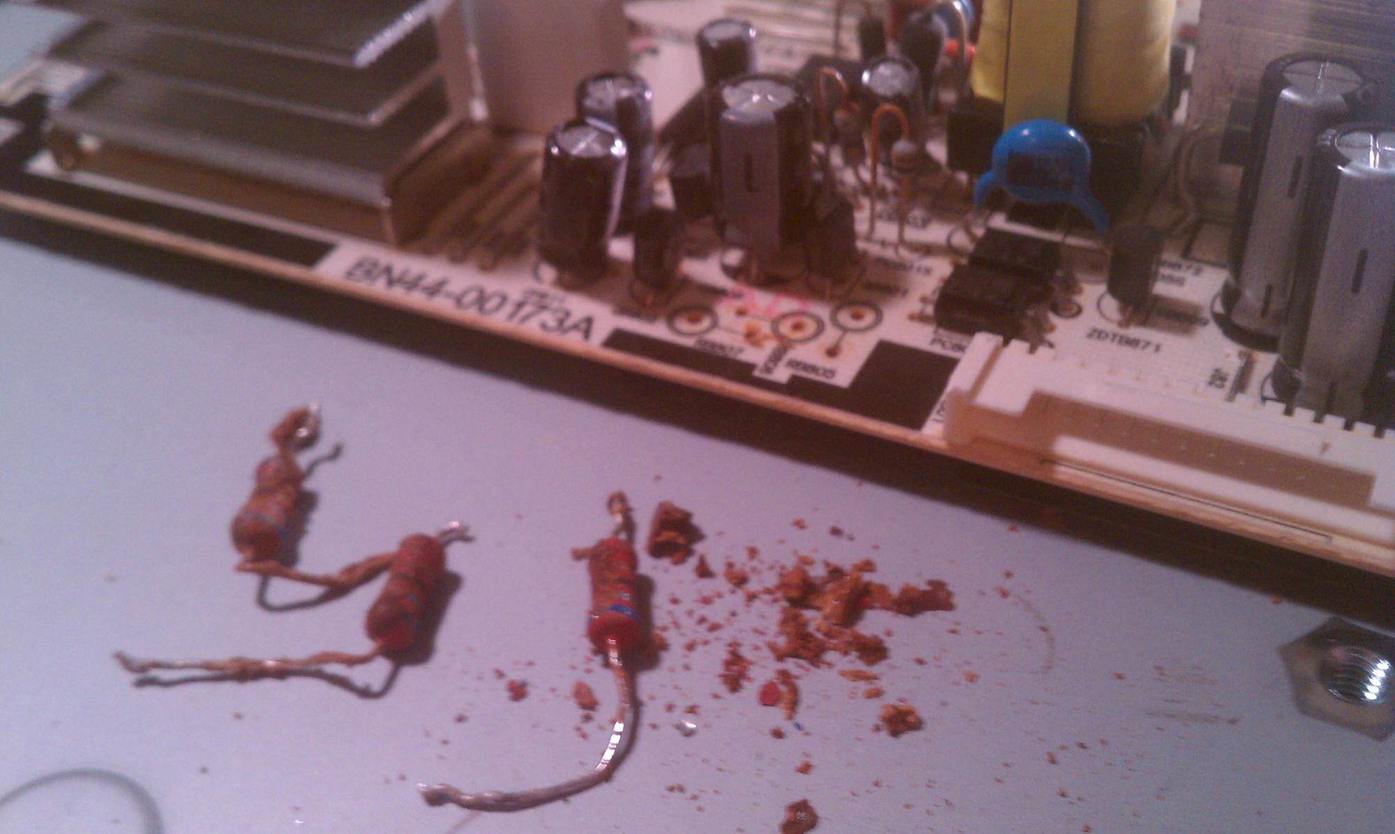

      This thread has been a great help. I found resistor RB805 bad on my monitor, like many here. I spent $1.13 in parts and I'm back in business.

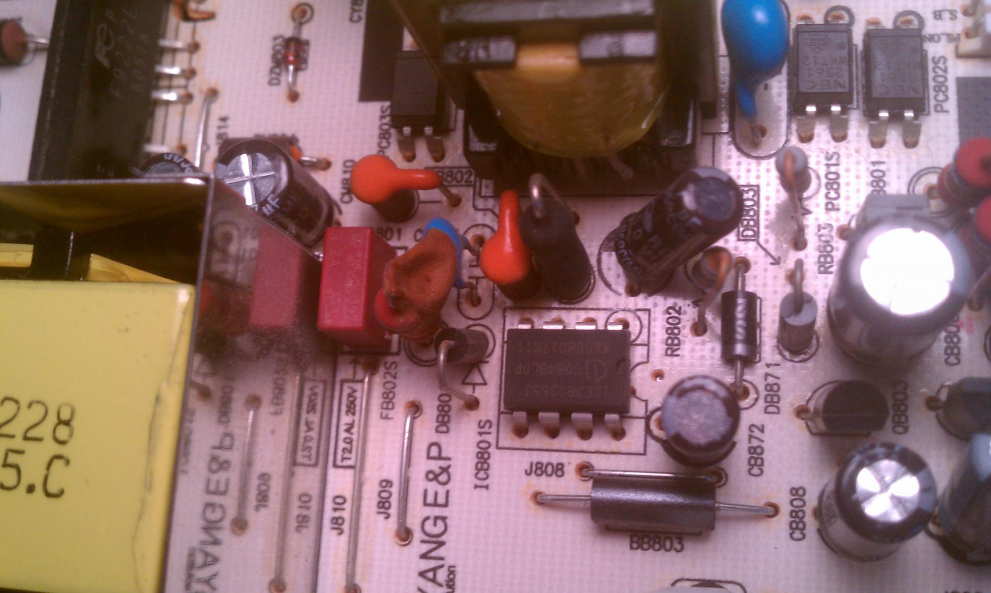

              #306
              Re: Samsung Syncmaster 245BW
              Originally posted by mfunke2601
              Yes, missing 24V. The voltages around the F9222L are the same as in your post. All looks fine, but there are no PWM oscillation! I used a 20nF or 22nF. I thick, this is not critical..
              I am also struggling to get my defective power supply BN44-00173A from my Samsung 245B back into life again. Mine also has the typical symptoms with a bright blue LED, but no screen.
              - The other day i already changed the RB805, which was about to fail. It already measured 180 ohm instead of 68. This is, as you all know, the first and easiest step to get your power supply back into work again. But unluckily, the screen stayed black.
              - Did a complete recap today, but that did not help. I measured the +24V rail, and it is as dead as before. Now i also want to go for the CM802.
              This is a MKP condensator with 0.018 uf and 630 V.
              As i see, you are also from Germany. I looked in several stores like www.conrad.de or www.reichelt.de or www.buerklin.de , but they all offer either the 0.015 uf or 0.022 uf version. No 0.018 uf there. The factory that produces them is named WIMA.
              Then i found an offer in Ebay by a greek electronics shop, that sells the 0.018 uf / 630V version of that capacitor. But not as MKP version, instead it is an FKP-1. I already ordered one. FKP-1 is said to be better, when there are high amplitude differences, e. g. in oscilloscopes and so on. The price for a FKP-version is also significantly higher than for the MKP version?
              Okay, just two questions:
              (1) Can i also use that FKP-1 version? Or is it better to use a 0.022 uf MKP version?
              (2) mfunke2601, does your Samsung TFT still work after those few months with the new 0.022 uf capacitor?

                    #309
                    Okay the new capacitor arrived. I soldered it in, and tada - the 245B works again!
                    Regrettably the part was bigger than the original capacitor, so i had to enlengthen the legs a bit.

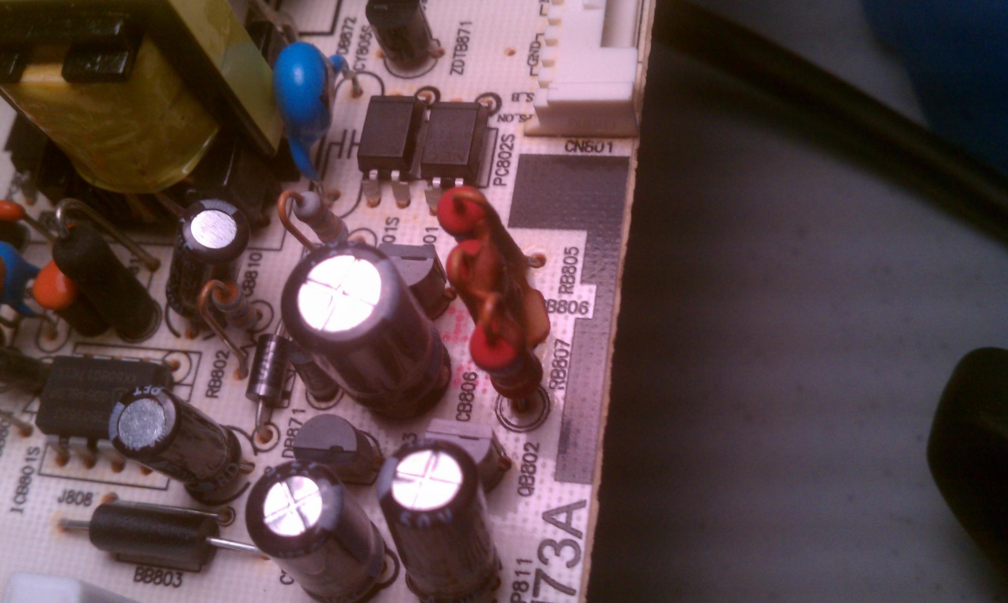

                        Actually to answer my own question, I found that the evil B805 was dead... off to Fry's to grab a replacement!

                            #313
                            OMG you guys RULE! Thanks so much for the contributors to this thread! I replaced those three (only one was bad, but the others looked ugly) and am good to go!!! $0.95! I think I spent more in gas on my round trip to Fry's!
                            Here's a couple of pics. Thanks again so much!!! I am a happy camper!
