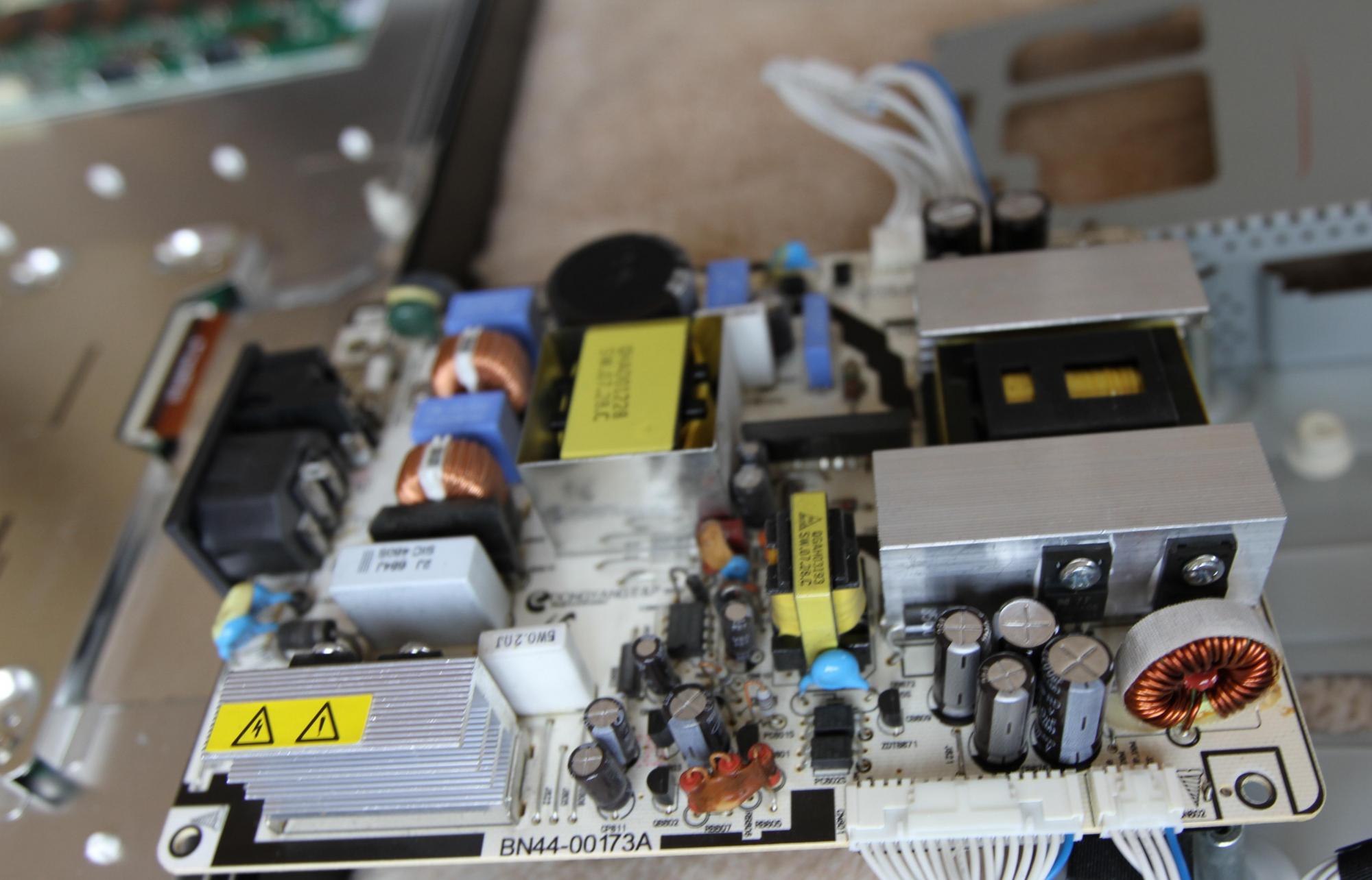

                      I took a photo before rebuilding it. unfortunately I haven't got a perfect picture of the BN but reads like BN44-00173A, whereby the 4-00173A is readable, ( the 00 and 3A in this string are clearly visible)

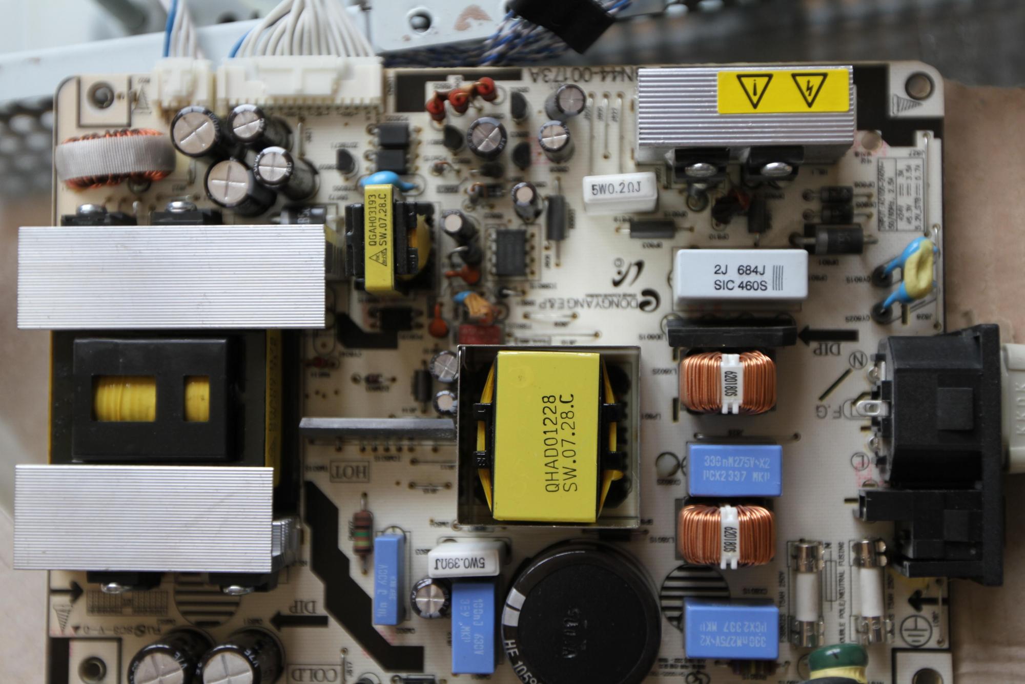

                                  Thanks for all the suggestions. Note the monitor works but just makes this annoying fan type noise
                                  I opened up box again, took a number of pictures, and got it up and working with the whole thing dismantled. We took a cardboard tube and listed. 2 of us couldn't really locate the noise, only generally. Using a a doctors stethoscope we concurred that it seems to be the white "2J 6843, SIC 460S (on the board is written CP801)" but we could have been mistaken and our next bet was one of the blue units in the direction of the fuses
                                  written on the S/n sticker is written Rev 1.1, BN44-00173A. and I attach pictures.
                                  I should try just replacing the 3resistors first I assume rather than all the potential damaged parts. 68 ohm 2watt (or 5 watt)

                                      All three of the components you identified is a capacitor, but they are not electrolytic caps, and are much less likely to fail.
                                      I can do a tentative identification of them.
                                      The white one is a .68uF film cap; I'd guess that the voltage would be 450 volts. A POSSIBLE replacement would be a Panasonic ECW-F2W684JA, Digikey P14204-ND at $.96.
                                      The blue ones are .33uF, 275VAC EMI suppression caps. A possible replacement would be Panasonic ECQ-U2A334ML, Digikey P10733-ND at $.57.
                                      In each case, additional information would be desirable before ordering. The lead spacing is critical, and it would be very nice to know the voltage rating of CP801 (it may be printed on the side).
                                      The three 68 ohm resistors are another issue. They are a common failure on this power supply. If one of them goes open, the supply won't work. I'd agree that replacing them would be a good idea, even though it won't help with the noise problem.
                                      I should note that while it is possible to positively identify proper replacement for the suspect parts, they are only suspect - there is an excellent chance that none of them are the source of the noise.

                                        @ danweil -
                                        Above the white capacitor you identified, mounted on the aluminum heatsink with the 's on it, are the main switchers for this unit. On the legs of them are ferrite beads. While the unit is running, use a plastic or wooden stick to touch those beads one at a time and see if the noise goes away. The goop that the factory uses may have dried up allowing them to vibrate.
                                        The 10x a second sound does seem to me that the startup caps are beginning to fail however. Before you put it back together, I would invest in the repair kit mentioned, and recap that board. Like changing the tires before they've lost all their tread and now you're on the rainy highway trying to stop...
