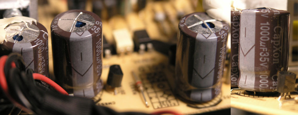

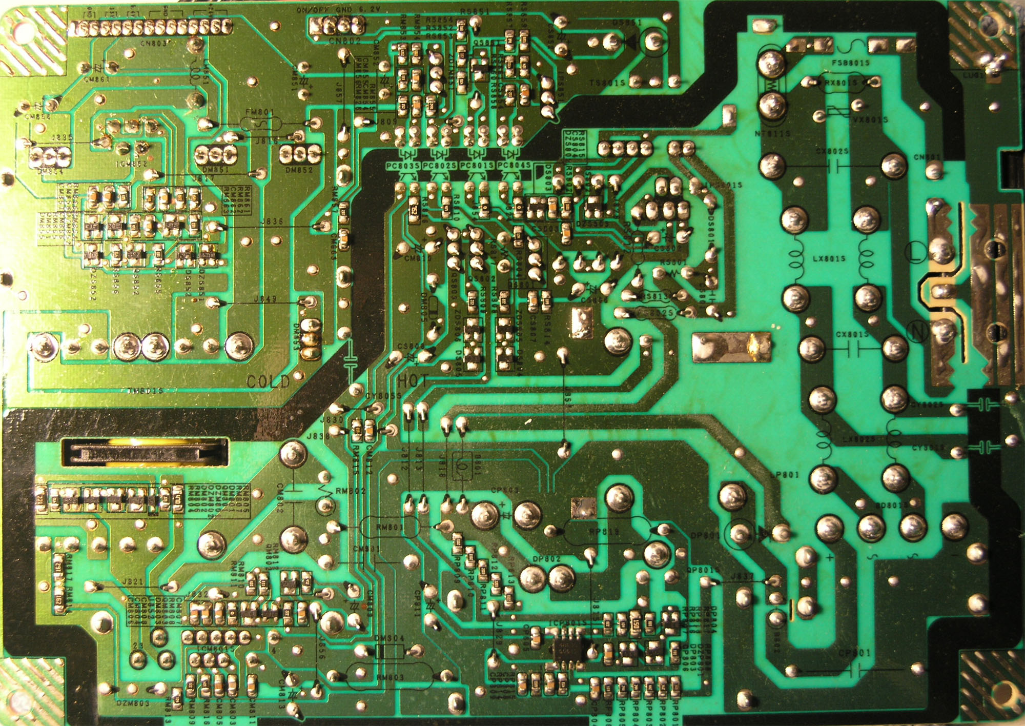

        I've got a syncmaster 244t, mostly the same as 245bw, but PVA panel instead of TN and 2006 instead of 2007. No threads on it, but let me know if I should give this its own post.
        Symptoms are just like the others, power light blinks but the screen stays dark. So I pulled 'er open, and I've got what are probably a couple of bad caps (pic 1). BUT, the voltages all read correct when the logic board is hooked up: does that mean the power supply isn't the problem? The caps look borderline to me, so I'm hoping more expert eyes can tell me what I've got here.

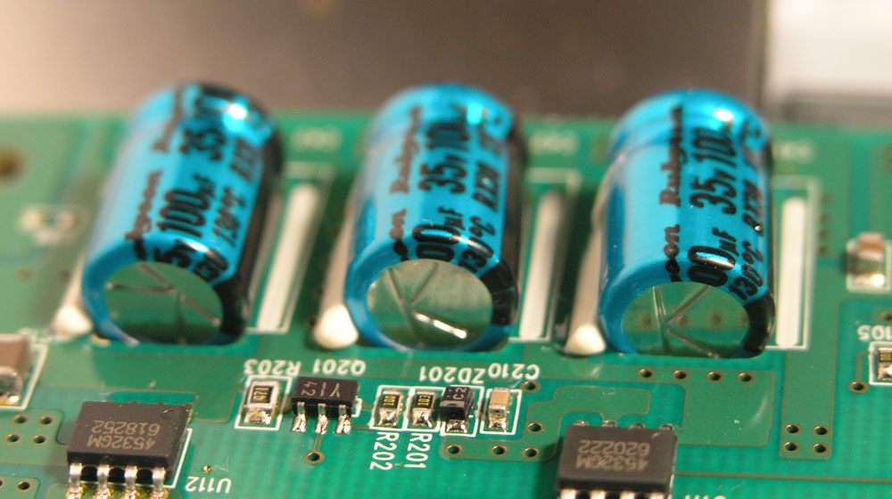

        All fuses are good, nothing looks toasted, and the CCFL inverter uses undamaged-looking Rubycon caps (pic 2) so I'm assuming that's not the problem.
        I've included some additional pictures in case that helps with diagnosis. Thanks to anyone that helps out!
          You definitely have 3 bad caps. These caps are listed at 1000uF 35V so they are probably providing power to the inverter section of the board. I guess "technically", you could consider these caps not part of the power supply.
          Replace those caps for sure and retest. Most here will suggest that you replace all the caps on the power/inverter board regardless if they are bloated or not. Caps do not need to be bloated to be bad. They can be out of uF spec, dried out, or have high ESR (ohms).
          The Rubycon's look okay.

          edit: Capxon has a poor reputation for quality. Some members replace Capxon on sight.

            A few things:
            1) when you say the voltages are correct, what values are you seeing?

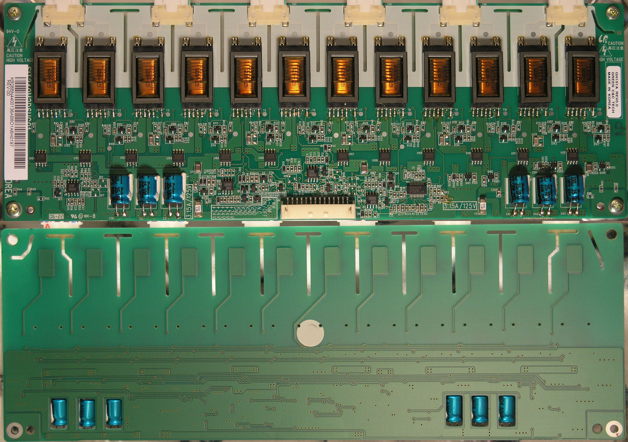

            2) can you please post a photo of the entire inverter board?
              Re: Samsung Syncmaster 245BW

                      Okay then, I haven't hit the purchase button yet so I'll skip the big cap. I figured I'd leave the inverter board alone, since those fancy teal Rubycons show no signs of failure. I took some inverter board pics for jetadm, though hopefully I won't need to do anything with that.
                      I've only got an old-school analog multimeter to test with, but the 5.4 V, 6.2 V, 13 V, and 24 V rails are all running at as close to nominal values as I could measure.

                            Really nice photo of the inverter. It also wouldn't hurt if you were to check the fuse on the inverter board. It's the small white rectangular device at the bottom of the board to the left of the 3 blue caps, marked 3.15A/125V.

                              and jetadm, I tested the inverter board's fuses earlier and they were good. It's looking like the only thing wrong with the monitor is ten bucks in caps!

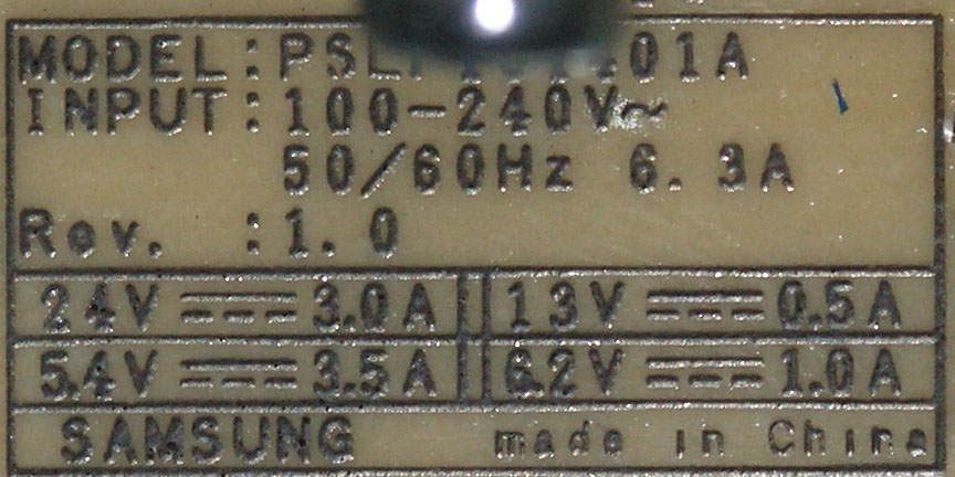

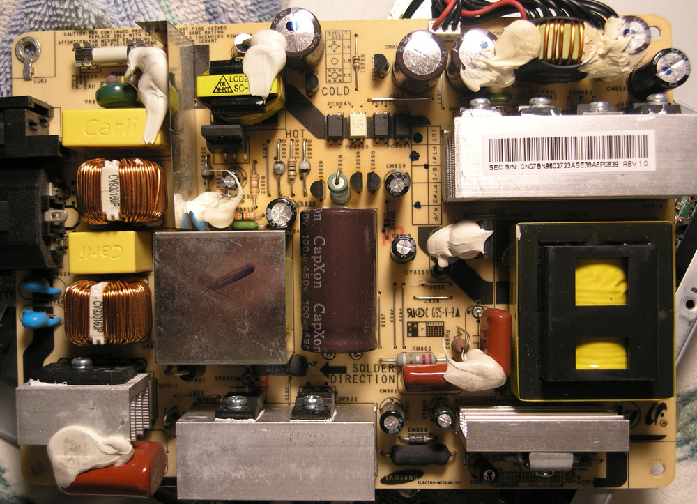

                                  Maybe the 244t has strange, extra v-outs because it's a PVA panel instead of TN? I've attached a closeup of the specifications printed on the board. It's also labeled in the picture of the traces on the back of the board, along the top edge. It's the only output that works without the logic board connected, so it may be for some always-on feature like the standby LED.
                                  I do need a new multimeter though; it'd be instructive to know whether voltages are really changing or if it's just my tools.
                                    Thanks for the picture. Never seen 5.4V and 6.2VDC, but there it is. Sounds like your meter is working fine.
                                    Anyway, change the caps and go from there.
