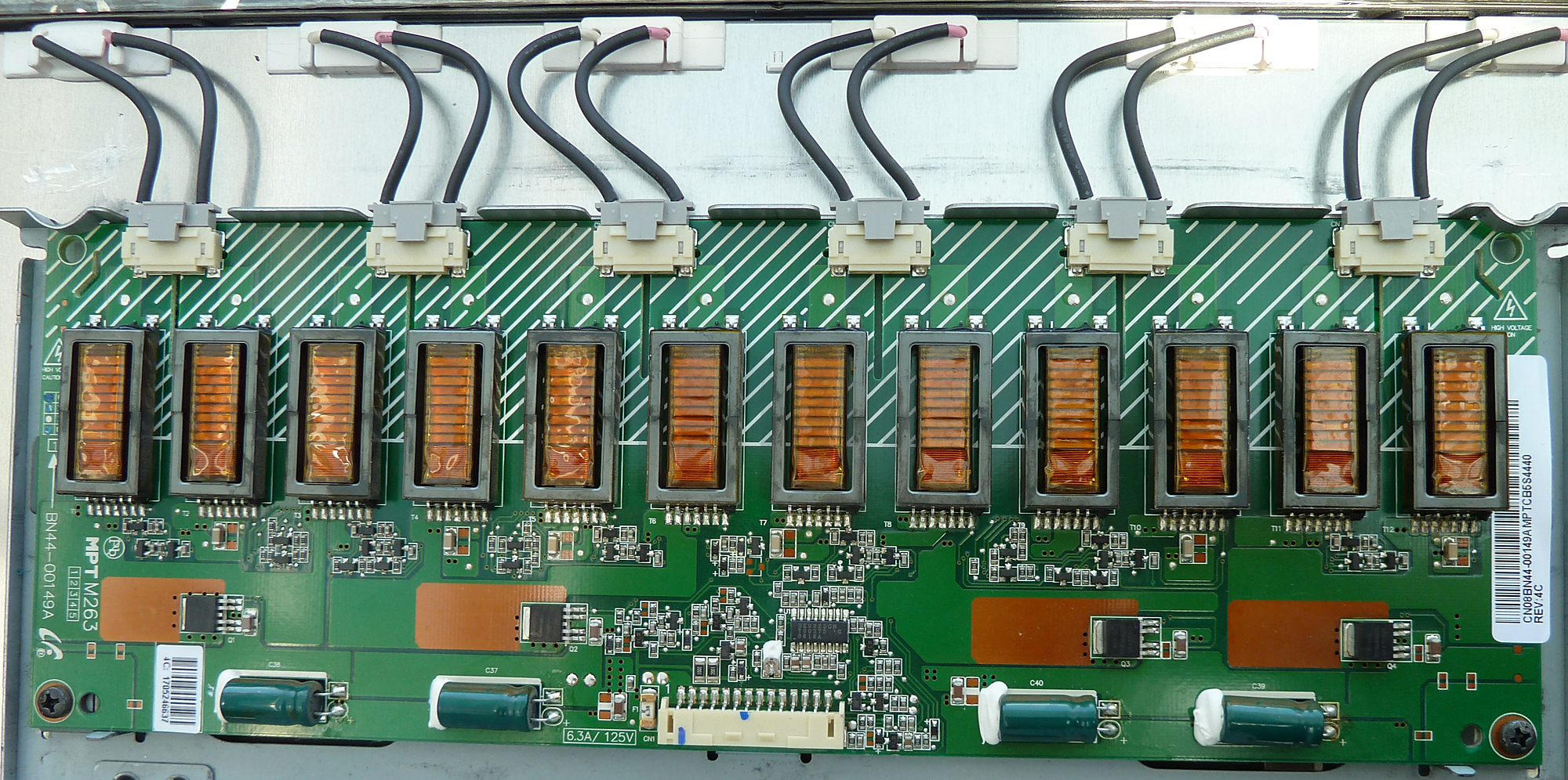

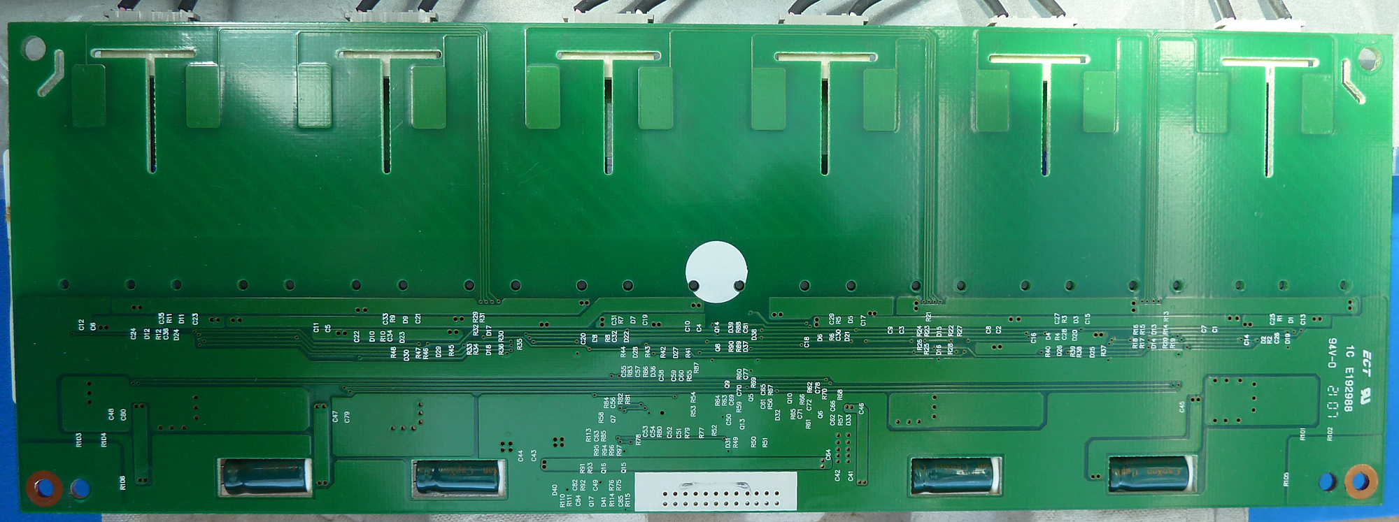

        Ok, here are the photos of the Inverter board, per RetiredCaps request.
        I don't see any 3-pin mosfets on this, but there were 4 mosfet-like items that had 4 pins. I tried testing them on the multimeter in various pin configurations, but got no readings.
        Regarding fuses, I did see a small item that could be a micro fuse (very tiny, copper looking ends, small white body), near the connector pin.
        Tested it on the multimeter and got a 0.2 ohm reading, indicating that the fuse is ok, right?
        Thanks!

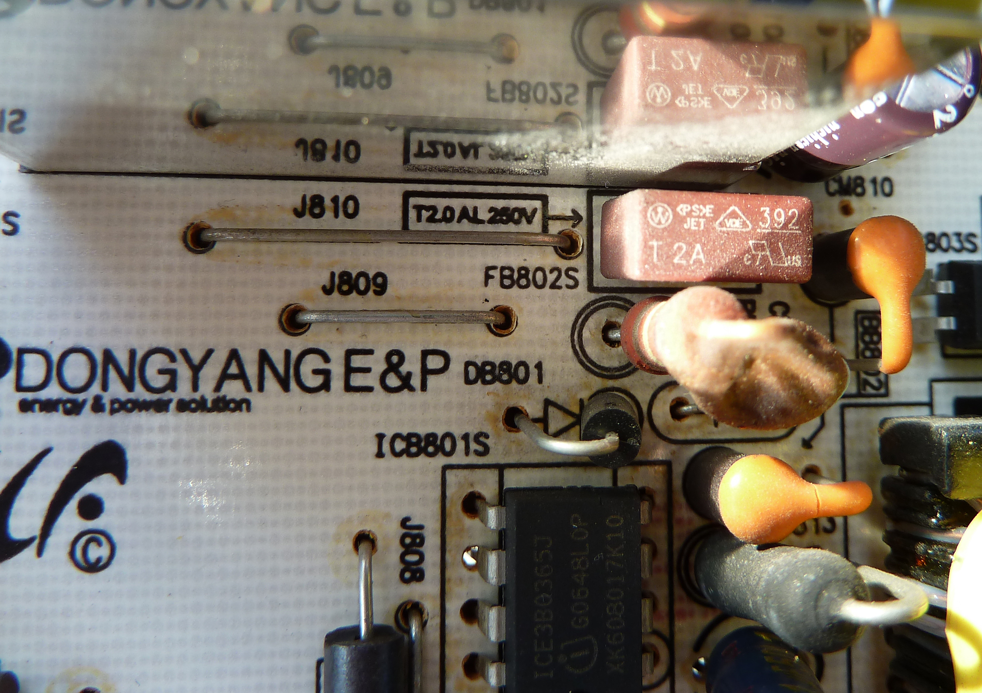

          Originally posted by selldoor
          Suggest you remove the glue from other components if it touches conductive parts - near cp810 and DB801
          There is also another fuse on this board you can test at FB802S just about dead centre of the board.
          - Glue removed. Nasty stuff, that red glue.
          - I saw a red rectangular block there (photo attached). Didn't look like a fuse, but I turned the board over and tested with the multimeter.....got a 0.2 ohm reading, which should be ok, right?
          Thanks for your help!

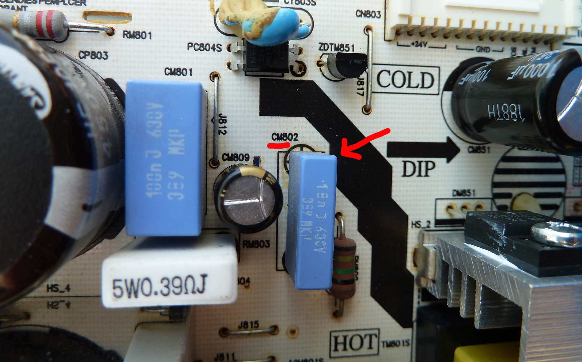

            Okay, replacing the resistors was a step in the right direction. If you have verified that you're not getting the 24V output, which powers the inverter board, then the second most common failure of this board is capacitor CM802. It's rated at 18nf 650V.
            Here is a photo of the CM802 I could find (the blue chiclet). It looks to be marked 630V.
            Is this the one? Doesn't look like a regular capacitor.........and where would I get this one?
            Thanks!
              See (where I get schooled by PlainBill )
              https://www.badcaps.net/forum/showth...ighlight=CM802

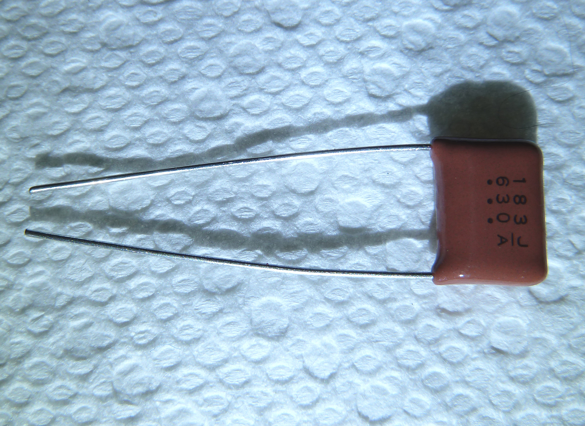

                              Ok, so I got the CM802 Replacement from Digikey (a part referenced by PlainBill in another part of the thread) here:
                              http://search.digikey.com/us/en/prod...550-ND/2567798
                              It is a Panasonic part, but looks quite a bit smaller than the blue chiclet cap it is replacing. The other issue is that there appear to be no polarity markings on this new one, nor on the blue original (both pictured), nor on the board itself.
                              The photo of my new cap (reddish brown) only has text on one side, and no other markings, and the wire legs are both the same length.
                              I'm assuming for this particular kind of Cap, polarity does NOT matter?

                                #495
                                Re: Samsung Syncmaster 245BW
                                Thanks!
                                N~
                                Correct. Polarity does not matter.

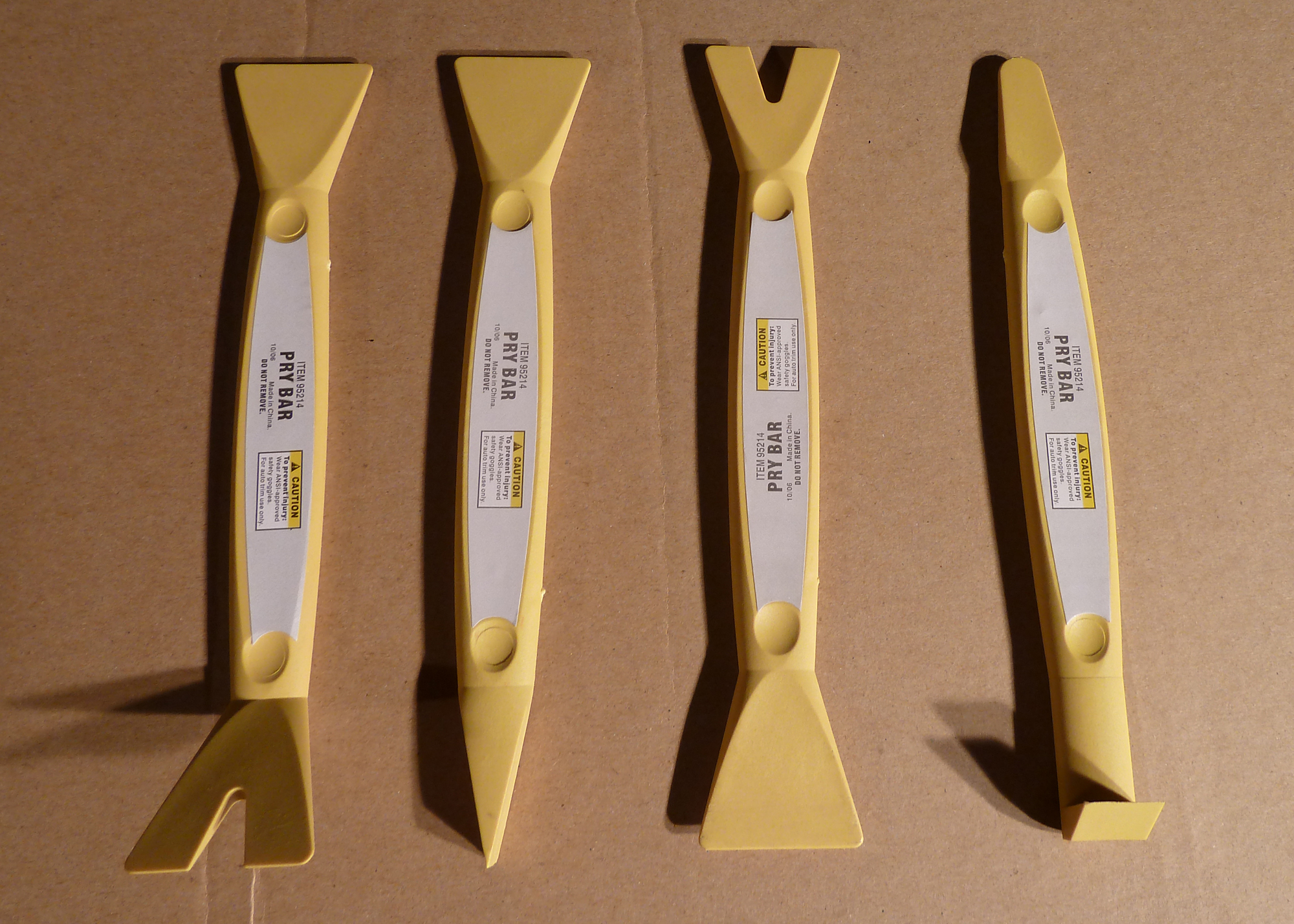

                                    1) Taking the rear plastic panel off the monitor is a challenge, as the panel is "snapped" in via plastic tabs. I ended up using a set of nylon-style pry bars that I found at Harbor Freight (a U.S. tool chain that specializes in low cost tools). These nylon pry bars are mainly for use by the automotive trade (stereo installers, especially) to pry off and remove door panels on cars. They worked fantastically to pop the tabs on the monitor panel, and also acted as wedges while I worked my way around the back panel popping more tabs. I had absolutely no damage to the panel. (tool photo attached).
                                    They run a mere $5.99, and can also be ordered online.

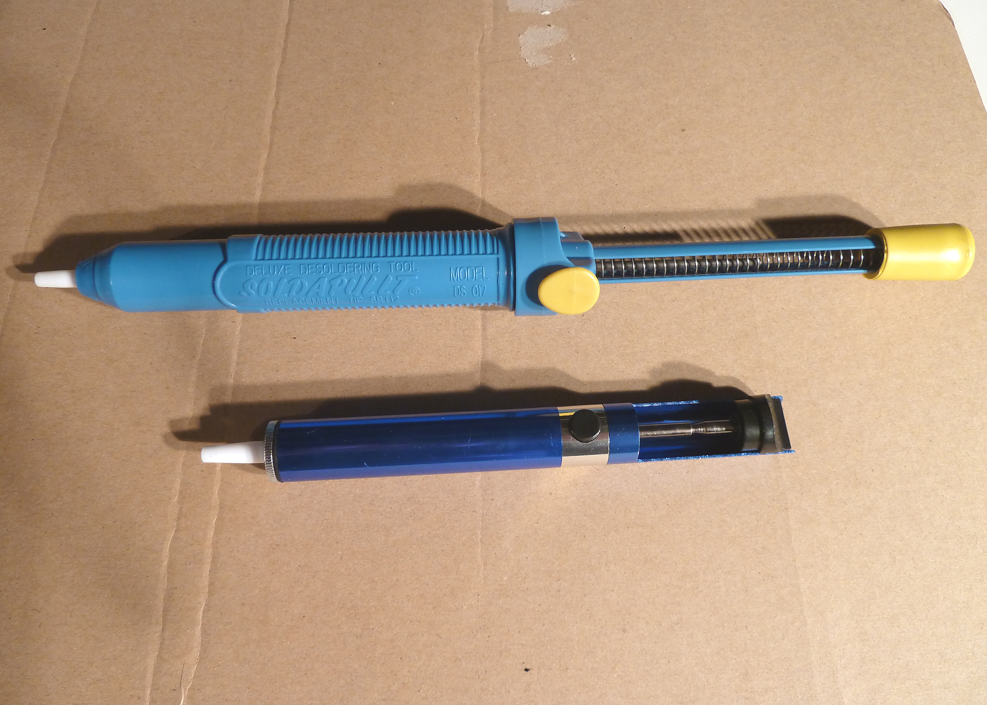

                                    2) When I first started trying to remove capacitors and resistors I tried using a solder wick to soak up the solder - it didn't work that well. Then I picked up a cheap "solder sucker" that worked better, but was far from ideal. Then I ran across a larger solder sucker tool from Edsyn Soldapullt and bought it. It worked GREAT. (photo attached).
                                    Runs about $20 on Amazon, but can also be found on Ebay too. Lots of positive reviews.
                                    http://www.amazon.com/Edsyn-Deluxe-S...4465565&sr=8-3

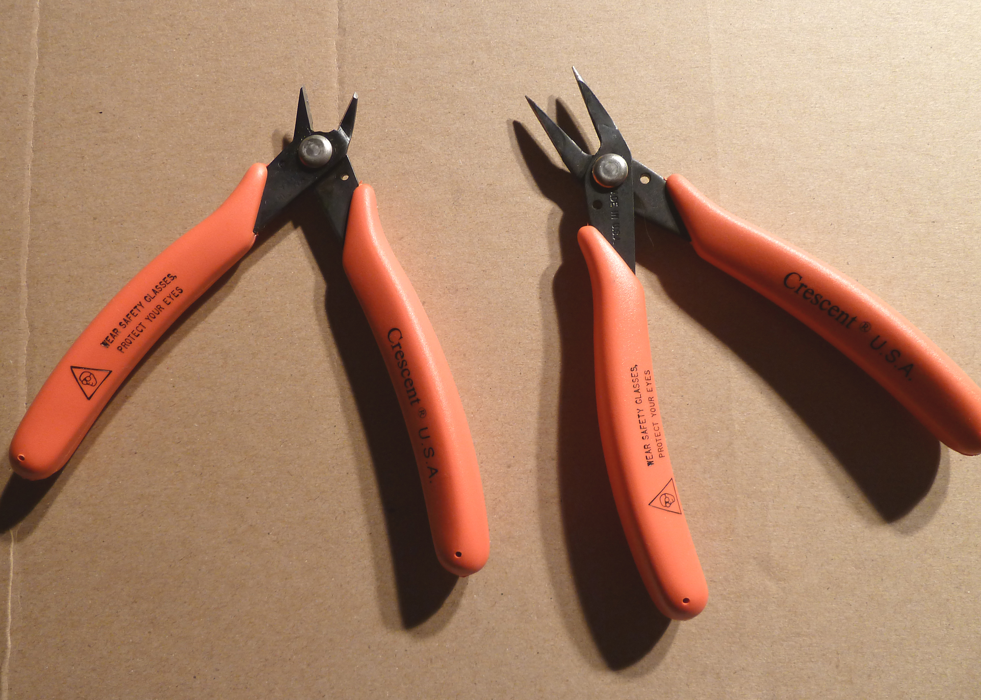

                                    3) In order to cut the excess wire legs from capacitors and resistors, you'll need a small wire cutter that can cut flush to your solder point. I bought a Cresent Miniature Wire Cutter and Miniature Plier set from Home Depot. The pliers came in very handy to compress and remove the plastic tabs on the plastic shielding covering the power board. As I recall, the price was about $12-$14. (photo attached)
                                    You can find these type of wire cutters and pliers all over, from a small electronic store, to Home Depot or Lowes, to Radio Shack. Amazon and Ebay too.

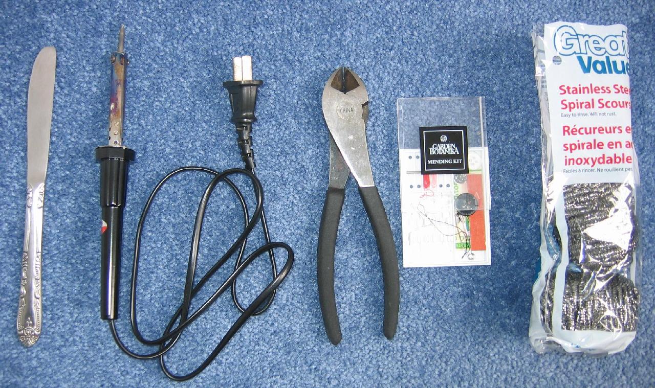

                                          Well, for post #500 , I will present the lowest possible cost way of getting the monitor fixed. These are my real life tools that I started with almost 2 years ago and still mostly use today.
                                          Obviously, good tools makes the job much easier and last longer, but for a one time DIY fix, these will suffice as well.
                                          1) The old butter knife. Yes, it might scratch, scar the plastic and break a few tabs, but it works.
                                          2) Sewing kit (free from some hotel). I used the stainless steel bobby pin to clear the holes after removing the capacitor. I used to use a solder sucker, but the bobby pin works way better.
                                          3) Dollar store wire cutter. I think I got this at the dollar store back when all items were actually $1 and not $1.25 or $1.50.
                                          4) If you live in the USA, a DIY capacitor order through digikey.com will save you about 50% or more the cost versus the kits found on ebay.
                                          5) Sort by lowest ebay price 40W (around $4 USD) soldering iron. These irons work, but they come with a conical tip which has less thermal transfer area than a chisel tip. It is almost impossible to find a cheap 40W iron with a chisel tip and replacement tips are non existant so consider this a disposable iron after the tip dies.
                                          5a) Stainless steel scour pad. I used to use a wet sponge to clean off the solder iron tip, but I find the scour pad works just as well with no thermal shock. $2 for 3 at Wal-Mart or equivalent.
                                          6) Nordhaus never mentioned his multimeter, but I made the foolish mistake of buying your 99 cent cheap crap multimeter off ebay when I first started. I have long since fixed that problem by buying several good used Fluke brand multimeters. You can always borrow one from a friend or get yourself a decent one as it is a handy tool to have around the house.
