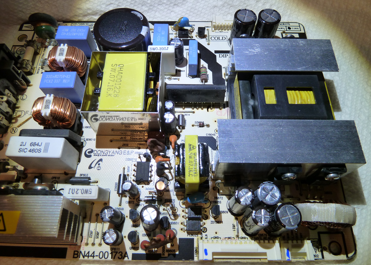

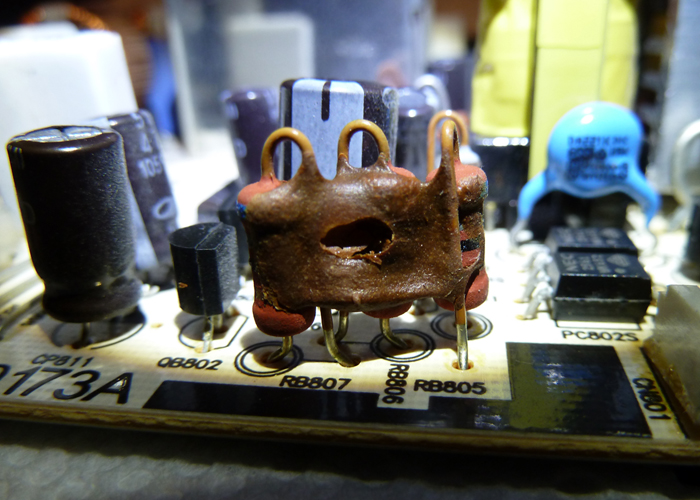

                I notice that the 3 resistors on my board have some kind of brown paste or adhesive on them that "holds" them together. (photo attached).
                Three questions for you all:
                1) Is this important to replicate (the adhesive) when I put the new resistors in? If yes, what do I use?
                2) And, just for grins, I've also attached a photo of the power board - the capacitors look remarkably clean to my eye, anyway. Anyone disagree?
                3) Lastly, I want to check the two fuses, but they both appear solid white and don't look blackened in any way. What's the best way to test them?
                Thanks!

                  1) No. The adhesive is used to hold the resistors in place during the assembly process. It should be removed as it can become conductive as it dries out over time. Before you go replacing the resistors, take a resistance reading. Each one should read approx. 68 ohms.
                  2) You cannot tell if a cap is good/bad by just looking at it. A ESR meter will provide that info.
                  3) Set your meter to 20 ohms resistance setting. With power off, place your probes at each end of the fuse. A reading of approx 0 ohms indicates a good fuse.

                    I dont know about "for grins" but posting pictures of the front and back of your power supply and main/video/logic board is almost mandatory and they should be as clear as this one https://www.badcaps.net/forum/attach...1&d=1290283049
                    As retired caps said earlier
                    If you are new to this forum, we can help a lot more if you please post clear focused pictures (max resolution 2000x2000 and 2MB) of your boards using the manage attachments button so they are hosted here.

                          Ok, per retiredcaps request, here is a photo (again, done by "manage attachments") of the bottom of the power board.
                          Please note that I've already removed the 3 resistors so don't mind the empty holes.
                          And while I have the sunlight, I took another photo of the top of the board, and tried to max out the photo in Photoshop, so here it is again (note again, the resistors are missing, as I just removed them).
                          Thank you!

                            As a side note, I ran the multimeter on the 3 resistors I removed. 2 of them measured .068 and one of them measured .076.
                            I'm assuming that the variance might indicate an issue since all 3 resistors are the same.

                              Here's my suggestion:
                              The original resistors are 68 ohm 1/2 Watt 5% tolerance. Since one is reading 76 ohms, it's out of spec. The dried glue covering them probably also didn't help. Ideally, I would recommend 1 Watt replacements, but in the interest of time/testing I suggest you go to your nearby Radio Shack and purchase a pack of 5 68 ohm 1/2 W resistors. Should set you back $1.19. Also, pick up some 60/40 solder if you haven't already done so. Solder the new resistors in and see what happens.
                                Re: Samsung Syncmaster 245BW
                                Okay, those are excellent pics. The reason we are picky about clear focused top down pictures is because doing remote troubleshooting without them is almost impossible. Pictures at an angle or out of focus makes troubleshooting and spotting problems difficult.
                                We need another set of pictures of your inverter board. This is the board where all the ccfls plug into. On that board is likely one SMD fuse and several mosfets. If the fuse is open or the mosfets are shorted, then you would get no backlight.

                                  My son's monitor had the same problem. I replaced RB805 with a large 50 year old 68 ohm wirewound resistor. Fortunately there was plenty of room for it to stick out beyond the edge of the circuit board. I never would have found the problem without this forum. Many thanks for the advice!
                                    Update: Ok, I replaced the 3 "usual suspect" resistors on my 245BW Power board (RB805, RB806, RB807), but no joy. Monitor still doesn't light up (blue light on power button remains lit, as before).
                                    So I've moved on to replacing the 14 capacitors on my power board (except for the big 850V capacitor).
                                    Will take a photo of the Inverter board when I get up in the morning.

                                      Suggest you remove the glue from other components if it touches conductive parts - near cp810 and DB801
                                      There is also another fuse on this board you can test at FB802S just about dead centre of the board.
                                      "(except for the big 850V capacitor)" should probably read 450V
