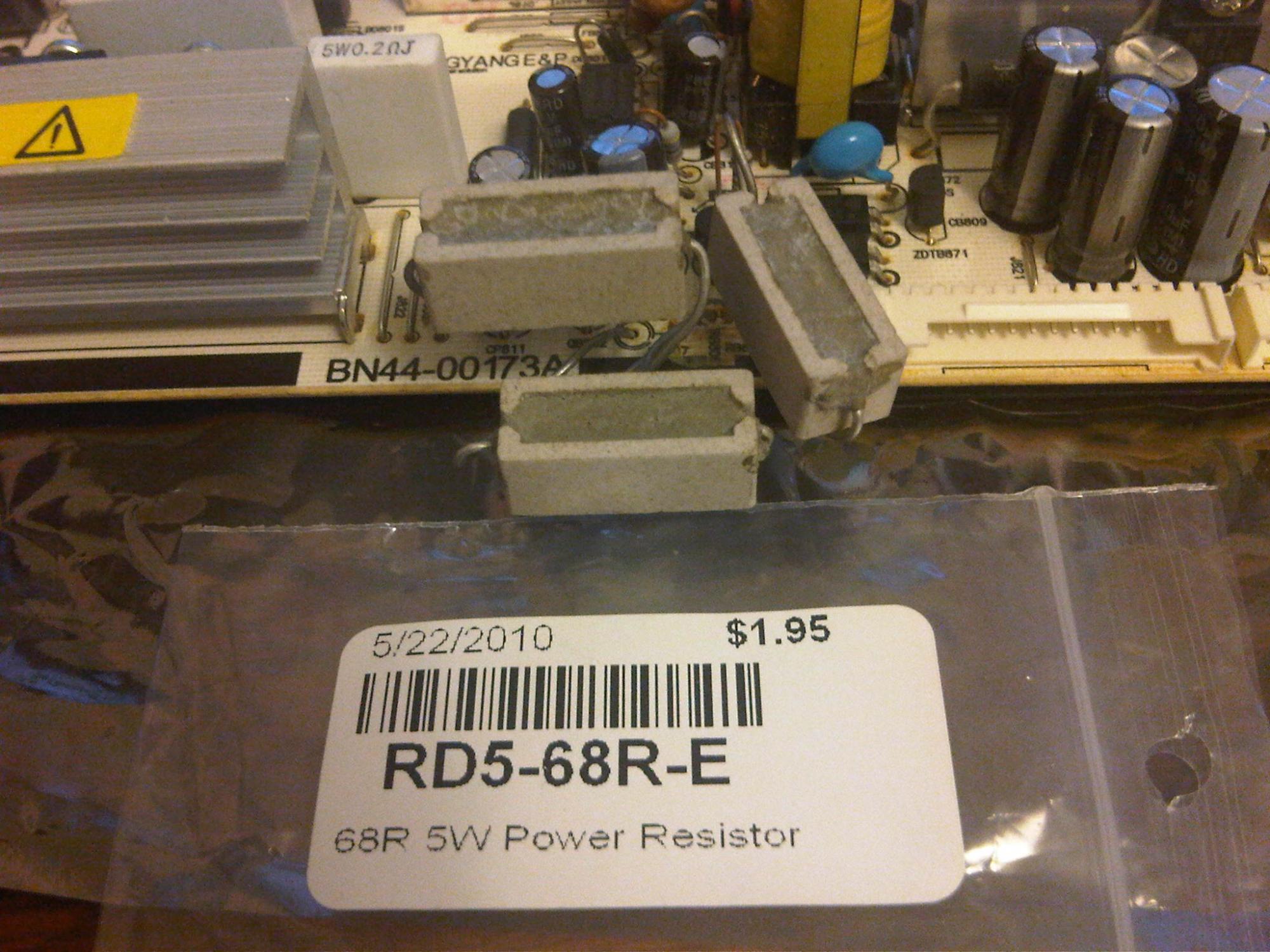

                  As a side note, if you go and replace RB805, I would highly recommend changing out RB806 and RB807 as well. Same resistors and all seem to be subjected to a lot of heat or just "run" hot.
                  I was having trouble finding the same "size" resistor in 68 ohm without having to wait a long time (the weekend). So as mentioned before, I replaced them with TRW 68 ohm 5
                  watt variety. There is amazingly lots of room in that part of the housing to have the resistor body protrude out/away from the board to the side.
                  Anyone have a neat solution for cooling the power supply? I am going to see if that is a way of ventilating the power supply board to have it run cooler/more airflow.
                  Cheers,

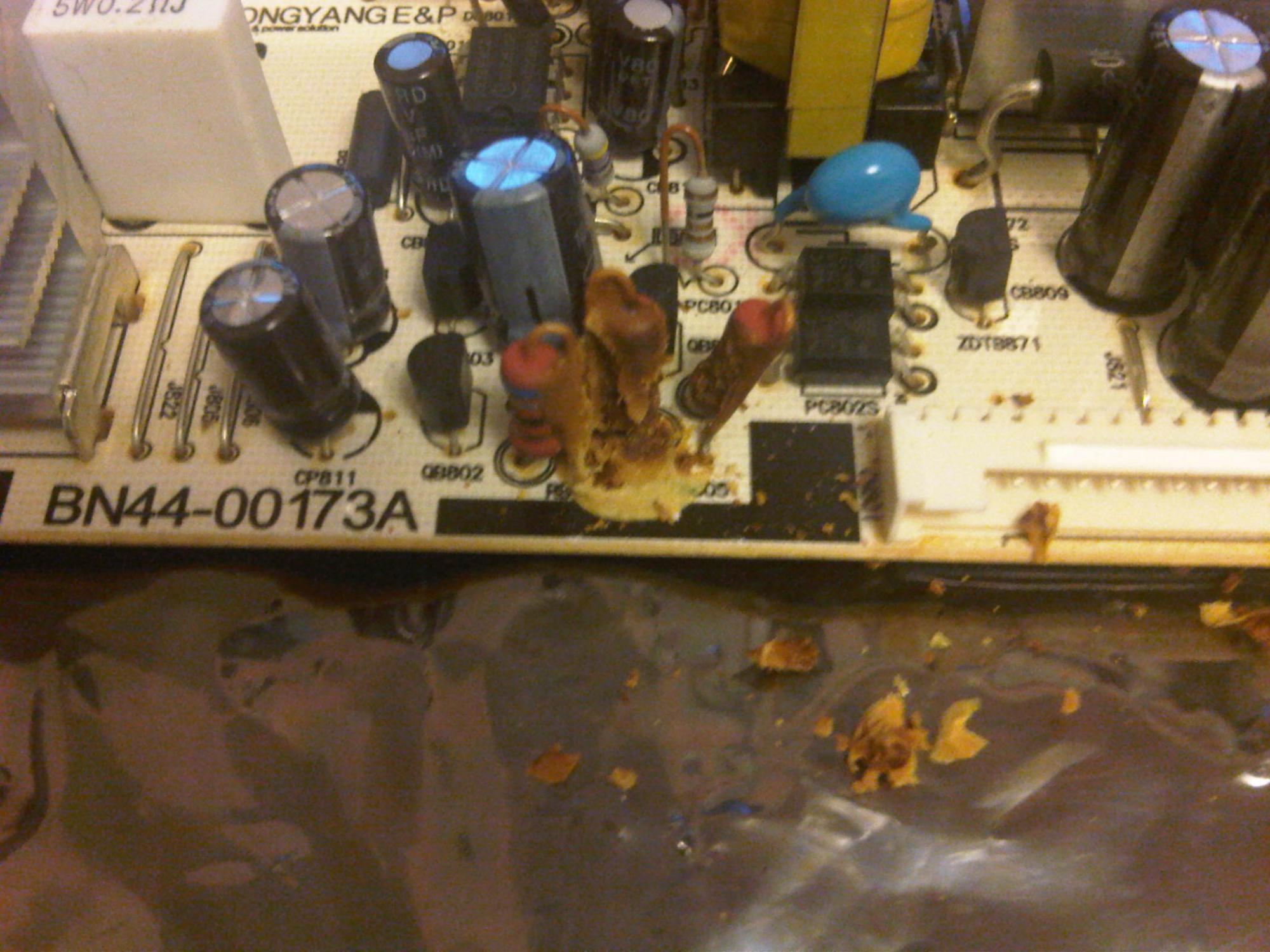

                    Here are some before and afters..... RB805, RB806, & RB807 replaced

                      my original resistors did not look that bad, if i had not measured there was no way of telling one was broken. my monitor is in an eastbound window, so its "ventilated" and does not get sun. i reakon you could plud a fan into the monitors 12v out and give it airflow that way. just get a low-rpm one.
                      anyways. 50ohm instead of 65 ohm. is that ok?

                        Yes, should be fine, just that it'll heat up a little more. Those look like they are minimum load resistors - they're using an outdated design on that power supply.

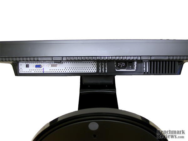

                            Re: Samsung Syncmaster 245BW
                            they are actually in series... didnt think of that. well, if it fails again, i know where to look.
                            my monitor has an 12 volt outlet besides the 230v and signal inputs. just plug a pc fan in there and aim it through the grill i suppose. if you wanna go for silence, add an resistor before the fan and enjoy
                            edit; added picture, the 12v out is at the far left
