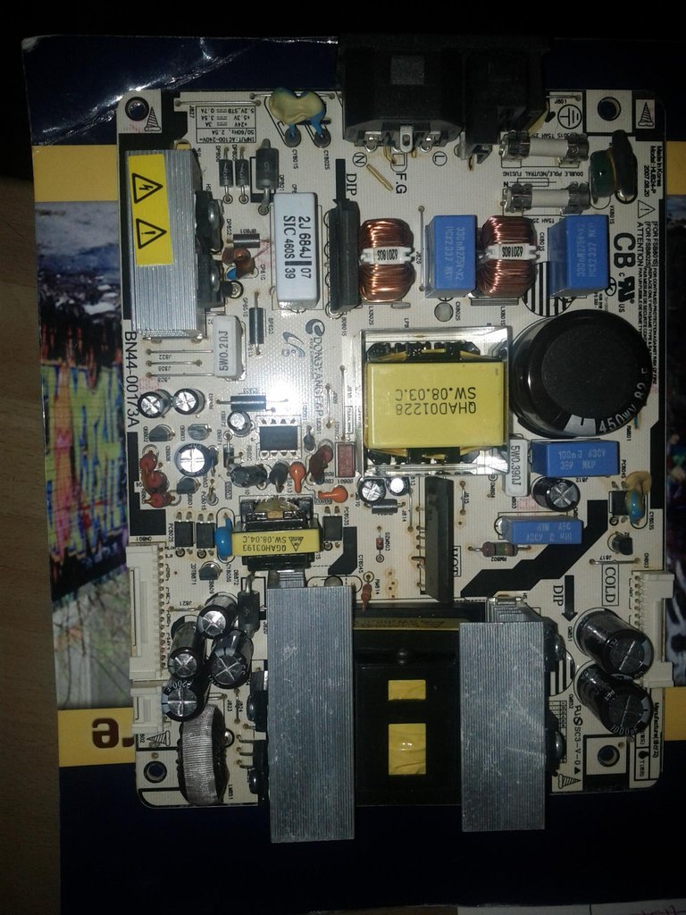

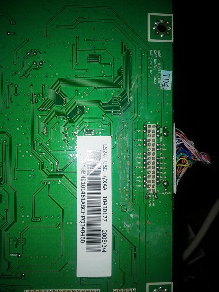

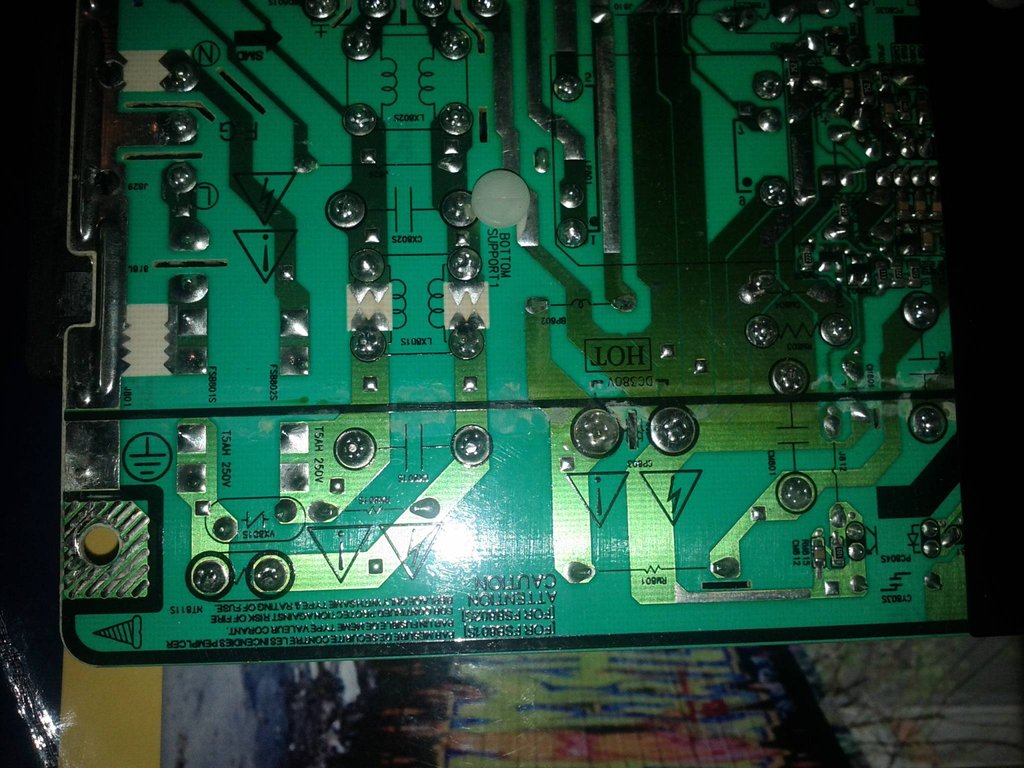

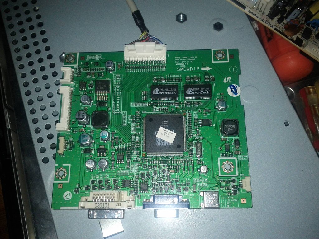

                                      Re: Samsung Syncmaster 245BW
                                      Originally posted by ChuckTs
                                      Hoping to get another success story here, looking for help on what to replace and how. My 245 started clicking, if I remember correctly, kind of quietly for about a week before it went dead. Power still turns on, but the screen is completely black. No gx settings help, almost positive it's internal with the monitor unless I've completely overlooked something. Thank god I normally dual-monitor
                                      Took it apart; here are some 'overview' photos of every board, front and back. I noticed some kind of scum on the back of two of them, but don't see where it's coming from. With my non-existent experience, I didn't notice any busted caps or leaks on the top side of any of the boards. Let me know if you need any part numbers or closer pics or whatever. Also, if/when I get a replacement part, I assume I either need to send it in to get repaired or figure out how to repair it myself - I'll probably need soldering equipment right?
                                      I'm a complete newbie to this so any and all help is much appreciated. Thanks in advance and let me know about anything else I need to post.
                                      EDIT: I tried to upload my pics but got a "there was no security token" error
                                      Going to try posting new pics here since the last ones evidently weren't clear enough for you guys to give any feedback on.
                                      I'm really desperate now - my second of two 245bw's just broke down (I have yet to take apart the second one) and I need to work with them so I really need them fixed asap. Happened to find out that a friend has a soldering kit too which was a nice surprise.
                                      Please let me know if these are clear enough and if you think it's repairable, or if I should start scraping up funds for a new display. As mentioned in my first post, the scum seems to be on the back of the boards, but I can't see where it's coming from on the top.
                                      Thanks!

                                        #419
                                        It is preferred that pictures be attached to the post using 'Manage Attachments' - below the test entry area. That way they will be available to others.
                                        For a number of reasons, including popups and malware, some refuse to view pictures hosted offsite.

                                          #420
                                          I see 2 blown caps in the power supply. Lower left corner.
                                          Recap the entire power supply. Except for the mains cap, there are only 14 total to do.
                                          Attached your pics for you. They are a bit dark....
