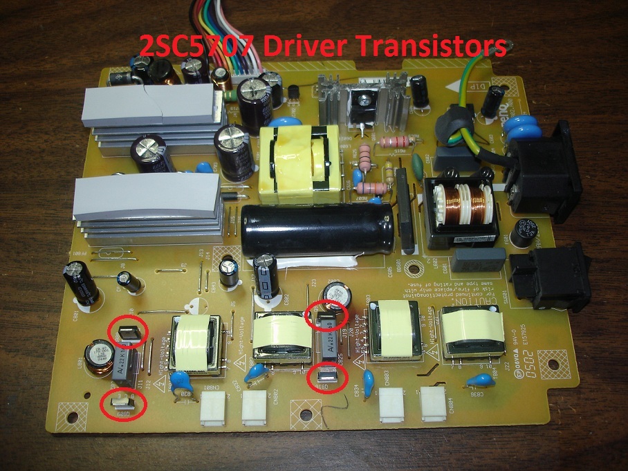

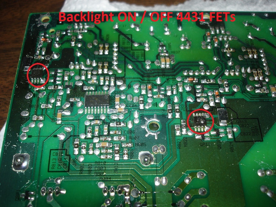

    Well another HP L1955 crossed my path and for awhile it got me stumped.
    This should be the defacto guide for repairing this monitor and similar Benq inverter boards.
    It came in with the classic symptoms backlight flashed on and off for a second. If the backlight doesn't come on even for a second then the inverter fuse is blown.
    A flashlight on the LCD revealed the the main board and LCD driver circuitry was functioning.
    So I pull out the inverter board did a check of the C5707s one of them was blown as was a 4431 backlight ON / OFF FET from source to drain as usual. As you can see it has a nice bubble in the package (See Picture). Also if a FET is blown be sure to check the protection diodes as well (see picture).
    However the 5 amp inverter fuse wasn't blown if it was as I said before I wouldn't even get a backlight flash (See Picture For Fuse Location).
    The board was packed with Elites known crap caps they weren't bulged but as a matter of course I replaced them. I also replaced all 4 C5707s and both of the 4431 backlight ON / OFF FETs.
    I power the monitor on and I get the same symptom. Backlights flash for a second then go off.
    So I ring all 4 inverter transformers with my ring tester they test fine. I test the CCFLs with an external inverter they're fine. Now I was officially stumped.

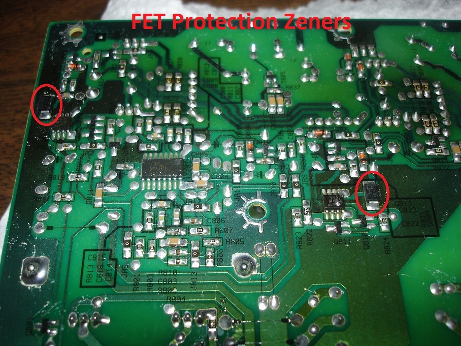

    I get away from the board for a bit and then it hits me. Check the small signal general purpose transistors for the failed FET. Then what do I find? The NPN signaling transistor that switches the backlight FET on and off was shorted from base to collector.
    Since it was shorted this way it was sending a positive voltage to the gate of the replaced FET irregardless of the signal from the mainboard.
    Since this is a depletion FET when a voltage is applied to it's base it is off. The bad NPN was forcibly holding one backlight pair off. So when I tried to power up the inverters PWM protection circuit was sensing two backlights not coming on assuming a fault then shutting down.
    I checked these transistors in a few of these monitors I've done already and they were fine but I got a little reckless on this one since all of those other times the signaling transistors were okay. They are a pair of two one PNP and one NPN be sure to check them both.
    Here are the part numbers a special thanks to mrlooi who posted in this forum a year back. Giving out the part numbers for the signaling transistors and saving me hours of datasheet combing.
    Where to buy and component info:
    Sanyo 2SC5707 Bipolar Transistors: E-bay or B&D Electronics
    Vishay Siliconix SI4431BDY FET: Digikey or Newark
    W04 GP NPN Bipolar Transistor: Original part number PMBS3904 (SOT23 Package) NXP Semiconductor (2N3904). Mouser has a stock of the NXP originals as of this writing. If they don't here is an alternate part number from Fairchild Semiconductor 512-MMBT3904.
    W06 GP PNP Bipolar Transistor: Original part number PMBS3906 (SOT23 Package) NXP Semiconductor (2N3906). Mouser was sold out so I found the same transistor from Fairchild Semiconductor part number 512-MMBT3904.
    The W in the preceding part numbers is irrelevant it just means the transistor was made in China yours may have a different letter. T means made in Malaysia and P means Hong Kong FYI.
    5 Amp 125V axial leaded fast blow inverter Fuse: OEM was made by Bussman but any standard Pico fuse from any name brand fuse manufacturer will work.
    Edit: I have found that in some later model 1955s the 5 amp fast blow fuse has been replaced by a 3 amp 125V slow blow fuse. It's a Bel MS series 3 amp fuse. Again no need for the same manufacturer any slow blow pico fuse will work.
    The fuse can be at either of the locations circled.
    My only guess for the fuse amperage change is HP received complaints of monitor failures and upon investigation it was found that the inverter fuses weren't always blowing. As in the case of the inverter board pictured in post 12 where the overload condition actually burned the traces off one of the On / Off FETs.

                        Well another one of these crossed my path same symptoms.
                        However the FET on this one seemed to really flare up killed three of the source lead traces on the FET and took out both the PNP and NPN signaling transistors. As you can see on the plastic insulator on the back of the panel some serious overload happened here.
                        FYI the 4 top pins are all tied together and are drain the 3 bottom pins are the source while the last pin is gate.
                        So I removed the old component removed as much of the char as I could with alcohol and cut off what was left of the lifted mangled source trace with a razor knife.
                        I then stripped some insulated wire the soldered it to the collector of the replaced NPN transistor. A valid tap point for the source. All 3 bottom traces were destroyed but the rightmost gate pin was still fine.
                        As I said before normally all of these pins are tied together so I intentionally bridged the 3 source pins and soldered the jumper wire to it.
                        As you can see I left some insulation on the wire that is because the jumper goes over the gate pin.
                        It's not pretty but you didn't see it before I cleaned it up .
                        It makes me wonder if they overrated the 5 amp fuse? It again didn't blow. I've seen other 17" Benq builds with 3 amp fuses.
                        As for the cascading failure I am still thinking there was a bad batch of C5707s that Sanyo never admitted to.
                        • Krankshaft
                          • Jan 2007
                          • 2328
                          Re: HP 1955 Monitor Repair Guide
                          Sorry about the pics I didn't deflux the board before I took the pics and the flash made it look horrible.

                            Krankshaft, do you happen to have the part number for the zener diodes? If not, how could I find it?

                                  I think a majority of these failures are from bad solder joints on the transformers.
                                  I always wick all of the transformer pins and reflow with fresh solder. The two gray caps in between the C5707s and the two inductors in the inverter circuit. This gets done automatically whether or not the joints look suspect for insurance.
                                  Afterward I go carefully over the whole board with a magnifier and touch up any remaining suspect joints.
                                  It does sound like an inverter side issue the flash is the inverter trying to power up it sensing a fault and shutting down.
                                  Loose CCFL connections or a bad joint on the inverter board as PlainBill said. It's the only explanation if it magically rectified itself.
