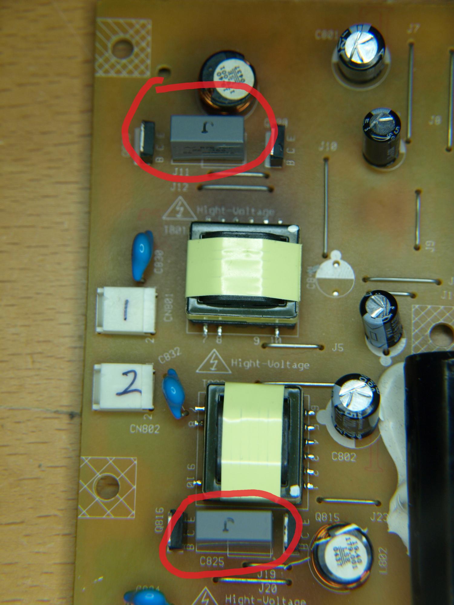

                  Re: HP 1955 Monitor Repair Guide
                  You mean the two grayish rectangular components at the power connector and the two at the transistors?
                  Refer to attachment pictures.

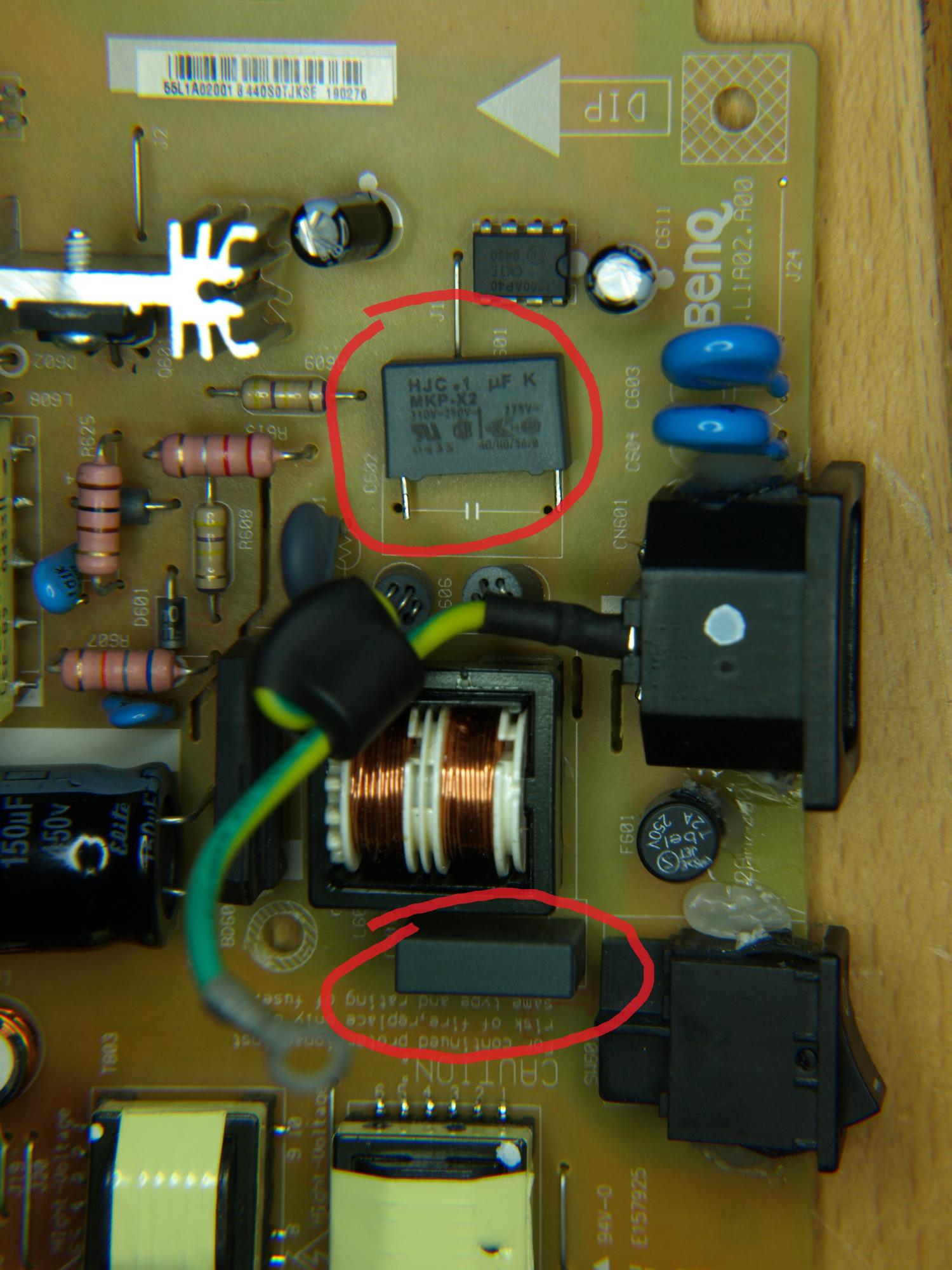

                    #89
                    No the small aluminum caps just above the gray one in the first photo.

                      #90
                      The caps (two battery shaped) at the ic?
                      Or the two blue ones at the power-connector?
                      Updated: Electrolytic capacitors, yeah. Like I said. I changed them all.

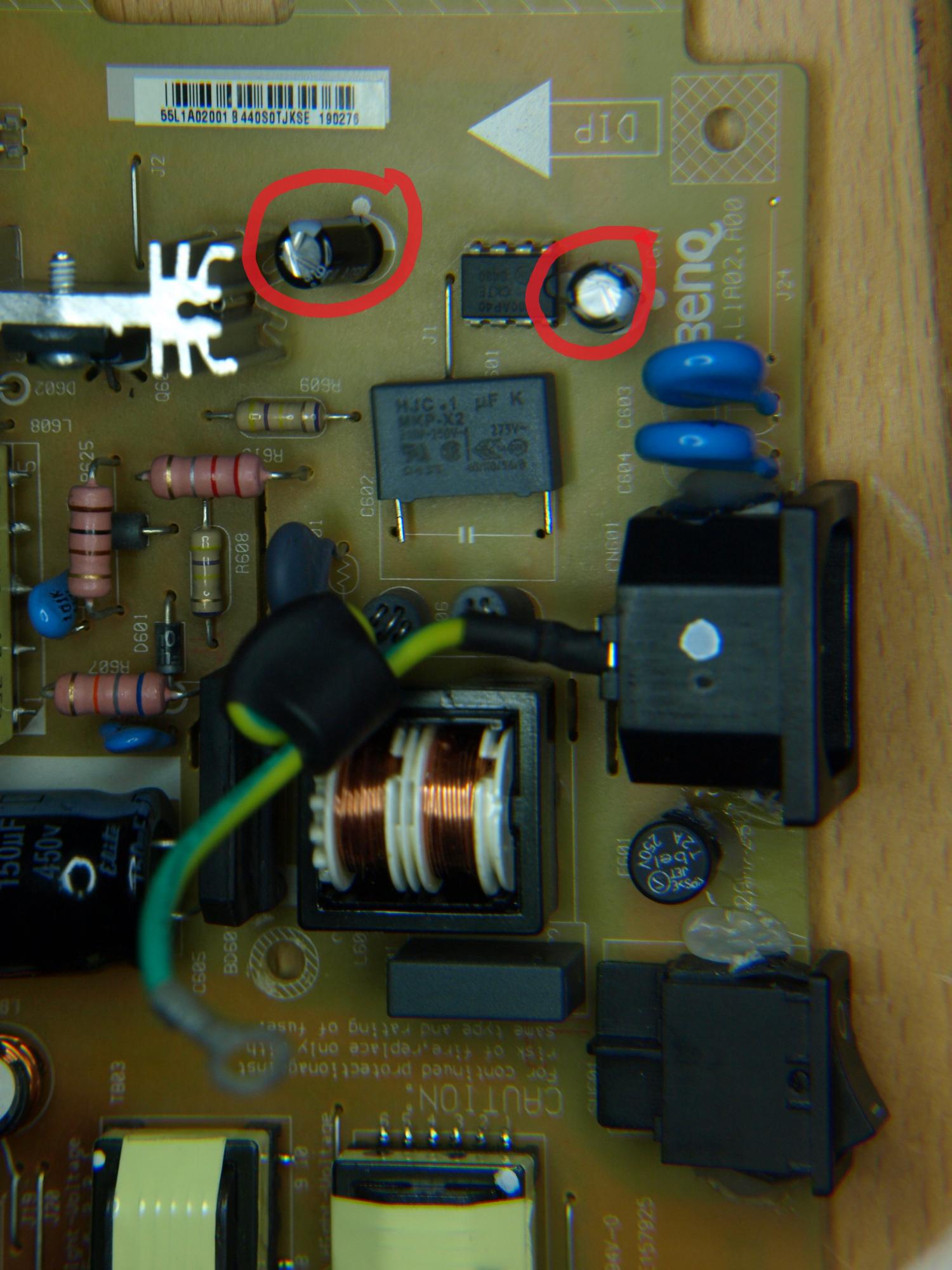

                        #91
                        The two circled in red. One of those is the start-up cap. If it fails completely you will not have any power at all. If it is marginal (capacitance is seriously reduced) the power supply will start and appear to work normally, but will fail under full load - such as when the inverter starts.

                          #92
                          I guess I need to wait for my new multimeter (Fluke 179) so that I can check the capacitors with that. Maybe they're defective?
                          I think folks may have missed it when you initially said that you had already changed all the caps (post #56) except for the large 450V one. Perhaps the question that should be asked is: what brand/series caps did you replace the original caps with?

                              #94
                              The startup cap is critical to have the correct series.
                              You look to have somewhat of a difficult monitor to repair.

                                        #99
                                        What were tge series of the start up caps?
                                        Did you re-solder the gray box type caps by the 5707 transistors

                                          #100
                                          You mean what uF and V-capacaty?
                                          I never desoldered the gray box type caps but the 5707's. Only the one in the picture to know what it was.
