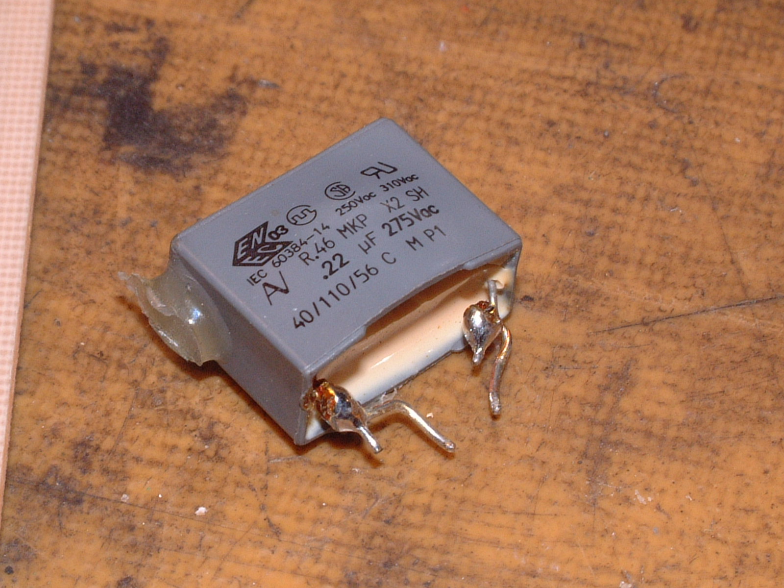

      YES! We found the problem. I desoldered the gray box caps then resoldered them. I mounted the bord on the back of the LCD, started it and it worked!
      Im gonna give it some time off and stuff till I feel sure that its really fixed.
      I just want to say Thank You to all of you for helping me out debugging the board. I love this place!

        Remember way back in post 64 when I said to resolder those caps and the components around them ?
        You're lucky it was caught early a joint failure there would eventually blow out one or more driver transistors and sometimes On / Off FET and inverter fuse. Sometimes the fuse blows other times it doesn't when there's a short. A fuse of too high an amperage was probably sized from the factory.
        Later revisions got rid of the 5 amp fast blow fuse and replaced it with a 3 amp slow blow. Probably in hopes of it actually opening a greater majority of the time if there is a fault.
        I always go over the entire board with a magnifier but focus mostly on the inverter section to check for any other suspect joints when I repair these boards.
        I recently repaired one for a member here who said the solder joints looked fine. The moment I got it in my possession one of the joints on one of the gray caps was completely cracked. When I wiggled it I could see the lead move. In this boards case it was too late and the inverter drivers were blown. But you caught it in time.

              Cracked solder joints in the inverter section cause these displays to die especially on those two gray caps between the C5707 driver transistors. I always find at least one cracked joint on one of those two caps. Resolder both gray caps between the drivers, both inductors in the inverter section, and all of the inverter transformer pins. The rest of the board then has to be checked over with a magnifier for any other bad joints.
              Unfortunately these bad joints blow out the drivers if the joints aren't repaired in time the shorted driver can then blow a 4431 Backlight On / Off FET due to an over current condition.
              After the cracked joints are repaired get a DMM and check the drivers and the On / Off FETs for shorts or opens. You can get the pinouts for the transistors and ICs in the attachments on my first post.

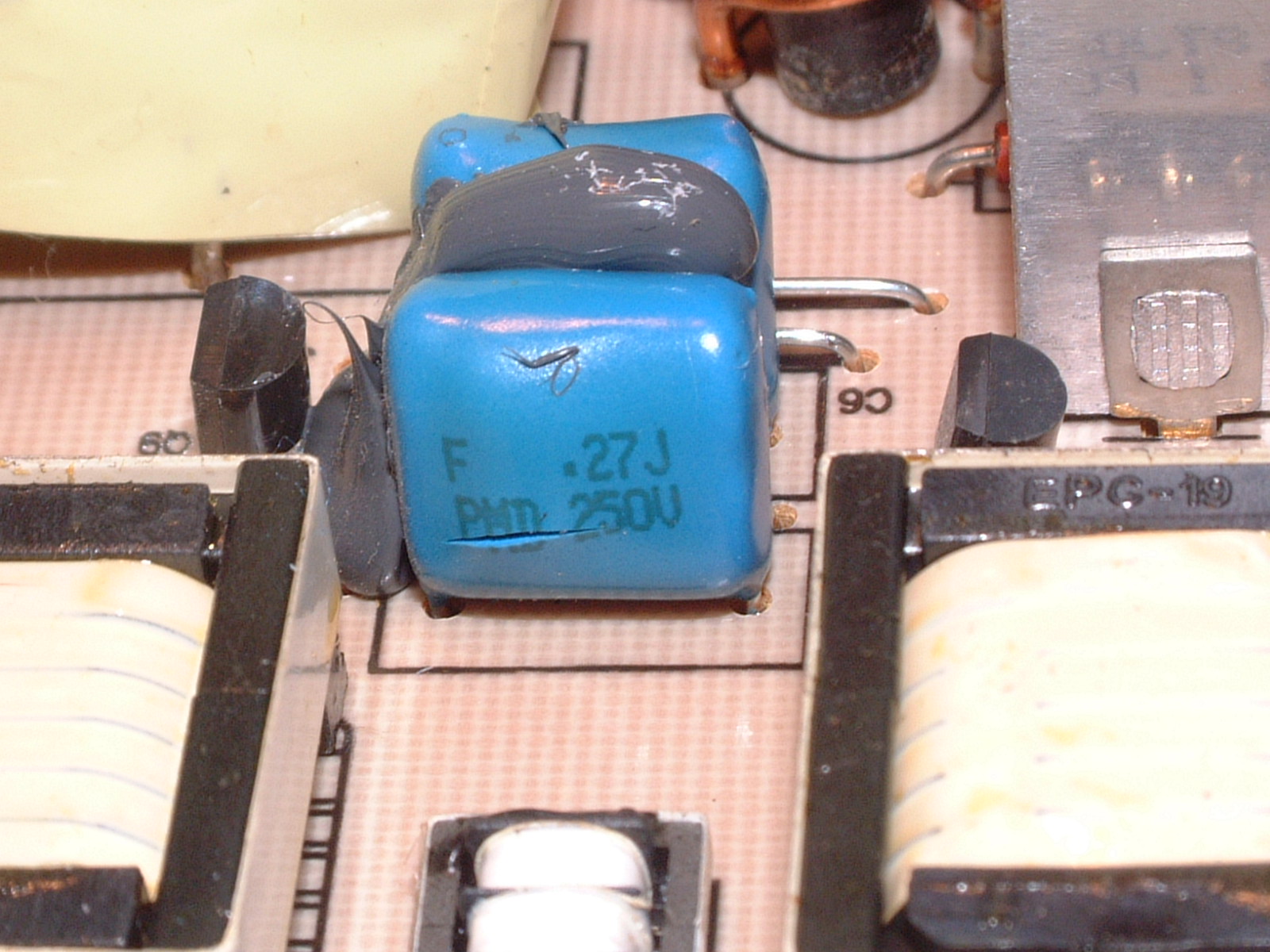

                Wow, I did not look carefully enough. One of the grey caps does have a cracked solder joint and is more evident when I gently wobble the cap.
                From seeing the bright display I noticed when I first plugged the monitor in and used it for about 4 weeks I would be completely confident the backlights all work well.
                I will check the first post to identify the On/Off FETs and maybe get the things you posted about done today and post back later.

                              May I also add, those two gray caps are part of the Inverter output oscillator circuits (Royer Oscillator circuit), if its value went out of range, the Oscillator will be running at the wrong frequency and takes out the C5707 output transistors, check the value and leakage or bulging on the caps first otherwise you will take out your new transistors. A lot of HP and DELL monitors were made by BenQ.
