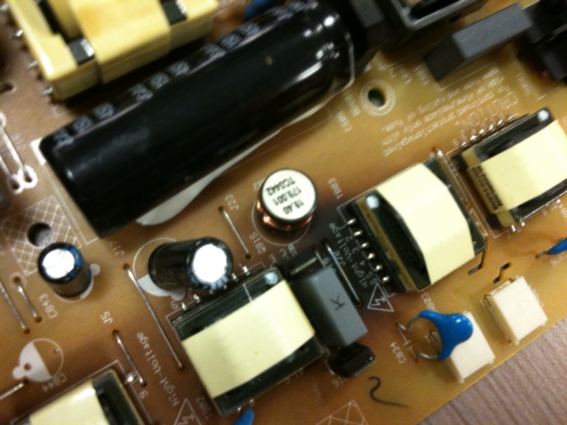

    I also have come across the same monitor, and I believe I have the same severity as Krankenshaft's second case. I will attach the pictures and maybe people can point stuff out. It is obvious that the FTE is just ruined, and I am unsure about the transistors however they don't look good. What else should I worry about or test? How should I test the transistors to see if they are performing as expected with the blown FTE? I want to know what parts to order so I can add them all in one order.
    • jnfurst
      • May 2010
      • 3
      Re: HP 1955 Monitor Repair Guide
      I tested the transistors with a diode test on with my multimeter test attached and found the transistors near the center of the board (Q815 and Q816 on A02.A00) were shorted. So I will plan to replace those along with the FTE. Is there anything else I should check before I purchase these parts

        Hello
        If you read Krankshafts post 1 and 7 of this thread it tells you everything you need to check and also everything you need to do to get the Inveter working again
        ??? Can you tell us if the 5 Amp Inverter fuse PF701 failed or is it still good ???

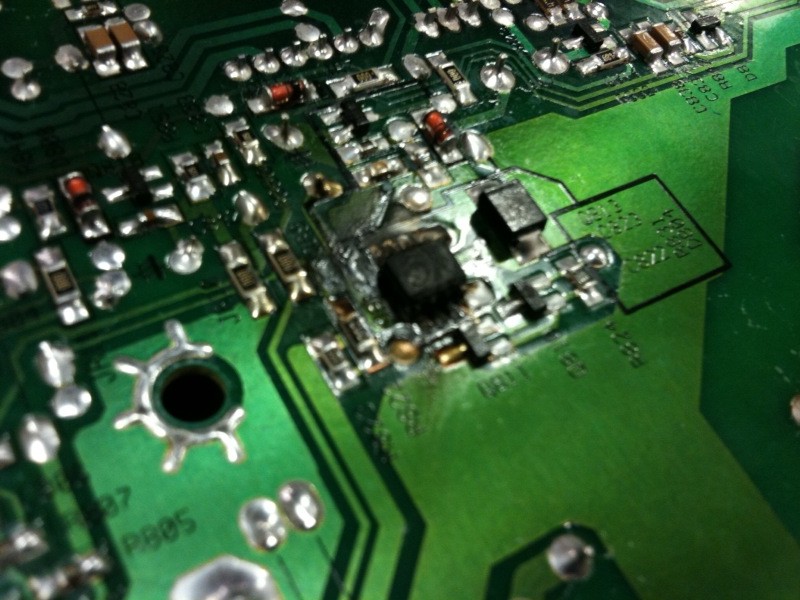

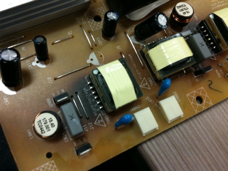

            Jnfurst
            You are totally correct if your B/Lights do flash on for a second then your fuse is OK (my silly error)
            The reason why I asked was there is a lot of damage to your board, my thoughts are that this fuse should have opened before all of that failure occured on this particular PSU, all the other Benq boards that i have done in HPs, DELLs, BENQs have the usual transistor and fuse failure with plenty of cracked solder joints they have a 3 amp fuses yours has a 5 amp
            This fuse seems to be over rated as Krankshaft has mentioned in his post earlier,I was wondering if he reads this, has he yet tried lowering fuse to a 4 amp with any success
              Fantastic guide! A big thanks to Krankshaft for all the hard work! I managed to resurrect an HP L1955 from e-waste thanks to this guide alone.
              I wanted to post the links I used to order my components as I depended on only 2 sites: eBay and Digi-Key and spent around $10 total incl shipping to get this monitor back up and running.

              I ordered extra parts just in case and actually didn't end up needing them. It took me around an hour to solder and replace these components, the overall disassembly and replacement was simple enough. Use this manual for those who need the additional guidance:
