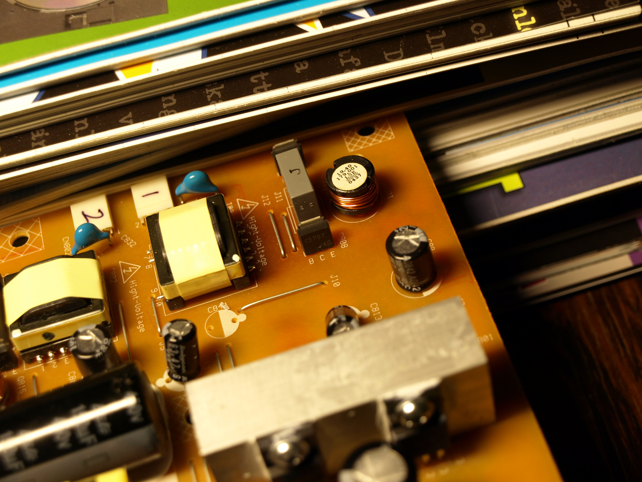

                                  I have a 1955 that I am trying to get working. I have changed all the caps except for the 150uF 450v. I cant see any blown FET's or anything else that might be shorted. What could it be?
                                  • alexanna
                                    • Mar 2010
                                    • 1346
                                    #57
                                    Re: HP 1955 Monitor Step By Step
                                    First describe the type of problem you are having.
                                    A monitor can fail in various ways.
                                    Does it have what we call 2 sec to black?

                                    • krantz
                                      • Nov 2010
                                      • 23
                                      #58
                                      Dose the power LED come on and recognize a signal?
                                      Can you turn the monitor on and off with the front power switch?
                                      The LED comes on and recognizes a signal when i push the power button. It then gives a picture for 0.5 seconds, restarts (also the LED blinks at the restarts) and repeats.
                                      I can turn it off if i hammer the power-button during the restarts.

                                        #59
                                        Re: HP 1955 Monitor Repair Guide
                                        Do you have a multimeter?It's time to look at some voltages.
                                        Even though this a long thread with photos,It would help to see photos of your power supply front and back.Try to get them focused so we can read the writing on the board
                                        Please use managed attachments to post the photos.
                                        Whatever I do, I consider it a success, if in the end I am breathing, seeing, feeling and hearing!

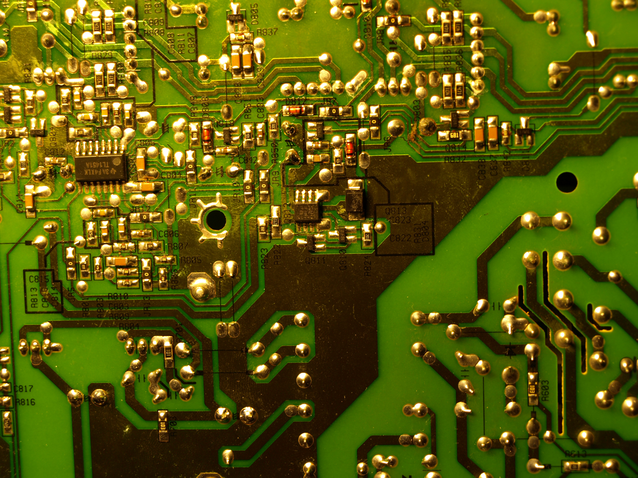

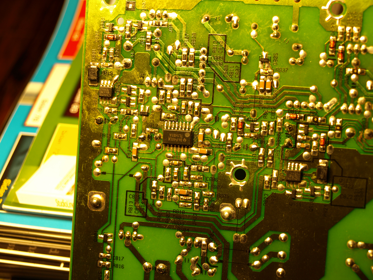

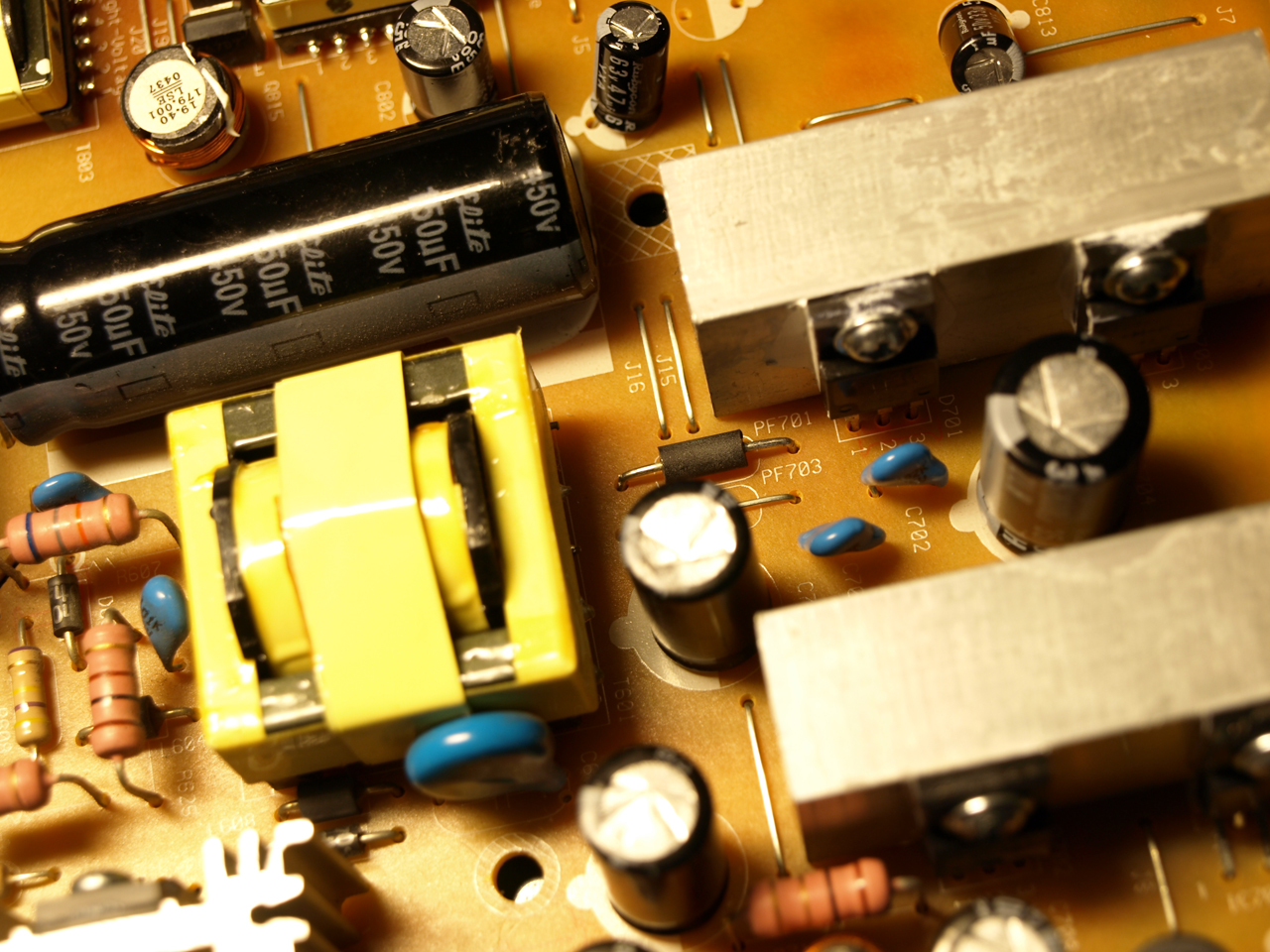

                                          #60
                                          Yes, I do have a multimeter but not sure what component to measure.
                                          Here are some pictures. Ive focused on the components as Krankshaft did.
