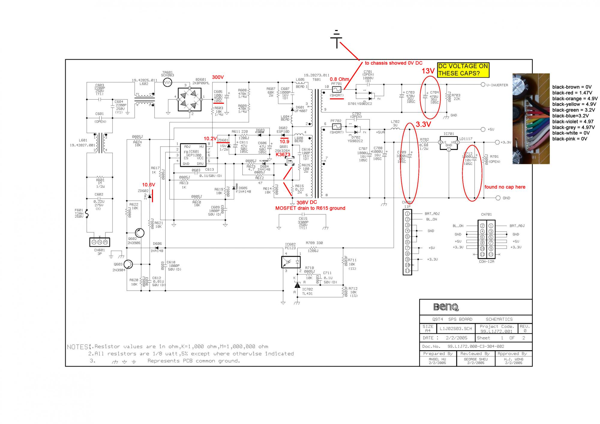

    I got 29 V DC
      #162
      Re: HP 1955 Monitor Repair Guide
      Right at the two legs? It cannot be that high!, The IC will not take that, your meter's battery is good? It is 15V zener diode.

        hmm. sometimes multimeter shows low battery indicator. measured one more time. same results. in 20 v range its out of range. will try to find another multimeter meanwhile.

              Sorry to say, that cannot be, unless the Zener is open. As you can see in the circuit, that 15V Zener is for regulating the VCC for the SMPS IC to be at 15V max.

                I see.. is it wise idea replacing zener diode without going any further? may be mosfets Q602, Q603 are shortd too, as well as zener diode ZD602.

                  on D602 i've got 10.9V
                  Sorry for measleading info. I measured standard diodes not zener ones.
                  Find proper ones
                  ZD601 - 10.2 V
                  ZD602 - 10.6 V
                    #169

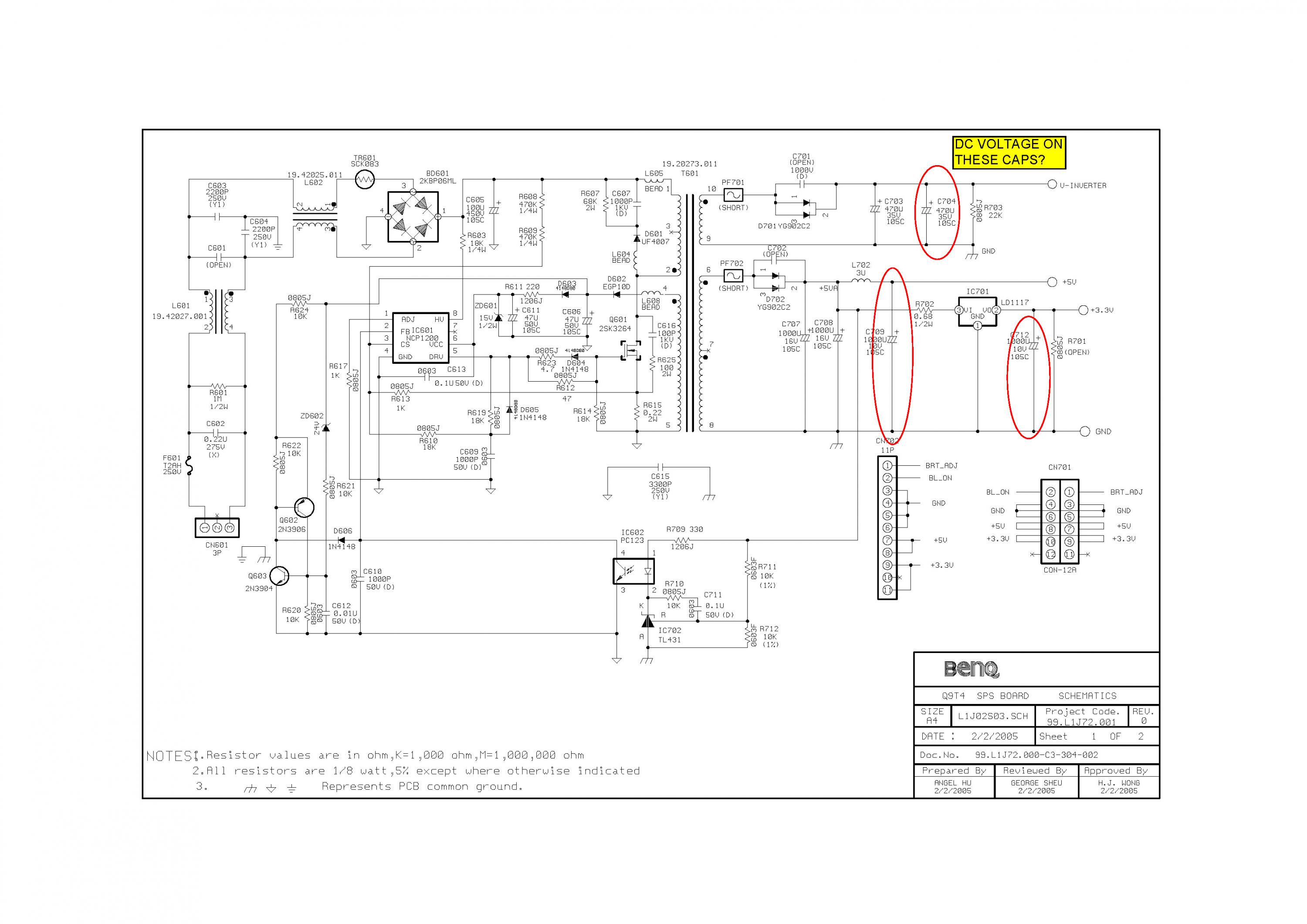

                    About 10VDC is correct voltage for NCP1200 SMPS IC to run. Check R615 Source resistor 0.22 Ohm for MOSFET Q601 to see if it is open. Check the DC voltage at the Drain pin of Q601 using C605 Negative leg as the ground ref point for this primary circuit section.
                    OK, just to sure, you are not getting any DC voltages on these caps?

                          OK, the power supply is not dead after all since you are getting the 5V, so next step will be hooking up logic board back but leave the flat cable from the logic board that go to the panel and see if those voltage readings change or disappear, especially the 5VDC. one thing does bug me is that you are getting only 13V for the inverter, but then the sch does not match your board 100%.
                          I will need you to post good closed up pictures of your board, both sides so I can trace out the connections and compare it to the sch.

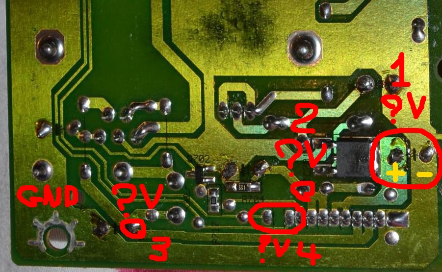

                              Can you tell me what voltage are you getting at those 4 locations?
                              Notes: number 4 location are 3 pins, report reading at those 3 pin with the monitor connected to running PC. One of those 3 pin is for BL_ON (Backlights ON), another pin is for Backlights Dimming control, the 3rd pin I do not know what that one is for.

                                  #176
                                  if i understood you right.. than
                                  V1 - 3.3V
                                  V2 - 4.97V (pin to GND)
                                  V3 - 5.07V (pin to GND)
                                  V4 - from left to right - 3.13V, 0.02V, 0.02V (each pin to GND)
