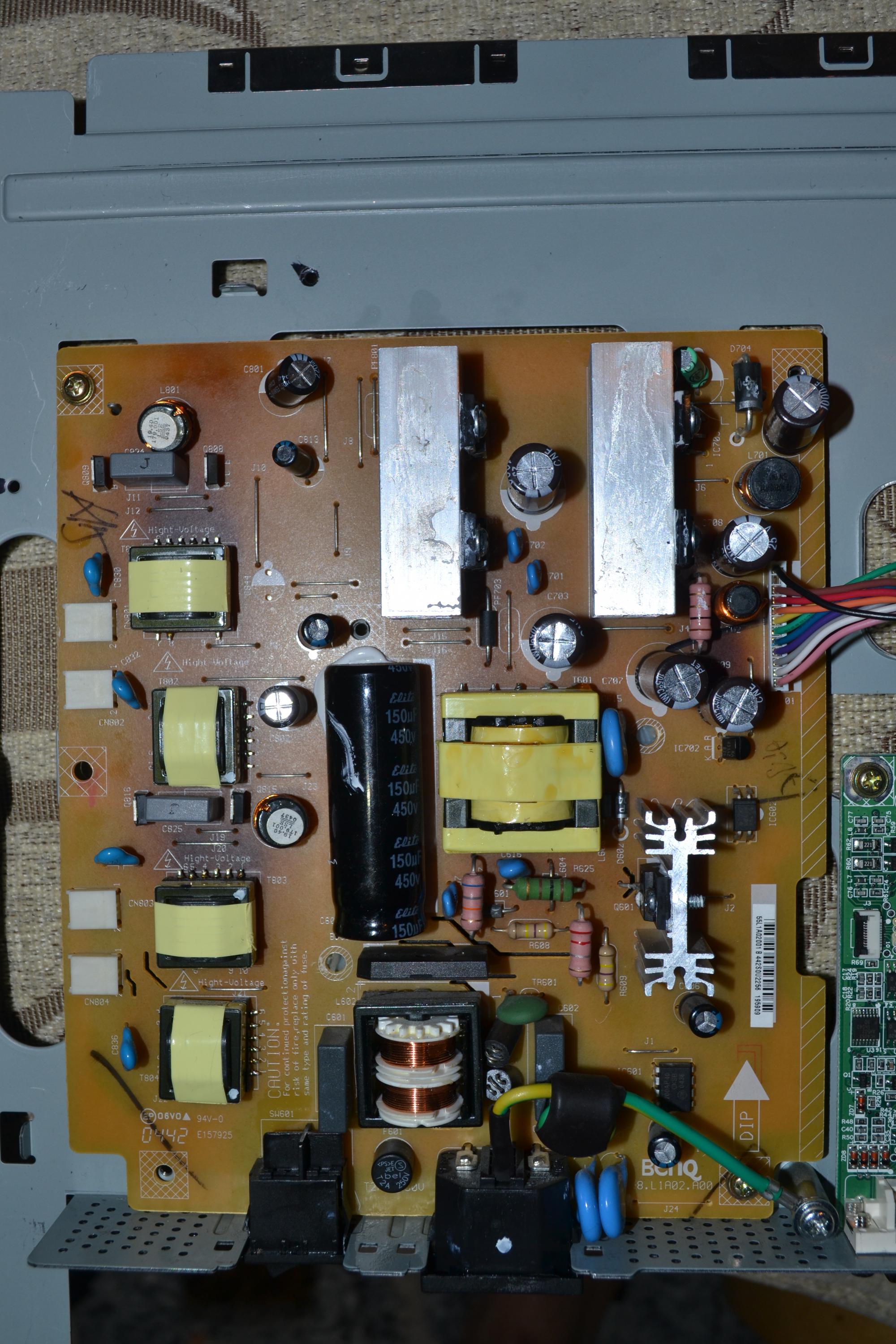

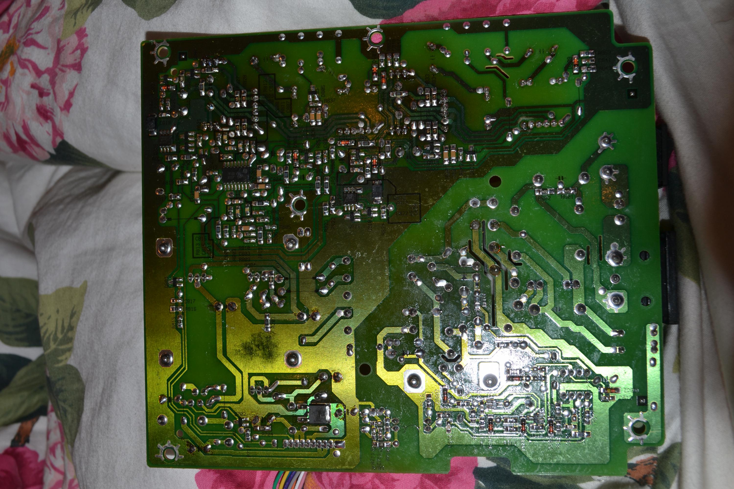

You have indicated on your post that the customer can shake the monitor to make it work but you cannot see any bad solder joints, from the pictures I can see small ring around the transformer's leg. When I work on these boards, I will also re-flow all the solder joints. See example of the ring develops around the component'e lead: http://s807.photobucket.com/user/bud...tml?sort=3&o=0Never stop learning

OK, just to be sure, black probe on the chassis, red probe on either end of the fuse and it shows 0V, then the power supply for the inverter is not working, but since the 5V power supply for the main board is also generated by the same transformer, then I will expect you not to have 5V power supply working either. Please post good clear pictures of YOUR board, pictures of both side of the board.Never stop learning

OK, so more likely you do not have the 5vdc output to feed the main board either. So carefully check the DC voltage of that large main DC filter cap, it should have more than 300VDC on its two legs (the reading should be Line voltage x 1.414= xxxx DCV).
I can see ring (cracked solder) on one of the AC input connector. Similar to this: http://s807.photobucket.com/user/bud...tml?sort=3&o=2Last edited by budm; 09-03-2013, 06:23 PM.Never stop learning
resoldered bad joints on AC jack and large capacitor. Measured line voltage on large cap legs - got 300V (so 300 X 1.414 = 424V DCV) so it looks ok?Comment
Re: HP 1955 Monitor Repair Guide
your line voltage is 220 x 1.414 = about 311V, so the board is getting the Main DC to feed the switching power supply circuits OK. Your board seems to match the diagram I posted on post 147. Did you down load that diagram? So with just power supply board by itself with the board power cord connected, check the DC voltage on the TWO LEGS OF Zener Diode ZD601, DO NOT TOUCH anything on the board with your hands!Never stop learning
