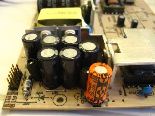

            I believe that Mag use the same circuitry for the 17" and 19", as shown by the enclosed pictures. For reference, here is my post on the repair of a MAG 17 titled "MAG Innovision LT716S Model 700P".
            I had time today to look again at the power board [1] the primary & secondary fuses tested OK when I used a sharp probe to get through the oxide [2] primary rectifier and both secondary Schottky dual-diodes [one dual common-cathode for the +5VDC and one dual for the +12VDC] tested OK with a multimeter on 'diode test' settings. I then recapped with capacitors bought at HSC in Sunnyvale: six 470mF/25VDC/105deg and one 330mF/25VDC, see enclosed photo. Note on the photo that the output pins of the power board are clearly marked +5VDC, +12VDC, GND, BRI, LPON.
            The LCD now is fully functional.

              Low voltage kills the cap quicker, but if it kills it instantly you'd know.
              The mag does use the same boards, the caps are guaranteed crap. Replace all over 200 IMO.

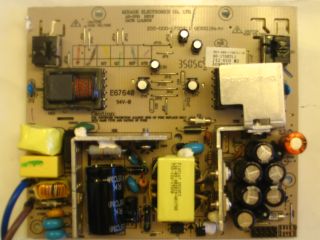

                    I believe that Mag use the same circuitry for the 17" and 19", as shown by the 1st enclosed picture. For reference, here is a summary of my posts on the repair of a MAG 17 titled "MAG Innovision LT716S Model 700P, seven bulged Xunda's".
                    I just opened a MAG Innovision LT716S that does not power up. The power board is another typical case of 'bad caps' bulged and 'oozing on top', as shown in the 2nd picture. These caps are all on the secondary side of the power supply: seven Xunda capacitors, including six 470micF/25V/105deg and one 220micF/25V/105deg. /---/. I then recapped the board with capacitors bought at HSC in Sunnyvale: six 470mF/25VDC/105deg and one 330mF/25VDC, see enclosed 3rd photo. Note on the 3rd photo that the output pins of the power board are clearly marked +5VDC, +12VDC, GND, BRI, LPON.

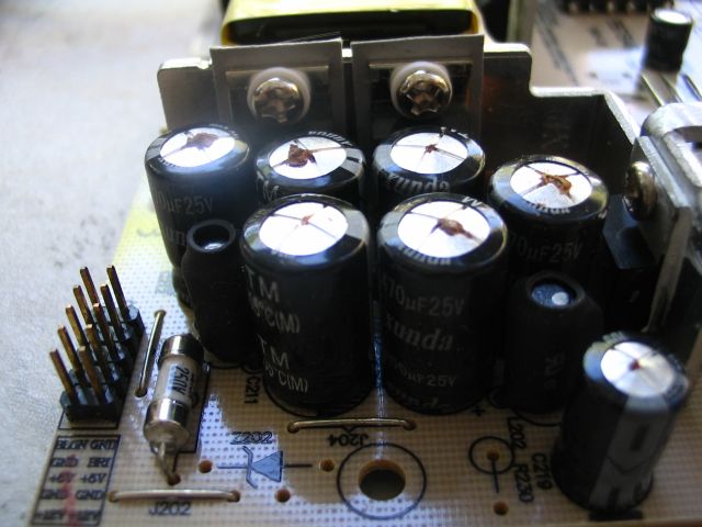

                          Ok guys, I have a Cicero 19" LCD I purchased from Futureshop a few years ago, and it had these exact symtoms. At the time I didn't know, and put it in the closet, well I pulled it out and took it apart before I wanted to throw it away.
                          I noticed the 6 470uF caps were all toasted, so I replaced them with 470uF 63V ones I purchased locally.
                          I still have the same 2seconds on, then off issue. I can't see anymore problems with the board components, and I am stumped. Anyone have any ideas on where to look next?
                            #33
                            Re: Mag LT916s Model 900p 19" LCD dropping like flies
                            Well everyone, I got mine fixed. I replaced all the 470uF caps, as well as the 2 100uF caps and the 1 220uF caps with all larger voltage rating ones. I also replaced one of the 250V 3A fuses near the 2 100uF caps and everything now works great.
