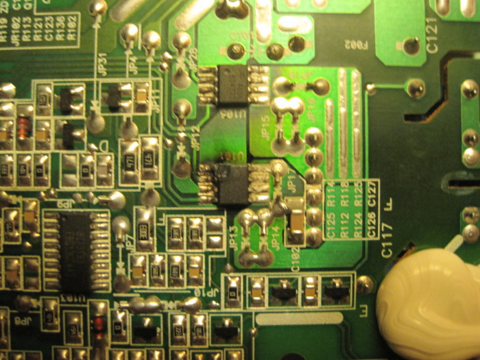

          Re: Mag LT916s Model 900p 19" LCD dropping like flies
          This is why I ordered a new board..
          A lot of heat and the burnt chip...
          What isthe chip that is brunt?
          The # on the chip is 4606 and BD4332
            That board has been overheated; I've seen worse. Considering the value of a 19" LCD monitor I'm not sure if it is worth repairing (other than as a matter of pride). (I just replaced a bad CCFL in a 19" Dell monitor. By the time it is sold I will have worked for about $5.00 an hour. Not a good use of my time.)
            I'm sure the IC that has shorted is listed somewhere else in the thread. It is either a dual complementary mosfet (identical to the one near it), or a dual n-channel or p-channel mosfet - the complement of the one above it.
            PlainBill
