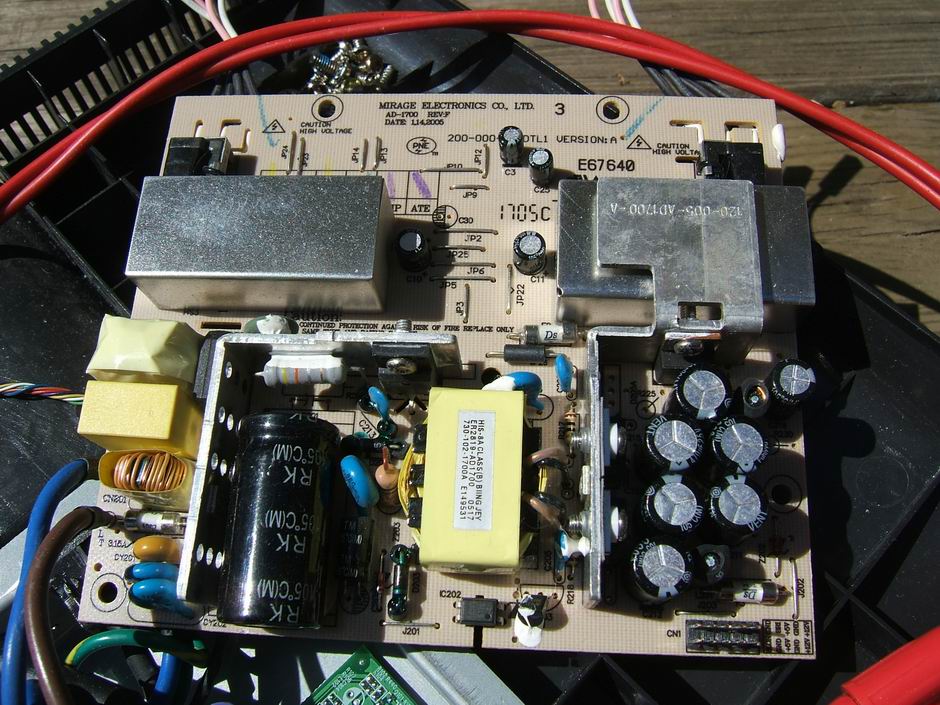

    MAG LT916s 900P Inverter Mirage Electronics AD-1700 Rev:F 200-000-170DTL1 VERSION:A
    Sticker: 860-AB0190DTL1-A AD-190DTL1 J22-001 A 5083725

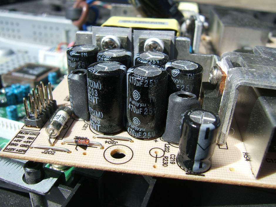

    One by one these are dying. The symptom is that it powers off 2 seconds after turning on. The first I played with the inverter long enough and swapped enough parts to break it completely. Pictured is the second. In circuit ESR testing shows 0.03 ohms with the two Fuhjyyu 470uf 25v output parallel cap pairs and 0.05 ohms with the two single Fuhjyyu output caps. I've pulled and tested the xunda 100uf 400v input cap and its 0.75 ohm ESR looks good too. 100uf caps C10 & C11 are 0.00 ohms so are unmeasurable in circuit and the remaining caps test with good ESR.
    The 3rd dead Mag LT916s has been delivered and is working but like the others the runtime will get shorter and shorter until it gets to 2 seconds where it can't be used any more. I haven't even opened it up.
    Playing with the first inverter I found that the boards will shut down if you pull too much current, and those sparks and corona effects sure are nifty. One problem might be that aging lamps have increased their current draw and this board doesn't have enough headroom. Unfortunately it's not worth buying new lamps just to find out the old lamps are fine. Turning down the intensity may alleviate this problem for a while but that's hard when the runtime is 2 seconds.
    I've also fixed a PC power supply by replacing all of it's bad brand good caps with good brand good caps. That might mean that there are things that go wrong with caps that push marginal circuits out of spec that our meters can't test. Unfortunately I have no 100uf 400v caps and not nearly enough 470uf 25v caps on hand to do 3 monitors only to find out that the Fuhjyyu caps aren't bad yet.
    I wouldn't mind a replacement inverter board but since these Mirage units seem defective a replacement would need to be beefed up before I'd trust it. No one sells this inverter yet.
    Replacement LCD screens similar to this HannStarr HSD190ME12-A00 LCD are getting dumpster prices so selling the screen isn't an option.
    http://forum.electronicwerkstatt.de/...1_bz0_bs0.html
    http://www.elektroda.pl/rtvforum/topic746362.html
    http://www.google.com/search?hl=en&q...=Google+Search
    http://www.google.com/search?hl=en&q...ay&btnG=Search

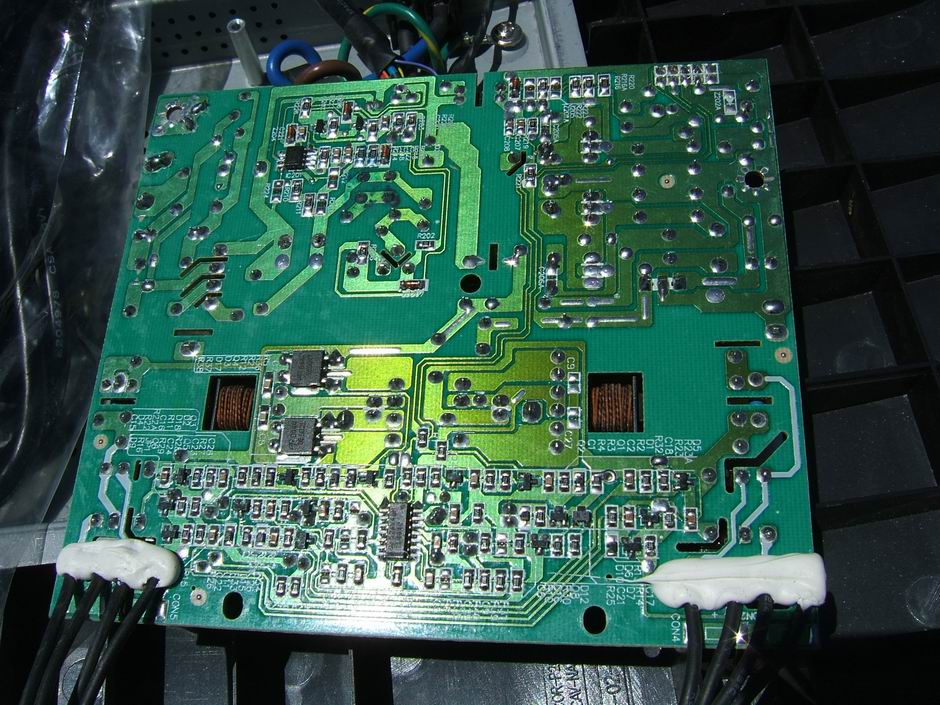

    The input is regulated by an 8 pin chip IC201 203D6 PSDI and the HV inverter has a 16 pin chip IC1 TL494C and two large transistors U1 & U2 D444 (2SD444). The schematic at elektroda.pl looks nice but it doesn't match up with what I see.
    BLON and BRI go directly into the inverter section. Perhaps I could defeat the cutoff circuit by cutting the BLON trace and hardwire it to something, assuming the BLON trace does something other than shut off the monitor during power save. The inverter probably has its own safety circuit independent of BLON.
    Fortunately we have some sun so my pictures don't suck. The pulled solder pad near the 8 pin chip is to the 100uf cap. I haven't soldered it back in yet.

    I actually fixed on of these by replacing the 6 470 caps and the 219 (220uf ?) cap, first recap job I did, with the exact same symptoms. Running fine 24/7 8 months later.

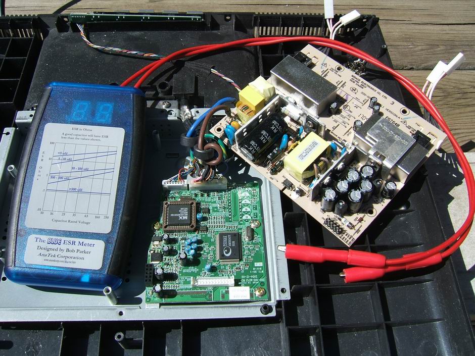

      Testing ESR is usually sufficient. I've found that both capacitance and ESR tests are almost equally reliable. ESR has more negative effect on the circuit, can often be tested in circuit, and is detectable sooner.
      Score 3 for the good guys! All 3 Mag monitors are working, even the one that a nitwit who shall remain unnamed burned out with too much experimenting and spark fun. Once I saw the pattern the 3rd time I decided it had to be a capacitor problem so I decided to attack. The pattern goes like this:
      The original owner gets tired of 2 second shut off, disconnects the monitor, tests it on a few computers, and brings it to me. I plug it in and it works for a few hours. When I come back after it has run for several hours it exhibits the same 2 second shutdown.
      The power supply runs continuously whether green or orange led which keeps all the parts heated. Knowing that we can expound:
      The original owner runs the monitor continuously until time and heat destroy some caps beyond the tolerance of the circuit. All of their brief testing between computers occurs while the circuits are still hot so they bring it to me after it fails all tests. It is stone cold by the time I test it so it runs for a long time. I leave it at an orange led which lets all the circuits heat up and when I come back it immediately exhibits the 2 second shutoff.
      Knowing the problem only happens when the circuit is hot I disassemble the monitor while it is running to keep it at max heat hoping the extra heat would more easily expose the culprit. Turns out this was unnecessary.
      Having tested all the other caps in circuit I start with the untestable caps C10 & C11 Xunda TL 100uf 25v. Fresh off the soldering iron they measure 35 ohms. Cooling for a few minutes they rise to around 90 ohms. Watching this happen live on the ESR meter is a great demonstration of the rule that heat reduces ESR. They are a bit hard to test accurately since only a few seconds of body heat is enough to drop 30 ohms so I leave them on the table untouched to maximize ESR.
      Failure #1 >99ohm, >99ohm, 57uf, 14uf
      Failure #2 >99ohm, 95ohm, 58uf, 47uf
      Failure #3 >99ohm, 87ohm, 52uf, 48uf
      Monitor #4: 1.2ohm, 1.3ohm, 97uf, 94uf
      The capacitance is 50% it's proper value. I've seen far worse caps still operational. Only one of the 6 caps from failed monitors is so far off that the need for replacement is clear. The ESR is 100 times what it is supposed to be on every failed cap. I replaced the caps in Monitor #4 even though they haven't failed yet. My 100uf 25v reclaims have 2 different ESR averages.
      Rubycon MH, Taicon VT, Jamicon TK, G-Luxon SM, Lelon LZG: 0.80-1.1ohm
      United Chemicon KY: 0.16ohm (from D-Link router)
      I chose the highest ESR 5 Rubycon and 3 Taicon.
      The burned out board had a bad 3.15A output fuse which I jumpered with a resistor lead wire cut down with a razor to reduce the current capacity. I'll find a fuse eventually. I believe that sparks that size could burn out a 3.15A fuse.
      The fuse burned out and not a chip. The board ran with ridiculous ESR. Maybe this Mirage Electronics board ain't as bad as I thought.

                      If the screen goes blank randomly then it may be a cracked solder joint on the board when the screen goes blank try whacking the monitor if the image returns thats your problem.
                      However if your inverter board is like the one pictured in this thread then it uses Fujiyuu caps one of the worst cap brands out there.
                      They attempted to take out two of my Antec power supplies before I replaced them.
                      As a matter of course I would replace all of the Fukyuu on the secondary side of the supply then continue troubleshooting from there.

                        The inverter is on the power supply.
                        I had two tiny inverter caps go and others have had the power supply caps go. There are other things that go wrong too so naming the bad part on your board requires testing. You can test or replace caps willy nilly hoping you catch it. One of the tips that helps narrow down where to look is to watch the power led as the monitor goes off. If the led goes off then the power supply is shutting down. If it says on then the inverter is shutting down.
