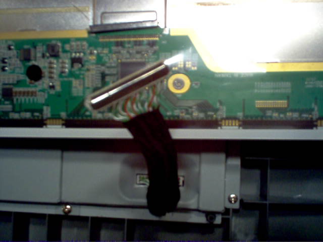

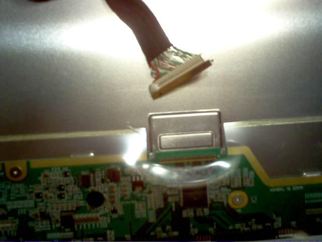

                                    Hi guys. My experiments have lead to the worse: I've completely broken the 32 pin board-to-cable connector, the one in the middle of the circuit board on the TFT panel's back, which is HSD190ME12-A00. Any experience would be extremely welcome: it doesn't look like I could solder those pins back together. Shall I find and replace the entire board - what is its make, find a connector and re-solder it - is it possible to do a 32 pin one with a regular iron, and where to look for such a connector, or maybe its better to just forget about it. Thank you for any input!
                                      Re: Mag LT916s Model 900p 19" LCD dropping like flies
                                      Pics of the cables (plus macro shots of the connectors) would be helpful here.
                                        Pictures are terrible, sorry. The cable is male, and the on board connector is female -- in pic 6 this broken piece is diagonal above the soldered pins.
                                          The picture I've mentioned where you can see the broken piece and soldered to the board pins (kind of see, since pictures are really bad) is "connector 048", and it is # 6 on the list in the previous message. I fill totally lost about that stupid brake and await on help from the experienced people. Be grateful for any input. Thanks.
