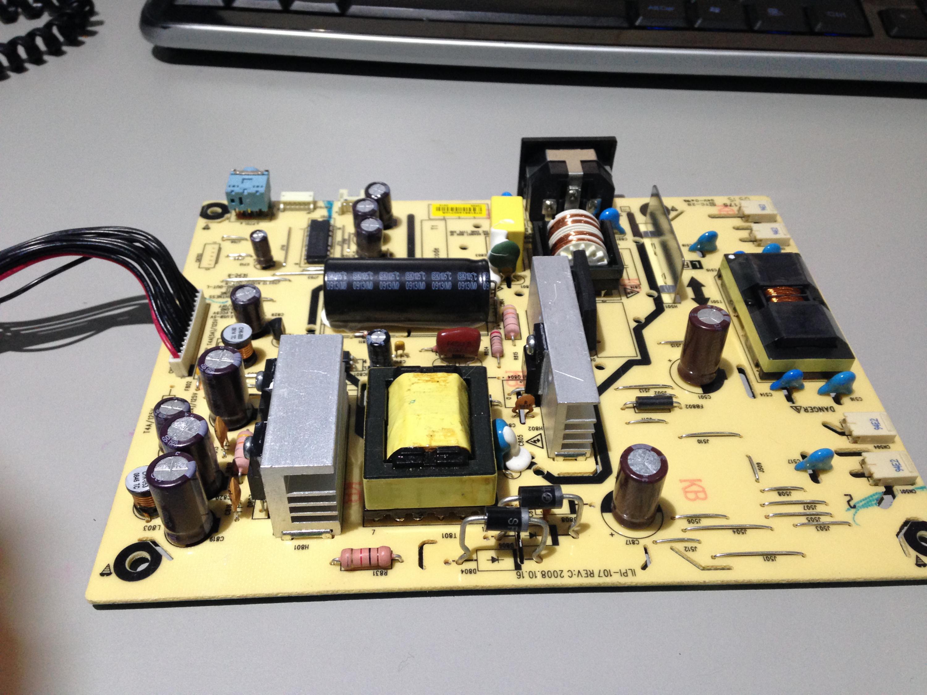

    Hello ! I have this Benq E2200HD here i got for free. It powers on, goes to black after showing the benq logo and saying no signal. With a flashlight, image is displayed with a pc input so it's backlight failure.
    Here's a picture of the power supply with included inverter. Caps LOOK fine, however they are JAMICON in the inverter section (270UF, 50V)
    The smaller one at the other end, there are 3 25V 680UF Su'scon (wth), 5 220UF Su'scon, 1 black 25V 47UF Su'scon near the big cap, and a smaller 10uf 50V near the audio output.
    I've reflowed most of the pins on the bottom of the board in the inverter section to start. I'm not so sure what i should do next, i'm able to power on the screen's CCFL with an external inverter. thanks !!!!
    Oh, here's the actual picture of it attached. thanks for any help !!!

    Did you check the resistance of High voltage windings of the inverter transformer?

        check smd mosfets on bottom, blue high voltage capacitors for short or leakage also to be sure..

          Is that a pico fuse F8802 on the Inverter side, ?? and have you checked that ??? also do as Budm asks ref the transformer.

            budm: don't know exactly if im looking right here, but i see 780ohms on each side
            selldoor, i did a few tests.. i mean i know it's the inverter that's in trouble. When a pc signal is connected, i see the faint image using a flashlight. works for 2-3 seconds
            davi.p : well, they don't look to have any shorts (the mosfets), they seem to tests ok. i'm not sure how to properly test the blue hv caps though ! i only have a fluke 115 to poke around.
            rtech; fb802 is a pico fuse yes and it tests ok !

              I would have thought FB802 the black one in the middle is a ferrite bead however there looks to be a small yellow fuse at F802 near the connector
              Have you tested that also?

                Yes, tests good as well !

                      If you don't want to go crazy finding a spare test lamp, disassemble the screen and see if the lamps have darkened ends, if yes them are to change.

                        AH ! fixed this one. I just reflowed everything with fresh solder in the inverter section, re-assembled, and voila !! as new. tested for hours, it seems it's the only thing it needed, sounds odd no ? visually all looked fine...

                          Some earlier Benq are known for bad solder quality..

                              Yeah, i did reflow them but never tought it would have fixed it so easy, so i didn't bother to re-assmemble to test... but i should have, it fixed it
