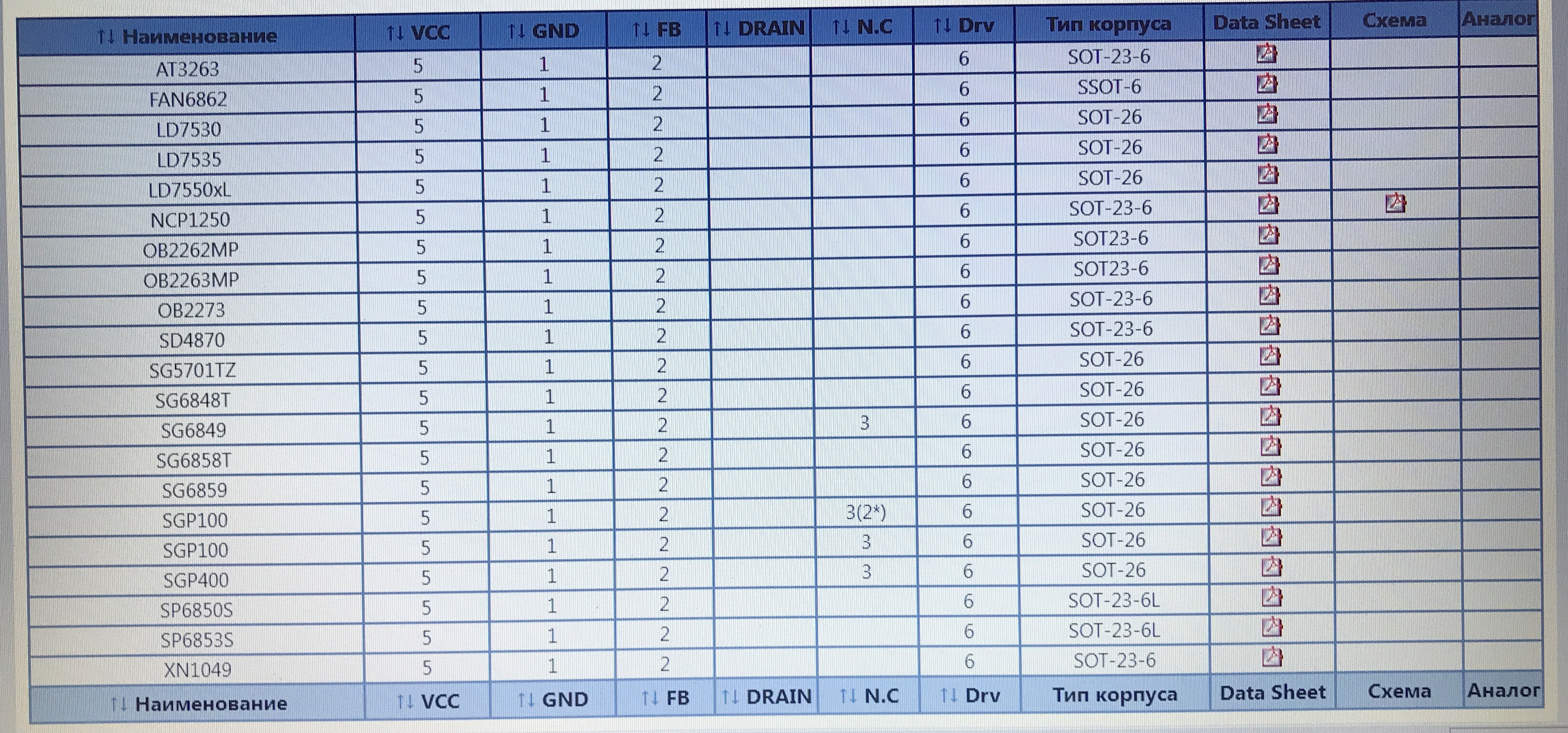

    Benq Zowie XL2540K / Power board failure / 6Pin-SOP-Chip identification
    I've got a Benq power board of a XL2540K monitor which suffered from a power cut and is since defective / won't turn on. It's got obvious defects, some blown resistors, some burning around the drain pin of a MOSFET...
    ... and some 6-pin IC I struggle identifying, that is driving said MOSFET.
    The IC is labeled as IC601, so someone with a circuit schematic could probably identify it really quick, unfortunately I can't find the schematics.
    In other power boards of Benq for which I did find the schematics, IC601 is an 8-pin NCP1200 PWM controller - I suppose the function of this 6 pin chip is the same.
    See the photos attached.
    Pin 1 - idk, i suppose GND
    Pin 2 - connected via optocoppler to low-voltage/DC side
    Pin 3 - seems to be connected to GND via resistor
    Pin 4 - connected via resistor to Drain of MOSFET
    Pin 5 - idk, maybe VDD - i can't really see a direct connection to the plus of the rectifier
    Pin 6 - connected to the gate of the MOSFET
    Could it be an OB2263?
    Thanks for any help,
    kindly,
    Sepp

    If you see any markings on it, gently wipe it with alcohol or acetone with an ear swab to wash off the varnish coating and look under a magnifying glass at what is written on it.​

        I'll see if I can get it under a microscope.
        Thanks for that table, that looks as though there aren't that many options actually and probably one out off all those might do the trick.

          Can you tell me which website you used to filter for those components?
            Hello, you need to register
            https://**************/forum/78-3771-1
