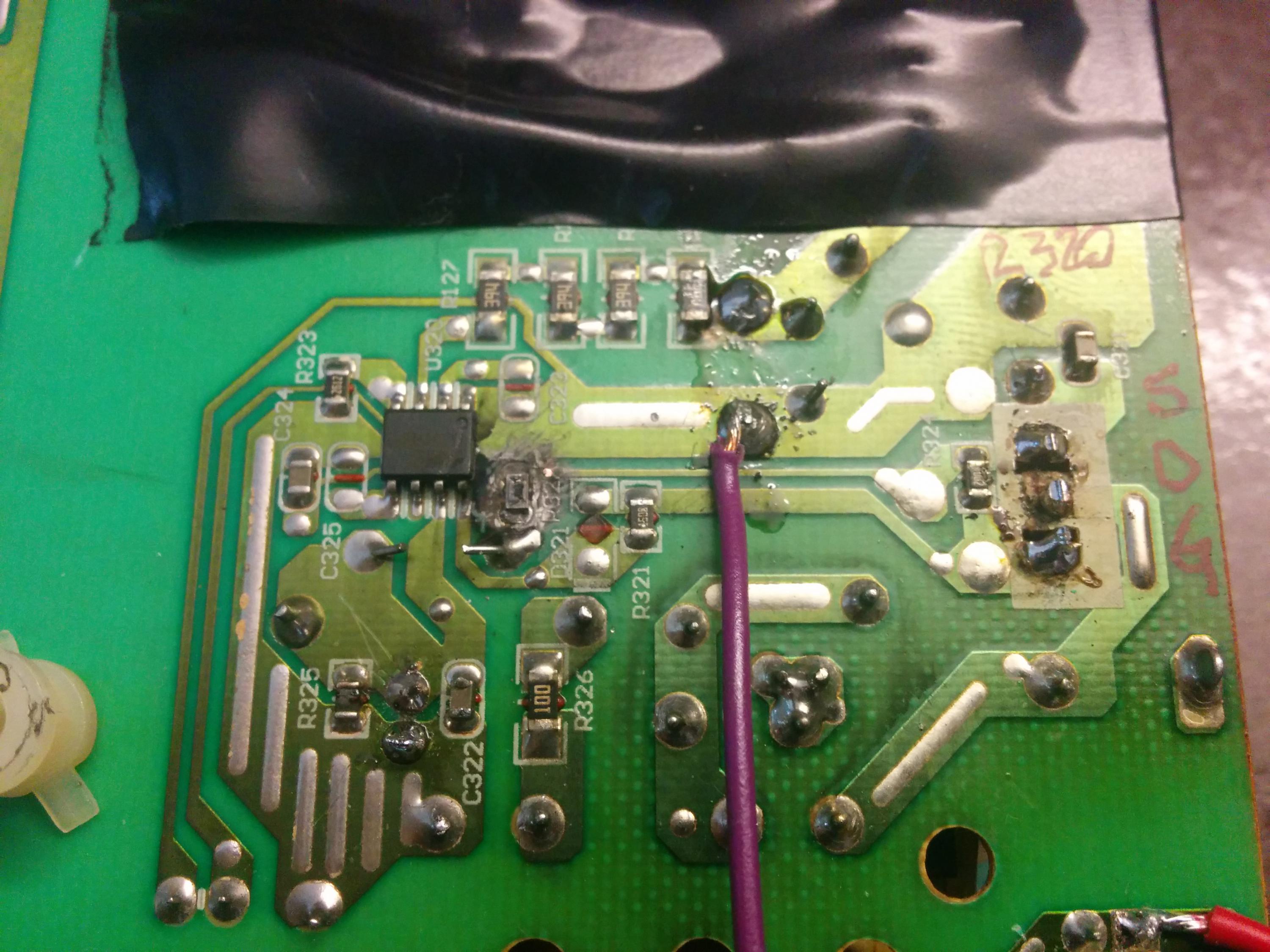

          Yesterday my VX724 died. Started with the power led blinking, and then died. After disassembling I noticed that the main cap had some fluid leakage.. changed the main cap, the 220uF caps and the 330uF caps. The others seems OK.
          The main cap is charged but there is no 12v at the output. I disconnected the PSU and disconnected the inverter (opened the jumper 9 that connects +v from 220 caps to +v of 330uf cap)
          I checked VIN of SG6841 and it's ok, but there is no PWM output and no signal in the gate of the mosfet (checked with oscilloscope, GND = negative of the main cap)
          I don't know what else to check.. I will desolder the mosfet and check it.
          Thanks!!!

            What do you have on VDD pin, it can be that the startup cap on the VDD pin is bad.
            From spec sheet, the Vdd must reach 16VDC for it to atsrt up:
            The turn-on and turn-off threshold of SG6841 are
            fixed internally at 16V/10V. During start-up, the hold-up
            capacitor must be charged to 16V through the start-up
            resistor so that SG6841 will be enabled. The hold-up
            capacitor will continue to supply VDD before the energy
            can be delivered from auxiliary winding of the main
            transformer. VDD must not drop below 10V during this
            start-up process. This UVLO hysteresis window insures
            that hold-up capacitor is adequate to supply VDD during
            start-up.

                  Bad news.. I replaced the mosfet (CER 541) with a IRF 540 and somethin exploded...
                  I remember that the SG6841 VIN pin was something like 3.2V.... I will try to fix the board and try again.

                    here a pic of the damaged part.. I think is R628
                      #110
                      Re: VX 724 black screen green light flashing
                      IRF540 has Vds of 100V, your power supply if it is 230Vac, it will be exposed to about 330VDC. You may have also damaged the SMPS IC due to blown Gate drive network parts as shown in your picture.
                        Damn,.. so CET541 (original mosfet) is not IRF 541...

                          I didn't find any capacitor in the startup circuit.. From +V of the main capacitor, there is four 390K resistors in series then to VIN.. and no cap to gnd.
                          Maybe the SMPS IC was damaged before the blown..
                            #113
                            the cap will be on the VDD pin not at Vin pin. See the spec sheet of the IC and how it works, But at this point the IC is probably damaged by now.
                              Id suggest R327 as a description R325 doesnt look too happy either
                              By the way where is this part CET541 - doesnt get a mention in the rest of the thread and doesnt google??

                                the cap will be on the VDD pin not at Vin pin. See the spec sheet of the IC and how it works, But at this pint the IC is probably damaged by now.
                                OK, found it, and also replaced before killing the SMPS ic.
