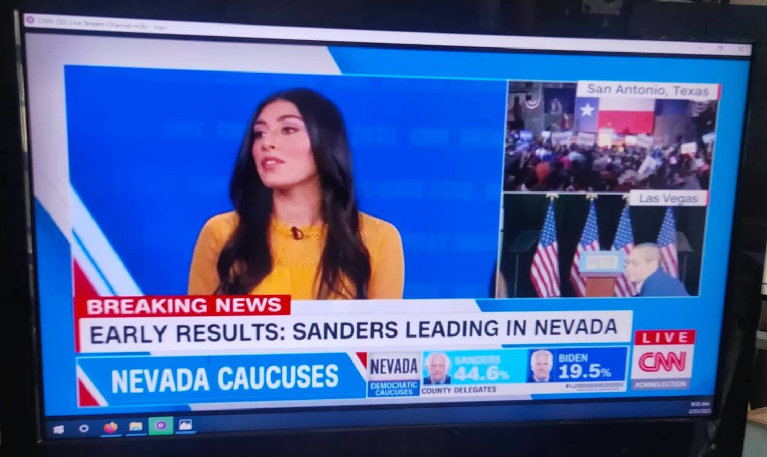

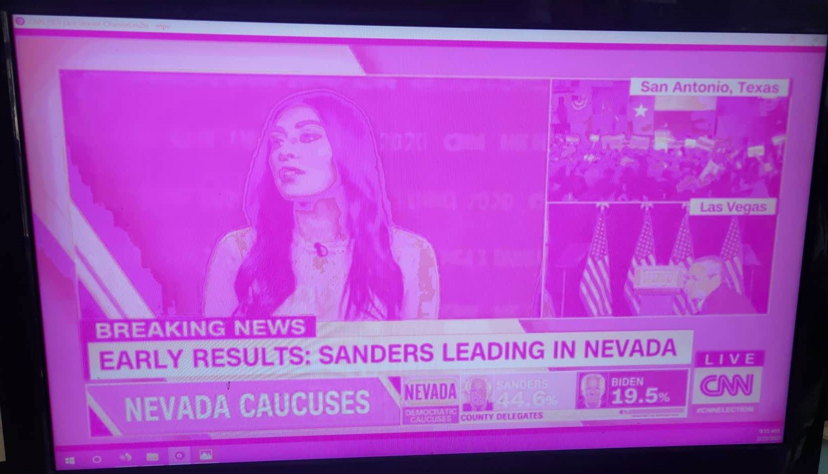

    I have a Dick Smith 37" LCD TV, Model GE6804. I am using it as PC extended monitor only.
    Problem is while watching tv, I hear a semi loud click(like a electrical breaker tripping due to overload, just sound like it but no actual electrical overload), then screen is covered with green or pink. I can still see the original picture image but overlayed by green or pink. See attached images. Pink.jpg is what I see, and Normal.jpg is before green or pink screen, What I captured was pink screen, but about 80% of time it's green and 20% of time it's pink.
    Then each time I either press power button(under tv) or unplug from outlet then re-plug in. Then normal picture returns. At first I thought physical separation from outlet will do "hard reset" and better than pressing power button under tv, but both option gets me back normal picture.
    Now this problem been happening for over several months. (Before this I had the tv for over 10yrs and NEVER a single problem). At first few times a week, then daily then several times(sometimes over 10 times and other time under 10 times) a day. Then few time nothing for entire day. Sometimes happens ever few minutes for 5-10mins, the other times nothing happens for hours or even over 10-15 hrs. I would IF it was something overloaded or heated, then as soon as power is back on problem will surface again. Very inconsistent, this hard to troubleshoot.
    Like I said each time I turn off tv then on again, and 100% of time back to normal picture.
    So I am not sure if something is overloaded? overheated? which triggers green/pink screen. Then after I turn tv OFF/ON then back to normal like tv was reset, or during OFF something was reset.
    One interesting observation about green/pink screen. When I do a print screen, green/pink screen is not captured, It's normal picture, even though LCD screen is covered with green/pink. So somehow green/pink is not part of normal picture coming thru T-CON or main board(??). Green/pink is overlayed color on top of normal picture.

    In last 30 mins...screen turned green 3 times and pink twice. I wonder why different colors? Rarely (only few times out of hundreds) screen turned blue. Like I said mostly green, and pink little less
