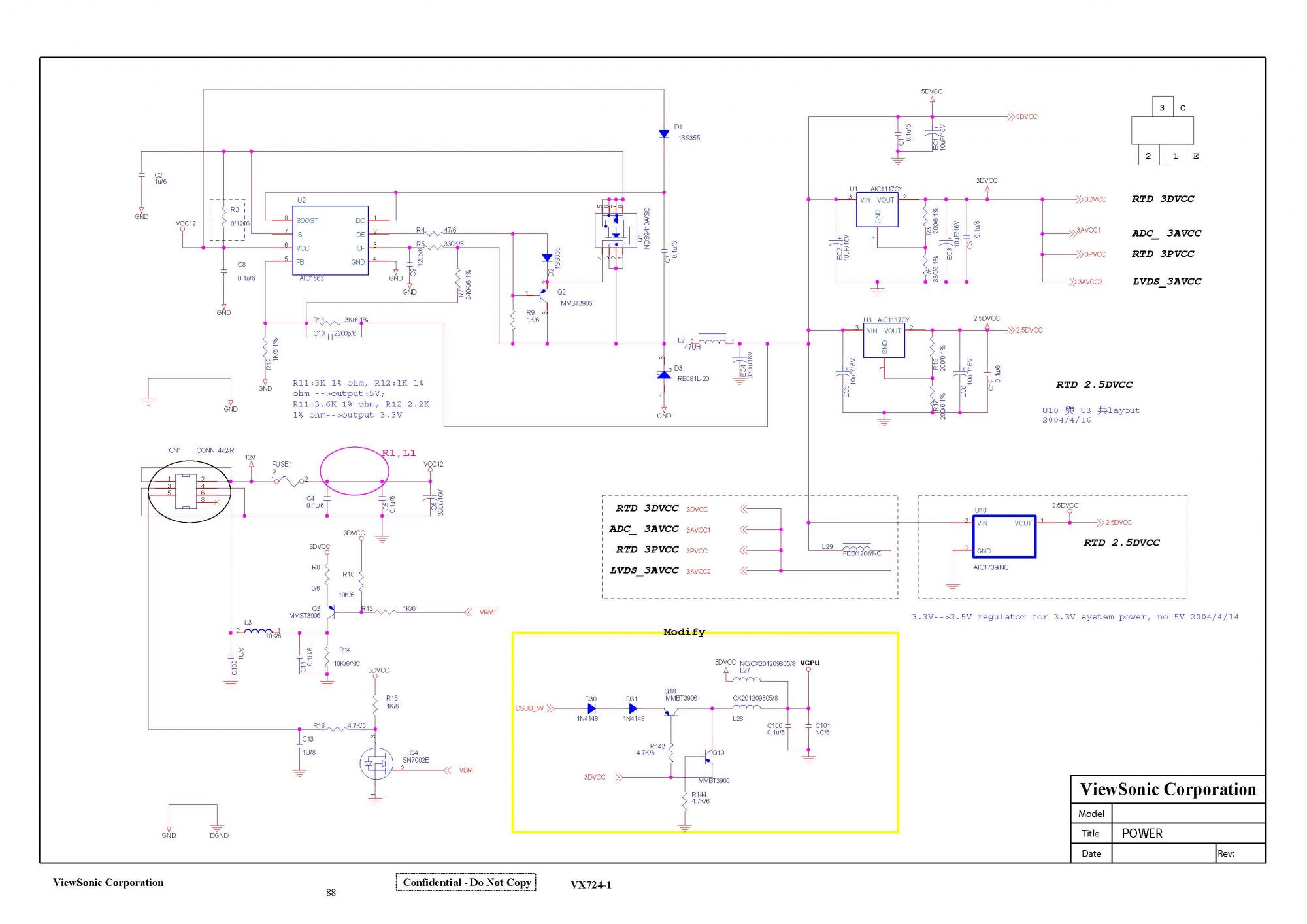

                #67
                Re: VX 724 black screen green light flashing
                Okay then, I'm gonna find these voltage regulators on the market because if I buy them on eBay, it'll take at least 15 bussiness days.
                But first of all, I'll have to look for the number of the resistors.
                I found the service manual for this monitor. It says that if the display color is "abnormal" then I should check U3 (which is a voltage regulator). I'm looking at the diagrams and it seems that VR are shorted, the output should be 3.3v insted of 2v ...
                Is it OK if I replace it with AS-1117? It's a 3-pin voltage regulator and the output is 3.3v and 800mA.

                  #68
                  The original part number has no suffix to denote an output voltage so it sounds like an adjustable voltage regulator not a fixed one.

                    #69
                    I looked at the service manual for the logic board power supply section, it looks like it uses the adjustable 1117 series, it also has 5v step-down switching regulator also so you may want to check those caps.. The stuff in the dash line are not used, I believe.
