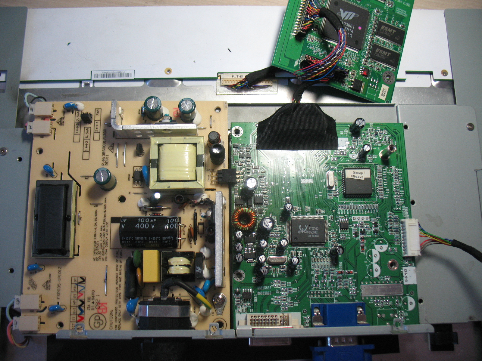

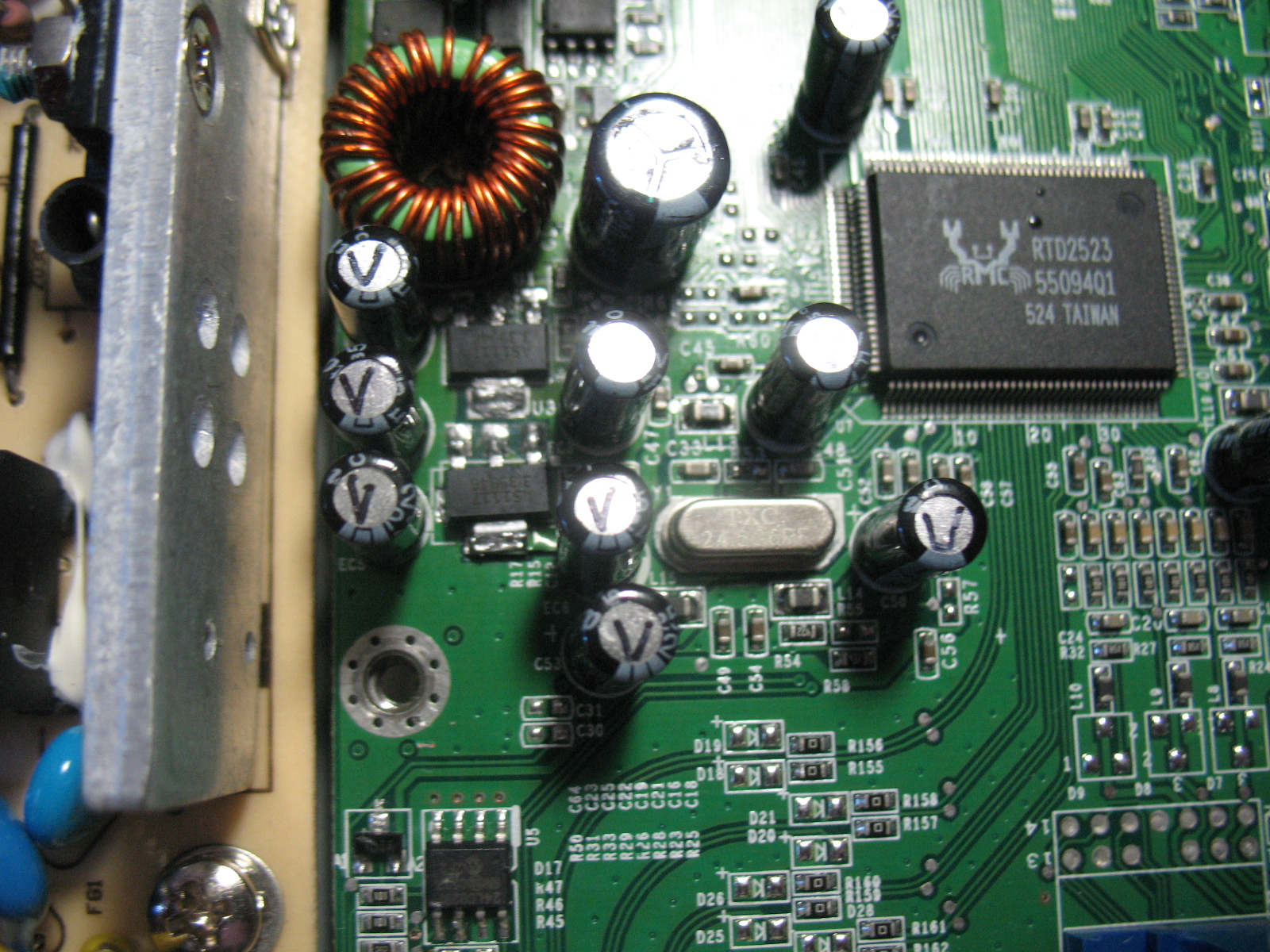

            #85
            Re: VX 724 black screen green light flashing
            Post some pics front and back of the damage zone.

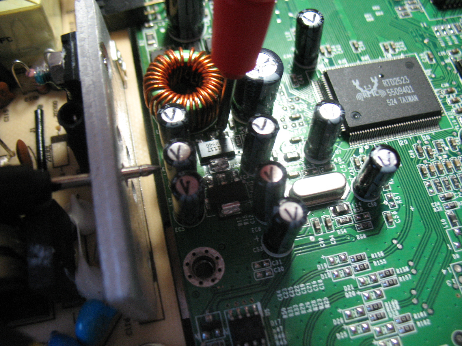

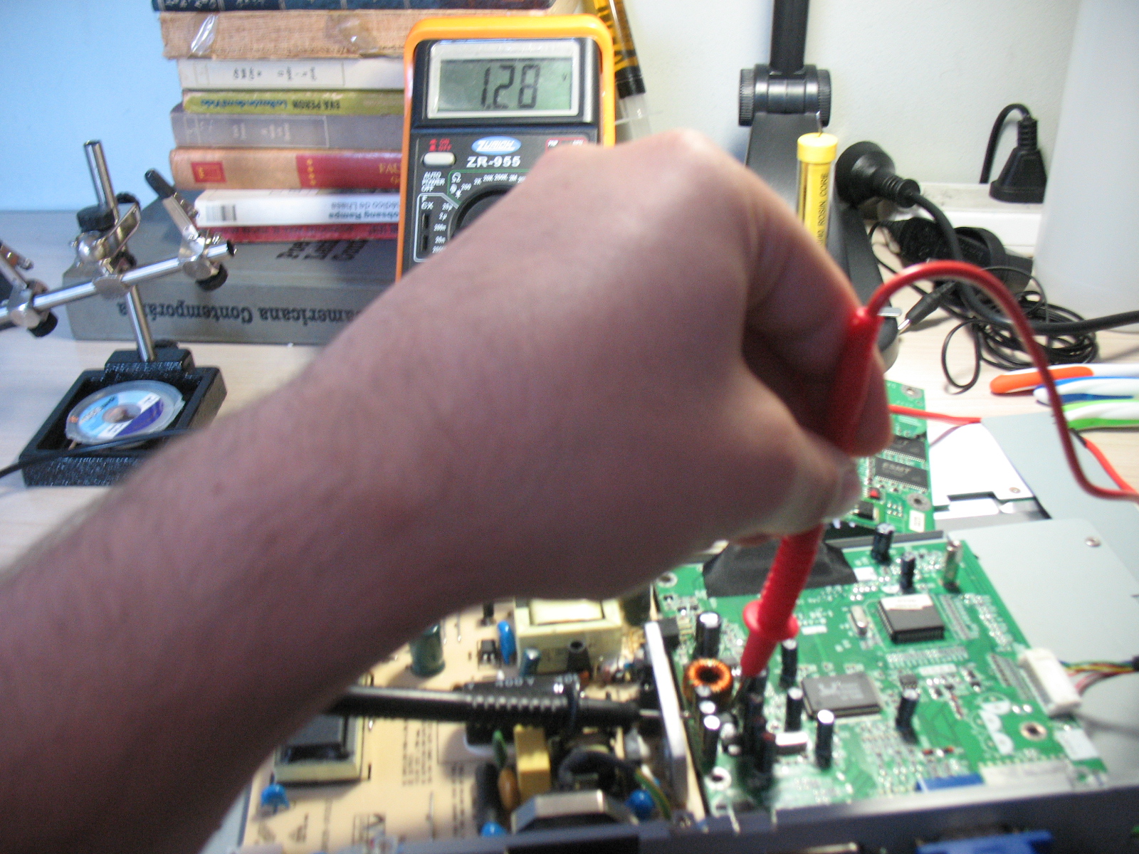

              #86
              From left to right, VR (U1 & U3) read 1,18-1,22v.
              I didn't replaced the VR next to VTI03601 because I can't find its datasheet. I don't know if AS1117 should work too. The name is 1084 - 0527CL (I can't find the datasheet).
              Black lead on ground (mosfet dissipator) and red lead on each pin.

                  #88
                  Hmm, those voltages look a bit low too me, but they could be right depending on the VR on the other board. See below.
                  What is the reading for this VR with the two new ones installed? If it is shorted, we can recommend a replacement.
                  For cold ground, either use the chassis or a ground screw on the logic board. Using the heatsink for ground is quite dangerous as it may be live with high voltage.
                  On the other, you get one bonus point for showing a picture of your multimeter.

                    #89
                    I LOLLED at that.... It should be compulsory....
                    I definitely agree with Retired caps on the skill full balancing of the negative probe. If that head sink was live you might have some real issues if it touched.
                    Fixed so far : 1 Home cinema system, 16 LCD Monitors, 4 LCD TV's
                    How to resize your pictures guide click HERE
                    Retiredcaps Ideal post example click HERE
                    • selldoor
                      Slow Learner
                      • Dec 2010
                      • 7870
                      #90
                      I laughed as well, actually when I saw the pic I knew there would be a comment
                      about the probe and the meter. Just proves I spend too much time on here.

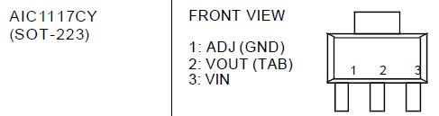

                                #95
                                Hi Nocta,
                                Just a few bits...
                                To give you an idea of what the regulars are finding confusing I will show you what you are getting on 2 of the regulators compared with what you should be betting....
                                U1
                                Pin 1 (left): 4.96v Should be ( 5V so this is close enough )
                                Pin 2: 3.94v Should be ( 3V 25% out of spec )
                                Pin 3: 2.70v
                                U3
                                Pin 1: 4.96v Should be ( 5V so this is close enough )
                                Pin 2: 3.94v Should be ( 2.5v This is massively out )
                                Pin 3: 2.25v
                                Something is very strange about the fact that both of the output readings that you have given are exactly the same.
                                I have attached a diagram which shows you where each pin number is. Can you look at this diagram and use that as a reference when giving us readings from pin numbers as i'm sure they are the wrong way around.
                                I know you have said that you have replaced some caps and you removed some caps to get to the Voltage regulators. Can you you confirm if you have changed the following? if so can you tell us what you replaced them with? EC1, EC2, EC3, EC4, EC5 and EC6
                                Can you also check that EC5 is definitely in the the correct way around and all of the others too please. ( Its hard to tell from the pictures but it looks like I get can see more white under that EC5 cap on the + side of it ).

                                  #96
                                  Hmm, those still look incorrect to me, but trying test the new regulators to see if they are shorted or not.
                                  I'm testing the new regulators.
                                  Originally posted by Jasgriff
                                  Hi Nocta,
                                  Just a few bits...
                                  U1
                                  Pin 3: 2.70v
                                  U3
                                  Pin 3: 2.25v
                                  I fully recapped the logicboard so from EC1 to EC6 are all new. EC4 330uF 16v; the rest are 22uF 25v (I did not find 22uF 16v).
                                  What I wrote is the other way around. I numbered them from left to right and the tab pointing at me. So, now, following your diagram pin 1 is pin 3 and pin 3 is pin 1.
                                  U1
                                  Pin 3 (gnd): 4.96v
                                  Pin 2 (tab): 3.94v
                                  Pin 1 (Vin): 2.70v
                                  U3
                                  Pin 3 (gnd): 4.96v
                                  Pin 2 (tab): 3.94v
                                  Pin 1 (Vin): 2.25v
                                  I really appreciate your input. Thanks.
