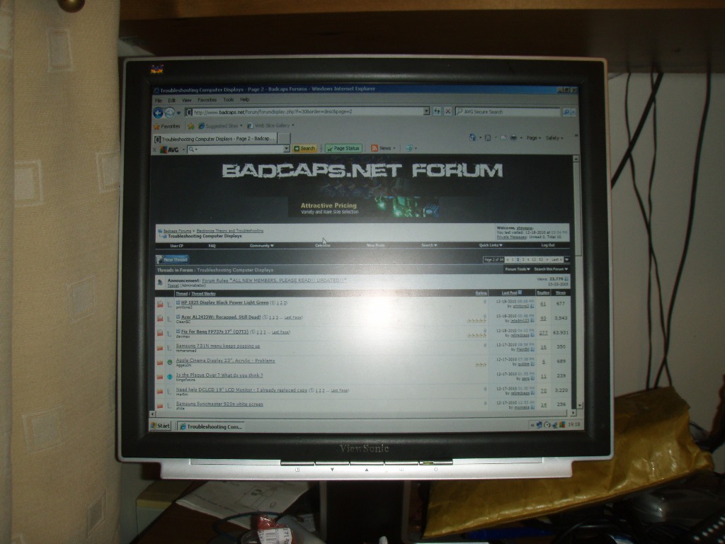

    HI All
    just an update , got some new caps to day to replace a duff H154 put them in and WOW a working screen again, been on for an hour now looks good with no funny smells..
    to get it working I replaced
    5 domed caps on the power board
    one burnt transformer (many thanks rtech, I would have struggled without this )
    The 2 small transisitors underneath above
    both of the H154 caps one of which had gone
    Thanks for the diagnosis, tips, help ive enjoyed the learning and repairing so much I bought another duff one of ebay to play with!

      Re: VX 724 black screen green light flashing
      Well done, glad to be of help......I hope the one you bought was NOT the one I was bidding on.....lol
        HI Rtech, If is was sorry, couldnt let it go
        Got my VX912 off Ebay, same board as the VX724, but screen is 2" bigger, it had the 2 seconds to black flashing , simple fix, swapped about 4 domed caps over and Bobs your Uncle
        YEEE now got a 2 screen set up
