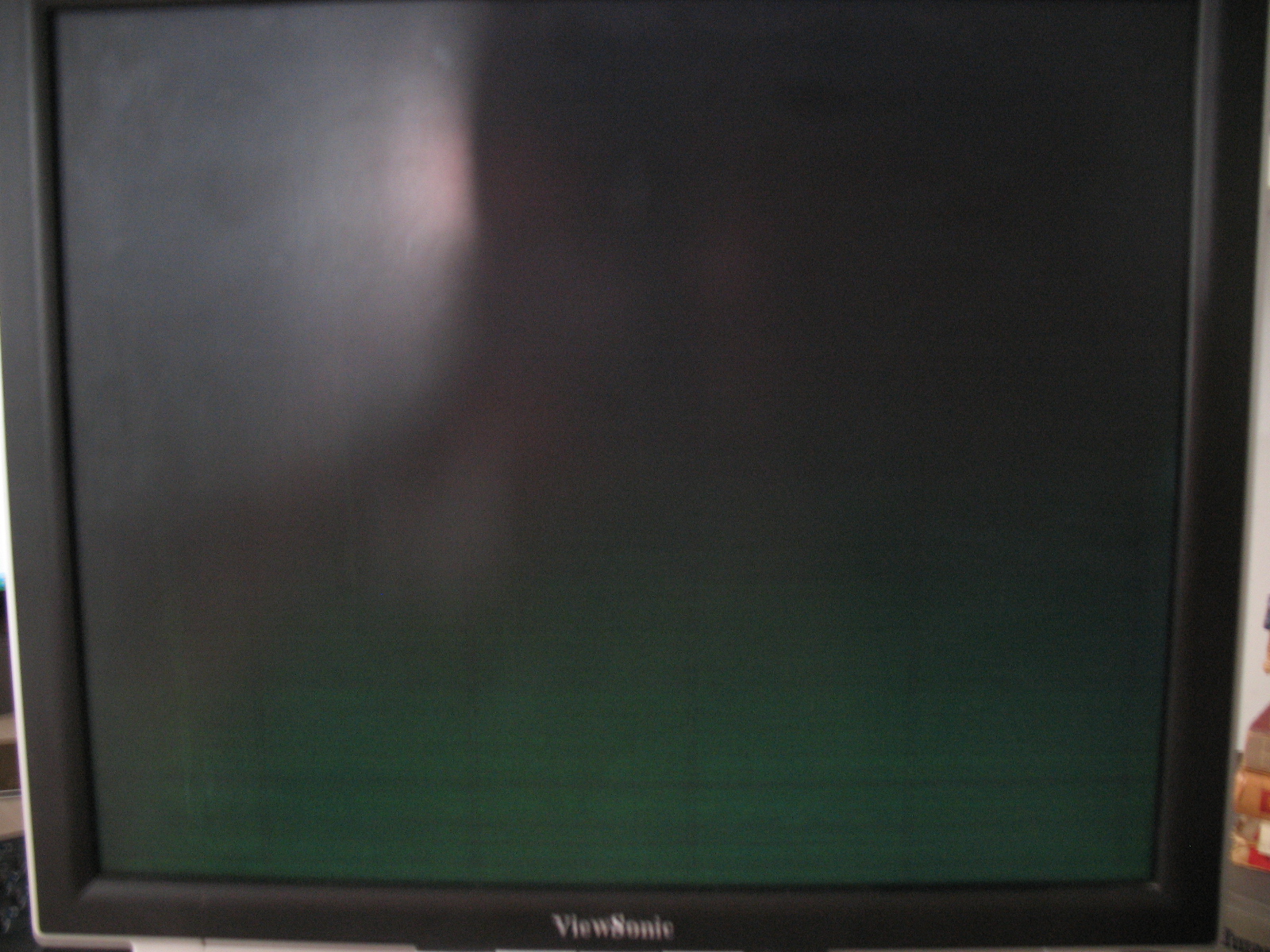

VX 724 black screen green light flashing

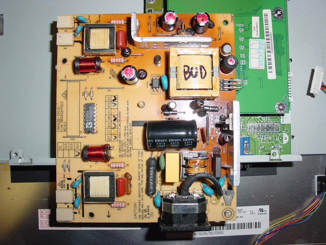

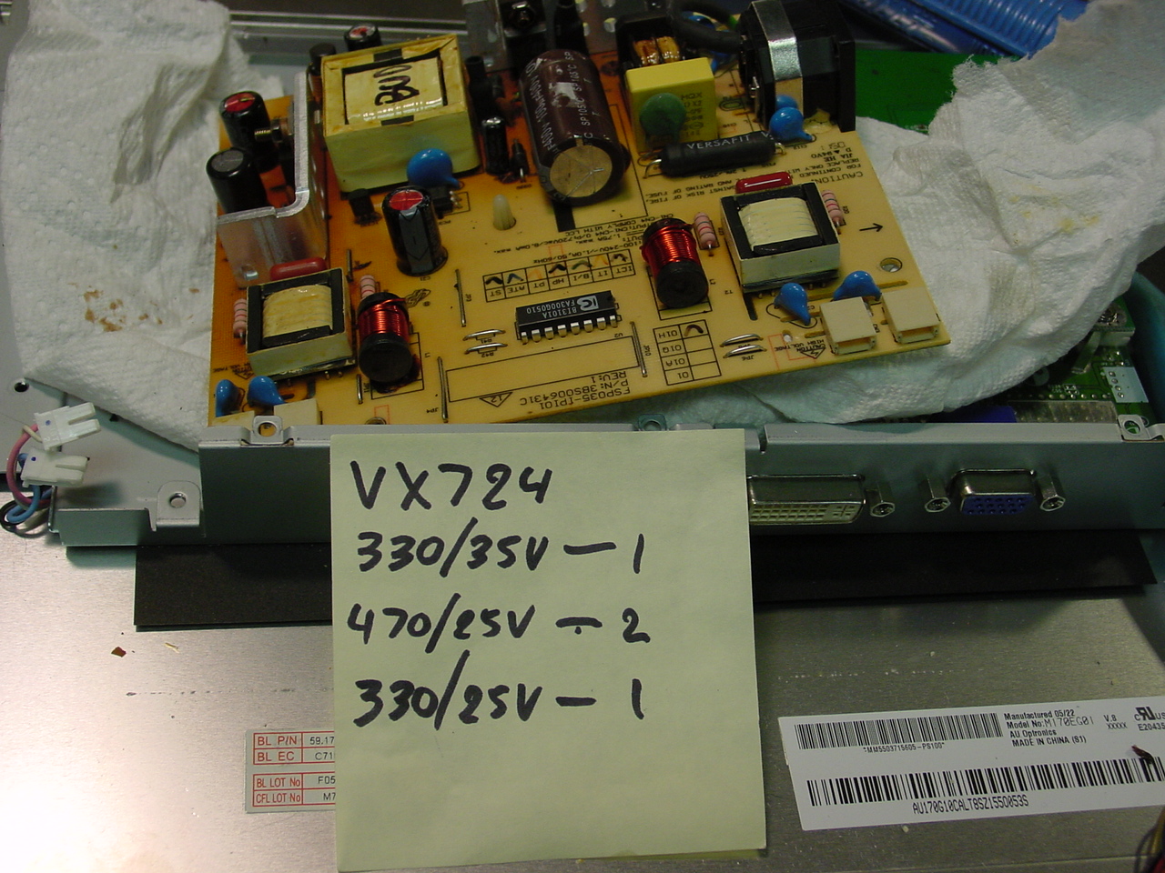

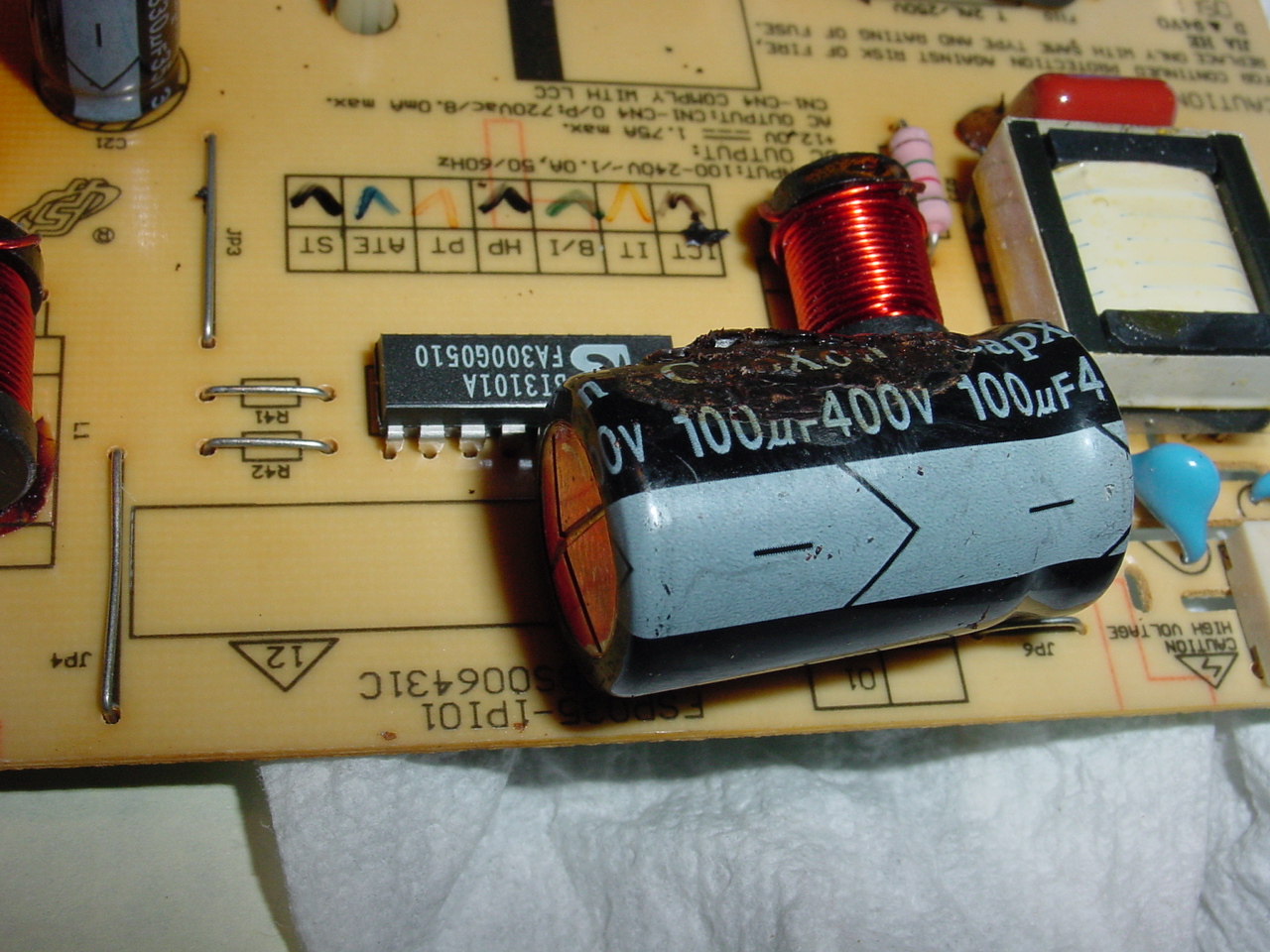

    Not sure about the substitute transistors, but one reason the transistor is blown can be due to the bad tuning cap (brown cap next to the inverter transformer), one per transformer. You should take them out and measure the value and the resistance (it should show open with the meter set to highest Ohm range), if the cap is bad, you will damage your new transistors. The not working lamp transistor reading is bad, you should replace them in pair anyway.
    More Viewsonic pictures: http://s807.photobucket.com/albums/y...udm/VIEWSONIC/

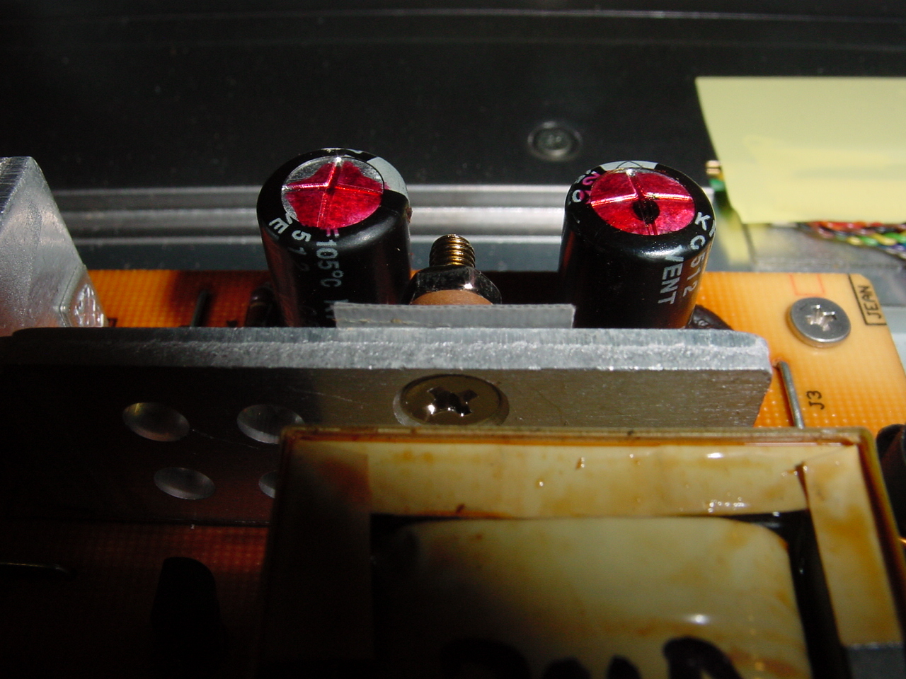

      Yeah, I have already replaced that capacitor too, the brown one. It was a bit open (literally).
      I also replaced the big cap for a new one even though it seemed to be working.

        Like I told you, I've already replaced the brown cap. The only thing left is to replace the 2 transistors but I can't find 2SD1628 or the similar ones (as far as I know, these ones should work too 2SD1624,2SB1124,2SC4672).

              I checked the CCFL transformers and I got same values on both of them. The transformer where the lamp works gave me the same values than the one that doesn't work.
              The only thing left to think are the 2 transistors. I can buy 2SC4672, it should work, right? The Vceo is 30V less than 2SD1628 but Ic and Icp are 2A less than Ic and Icp from 2SD1628.

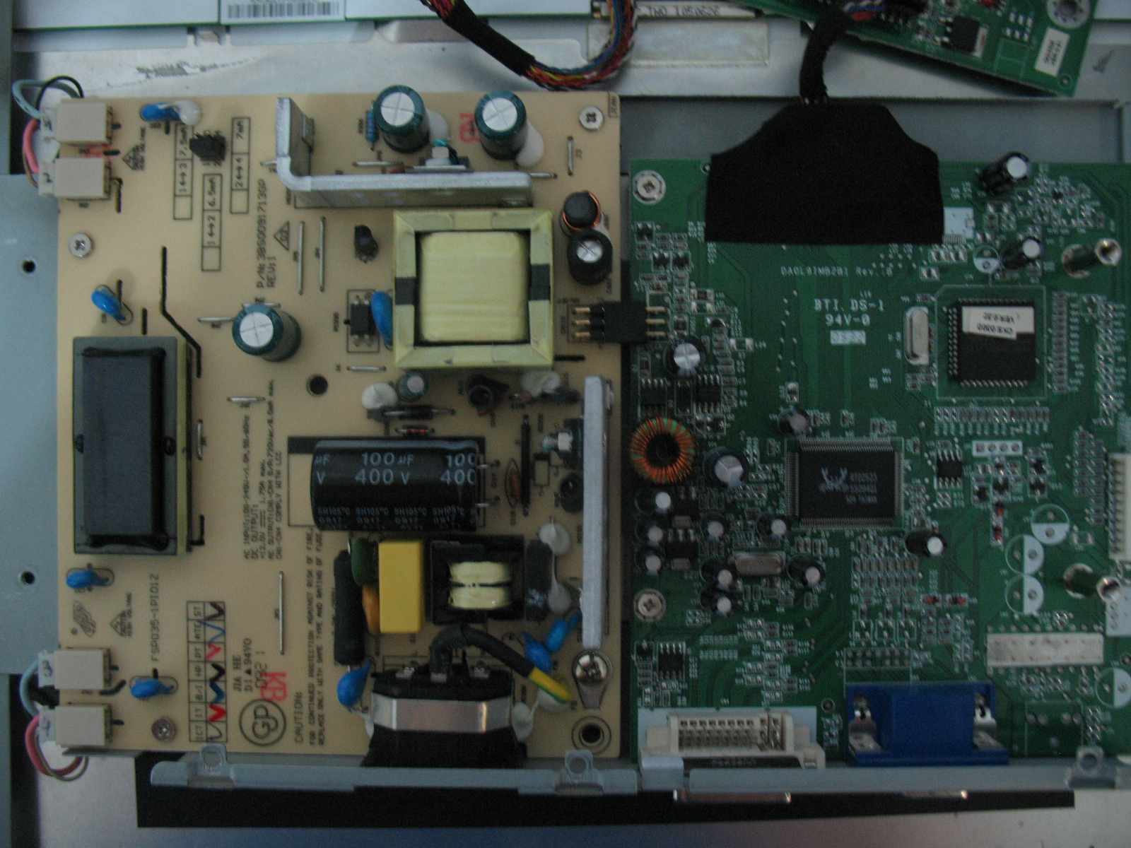

                        #51
                        Re: VX 724 black screen green light flashing
                        I bought a used board for 23 bucks. To be honest, it's much better this way because I don't have to check everything.
                        @jetadm123 I checked the user and they have 99,9% positive califications. It's a pretty high number. Thanks for that detail because I'm thinking of buying another board. I got a BenQ FP767 and its board has been already manipulated and some components are missing. Instead of buying and looking at a circuit, I'll buy a new/used board too. It's easier and i'm sure it works.
                        Thanks guys. Even though I bought the board, I learnt a lot here and that's what I appreciate over all!
                        Originally posted by budm
                        I would buy used board so you will have spare transistors, transformers, caps. Make sure to inspect the caps by the inveter transformer or replace them since that will cause the transistors to fail when those caps go out.
                        Thanks for pointing that out. I changed all the caps on the inverter/power board. I also changed (just in case) the cap close to the pins that connects the video with the inverter board and the H154 behind the transformer of the not working lamps (that one was a bit cut).

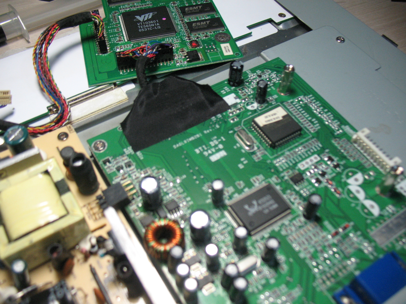

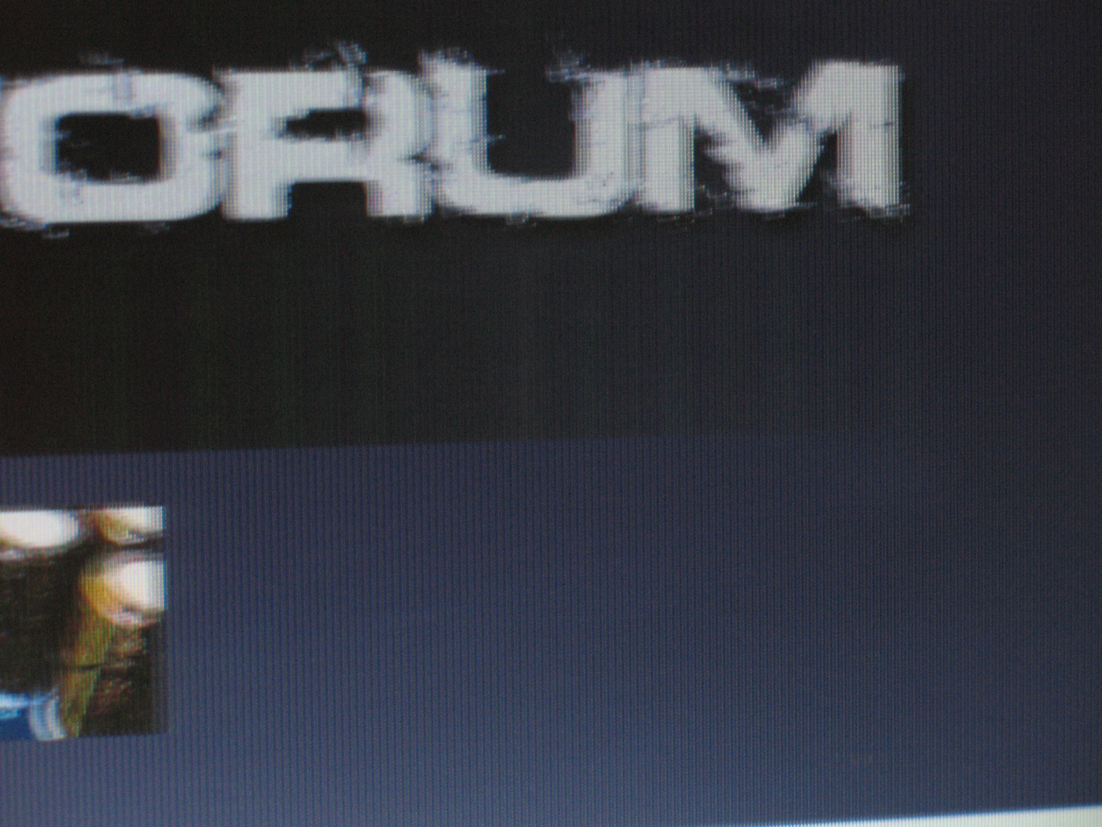

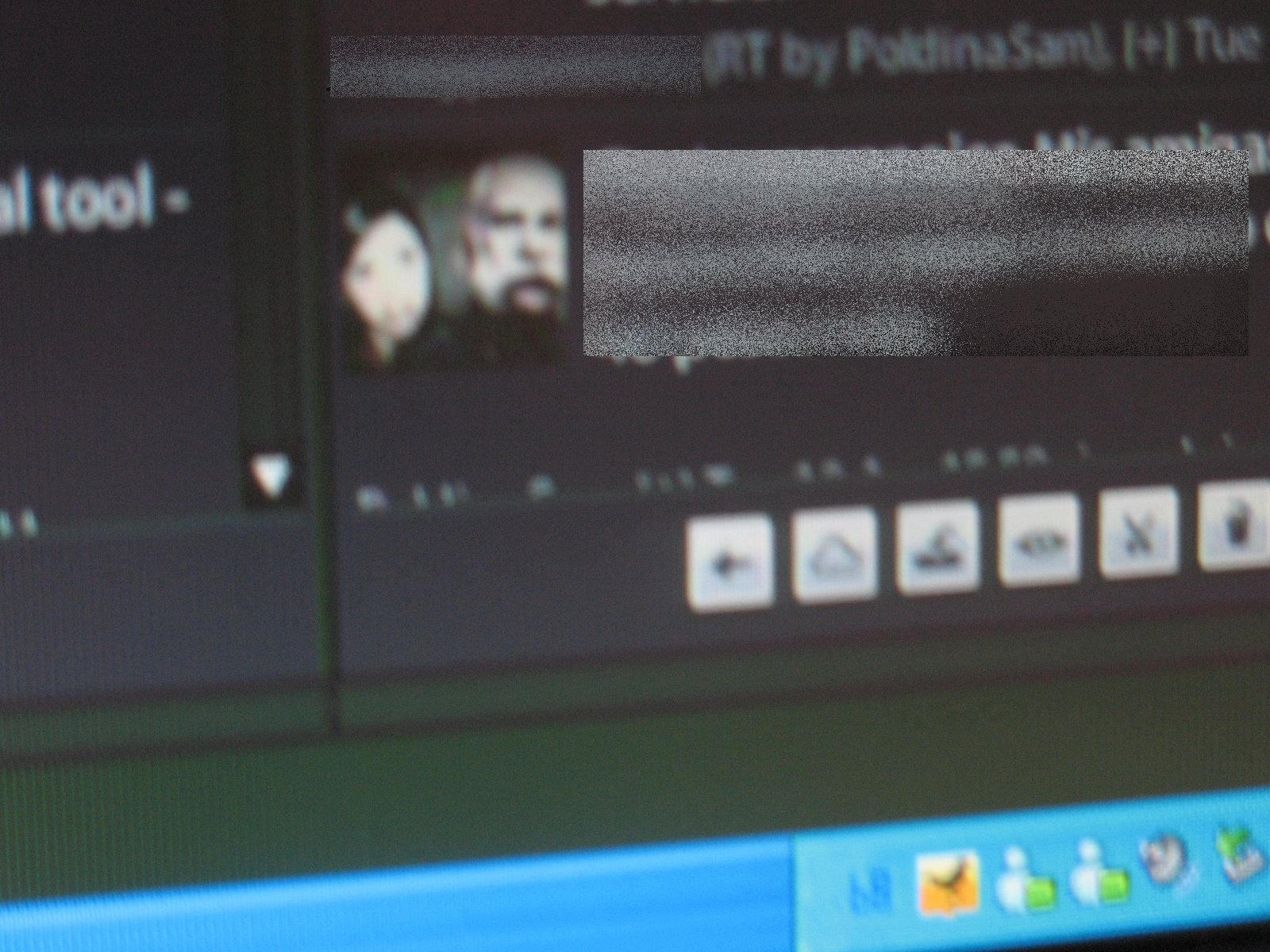

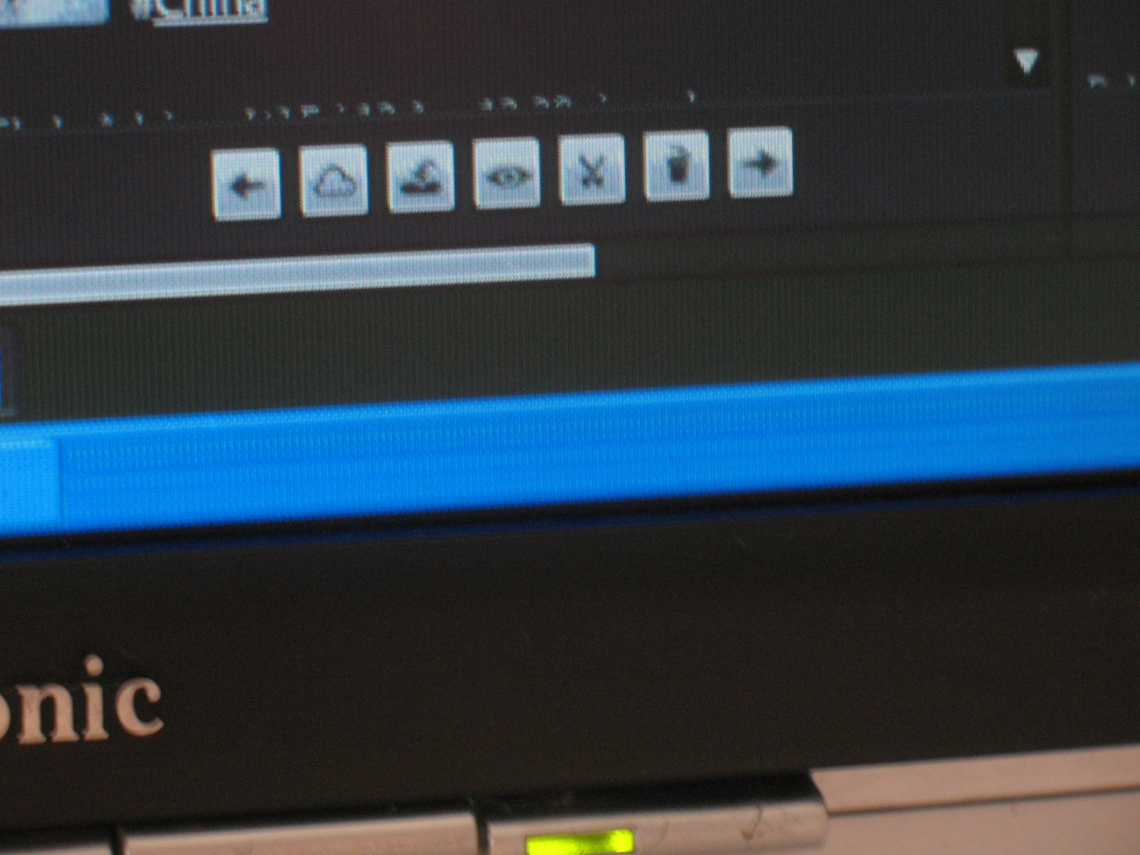

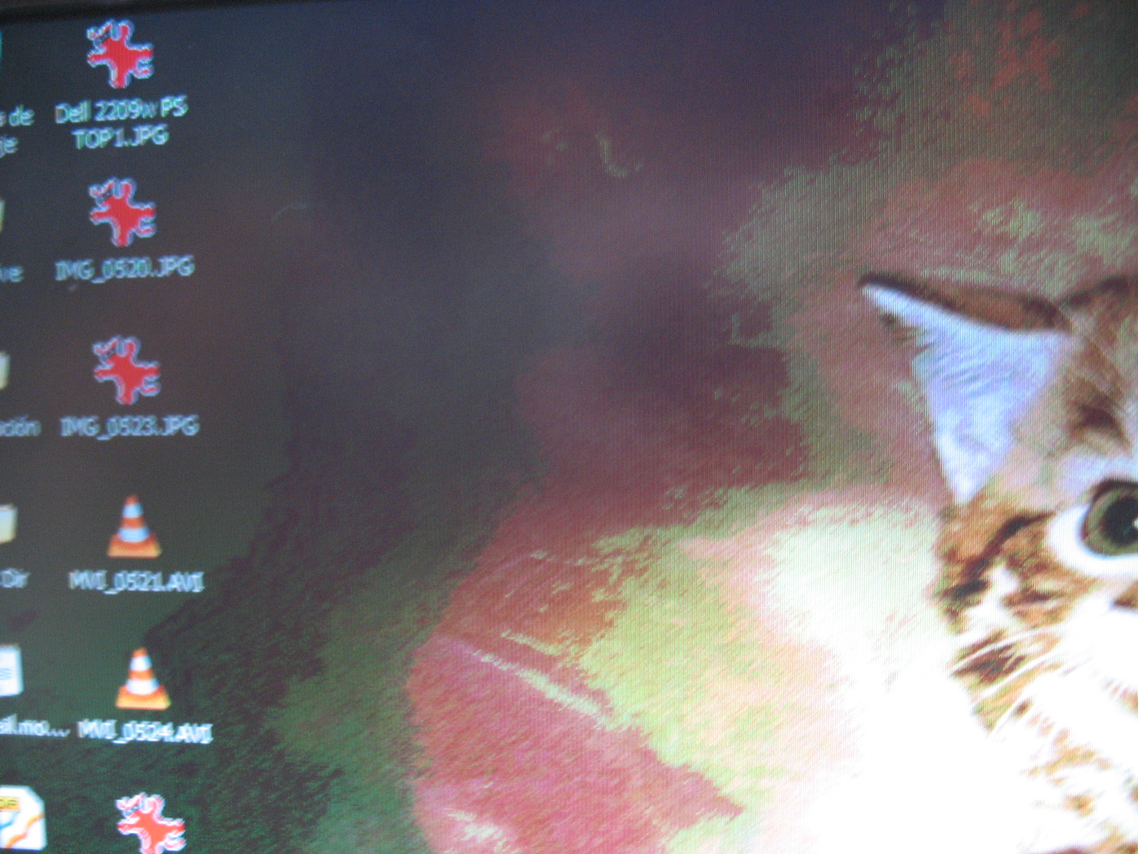

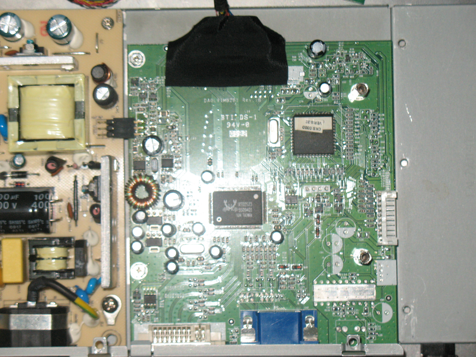

                          Ok guys, so yesterday the board arrived. I changed it and so far it's working but I have a problem and I don't know what could it be :/
                          I attach pictures and a video so you can see my problem. It's weird, like if I were set in 16-bit colors :/
                          I hope you can help me.

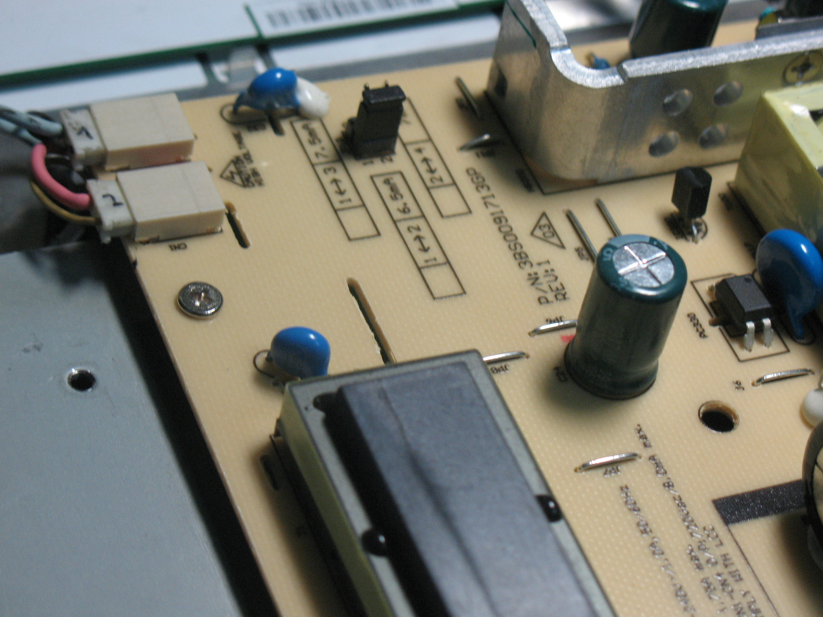

                          PS: The board has a jumper which I can set in 6,5 , 7 or 7,5mA. I didn't change it, it was set in 6,5mA. Do you think that could be the problem?
                          I'm starting to doubt, maybe the lamps are not working great.
                          http://tinypic.com/r/1z9gk4/5
                            #53
                            That is the jumper to set the inverter board to drive difference CCFL bulbs current as needed for particular lamps since the same board can be used in the smaller or larger LCD panels.
                            I am not sure what I am seeing in your pictures.

                              #54
                              So, what you think I should try set the jumper at 7mA and see what happens?
                              I know pictures are not clear. The problem is, for example, if I have a black square, I see it a bit grey and with green lines. Am I clearer now?
                              I attached new and better pics.
                              Thanks.
                                #55
                                OK, I see the picture problem now in #2 picture.

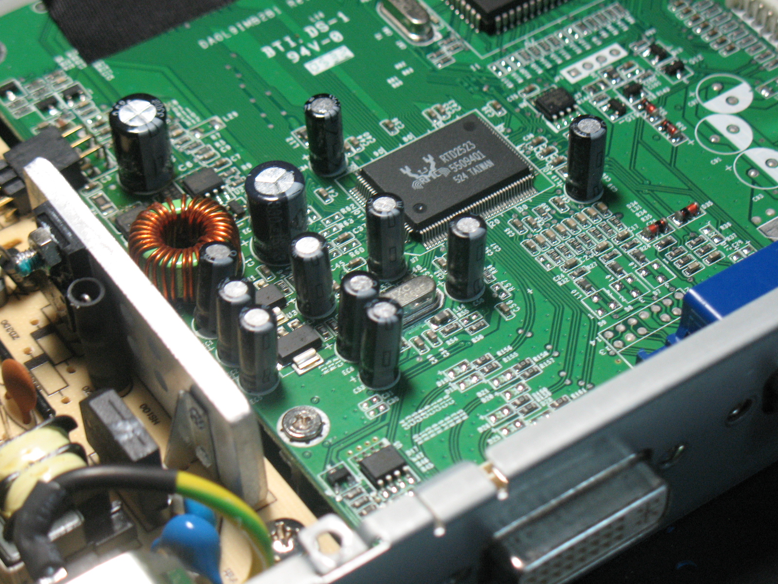

                                I think you may have another problem in the Main logic board due to bad regulator or caps for the video processing. At least try reseating the Ribbon cable from the logic board to the LCD panel first. You may want to verify that you do get good 5vdc from you new board.

                                  I have not really followed this thread but The new power board you bought did it look as if it had been reworked. What make /series caps does it have in?
                                  Did you re cap the video board and again what caps did you use?
                                  Did your old board have the jumper for the lights - if so what was that set at?
                                  This should be set the same? having said that the problem you have doesnt really look like its related to the brightness of the ccfls.
                                  Have you tried a factory reset.
                                  If the your old board did not have the power jumper - have you bought the correct board?
                                  Is the pc set at the optimum resolution for the screen
                                  Have you done the normal power board checks on the new board - voltage on main cap and output voltages.

                                    I had the "2 seconds to black" problem with my old board. The 2 seconds I had image, it was just like now but I thought it was the power/inverter board but now I realize it was not.
                                    The old board had no jumper for the lights. The board is the same but a different model. The partnumber seems to be the same (unless it's a fake) but clearly a different model. For example, the main cap filter is 100uF and the original board had a 150uF. Plus, it has a big transformer for the 4 light connectors. The other one had 2 little transformers.
                                    I don't know the brand of the caps on the new board. They were green.
                                    I tried also with a VGA cable (now it's connected with a DVI cable) and I had the same result.
                                    The PC is not the problem either because my other monitor works just fine. I connected this monitor (Viewsonic) to my laptop and same thing.
                                    I'll try cleaning the Ribbon cable. Is it OK if I use isopropyl alcohol?

                                      Ok, so I cleaned the ribbon cable with isopropyl alcohol and nothing. Changed the jumper and nothing.
                                      The caps of the power board are Taicon.

                                          LOL. The original caps are TEAPO and the ones on the board I bought are Taicon.
                                          I changed the jumper, means I changed its position (to 7 and 7,5mA) and still the image is not good.
                                          I changed a couple of caps from the logic board but not all of them (yet). I'm working on that.
