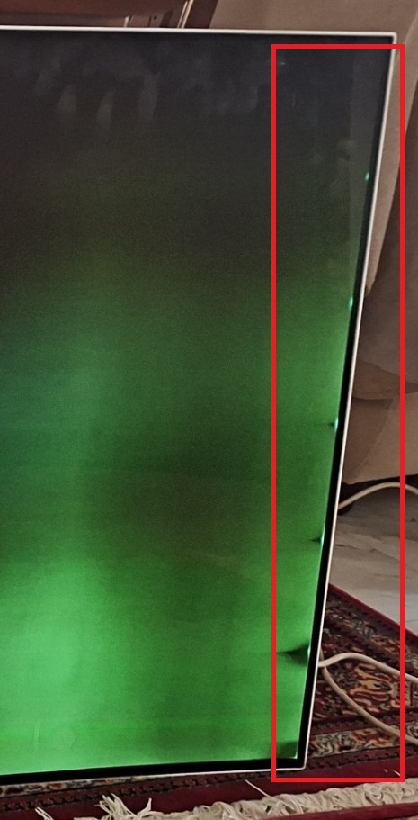

    Hi ! to all fellows out there!
    I have an LG 55inch 55RG910V-ZB Curved TV. With the following problem: When I turn it ON with Remote I get a Green noise Screen (attached foto).
    I have tried reseating all ribons, Checked PSU 24V,12V,3v ,etc voltages.
    The TV opens on the first Green noise screen and it freezes there -no respone of menu keys ,etc -only on/off via Remote. (I also noticed carefully that except from green noise screen there is a ghost image at bottom and left vertical side)
    I tried connected the lan and I can seee TV via local lan (as a device I didn't tried to cast etc).
    Is there any way of testinf T-con? I read different posts that I can check T-con to view with Red,Green,Blue screen.
    LG technicians and service manual estimates this is a panel fault (burnt screen!) BUT I am far for beliving it yet! as 2 days ago (of the total 10days TV not working) ONLY ONCE! TV started OK with normal screen menus, broadcast channels etc ! 😁
    Please any help what to try would be welcome!
    Thank you for your time.

    Panel issue at side COF of the right side ( need to remove all.. if the set belong to you..you can play with it by cutting the right bezel and remove the COF... but if it will display correct image are unknown.. such TV described as scrap.

      ....despite the fact that only ONCE TV started ok ?
        What do you mean? With a PC? You see the TV received by TV set? With which program?
        My guess is it could be a bad tcon.. put that in freezer and then when frost mount it and test tv..
          Yes I wasn't clear enough: I mean if I connect the LAN the TV can be detected on the lan vua the ip address.
          Do you think? I will try this...

            put card in a bag before putting in freezer

                No luck So far . I really don't know how to proceed. Only one time TV started normally without any issues. Despite that 15 days now it show signs of burnt screen!. Is there any chance of having problems with T-con? May be I try Diah recommendation and start dremel(ling) screen apart!

                  Well if you can get a tcon at reasonable price, try one, if no joy probably time to give up.

                    Where are and how are those burnings? Dremeling is not an answer because you don't know where are, if there are, the faulty COG, or if there are COF, you don't even know on which side are those..
