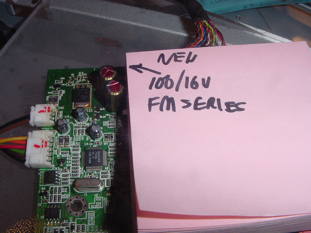

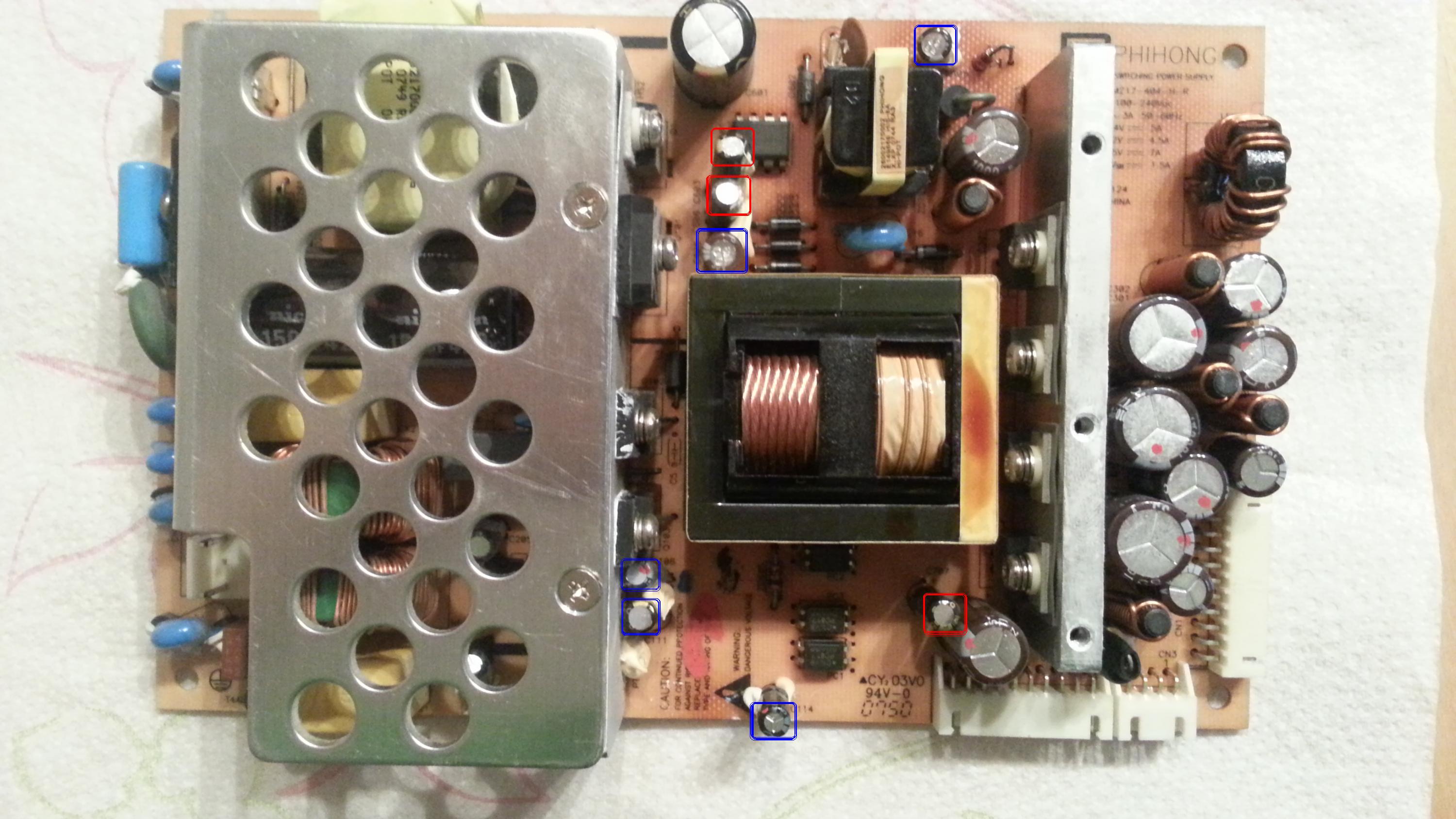

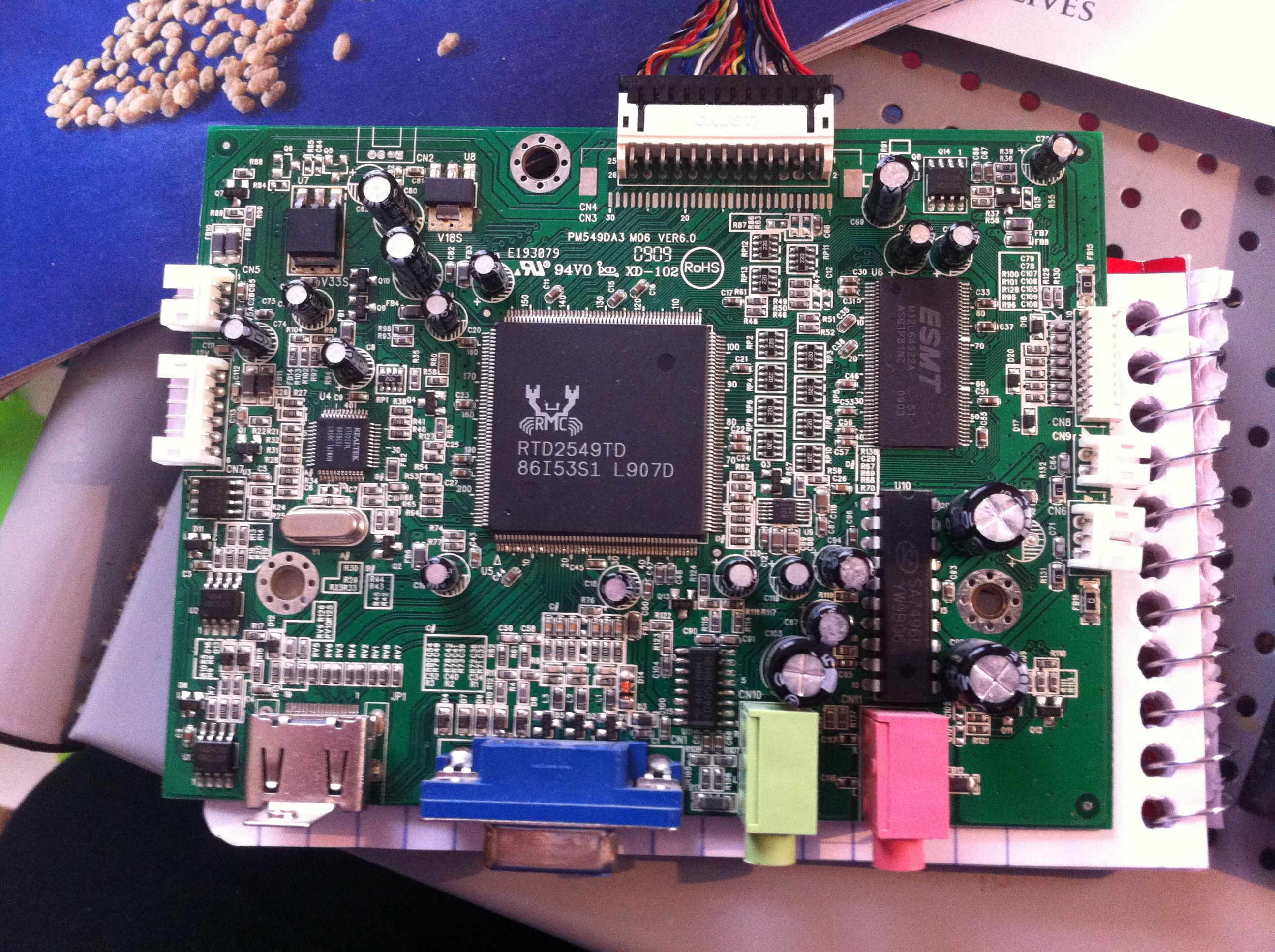

                I hope somebody is still reading this
                Problem: Always get "no signal" message when connecting or disconnecting hdmi.
                I already changed all the caps on both boards.
                Here are some high resolution pics:
                1
                2
                3
                4

                  You could check the 2 voltage regulators on the top left (in your picture 3)
                  Here's a good video explaining it - https://www.youtube.com/watch?v=cNFzBJELFoU

                    i just measured the two voltage regulators. But nothin seems off to me...
                    The bigger one has an input of 5.1V and an output of 3.3V.
                    The smaller one has an input of 3.3V and an output of 1.8V.
                    All voltages are stable when connecting something on HDMI or pressing on/off.

                                Are these pictures after you changed the caps? If so, I see one potential problem: you used Teapo capacitors (or so it appears to be by their vents) - those are known to be quite unreliable. You might also have used the wrong series of Teapo (i.e. not low ESR or not low enough).
                                The voltage on the regulators you measured appears to be fine, but bad power/excessive ripple due to faulty caps (or caps not adequate for the job) could still cause issues. I had one LCD monitor where all voltages came up properly and appeared "normal". However, the image on the display would not always display properly - sometimes, I would just get a bloack screen, other times random pixels. I replaced just a few of the output caps on the power supply with proper caps and that got the monitor working perfectly afterwards. So it is important to use good caps.
                                What qualifies as good caps? - The major Japanese brands: Panasonic, Nichicon, Rubycon, and United Chemicon. And you also have to get the right low ESR series. So...
                                Panasonic: FC, FM, and FR
                                Nichicon: PW, PS, PM, HE, HD, HW
                                Rubycon: ZL, ZLH, ZLJ, ZLG
                                United Chemicon: KY, KZE, KZN, LXV, LXY, LXZ\
                                Do NOT use eBay if you are new to buying capacitors - there are way too many counterfeit capacitors on there, especially from China/Hong Kong. Local shops likely won't have what you need either. The best place to get capacitors is online through some of the better-known part suppliers, such as Digikey, Mouser, RS Online, and Farnell/element14.

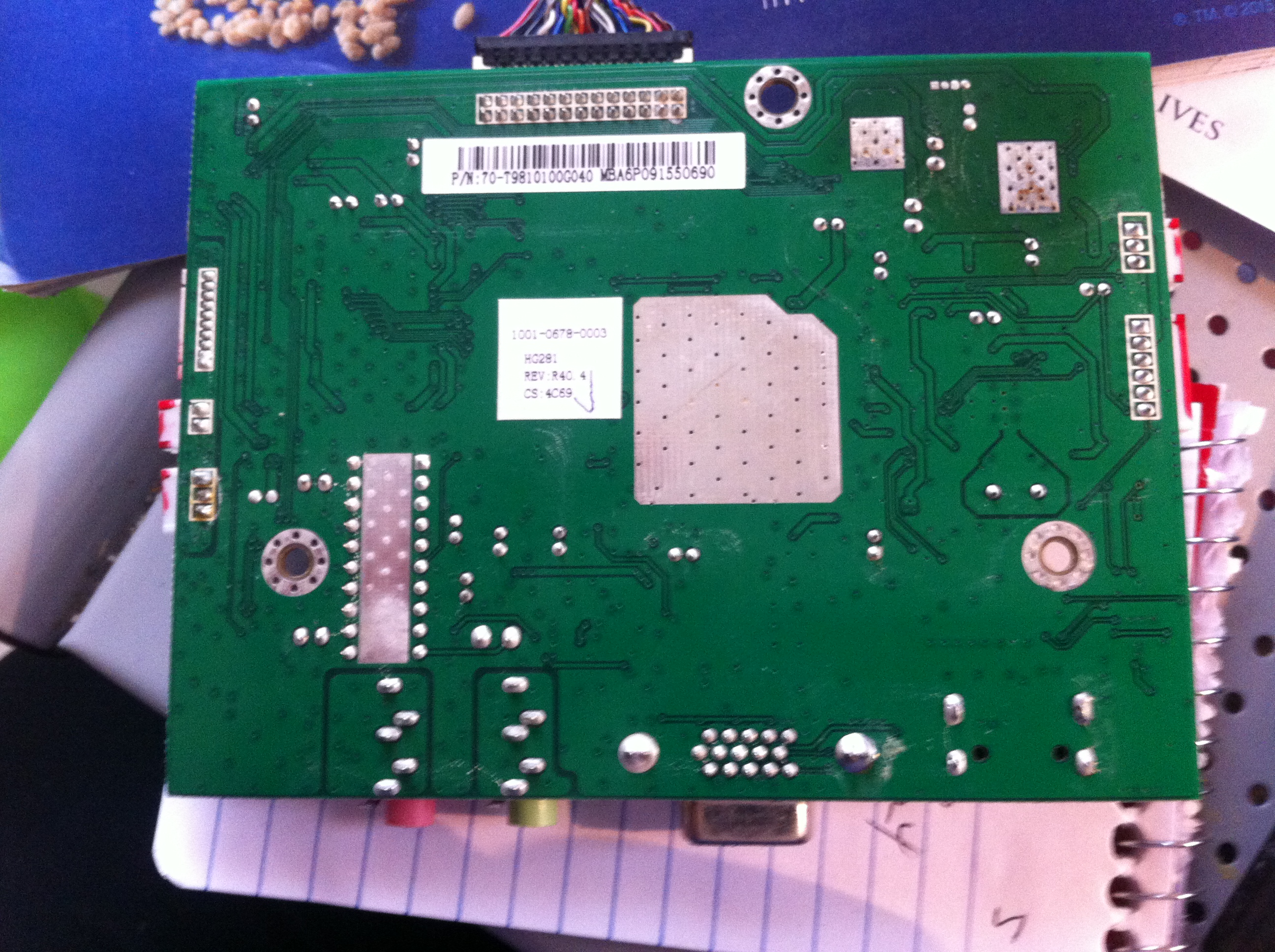

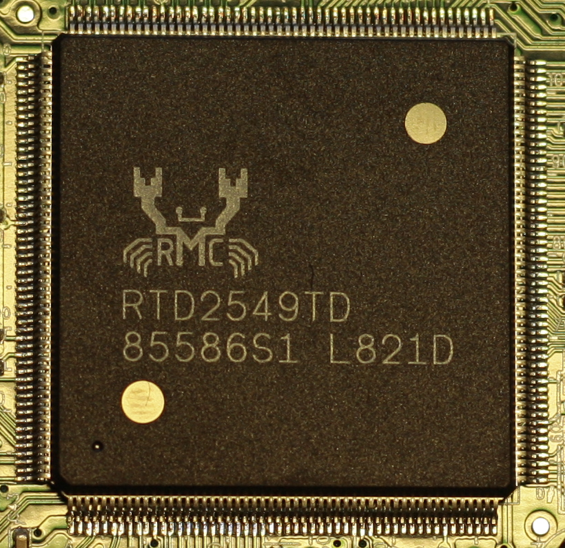

                                  Does anyone think the low solder on this chip might be a problem?
                                      What is the best way to make sure these soldering points make a correct connection?
                                      Ive read that some guys put their graphicscard into the oven for a short time. Can i use this method with the mainboard or will the caps get damaged from the heat?
                                      My problem is that i only have a rather large soldering iron. So I cant really solder on this small pins. i would only try to heat them i little without fully melting to give them a better connection...

                                          Interesting find. The solder does look quite ugly indeed. However, if the chip doesn't run too hot (under 60C), then the chances of the solder cracking due to temperature changes is fairly small. But if you tried everything on your monitor and it still doesn't work, then this might be worth a try. I will say, though, that manually soldering those pins with an iron is quite tricky. Hot air should be somewhat easier... but if you don't have a hot air tool, it's not worth getting one just for the monitor.
