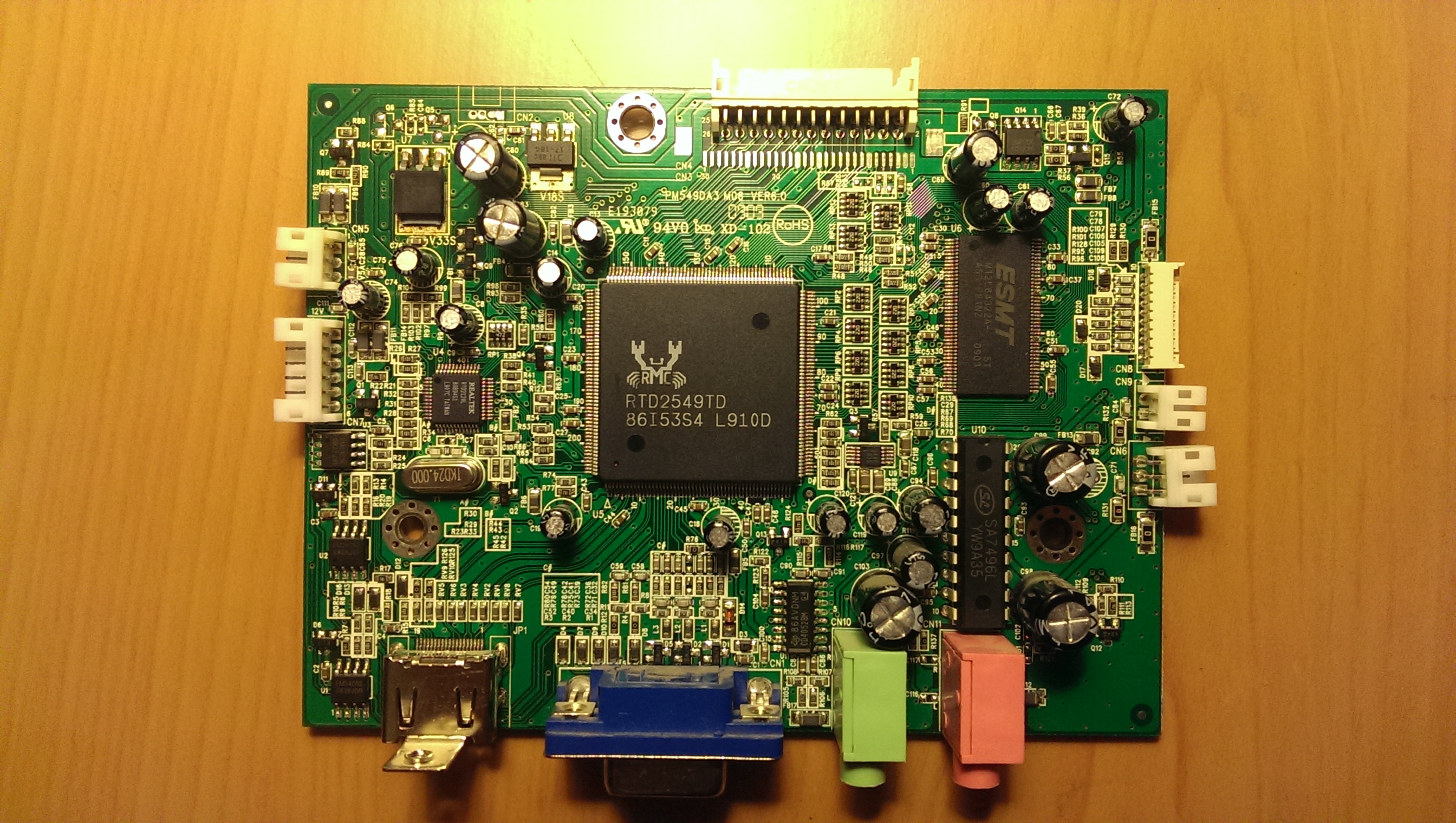

                              Here are some pictures of the boards. Also, would this suffice to repair the logic board: http://www.ebay.com/itm/Hanns-G-HG28...item2339edb9a5 (the new soldering iron would be nice, my current iron is a Weller SP23L). Suggestions for an iron/caps/solder etc would be greatly appreciated!
                              The scratches are from my iron slipping while I was attempting to remove the old caps.

                                Ok. First of all that "kit" is for the power/inverter board. Not the main/logic board. The Soldering iron is an el-cheapo that you can get on eBay for around 5 bucks. But they usually work. And burn out after a few hours.
                                You could buy a similar iron on eBay. (5 bucks or so) Buy your caps from Digi-Key. Buy the solder anywhere (leaded with flux core). And you'd be set.
                                In the 4th picture the 2 holes look rather large. Did you pull out the metal plated core by chance? Like a metal tube. If so, you'll need to bridge to the components they were connected to.
                                Also, when soldering, sit up close and brace the front of your body against the bench. And put your elbow on the bench (the one holding the soldering iron). This will keep the iron from moving while soldering.

                                  #676
                                  Re: Hanns-G HG281D, LCD Monitor no power
                                  Do you have to press very hard on the iron to get the solder joints to melt? If yes, my guess would be that you're doing so because your iron doesn't get hot enough. I used to do that too when I first started encountering lead-free joints. Higher wattage iron helps. As I mentioned, 40W is a minimum. 50W to 60W will make it much easier on these multi-layer boards with lead-free solder. Adding flux to the joints before trying to melt them with your iron also hels a lot.
                                  Here's a few inexpensive ones (recommended if you solder rarely):
                                  http://www.ebay.com/itm/60W-IRON-SOL...item2c8828fff7
                                  http://www.ebay.com/itm/Delcast-60W-...item233ce20c70
                                  http://www.ebay.com/itm/YongFeng-Dur...item4868efe0c8
                                  These aren't very high quality, so don't leave them unattended. But as Lumberjack777 noted, they should work.
                                  I don't recommend getting that kit you linked to. For one thing, you don't know the brand and series of the caps included in the kit - they could be good quality or they could be cheap generics that will fail very quickly. Moreover, these are for the PSU/inverter board. Also, the soldering iron is only rated for 30W - that is barely enough to do the job. I just tried to change a small cap on a very old graphics card (GeForce RivaTNT) with my 35W iron, and it barely got hot enough to pull the old cap out.
                                  Lastly, based on the picture of the power supply board you included, I do see some green Taicon caps that may be responsible for causing no-power issue. In general, Taicon caps aren't exactly bad (compared to other crappy capacitor brands), but they aren't exactly reliable either, if heat is involved (which is often true in LCD monitors).
                                  Here's a list of caps on the power supply board that may be responsible for causing no-power:
                                  C8, C31, C32, C33
                                  Although, if you are replacing those, you might as well do CS18, CS20, and all of the other green Taicon caps.
                                  As for the logic board, looks like you have the caps put on the right way now.
                                  So it could be that the power board is not providing power to the logic board or could be that a regulator on the logic board is bad (but I doubt it). This, you can check with a multimeter. First check if there is 5V comming from the PSU board. Should be present on a pin or two on either connectors CNS2 or CNS3 (or both?). Measure voltages with the black probe on your multimeter connected to ground (i.e. any metal part on the case of the monitor, as long as the power supply is installed in the monitor). If there is 5V, then check the voltage on the tabs of the two regulators on the logic board - U7 and U8 (top left, in this picture).
                                  Let me know what results you get. BE CAREFUL when taking measurements on the power supply. In particular, take note of the white line on the bottom of this picture:

                                    Got my monitor fixed! Thank you to everyone who set this forum up and the people who helped along the way.
                                    The Problem
                                    Originally the monitor was flickering off then on, and on top of that it would start developing white vertical lines.
                                    The Struggle
                                    I replaced every capacitor on the logic board and the power supply. The logic board was the most difficult, because the leads are so close to one another. Plus, when I started I didn't have a desoldering iron, lesson learned, and I got one. In addition, I had two of the capacitor's traces on the power supply lift, so that was hell.
                                    The Added Headache
                                    Finally when I put everything back together the damn thing had green dots everywhere. I took it apart one last time, thinking that it must be a bad connection somewhere on the logic board.
                                    The Solution
                                    Sure enough I went over the capacitors with a bit more solder, verifying the contacts were completely covered. For added measure, I used my heat gun to round out the soldering, moving quickly as to avoid damage to the ICs and the processor. Once that was done, I put the damn thing back together for the last time. Finally this time around it worked!
