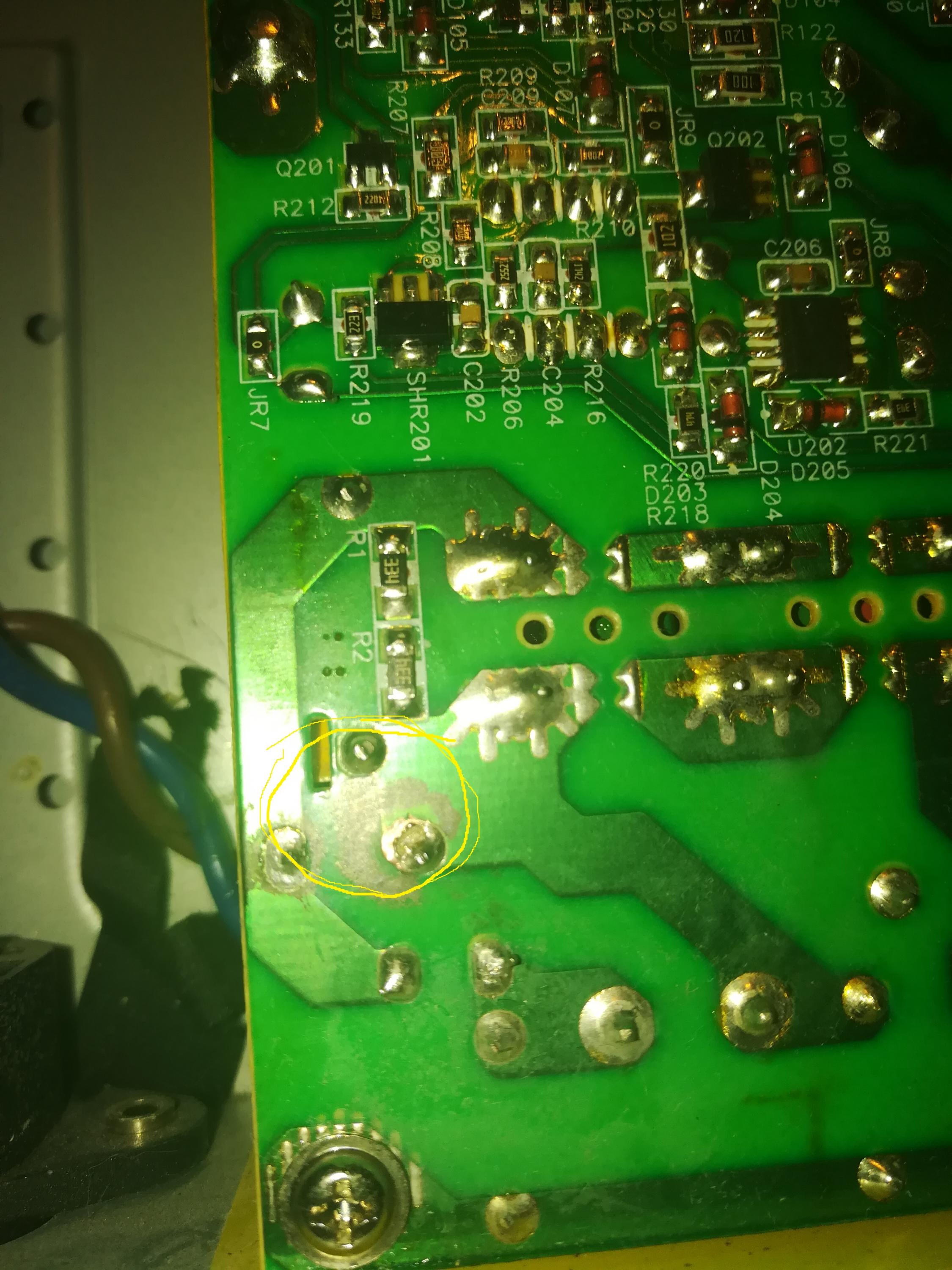

                          And one more question. I have empty slot on power supply. Is it normally? Image attached, with red circle painted.

                            #853
                            Re: Hanns-G HG281D, LCD Monitor no power
                            According to my previous post, didnt attached correctly.
                              According to some pictures I found in this thread... namely these three:
                              https://www.badcaps.net/forum/attach...2&d=1291157414
                              https://www.badcaps.net/forum/attach...5&d=1331360444
                              https://www.badcaps.net/forum/attach...9&d=1415717806
                              ... it appears that the missing connection there in normal. Looking at the PSU deisgnators, you can see that connector has 4 pins: 2 labeled with "GND" and two with "+12V". So, it's probably not needed.
                              On the other hand, this picture shows all cables connected:
                              https://www.badcaps.net/forum/attach...9&d=1358649456
                              But honestly, I don't think the logic board uses 12V (except possibly for the audio amp... though if you are already getting audio through, then the audio amp is powered from something else, obviously.)
                              Also, do you know who put that diode there on the bottom right next to where you circled the area in red? (It's North of the circle.) Was that done by one of the repair shops? If so, I wonder why.
                                Currently i have replaced 5 caps, two most reccomended C80 & C83. I placed there 16V 220uF, with 0.00 ESR. Still not understood for sure what is ESR, but think 0.00 is good, and if more than maximum as an table says this capacitor bad. Btw im replacing caps from pc motherboards, cause cant afford japanese right now, and for sale in local shops only chinese. After replacing 5 caps totally nothing changed. Ill try get somewhere more good caps, and maybe its helps.
                                And i have one question about logic board. There is processor, how to test him? My teacher from service center says problem could be just in proc, so nothing will help anymore and just getting new board. But he honestly says, he not really good in displays. Is there ways to check CPU health?
                                Also tried to connect to Orange Pi, maybe another signal... but no.
                                And i forgot to say something, maybe important. Last time i connected smartphone with mini-HDMI, to check how it works. After few minutes of looking how its hard to play movie with low Hz 1 core cpu i deattach. And display didnt worked anymore after this.
                                Thanks for assisting, momaka. Few your links already in bookmarks, very helpful.
                                Idk who placed diode, displays was on repair in 3 different. As my teacher said, it for force power on.
                                Changing "16V 100uF" to "16V 220uF" or "10V 220uF to 16V 220uF" is ok? I have seen in this thread, but forgot the rule. I should keep V but can increase uF? Or Keep uF and increase V slightly? Im not banned in Google, but wanna ask here.
                                  That's fine to do as a "test" on the power supply. But for a repair shop to return the power supply like that to you, I'd say they're close to incompetent (at least when it comes to LCD repair).
                                  The circuit should work as it was intended. Removing that diode and restoring whatever circuit there was originally would be a good second step in troubleshooting, after changing all the necessary capacitors.

                                      just posted this issue. Figure i post it here too incase any of you know what can be the issue. https://www.badcaps.net/forum/showthread.php?t=89422
                                      • gordesky1
                                        • Jun 2014
                                        • 66
                                        #859
                                        hmm so i seen this guy post about the red blue and green colors what im getting always now.
                                        post 838 a page back.
                                        Hello
                                        I have a screen hg281d down.
                                        At the start, it cycle on red blue green.
                                        I replace c80 & C83.
                                        I do not have 1.8V to regulator vs18.
                                        The output is short-circuited with ground.
                                        The regulator is ok, the capacitor is ok.
                                        I do not have the schema to find or is short circuit.
                                        If anyone had the schema.
                                        This is c82 was hs.
                                        thanks.
                                        now the screen turns on but there are red dots everywhere.
                                        The tensions are good.
                                        An idea?
                                        thing is i dont see anything on c82??? just 2 solder joints. unless im missing something?
