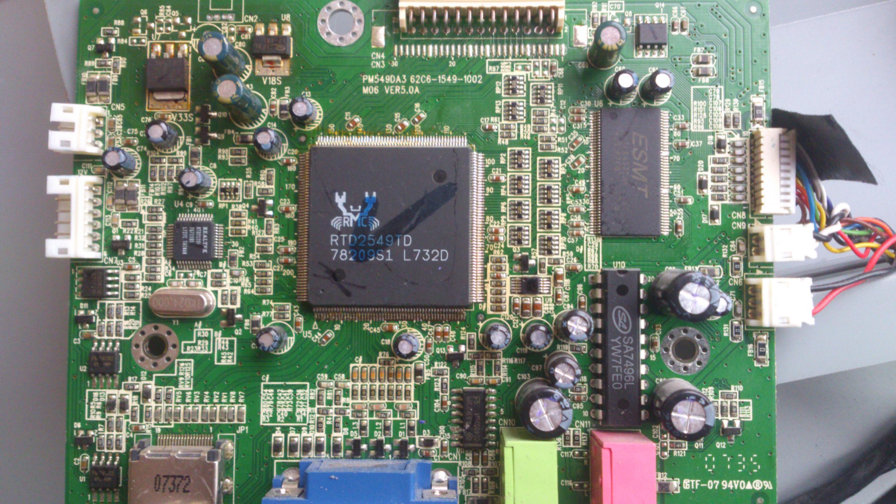

      Re: Hanns-G HG281D, LCD Monitor no power

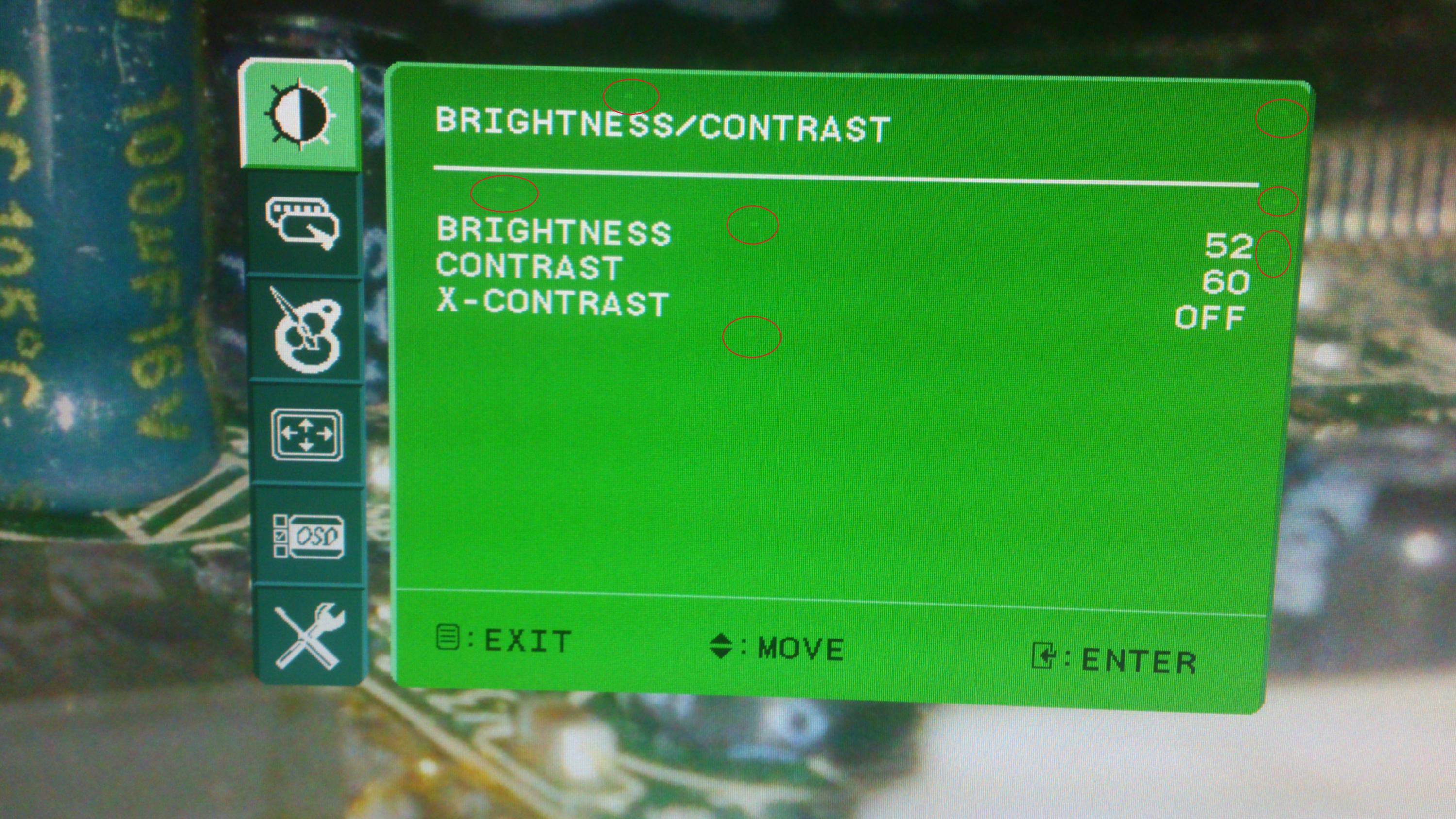

      Ok, you fixed the main/logic board. That's good. Your problem with the power on, is on the power board. There are at least 2 different types of power supply board for this monitor. Can you post a picture of your power board, and I think we can help you fix this.

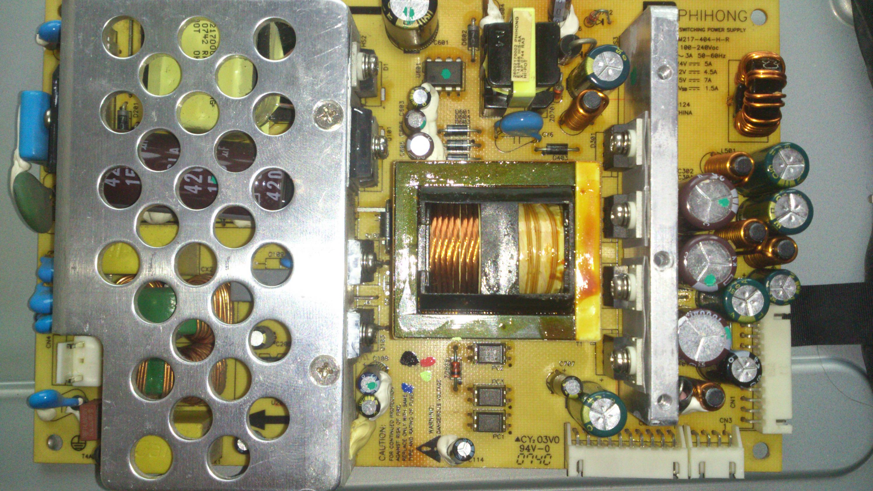

        Here are some.

          #704
          Lucky you. That's the easier one to repair. Try replacing the 3 caps circled in red. Feel free to change any circled in blue if you want. But the 3 circled in red are usually the problem.
          Make sure to pull straight out on the cap when desoldering. I have seen some botched repairs where the person pushed back in a little on the cap, and lifted the thin copper trace and pad. Those pads lift easily if you push on the cap.
            And to add to Lumberjack777's post above,
            Please, DO NOT use Teapo SC capacitors. Those, too, will fail in a relatively short time. Use quality Japanese capacitors, such as United Chemicon (like the brown ones you already have on your board), Nichicon, Rubycon, Panasonic, and Sanyo.
            I also highly suggest you DO NOT buy from eBay. While there are a few good sellers on there, 99.999% of the sellers sell COUNTERFEIT Japanese capacitors. Buy directly from either badcaps.net store, Mouser, Digikey, RS Components, or Farnell (I might have missed one more legit store or two, but you get the picture). Local shops are usually not a good idea either.

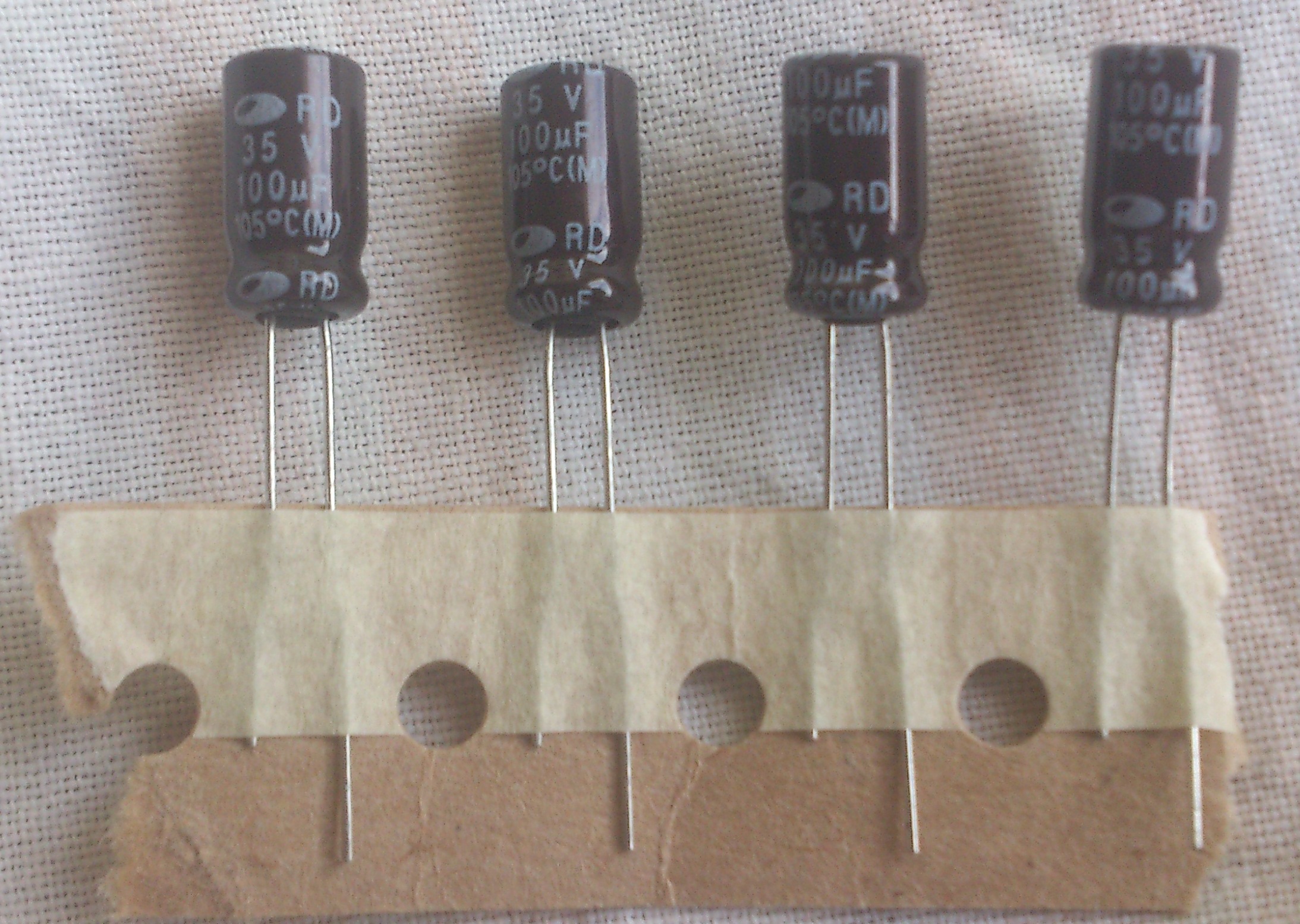

                • Castor8
                  • Dec 2014
                  • 14
                  • Hungary
                  #708
                  I bought these from Conrad. Are they ok?
                  The guy in the store said that the 35V caps will be ok, cause does not matter 16V or 35V. Is it true? I have never tried to repair anything like my monitor, so I hope I am not going to ruin it.

                      #710
                      Originally posted by Castor8
                      Forget about my last question please.
                      Should I have to order this, instead of buying those 3 caps?
                      http://lcdalternatives.com/Hanns-G-H...-P2087771.aspx
                      He is my friend and he uses good caps, I help him out a lot on the cap selection and technical questions. Just tell him Bud sends you.
                      just make sure you get the one that MATCHES your power supply VERSION.
                        #711
                        No, it is general purpose cap and only 85c, this monitor runs hot.

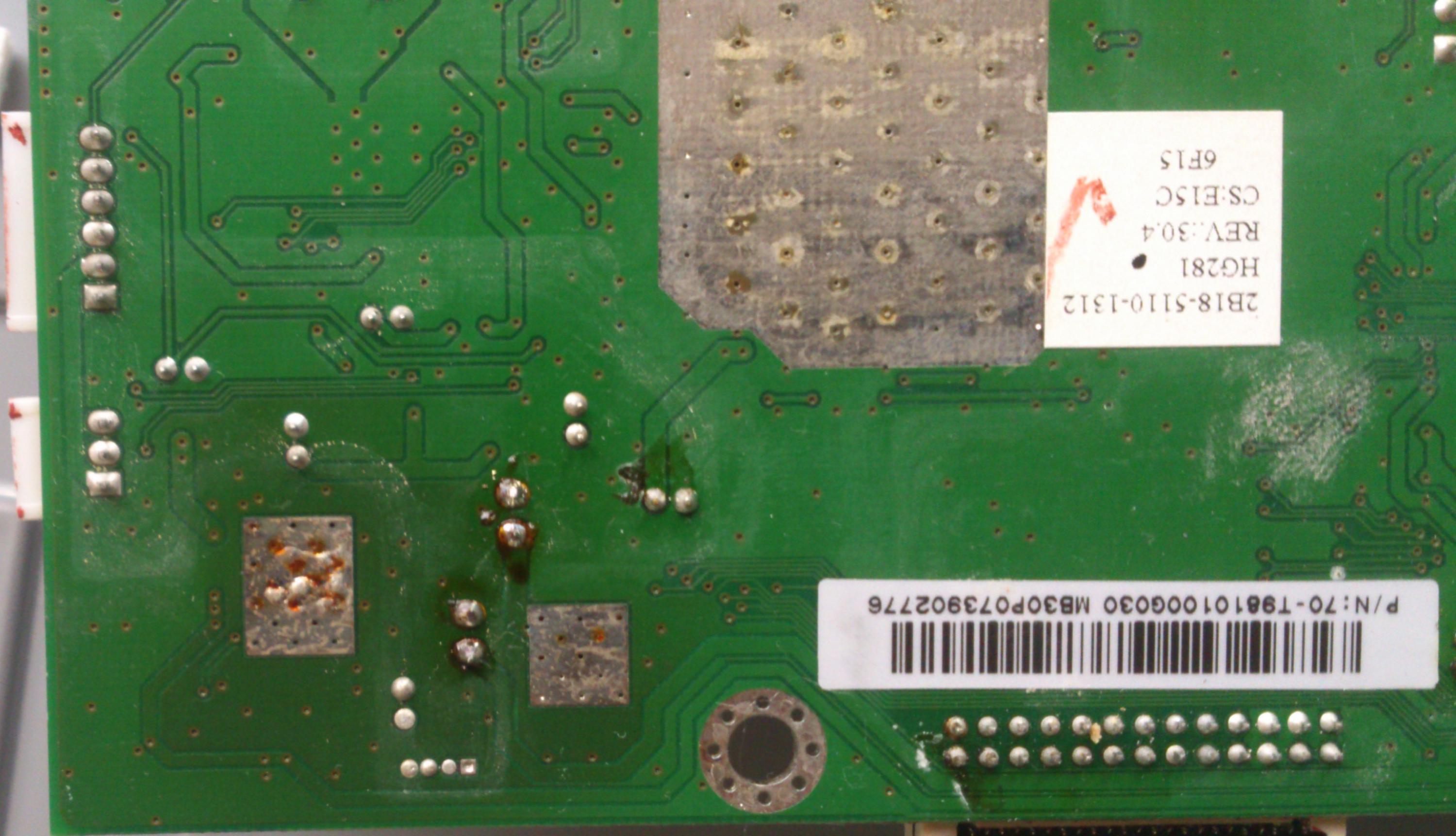

                            • Americanpiegamer188
                              • Dec 2014
                              • 4
                              #714

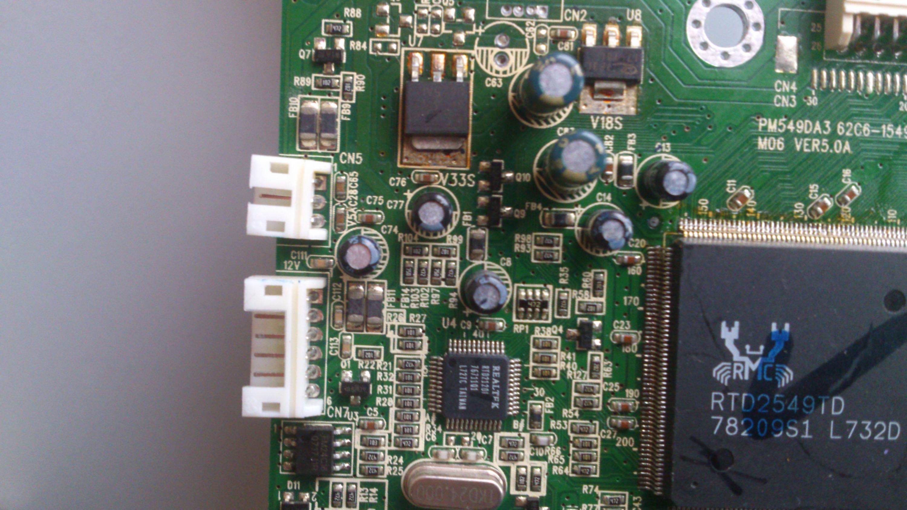

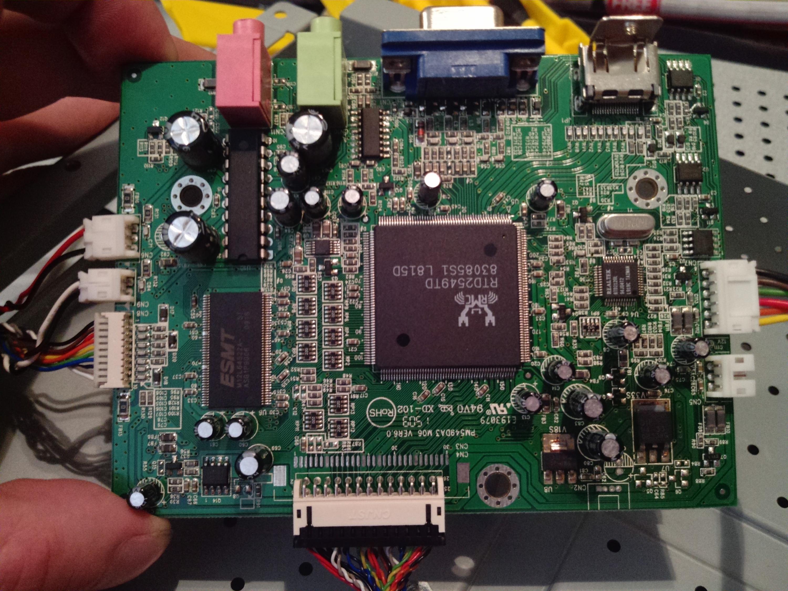

                              I read through all of this thread and I don't know where to start. I have a Digital Mutlimeter and not an ESR meter.
                              When connected through HDMI the monitor normally stays on for 2 seconds and then goes to black. When connected through VGA sometimes it works and sometimes it doesn't. When it does, it is extremely hazy.
                              Here are my pictures. Please advise where to start or what to replace! I have a soldering iron and am willing to try it!
                              I don't see any capacitors out of the ordinary - bulges or leaks.. but I've never replaced one before.
                              • Lumberjack777
                                • Dec 2010
                                • 464
                                #715
                                Excellent pictures. That helps a lot.
                                Ok, this sounds like the 2 caps on the main/logic board, next to the voltage regulator, in your first picture.
                                Replace the 2 in this picture I have attached. This repair, and the picture, are courtesy budm.
                                This is through hole soldering and it doesn't hurt to practice on an old motherboard or similar. Here's a youtube video that explains through hole soldering. https://www.youtube.com/watch?v=Z38WsZFmq8E
                                You can order the 2 caps from digikey. Panasonics are good. Make sure to get 105c rated.
                                  • Dec 2014
                                  • 4
                                  #716

                                  • Lumberjack777
                                    • Dec 2010
                                    • 464
                                    #717
                                    Originally posted by Americanpiegamer188
                                    I saw your link for the exact model in another post. Do you have the links for the other capacitors on this board as well? They seem to cheap to order that it couldn't hurt? Shipping is the real cost when only buying 2.
                                    I was scrolling under the same type and it only goes down to 17uF and it calls for a 10uF 25V
                                    You don't need to buy more and replace any others. Those have always lasted on other similar monitors before. It's also a waste of time soldering caps that don't need replacing.
                                    I realize (2) @ 53 cents apiece, plus 3 or 4 dollars shipping doesn't seem cost effective. But it is. Basically you'll repair for monitor for about 5 bucks. (or less)
                                    Here's a link to the ones you want (2) http://www.digikey.com/product-detai...0CT-ND/3072210

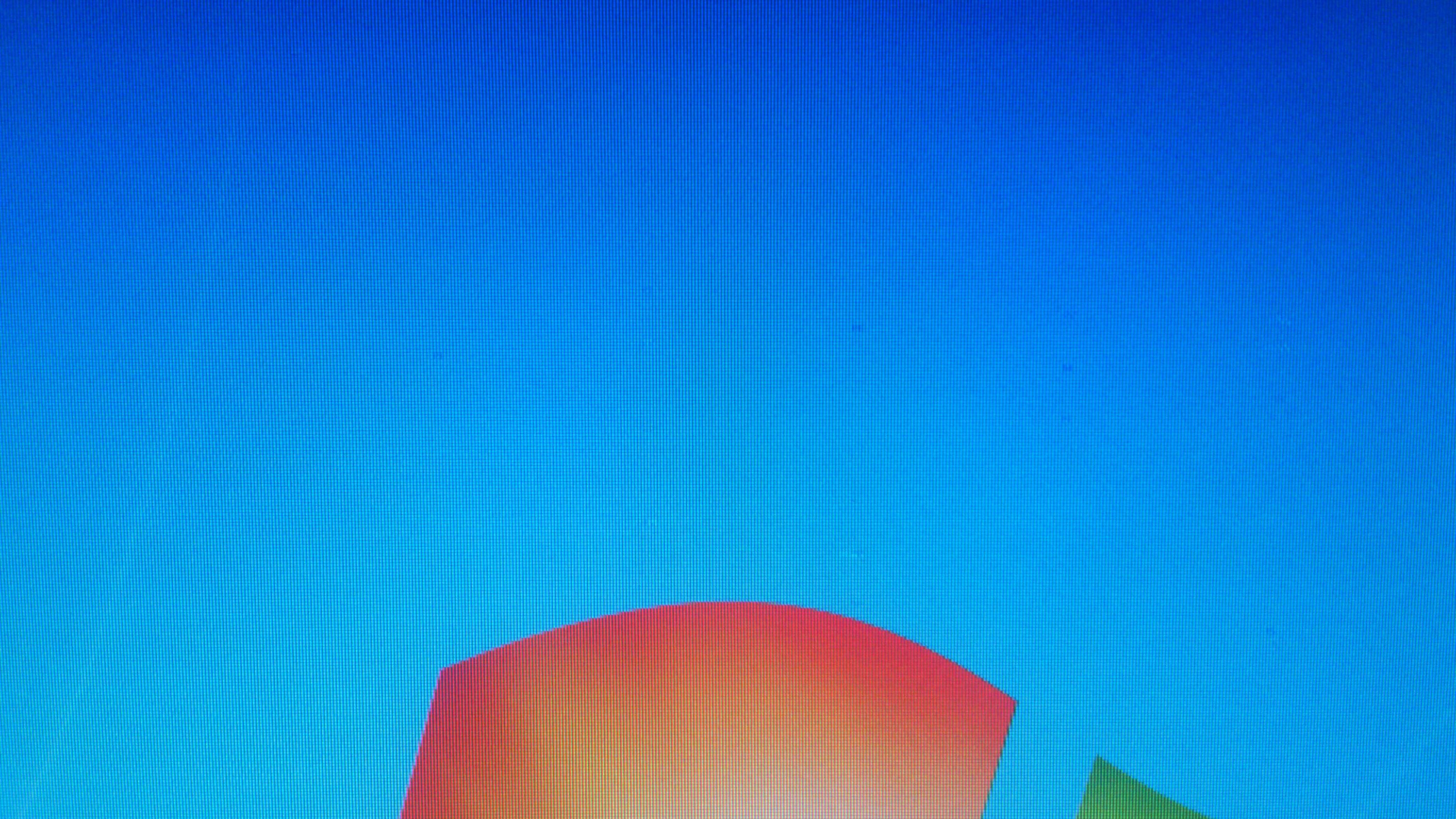

                                      • Castor8
                                        • Dec 2014
                                        • 14
                                        • Hungary
                                        #719

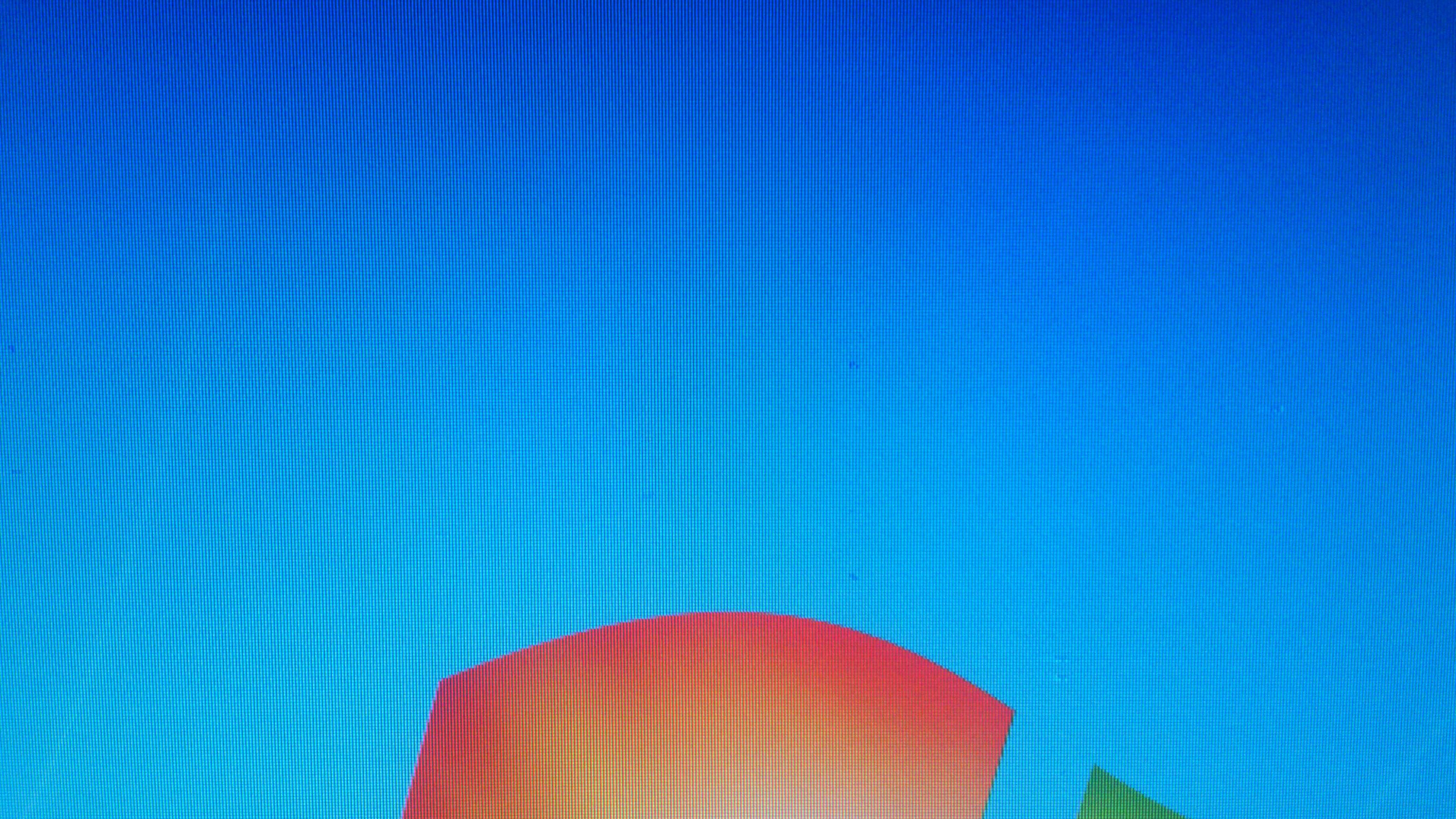

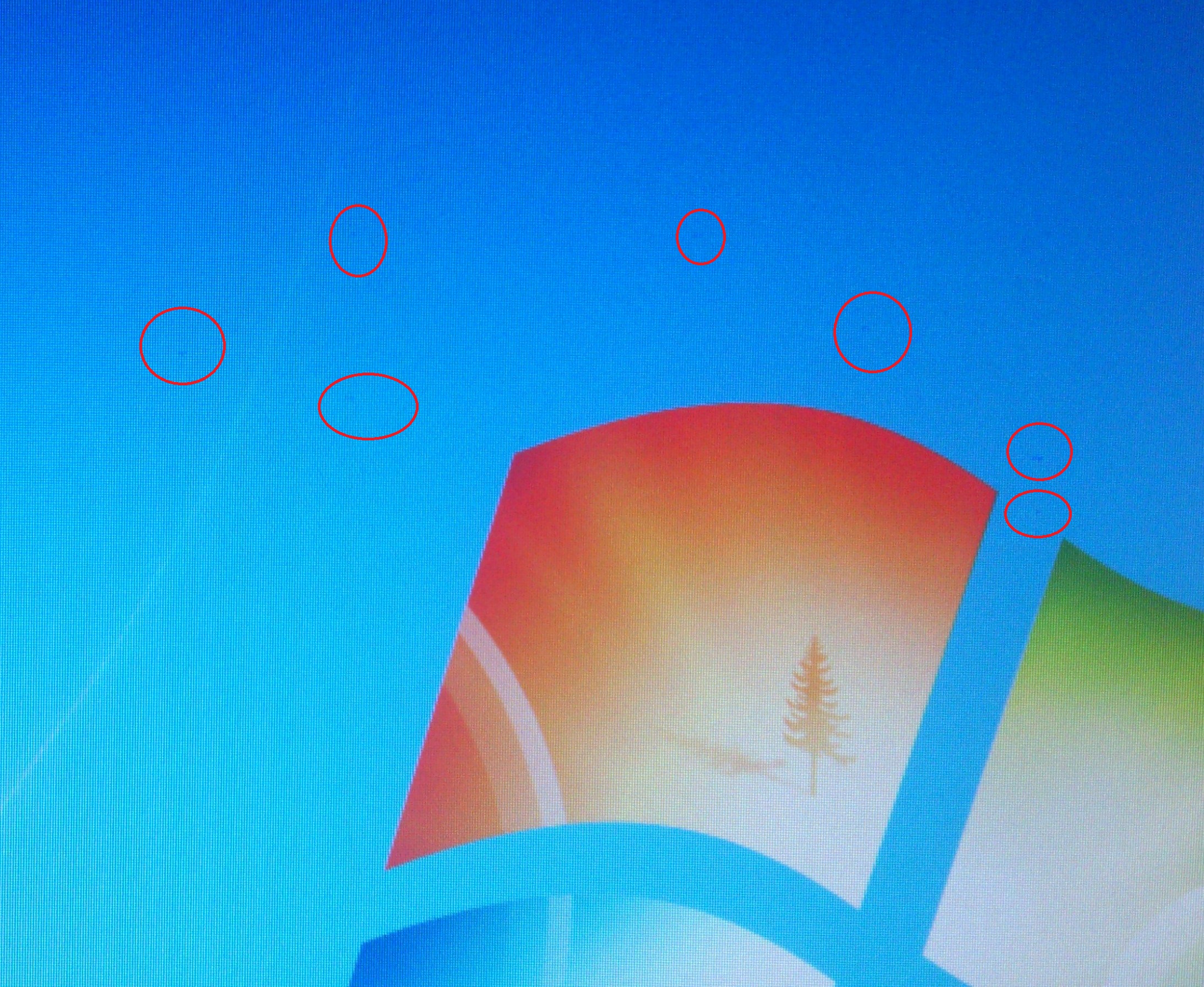

                                        Finally I fixed it yesterday. Now it is working properly.
                                        Thank you very much indeed for all. I am very happy now.
                                        But now it makes relatively high noise like a transformer or something. Is it ok?
                                        And I have an other issue. There are some flickering, running around in the middle(quadrant) of the display. I mean flashing pixels (I don't know how to say it in english) Sometimes are black, sometimes are white, it depends on the background color.
                                        Can I fix it somehow?
                                          • Dec 2014
                                          • 4
                                          #720
                                          Parts came today and I got it fixed!! Replaced the 2 capacitors and I am shocked it worked.
                                          I had/have no soldering skills. Radioshack has a $10 off $25 coupon so I bought a soldering iron, solder, and wicking for super cheap. Got the caps from digikey.
                                          I am so happy!
