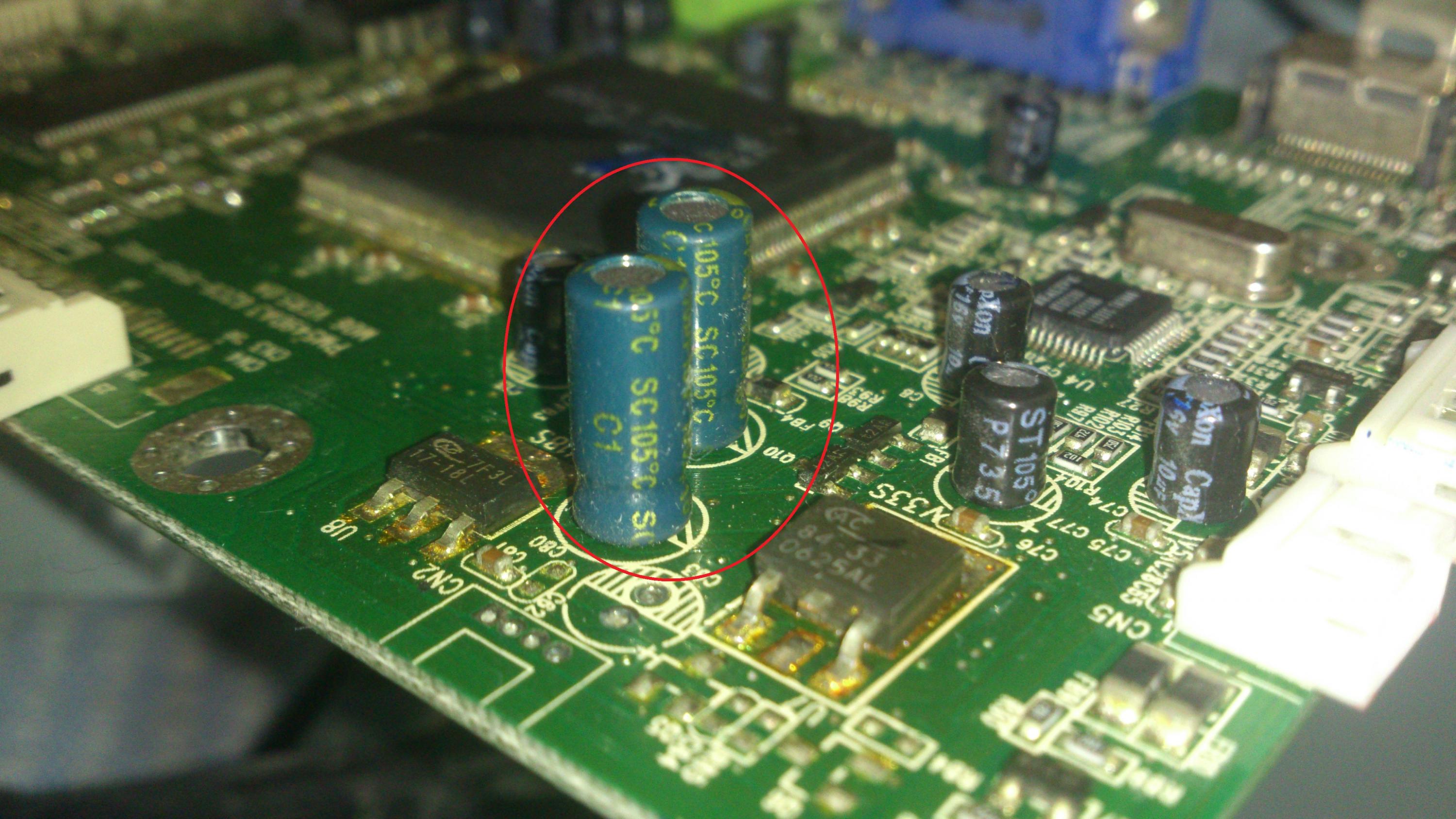

        Hi Hapollo. You know, I have never had one of the alternate power boards like you and BtB have to repair. It's always been the one I will attach here. But since your board was manufactured around the same time that many manufacturers were using the inferior caps; there's a good chance you have some bad ones. You could replace them all (If you are fairly skilled and have the time). I have an ESR meter so I can test them. In my experience on the other board, it was the smaller caps that tended to dry up. Especially in the middle. It's really up to you. If I didn't have an ESR meter, I'd start with the smaller caps that aren't bulging. Or just replace them all. Hope that helps.
        P.S. I did hear of a guy that fixed your board by replacing some caps. But I don't know which ones he replaced. So there is hope
        And you want to replace the 2 caps budm mentions on the logic/main board (photo attached)

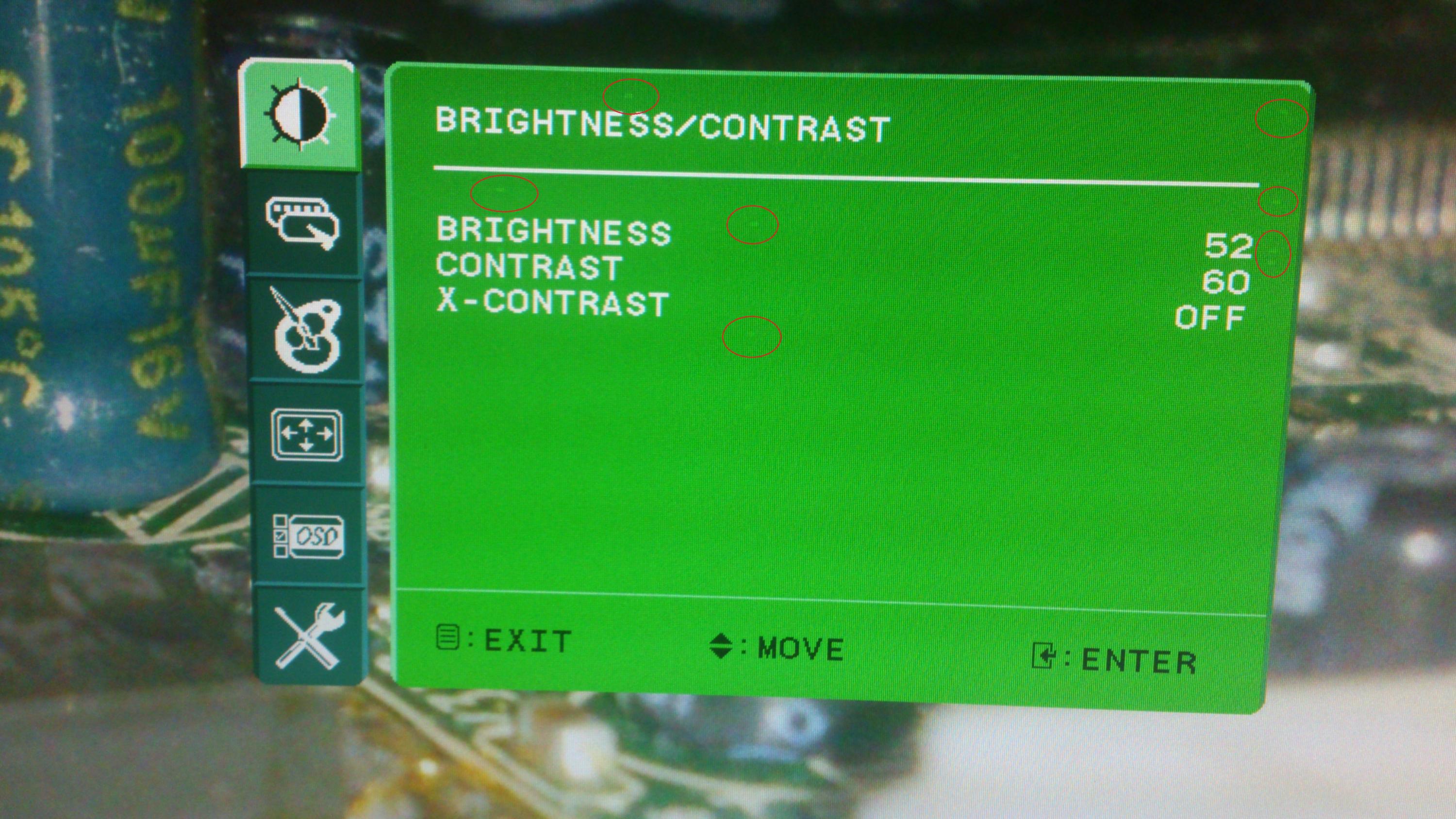

                      at first, thank you all for your excellent advice ! I succeeded to bring back to life a HG281D by changing just 2 caps on the video card.
                      But before this result, i tried to change a lot of caps on power and video card of another HG281D: strange area of red pixels disappeared and i can turn it on instantly. The problem is that i cannot change brightness anymore!
                      On OSD i can move from 0 to 100, but nothing changes on the screen, it is like the brightness is blocked at 0 ... Someone already saw that ? Any idea on what to do to solve this problem ? I checked continuity with a multimeter and everything seems ok, maybe a cap that i replaced is bad, but which one ?
                      Thanx in advance for your help,

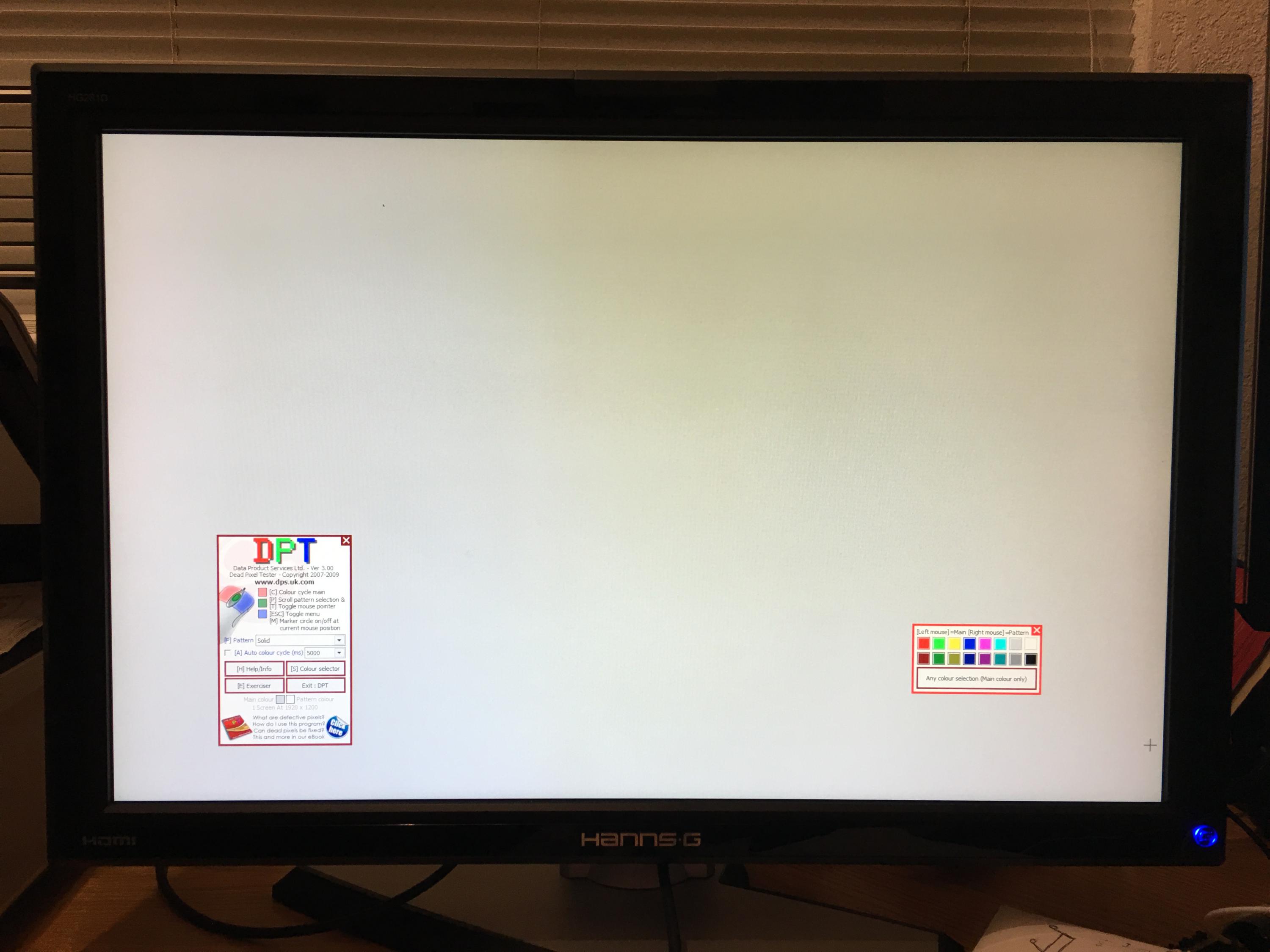

                          Per previous post, attached photo of the problem with the yellowed screen after recap.
                          The second photo shows some artifact from the camera (does not look this way) but the pattern seen by camera might shed some light on the problem.
                          Any ideas as to what to check next appreciated.

                              Try changing those two caps on the logic board first:
                              https://www.badcaps.net/forum/showpo...&postcount=783
                              But the power supply should also be re-capped.

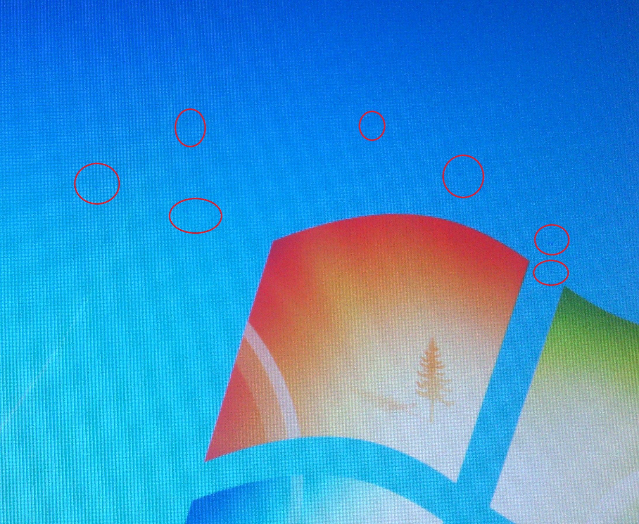

                                          I only changed those 3 poor quality caps, which was changed by monitor repair man. I did not change those Panasonics I did a year ago.
                                          And my other problem also solved. Those white filckering pixels around or I have no idea what they were... Atteched pics.
                                          So everything is perfect by now.
