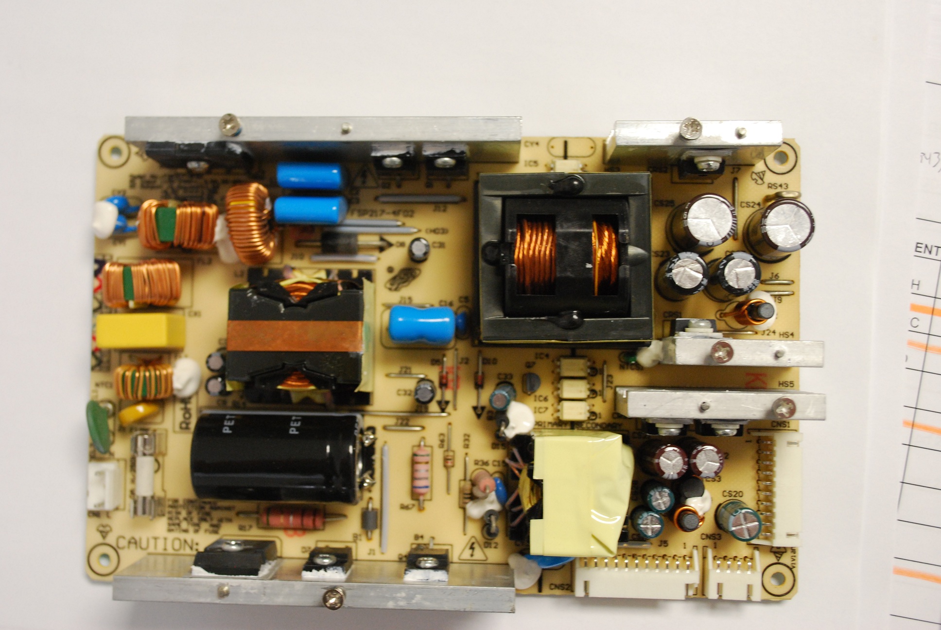

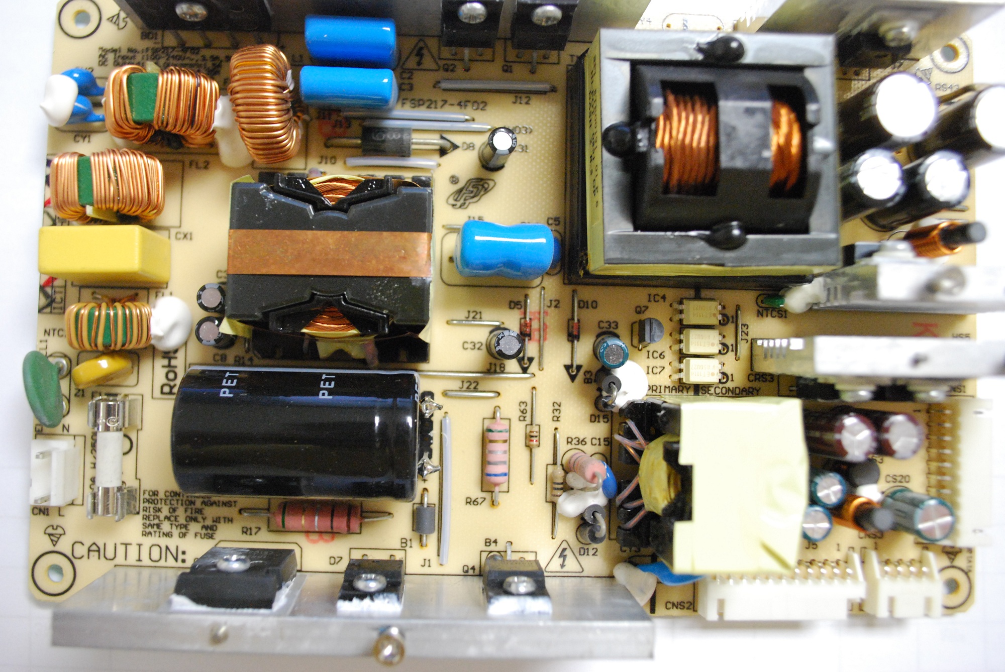

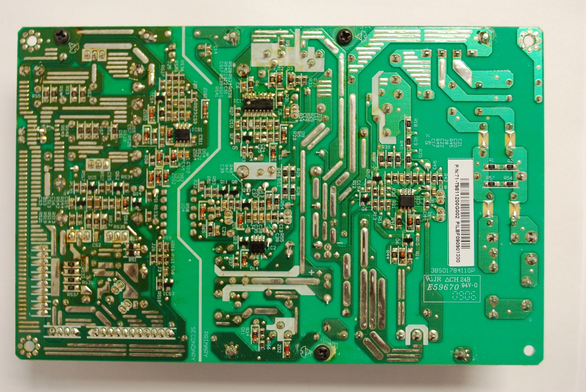

    Re: Hanns-G HG281D, LCD Monitor no power
    Thank, I was only checking the file size. I borrowed this camera, so I had no idea the default was that many pixels!
    Pictures NOW attached.

        #163
        The focus isn't too good on the picture of the power supply top, you may have to redo that. The one of the bottom is quite good.
        Step 1. Put the power supply back into the monitor, fasten it in place with the screws, and hook up the AC supply. Don't hook up any other cables. Set your DMM to the 20 volt range. Use the mounting screw in the lower right corner as ground for the meter. Measure the voltage on each pin of CN1, CN2, and CN3. If you get voltage readings (I'd hope you see 5 volts on one pin), report them, then stop.
        If all of them read 0, reset your DMM to the 200 volt range and CAREFULLY measure the voltage across the leads of the large cap.

          #164
          Counting from the lower right corner, Pin 5 of CN2 is reading 5.21

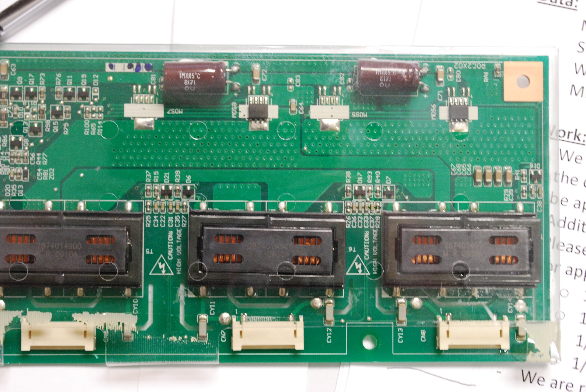

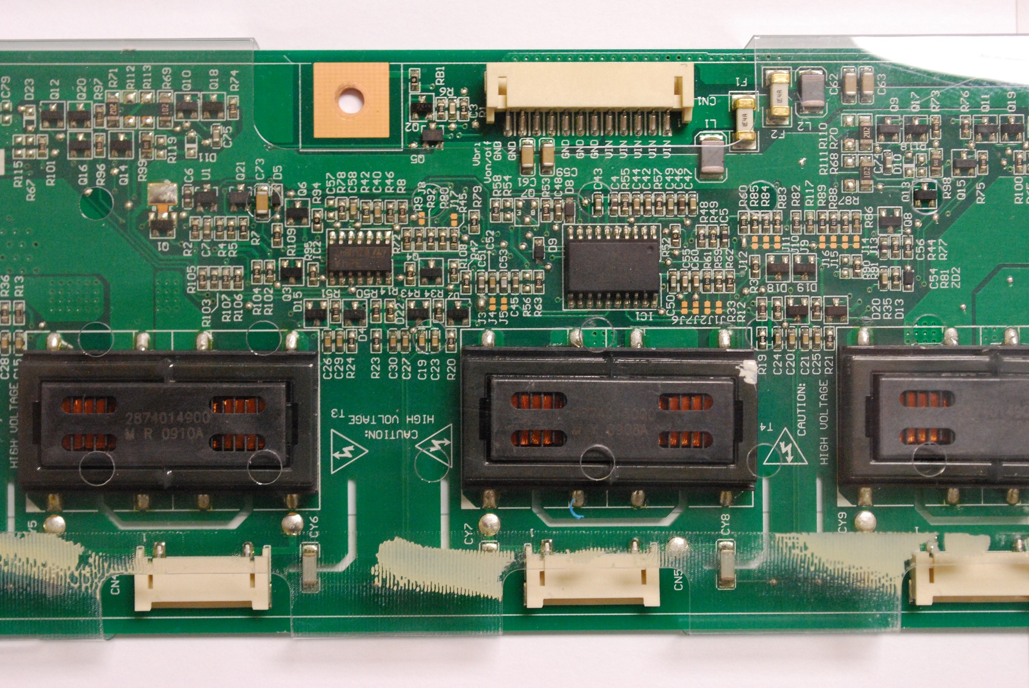

                  #168
                  I didnt have the LED hooked up earlier. With it connected, it is on. First blue, then orange.
                  Pin 11 of CN2 reads 0.01
                  I have attached 3 shots of the inverter. L, M, R for Left, Middle, and Right

                    #169
                    Power off and unplug lcd for all tests below.
                    1) There are two SMD fuses, F1 and F2, on your inverter board. Check to see if they are good.
                    Details explained at (section 3)
                    https://www.badcaps.net/forum/showthread.php?t=10419
                    with posts #19 and #20
                    2) This is not your exact inverter transformer (section 4), but see
                    http://www.lcdparts.net/TransformerD...ProductID=3360
                    Note pins S1, S2, S3, and S4. Measure the resistance between S1 and S2. Note the reading. Do the same for S3 and S4. Repeat for all transformers on the inverter board. Report all measurements.

                      #170
                      From those directions, the fuses appear to be good. Both read 0.7
                      Transformers L to R S1-S2, then S3-S4
                      1. 1142,1147
                      2. 1144,1148
                      3. 1161,1169
                      4. 1159,1167
                      5. 1151,1159
                      6. 1146,1152
                      7. 1156,1164

                        #171
                        1. 1142,1147
                        2. 1144,1148
                        3. 1161,1169
                        4. 1159,1167
                        5. 1151,1159
                        6. 1146,1152
                        7. 1156,1164
                        All those readings are within (barely) 3% of each other which suggest the inverter transformer secondary windings are likely good.
                        1142 x 1.03 = 1176
                        1169 x 0.97 = 1133
                        Move onto the ccfl tests as explained in the troubleshooting guide.

                          #172
                          If the CCFLs don't show any problems, C76 and C77 should be considered suspects, as well as the caps on the inverter supply portion of the power supply.
