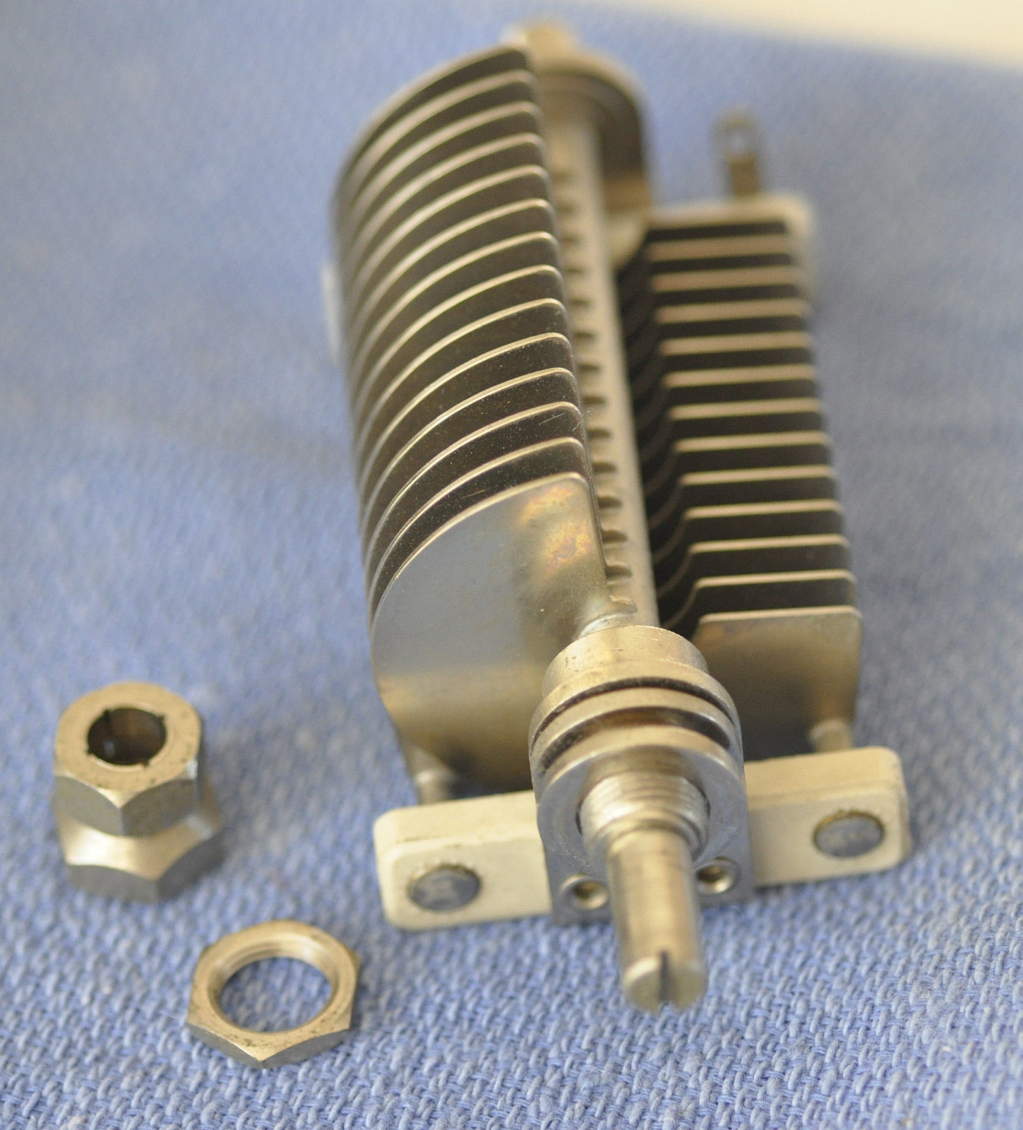

    The ones used in this radio are like this, they do rely on air as the gap but have an insulator so if you tighten the screw too much it won't short
    There are a few other types listed on this site http://variable-capacitors.blogspot.ca/

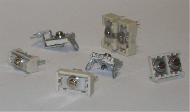

      I know the ones you are talking about an there is are just air caps. The plates would rust together. Even on the mica ones they can get to a point were they can not be turned. The right type of cleaner will not harm the mica. The problem comes when people use like WD 40 and car degreaser that may attack metal or what ever you may have. So it is important to get the correct contact cleaner. Usually when the cleaner is listed as a contact cleaner it will be safe, but you always have some bafone that sells crap. I have attached a picture of a large air cap. It is the same principle in a smaller package however some cars did utilize the larger ones. These would only get cob webs in them and dust until they got the smart idea of enclosing them.
      here is a smaller one

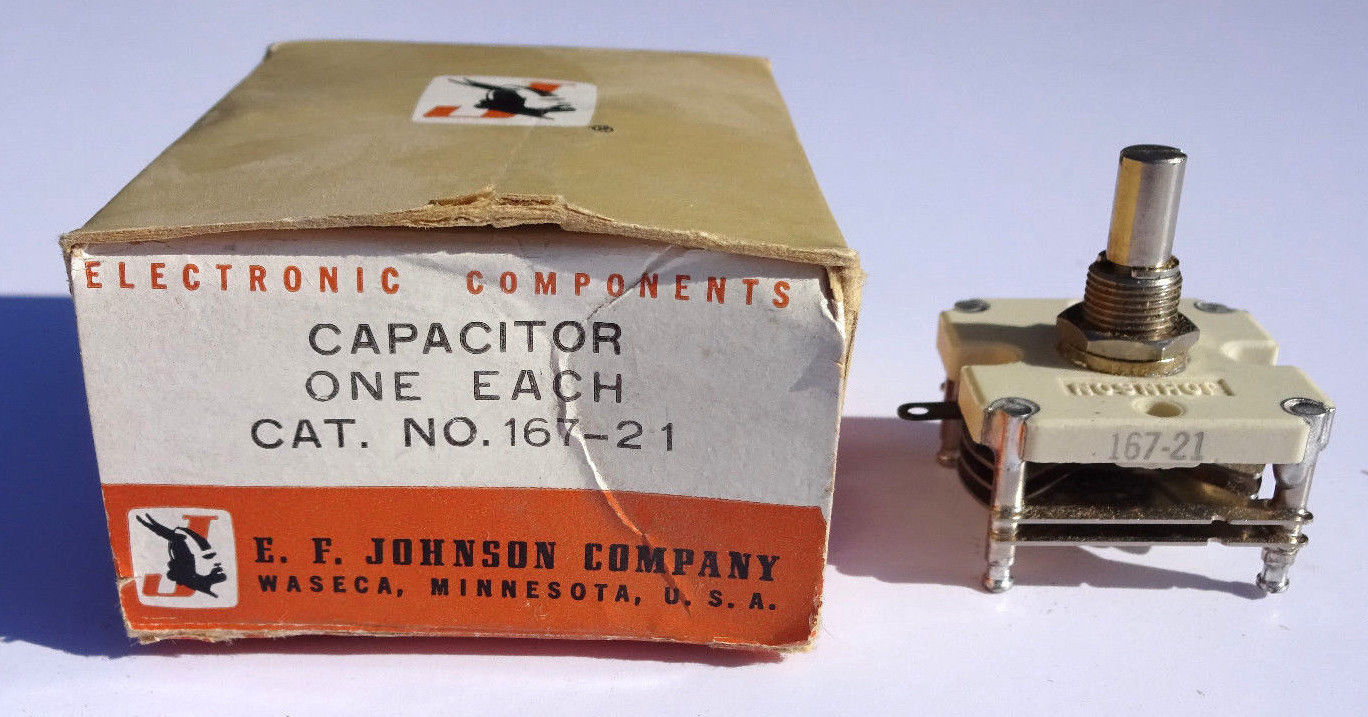

        R_J This is a interesting read http://www.iequalscdvdt.com/air-variable.html
        I was looking for the old disk cap exposed to air and with the tiny mica peace that could break easy. I ran across it earlier but could not find it again.
