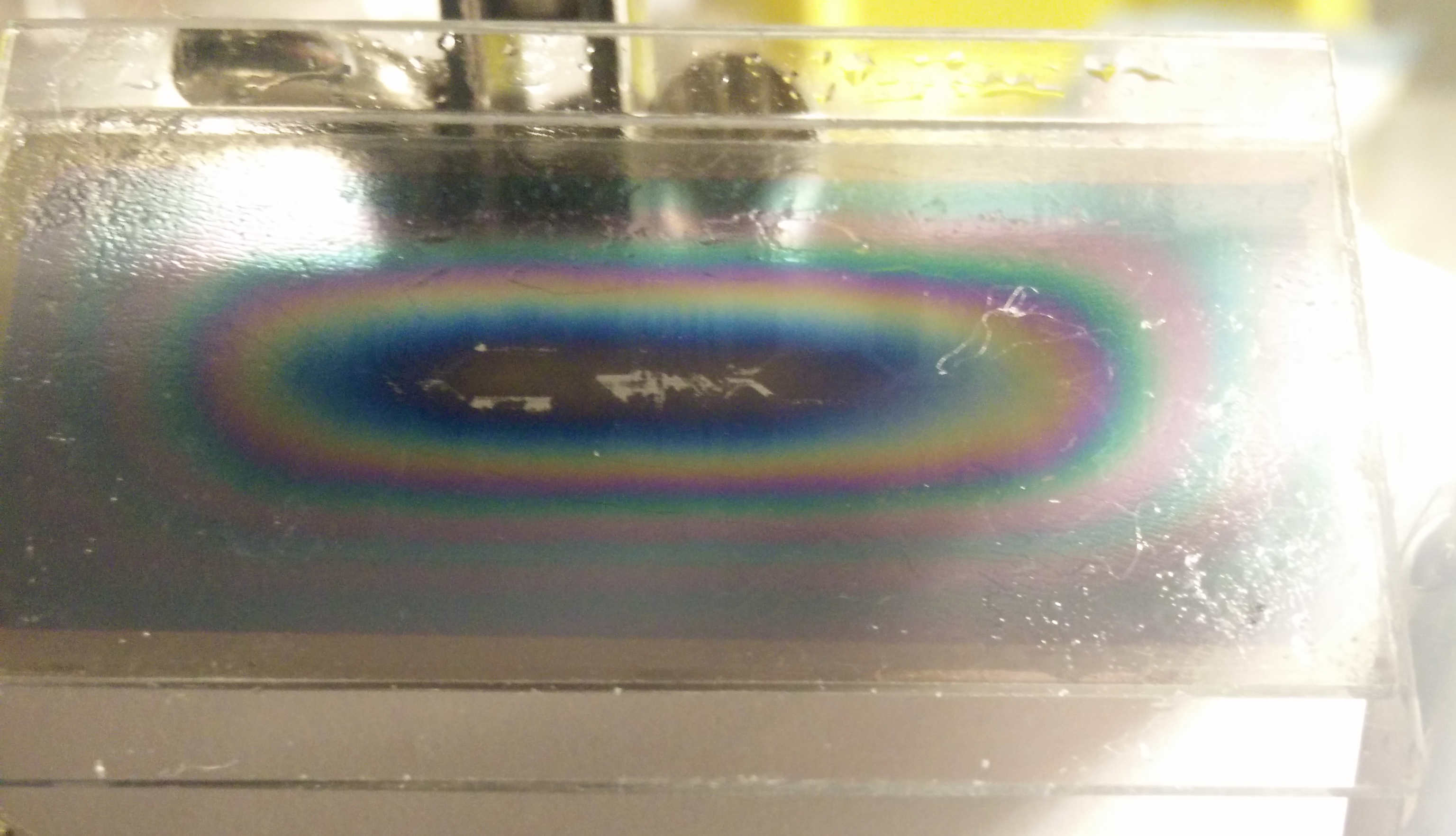

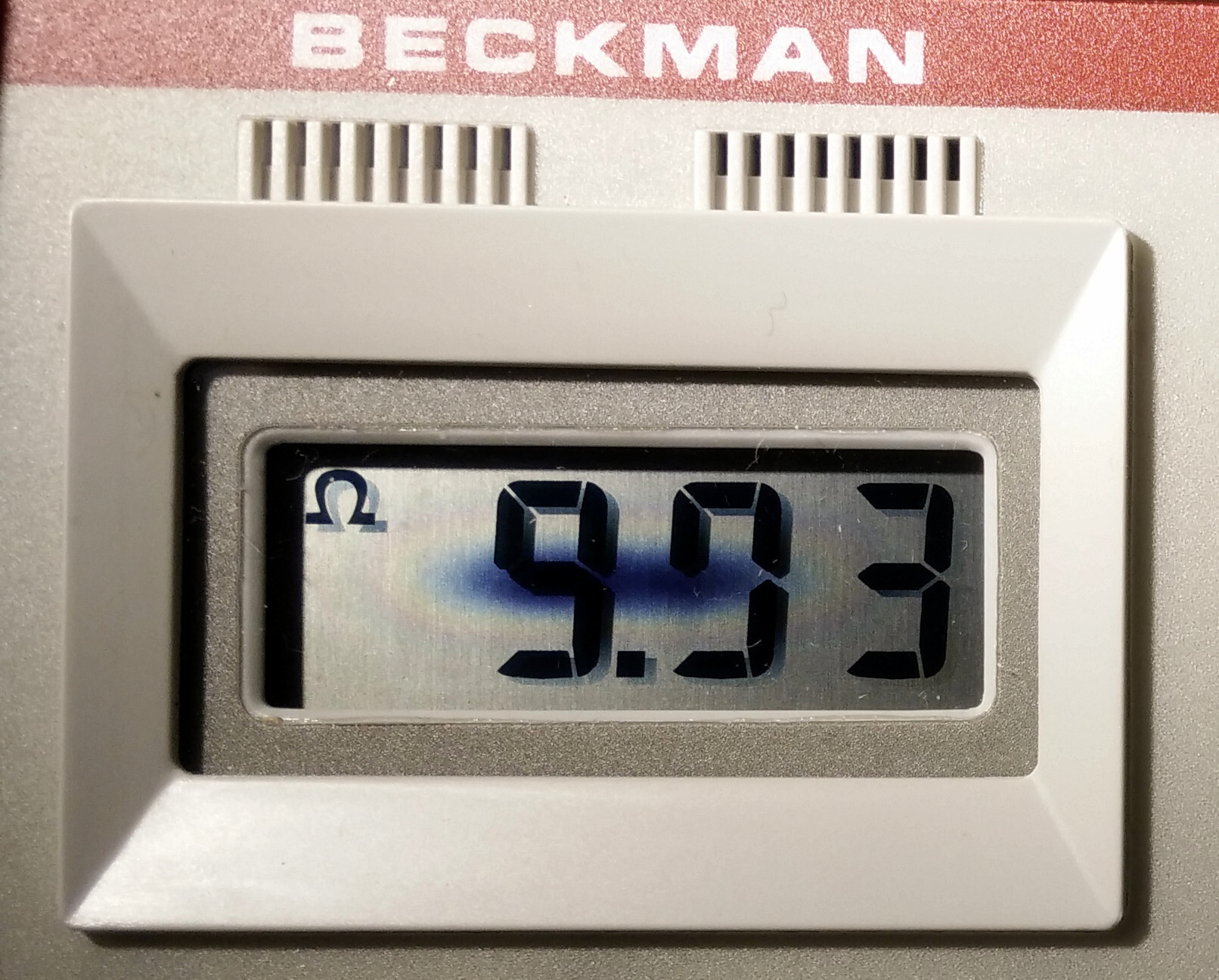

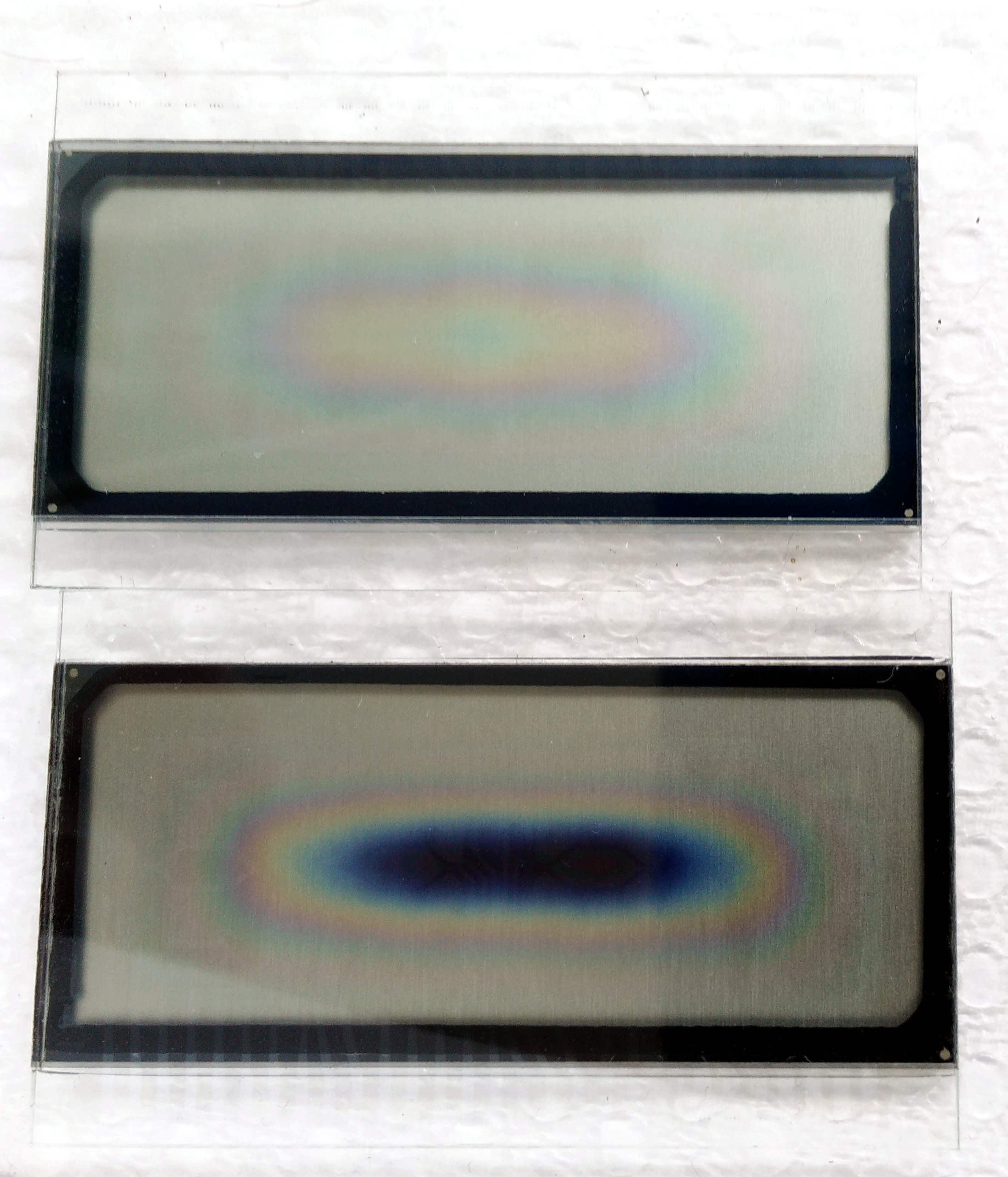

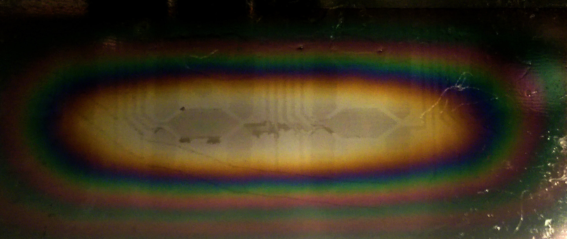

                            LCD displays die in the Beckman/Wavetek DMM's. They develop a black blob which spreads and gets worse with time.
                            I think it's a manufacturing defect, there is tin in the LCD fluid and it looks crystalline like whiskers but because it goes across segments etc. it's not the polarizer, I took that off. The displays are made by AND in the 80's and I was going to get a copy/replacement one made to keep these good DMM's going.

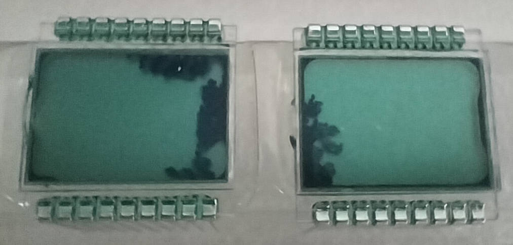

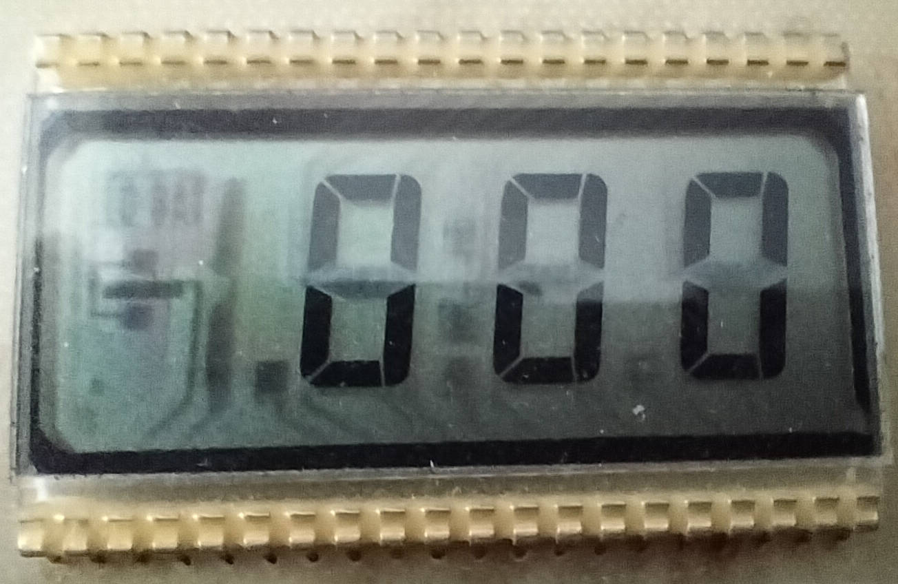

                                Some of these LCD failures may be attributed to pressure on the display which I can't say I never pressed onto the display that failed. But it's not the only non-manufacturing defect possibility. I do recall seeing Beckman LCDs fail in the past too but can't point to what or where I saw, hopefully not the same source :o
                                I have some NOS LCD displays that are fine too...
                                Click image for larger version  Name:	2lcd1.jpg Views:	0 Size:	43.8 KB ID:	3462671 Click image for larger version  Name:	312lcd.jpg Views:	0 Size:	110.8 KB ID:	3462672 Click image for larger version  Name:	2lcd2.jpg Views:	0 Size:	72.4 KB ID:	3462673
                                The small 2 digit displays have not gotten worse however. have to see if the 3½ display gets worse or not.

                                    All of the pictures that you have posted I have seen all of these issues before on LCD displays and like you I am not sure exactly what causes them to get this way
