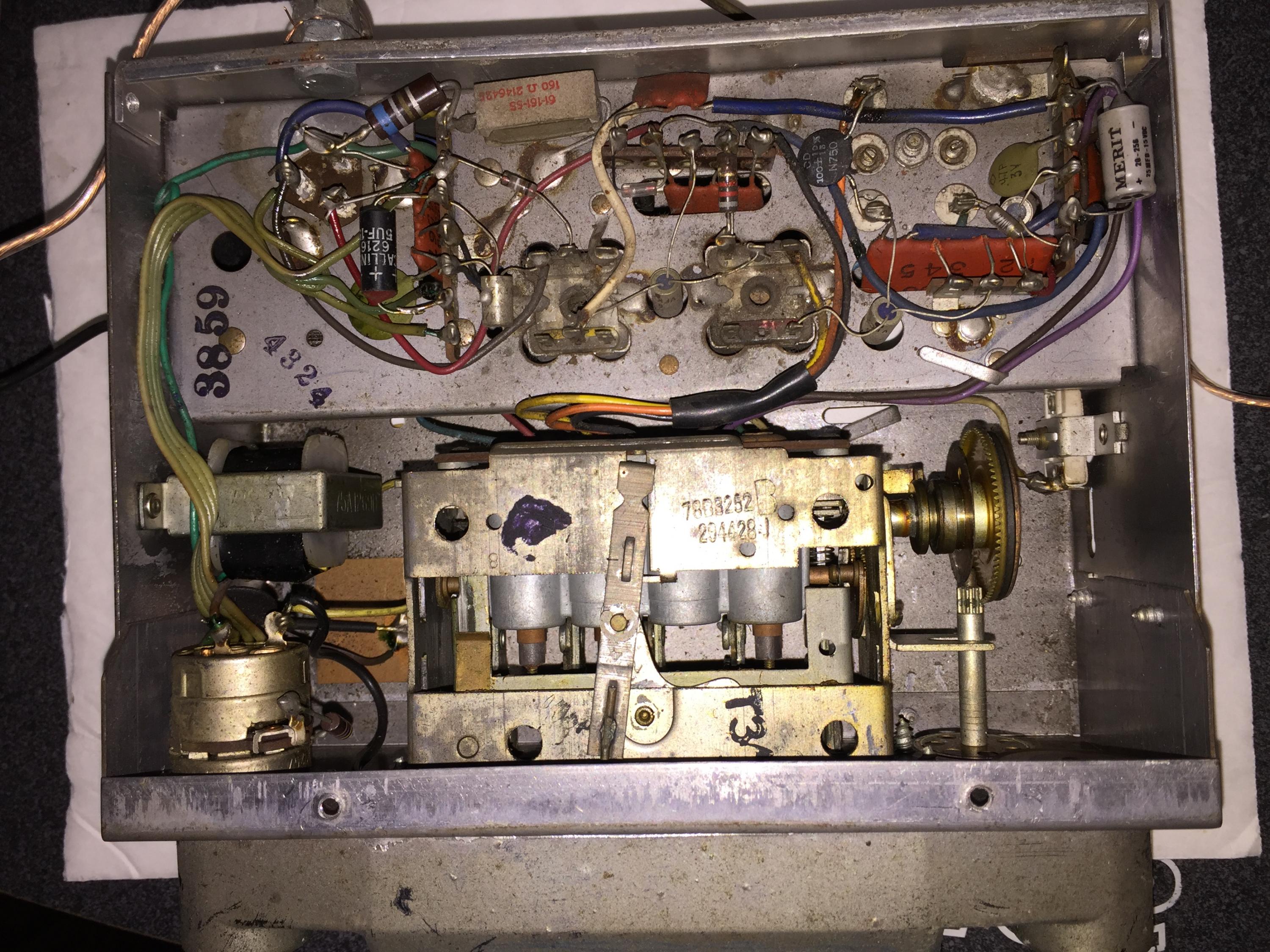

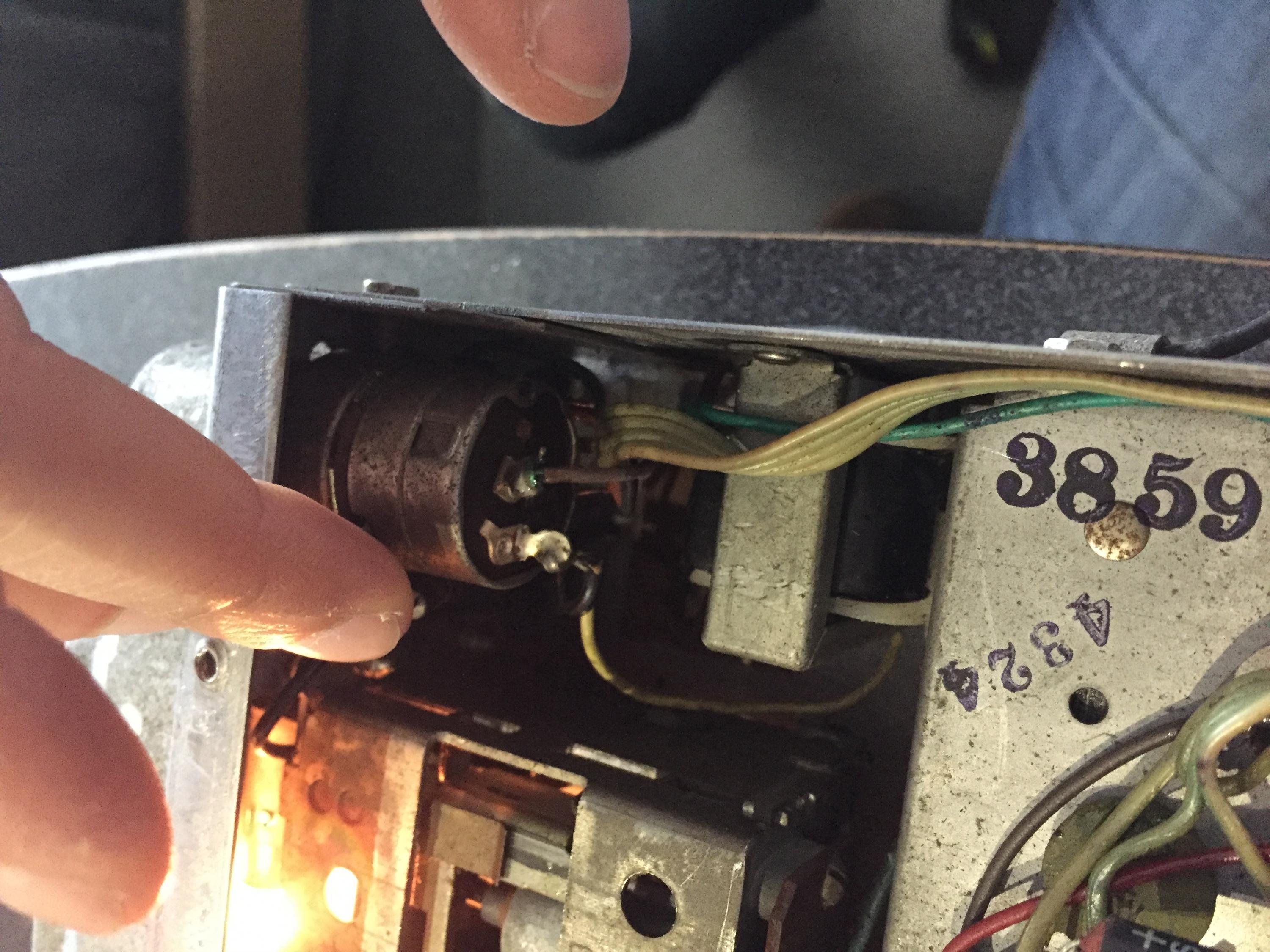

    not touch the knob, touch the contacts at the rear of it.
    • R_J
      • Jun 2012
      • 9594

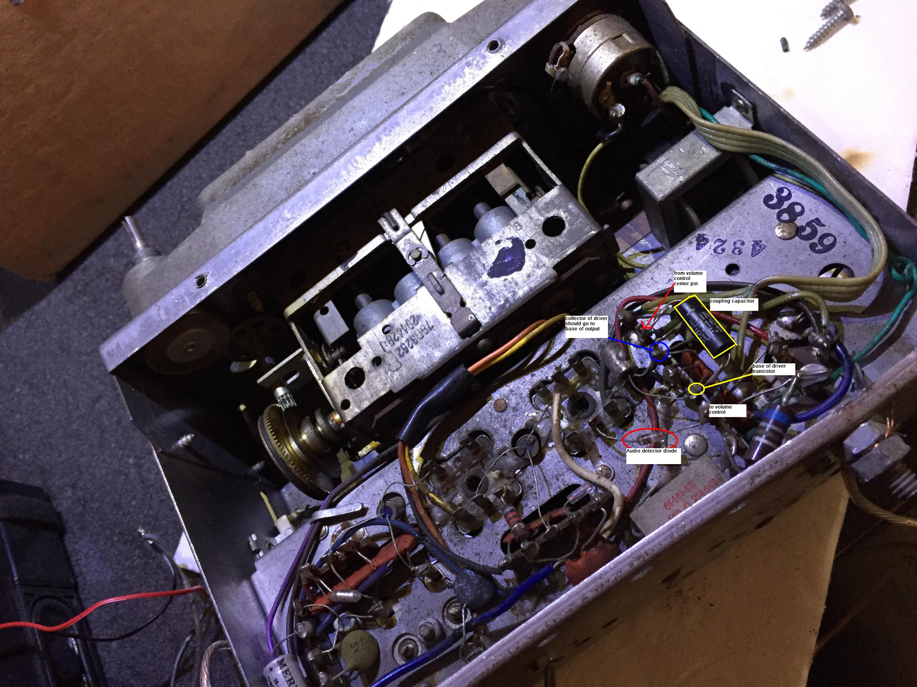

      Re: 64' Ford Falcon Radio Buzzing
      The control should have 3 terminals in a row on it, by touching the center one with your finger, or while holding the shaft of a small screwdriver you will inject a signal, (or use your audio generator to inject a signal, you do have one?) if not this will work.
      or try touching where I marked, it should give you some indication if the amp section is working
        Thanks I'll try that. The area you marked is that the amp side? Curious how you can tell.
        Also not too familiar with audio stuff so been doing some reading, do all radios have an IF section? Or only older stuff
          • 31219
          on a pot, the center pin is the wiper and the outer pins are the track.
          usually the wiper goes to the amp, the far right of the track goes to the audio source, and the far left goes to ground to eliminate hum at low volumes.
          so for this test, make sure the volume is set middle or high, or the center tab will probably be grounded.
            this is the audio path after the i.f. section (from what I can tell) The audio is rectified by the diode and fed to the top of the volume control, the center of the volume control (which controls the level) goes through the coupling cap. and is fed to the driver transistor base, that transistor drives the output transistor.
            so by injecting a signal at the volume control you should get a loud buzz indicating the audio circuit is working.

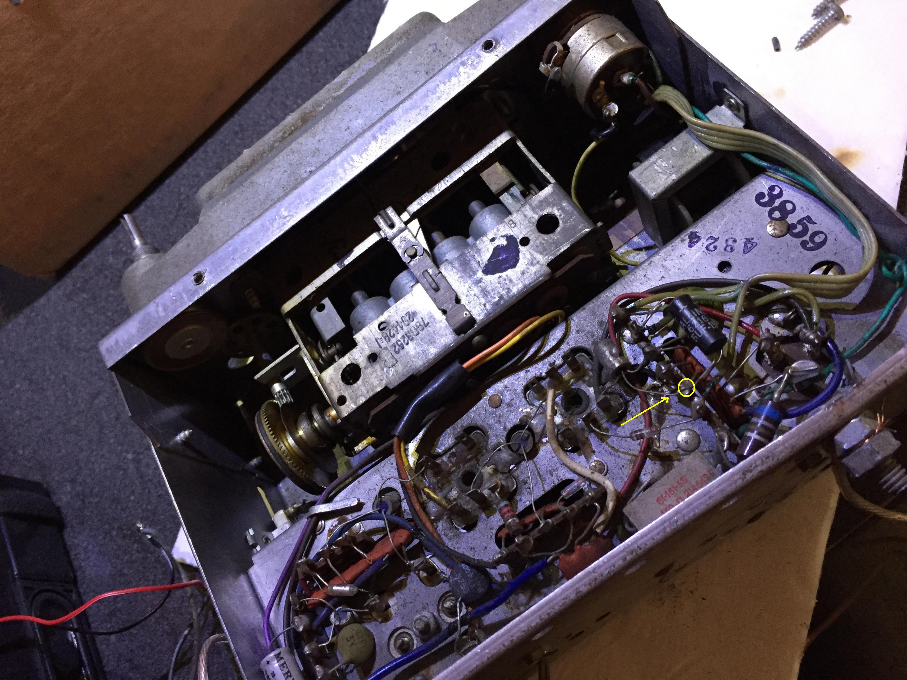

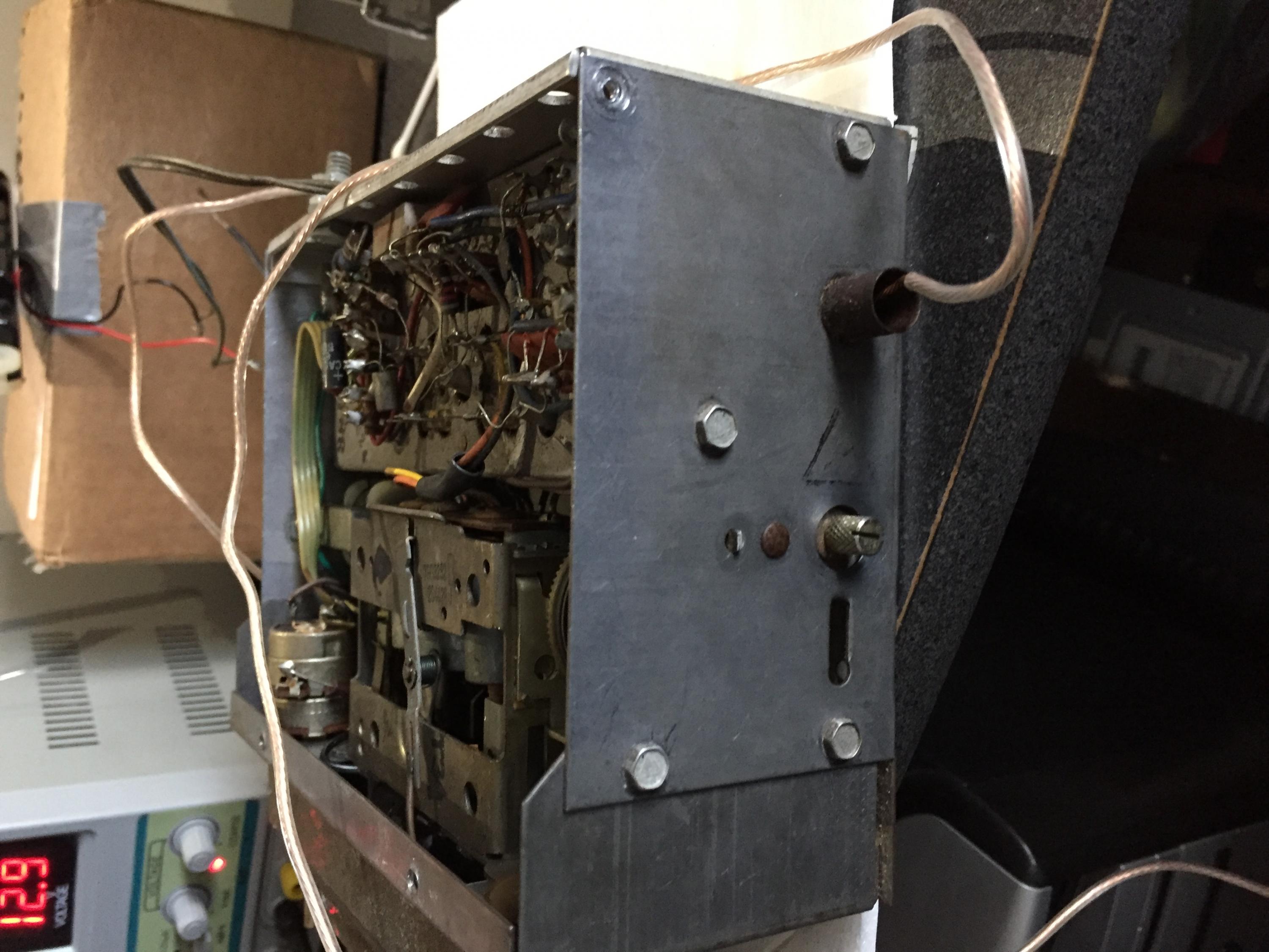

              Ok so touching the volume knob a hum is heard. Not super loud but audible. It's the left of the volume knob that produces it and touching at the - of the capacitor RJ circled produces same him but little louder. Does this mean the amp circuit is fine and I need to look somewhere else?
              I also provided additional pics. I don't see where an antenna would be plugged into this thing. Unless it uses the car chassis as one?

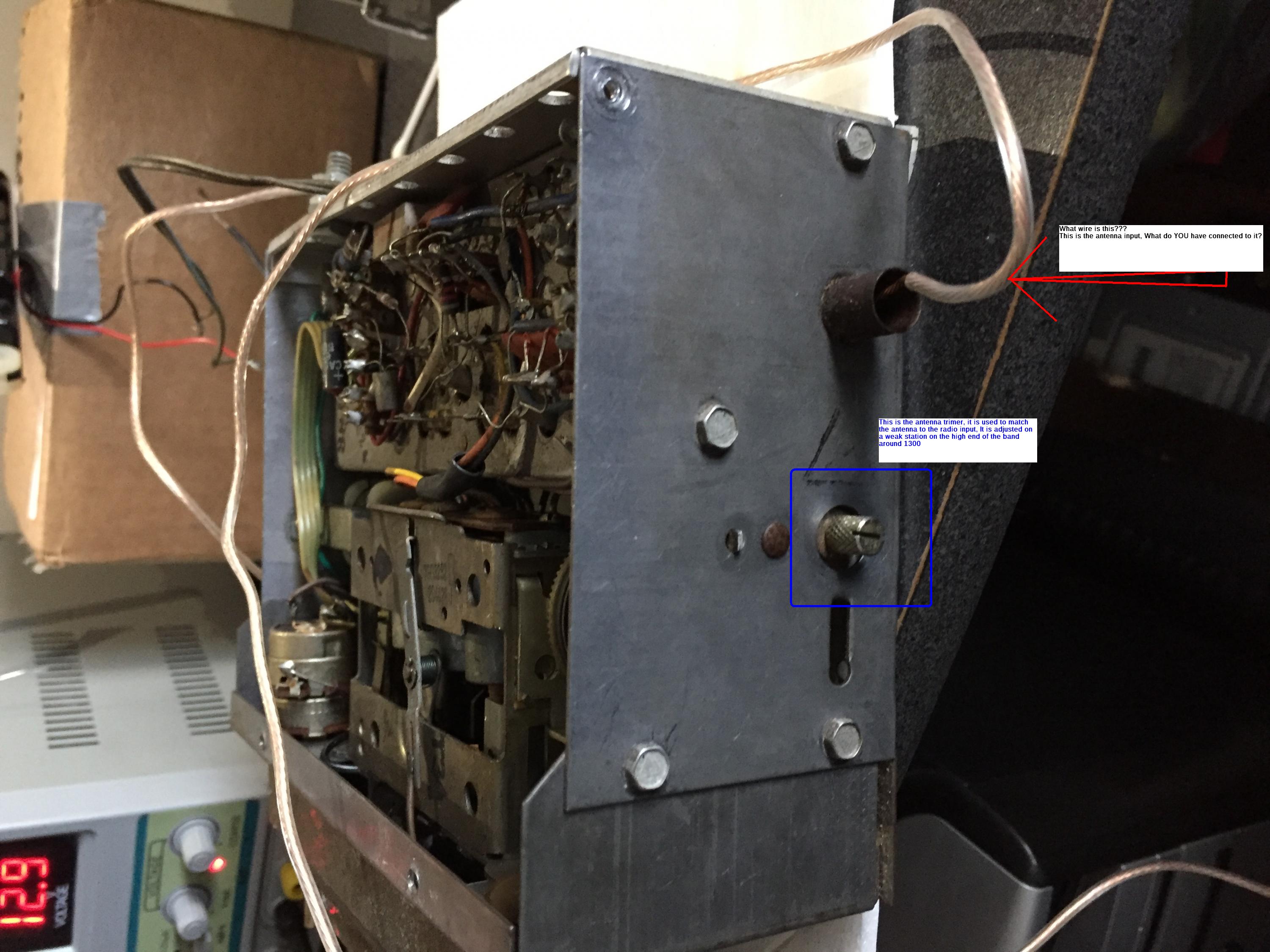

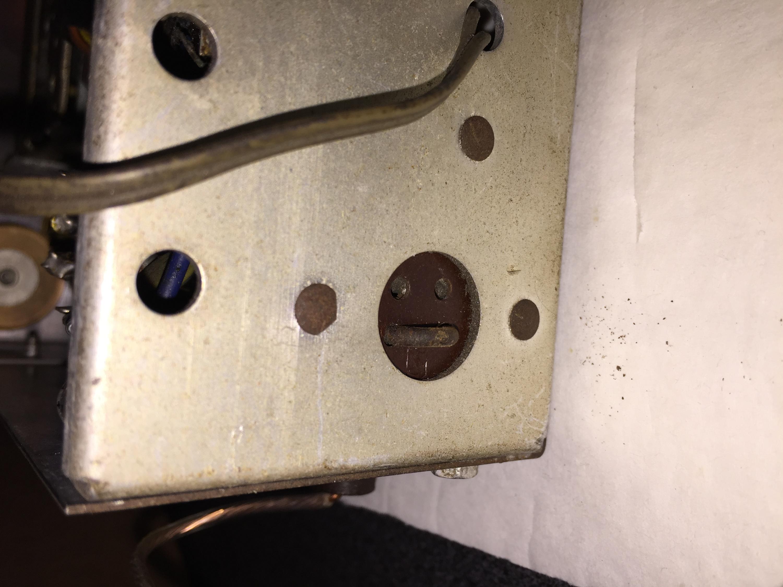

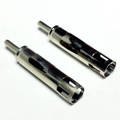

                I marked the antenna input, What do you have connected there? I hope you did'nt blow up the input. I also marked the antenna trimmer
                This is what an antenna plug looks like coming from the antenna, the cable is a coax, outside shield with center conductor
                  That is just a wire that was there when the unit was given to me. I didn't hook anything up to it.
                  Does that trimmer need to be adjusted at all? I haven't touched it just curious

                    #29
                    You don't need to adjust the trimmer, only adjust it when its installed with the cars antenna, Its used to match the antenna so you can get the best reception

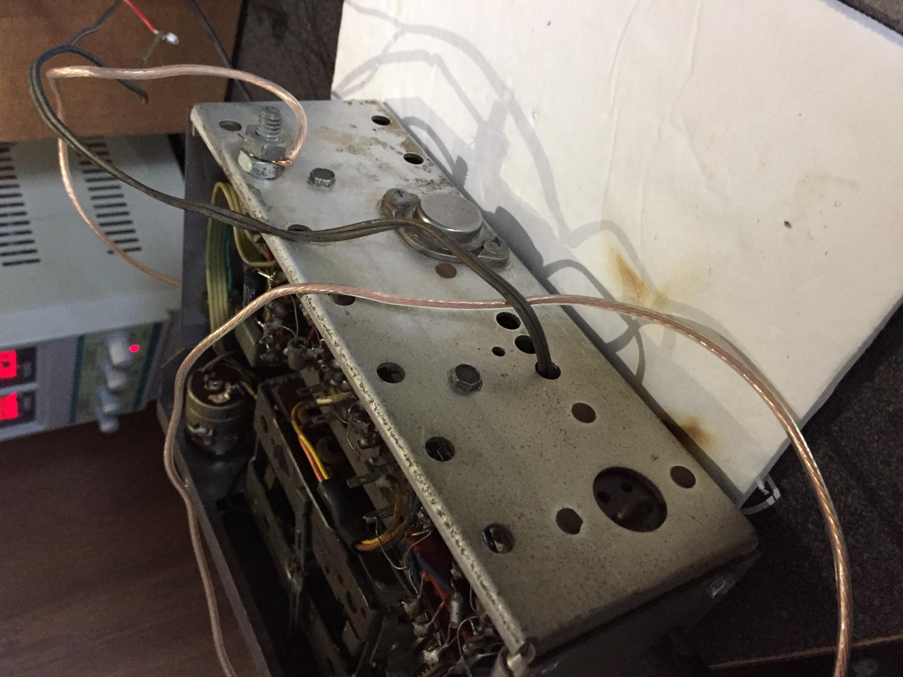

                        So I spliced a longer wire to that existing wire used for the antenna and now I hear the original complaint.
                        All it does is buzz at various frequencies. Sometimes a louder more prominent buzz other times more faint depending on the station.
                        Wish I knew what was the antenna input originally would have eliminated some troubleshooting steps BUT it was appreciated as I'm learning from them.
                        So now I'm guessing the issue isn't from the amplifier section.
                        I only see 2 electrolytic caps that I'll try to replace. Any others I might be missing that's visible to others? Do the values need to be exact or could I use higher ones?
                        Also I'm curious why that output transformer had such a low reading from E to C if it's considered good still?
                            Just a thought but are there florescent lights where you are working, if so turn them off, the could be interfering with reception. I doubt changing the electrolytics will change much. It could be the local oscilator is not working, without a scope I don't see how you can do a proper diagnosis
                            No fluorescent lights. However I noticed if I touch the "antenna" aka the speaker wire that's hooked up into that input then a couple stations come in clear.
                            Are those electrolytics just part of the amplifier circuits?

                                          #40
                                          I already pointed out the antenna trimer in post #22. It won't match worth a dam using a piece of wire, but adjust it if you like.
