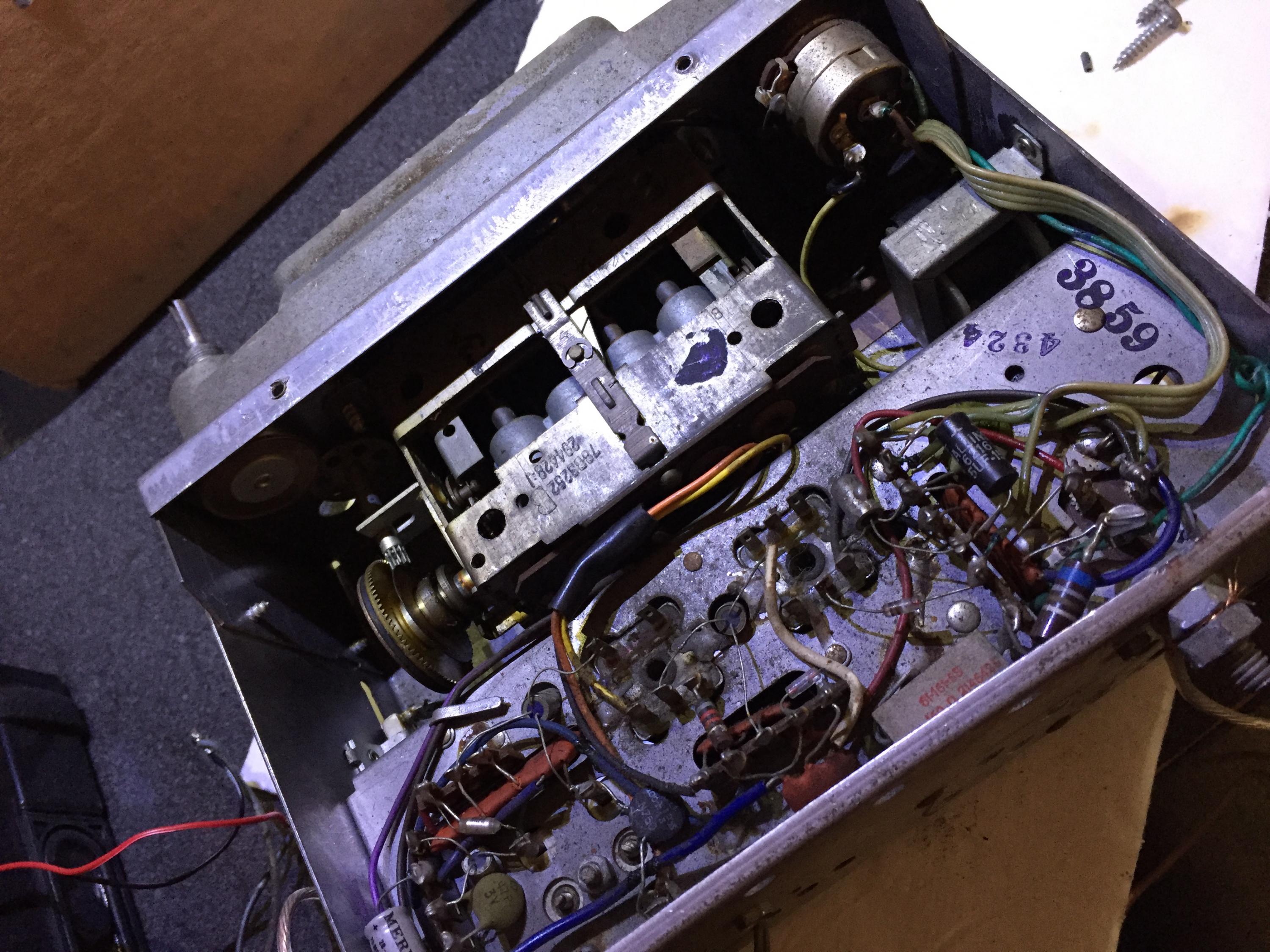

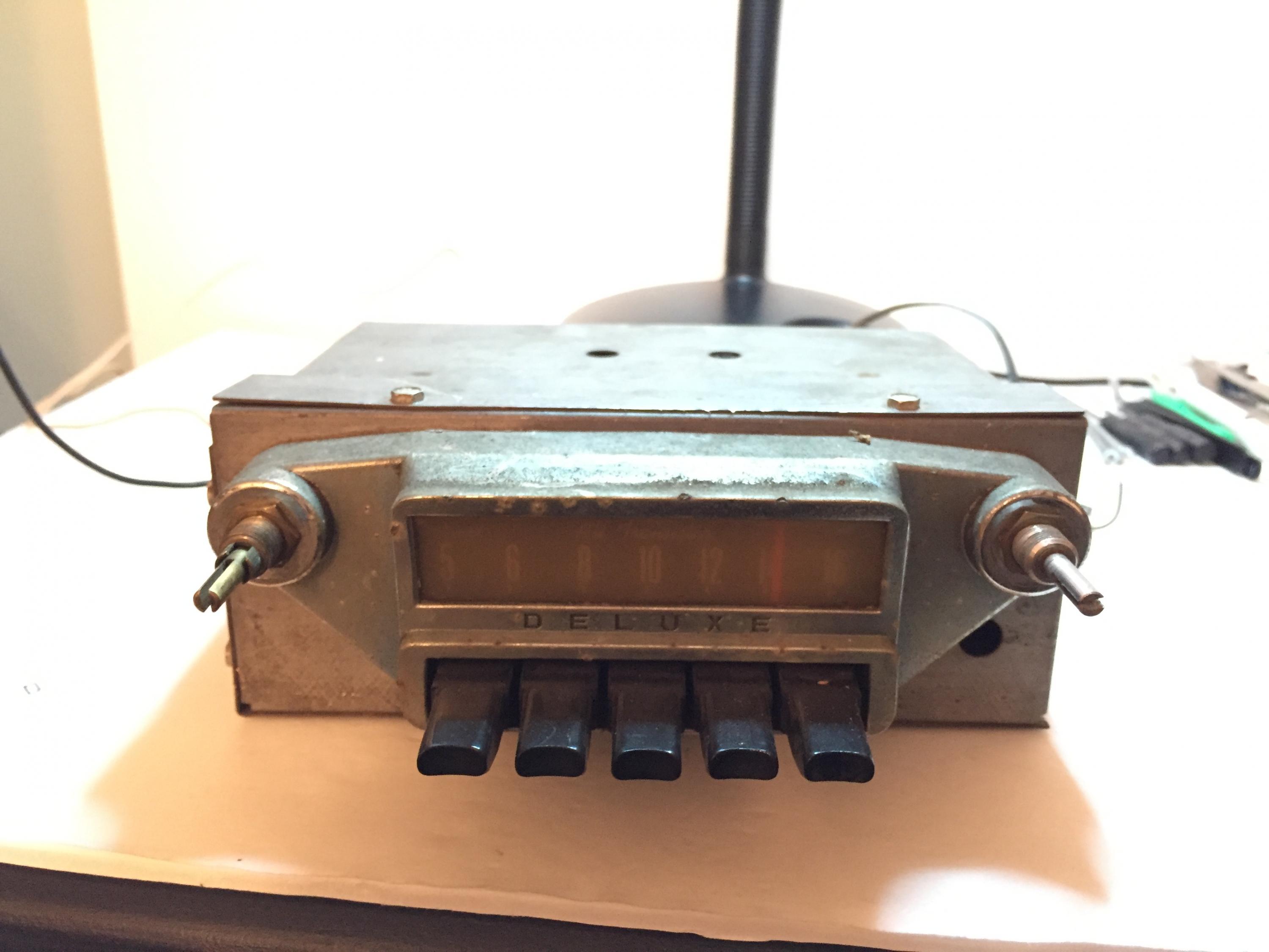

    Hi guys my friend's dad wants me to try repairing this radio from a 1964 Falcon.
    He says it only buzzes and there's no audio.
    I tested the PNP part# 8P404V TO-3 transistor that's mounted to the back of the case and all measurements from B to C/E seem fine but from C to E I get .018 one way and .044 the other in diode mode. When I ohm test C to E I get a reading of 43ohms.
    Shouldn't it be a higher reading? A replacement transistor is $35 so want to verify its bad before ordering a replacement.

            Re: 64' Ford Falcon Radio Buzzing
            Sounds like the IF stage is gone.
            Have you tried injecting audio into the audio amp/mixing stage?

                    No, that transistor is definitely leaky. Actually that doesn't look like the an audio amp transistor, it's attached to an RF coil. And the transistors in the amp section are usually bigger, or non existent if it's a hybrid set. If i had to guess you may be looking at the IF section.
                    More than likely the majority of them are leaky like that. i count four on that side alone. Exact replacements (germanium IIRC) are expensive, i would go through the datasheet and try to find some modern equivalents. I would also do a recap.
                    EDIT: Digging on the radio forums it could be one of many.
                    5TBD, 5TPD or if Motorola made any for that year, 5TMD.
                    BTW, The model number is stamped on the side of the radio, towards the rear, followed by the serial number.
                      start by replacing all lytics.
                      including the multisection can.
                      old germanium transistors like to leak.even develop tin whiskers inside.
                      the to-3 is the output.many pnp ge will work.

                                    I remember vaguely that a large capacitor was used to suppress emf noise coming from the electrical system. This noise interfered with radio signals even in the home.
                                    • kc8adu
                                      • Nov 2003
                                      • 8832
                                      • U.S.A!
                                      its right above the ground bolt in your second pic.
                                      the transistors are germanium.wont find them in modern stuff.
