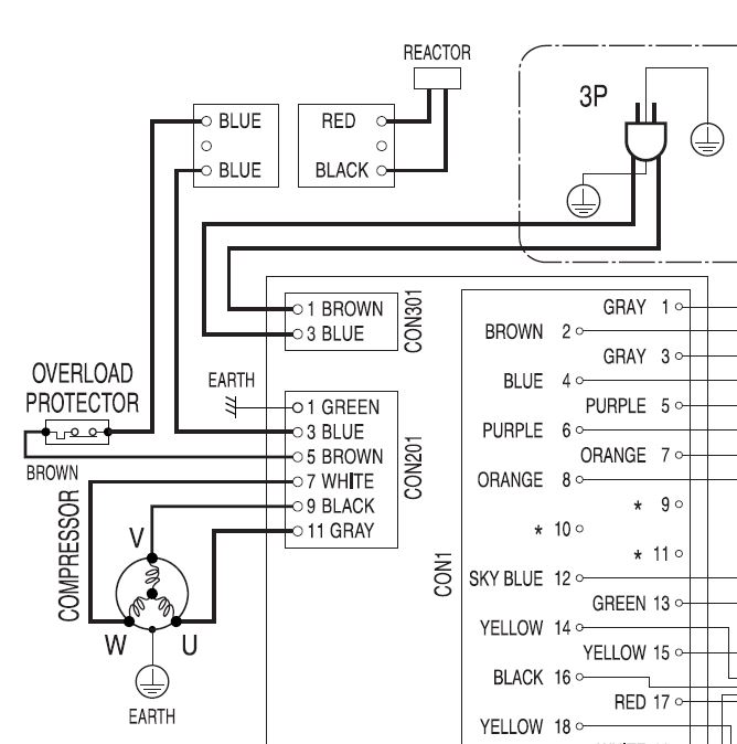

            After listening more carefully to the compressor, I think the humming and vibration is quite low and consistence. I can also hear gurgling noises around the evaporator.
            After power up and running for a few minutes, I gave the compressor a few hard knocks with a hammer (over a thick magazine). Nothing happens...
            The resistance between the 3 compressor pins all read 9.4ohm.
            I am not certain about how to measure the voltage going to the compressor. This is what I think:
            1. set DMM to AC
            2. poke to black probe into pin 3 (blue)
            3. poke the red probe into pin7 (white), pin9 (black), pin11 (gray) respectively
            Is this correct?
            How do I check the overload protector and reactor?

              This is a 240V DC compressor? So should I be checking for DC voltages into the 3 pins?

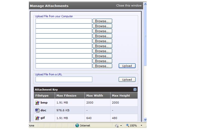

              *for some reasons, I frequently get this error when uploading pics:
              Fatal error: Allowed memory size of 134217728 bytes exhausted (tried to allocate 27000001 bytes) in /home/badcaps/public_html/forum/includes/class_image.php on line 2390
              Any idea why this is happening?
                • 31043
                Re: Panasonic Inverter Refrigerator model NR-BY602XS - suddenly not cold overnight
                sounds like your picture is too large

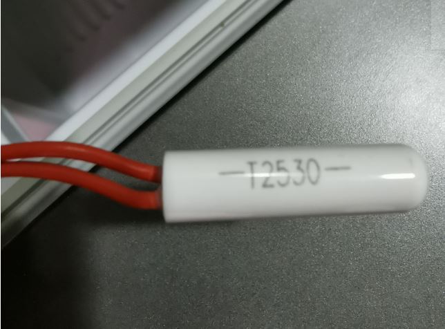

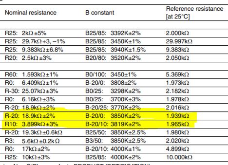

                  Please see the pic of compressor and temperature sensor.
                  What type of sensor is this, and what would be the temperature at 25c and 0c?

                    The compressor is a variable speed by the looks of it, 240v 57~240hz, the control board is basically a variable frequency drive that runs the motor. You should be able to measure the AC voltage VtoU, VtoW, WtoU, should show aboout 240vac
                    I am guessing that is the defrost sensor?
                    • beetle1303
                      • Jul 2019
                      • 279
                      • Singapore
                      Yes - the sensor is a defrost sensor. There is another similar on at the ice maker in freezer compartment. When probed at the cable connector, it measure 1.58k ohm, but when power up and probed at the connector pluck back onto the controller board, it measured 0 ohm, ~2VDC..
                      Shorted?

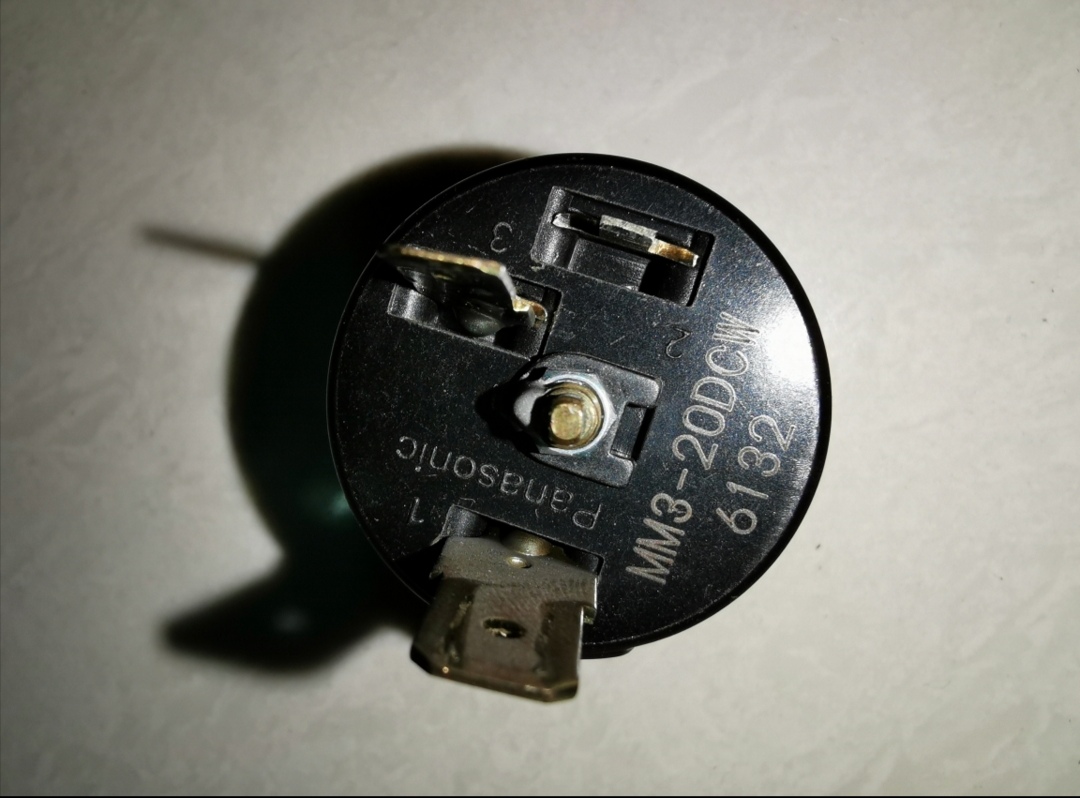

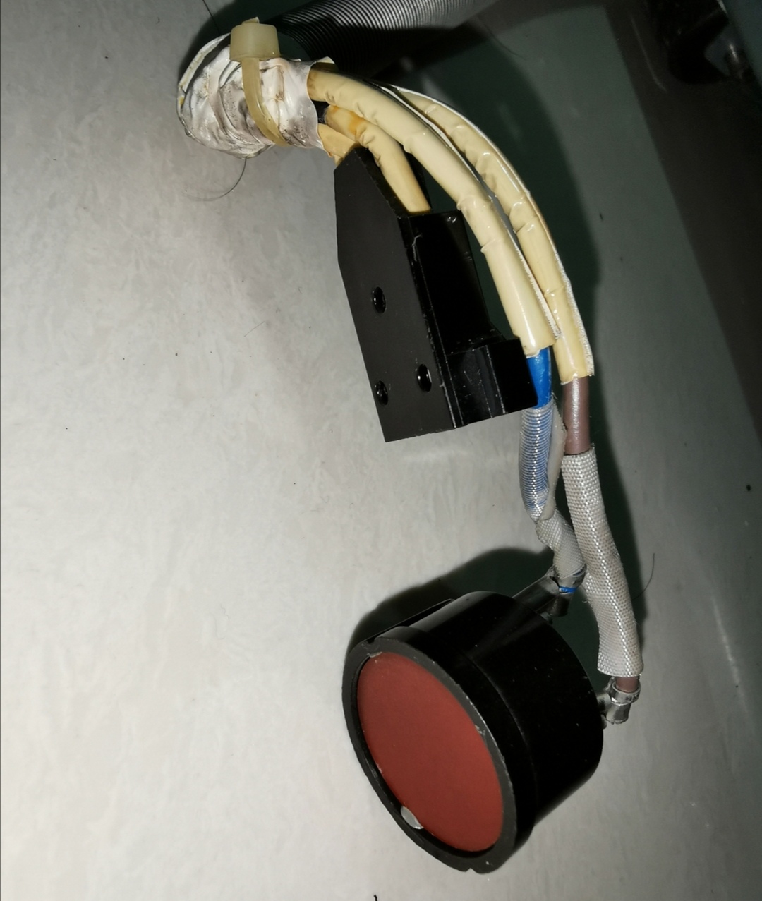

                      On the compressor:
                      I measured the voltages among the 3 pins - they all read ~160VAC. I am curious about DC - and they all read ~180VDC..
                      I also measured:
                      Incoming ~240VAC
                      Reactor 0 ohm
                      Over-voltage Protector 0 ohm
                      I connect a lead wire onto the blue and brown connector of the over-voltage protector, it measured 0 VAC/DC...
                      *all these while, the compressor is still humming and vibrating, but not hot..
                      Does it sounds like the compressor is mechanically jammed?
                                Based on this sensor specs, I believe the 2 sensors I tested measuring at 1.58kOhm at ~26-28c, and 5.8kOhm at 0c should be working normally.

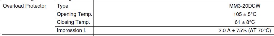

                                On the overload protector - how do I determine if it tripped open due to over-voltage or not?

                                    i suspect the motor may have a bad phase or drive line,
                                    if it hums then the electronics are trying to run it.
                                    we need board pics.
