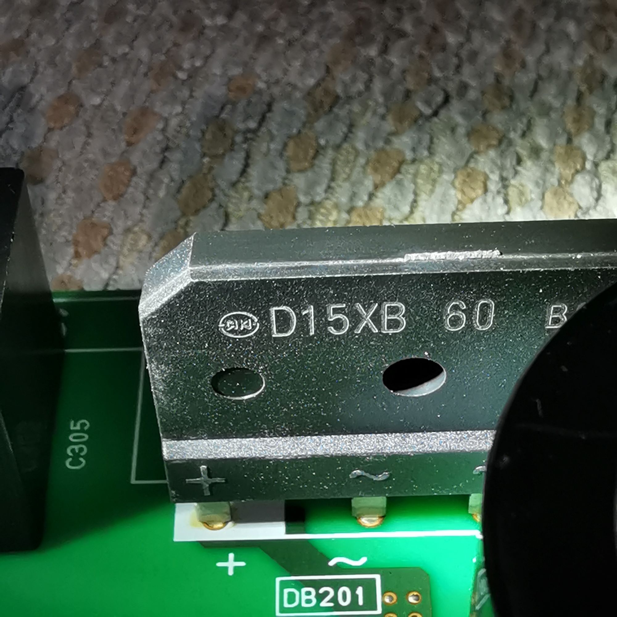

                    the + end of the bridge rectifier is darker, marker pen, soot, burn mark??
                        I think it's shadow from the camera phone. This pics is clearer, look normal.
