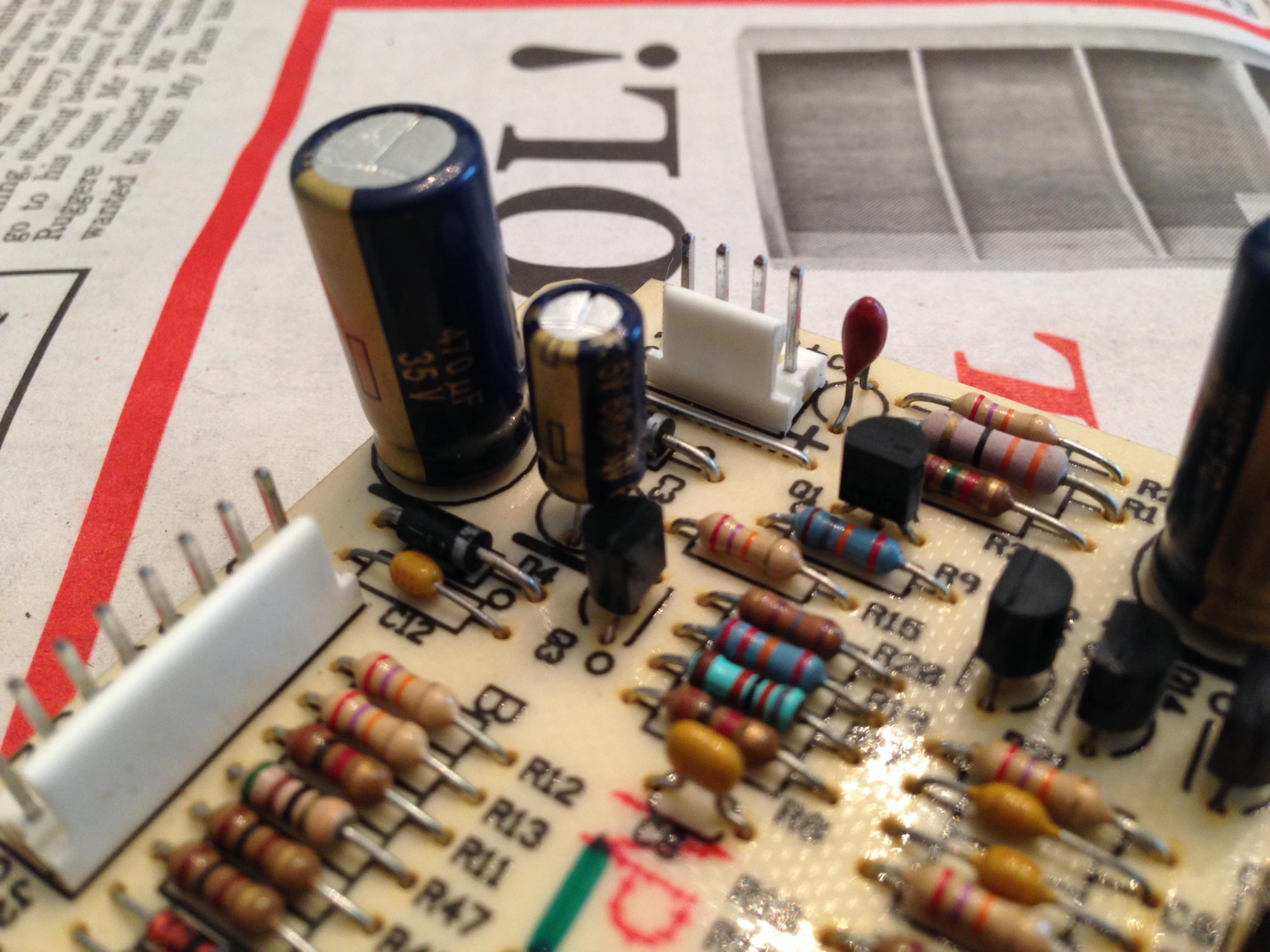

      On the clock module:
      C1 & C4 470uF 35v P10301-ND (or the FM series: P12400-ND)
      C3 68uF 35v P10292-ND
      C7 22uF 50v P10318-ND
      On my oven I also replaced the two caps on the power supply/relay board as a precaution. They were as follows:
      3300uf 16v P10260-ND [filter cap] (or the FM series: P12373-ND)
      47uf 50v P10321-ND [the only other cap on the board]
      Of course the power supply/relay board could vary if you have a different model oven (gas for example).

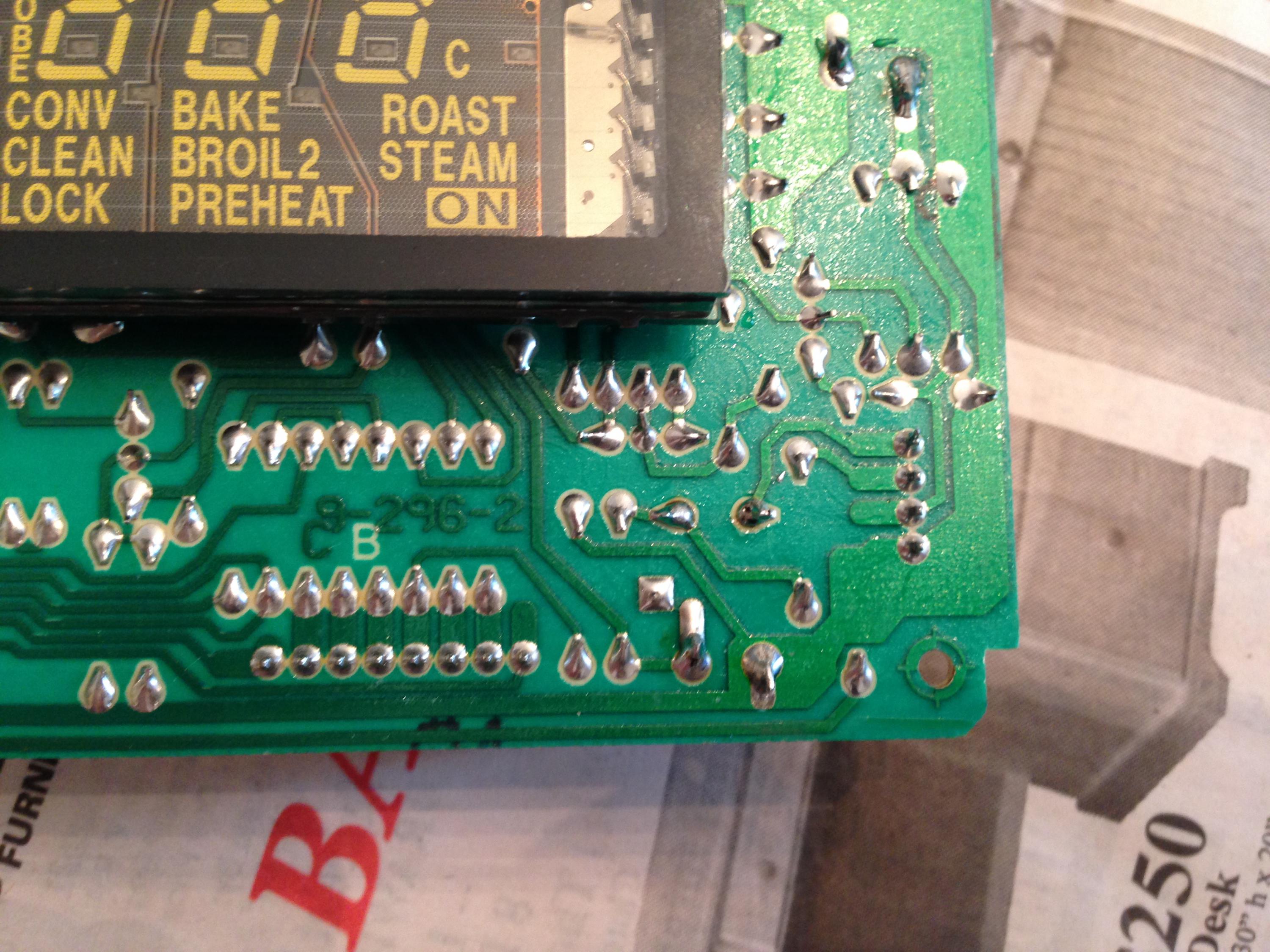

        Hi All,
        I am having the dim display issue and want to be one of the people to post a success story, but need a little help.
        As you can see my Jenn Air unit (model w256w) has two circuit boards stacked on one another.
        Please see attached photos.
        Which is the capacitor that I need to replace?
        Any help would be greatly appreciated!

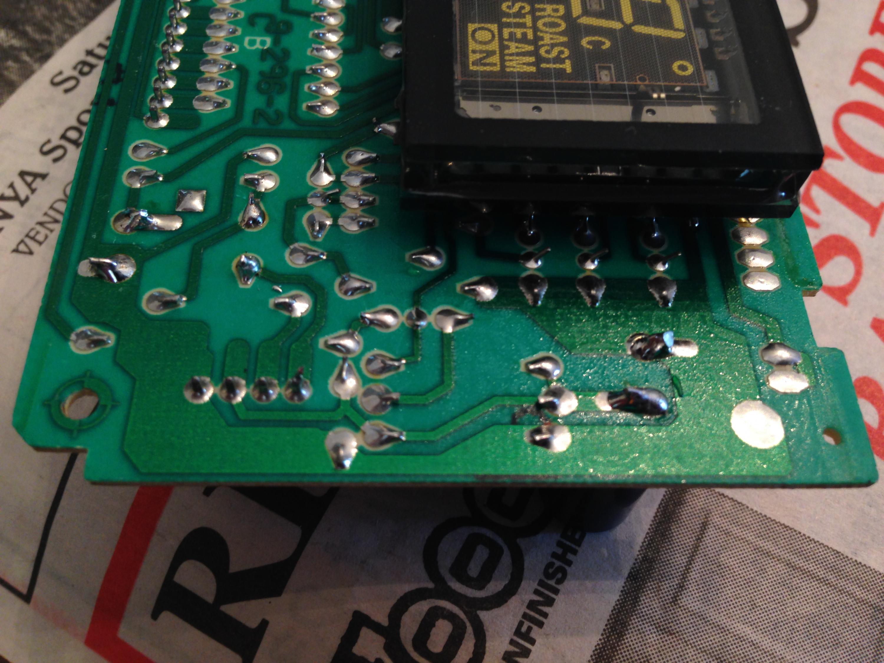

          #144
          Re: Dim Clock LCD on Jenn-Air wall oven
          Here's a photo of the other side.

            #145
            i would replace all 3 of them, but the most likely culprit ( without the schematic in front of me ) is C11 in the second post.

            • WestLinnN8
              • Mar 2014
              • 3
              #146
              Awesome! I'll give it a go, and your right might as well do all three. Thanks!

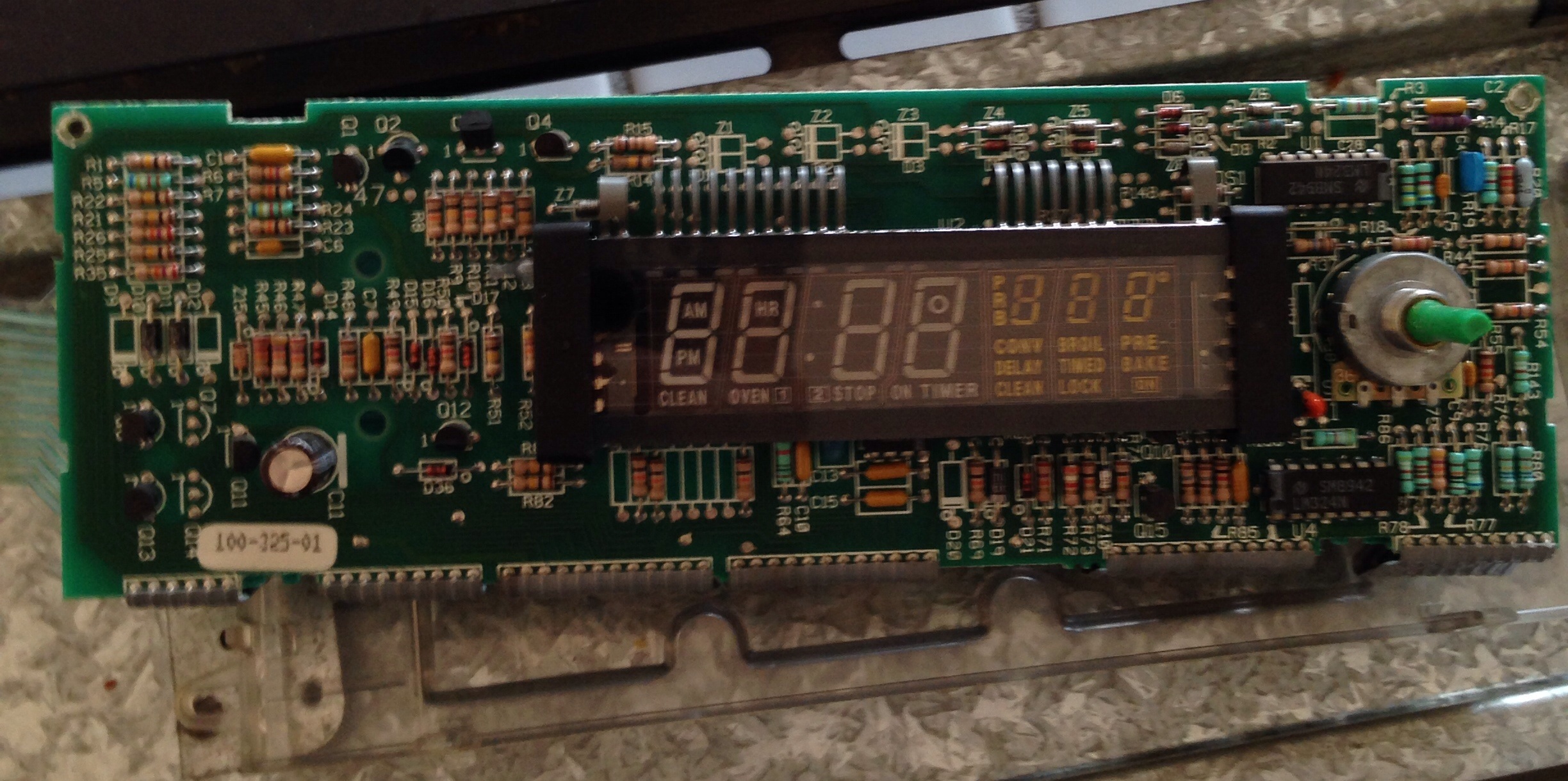

                          My experience so far-
                          I was thrilled to find this forum thread- my jenn aire w30400w surprised my wife one day by beeping and showing F1 on the display. The oven was not in use at the time. Then, over a few hours, the display dimmed down and then out.
                          She went ahead and used the oven blind to make pizza, and it works.
                          Since then I opened things up and poked around. My first thought was bad transformer. After unplugging the control board and reconnecting it, I found the board would light up and then dim down and then out all over again. I was pricing boards and reading the troubleshooting manual, which said F1 meant either bad J2 harness or bad Power Relay Board.
                          Then google brought me to this forum and thread. Very happily I ordered 6 new caps from digikey. This morning I swapped all caps out on the control board and relay board.
                          It seems like the first time I reconnected everything, it acted just as before- display dimmed down to eventually 100% off. The oven still works. Even at it's brightest after the repair, the amber display to the right was barely legible.
                          I read through the entire thread and checked my capacitor orientation and tested for burnt traces- everything looks good. I tested for continuity from each side of the new caps to the next solder point to make sure I didn't burn a trace, all seemed to test out as good.
                          Does anyone have any hints? I'd just as soon shop craigslist for (another) used wall oven as buy repair parts for this one.
                          Thanks to everyone for the great documentation found here!

                            #153
                            You have multiple problems. The dim display symptom is well-known and the fix IS to replace 2 electrolytics on the display board. They will usually be vented or have rounded tops.
                            Error Code F1 means: "Power to element relay energized during time of day display." That's a bit difficult to decode. Remember this model controller board can throw all kinds of F codes randomly. Pressing Cancel Off will clear the code. Removing power at the breaker for a minute or two and then re-booting will often help - for a while. Label the controller board connectors and check your bake relay solder connections. If the bake element shorts out, the relay connections will melt. The relay might still be ok, or you might have to order one from Mouser. They are easy to get.
                            The most common reason for the touch membrane pad failing is spraying cleaning fluid on it. The fluid gets up underneath the membrane and destroys it. Instead of spraying the panel, just spray your rag or towel and then wipe it down.
                            The next most common problem with this model is that the broiler fan runs all the time. See my earlier long thread on this subject also. I have concluded that the EEPROM on the controller board becomes corrupted. I replaced my controller board about 3 years ago and haven't had any further problems...
